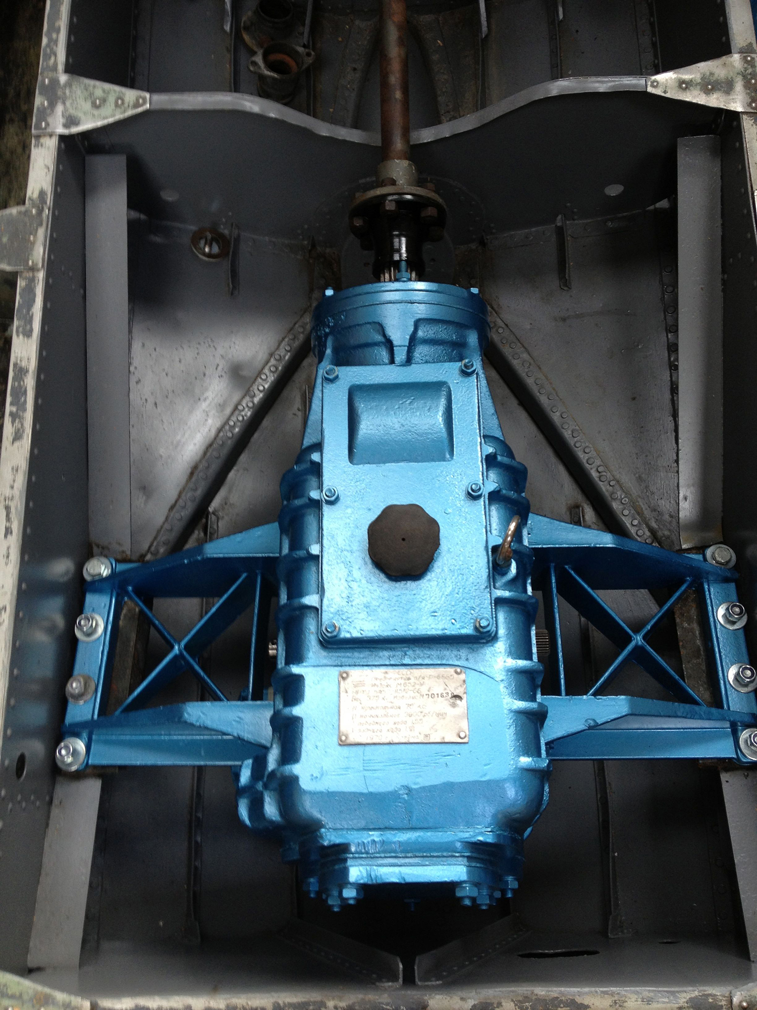

all done !!
and installed.
still waiting on my shafft bearings.
than i can line it up..
installed, still need to fine tune it

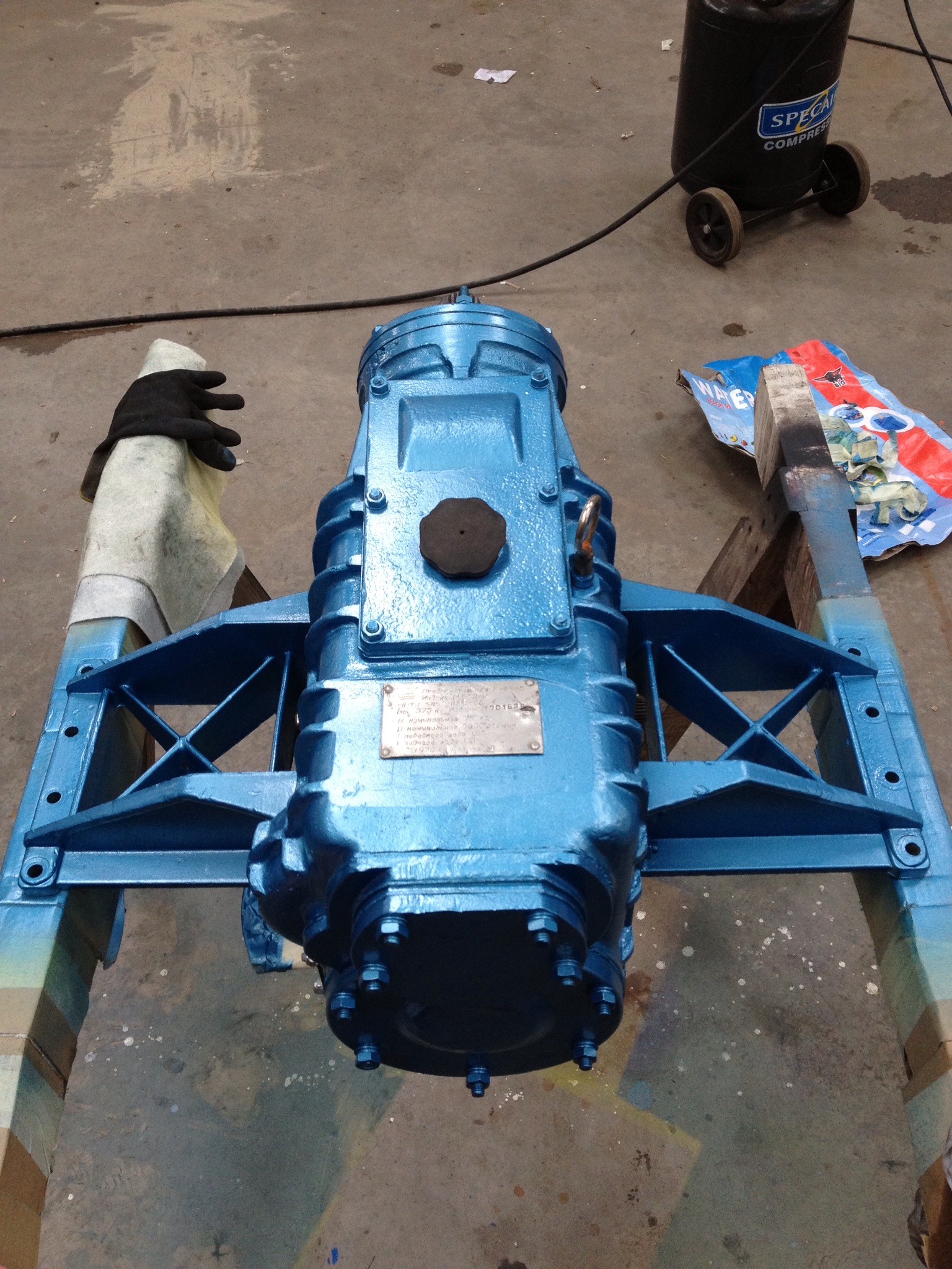

Right after the paint job.
