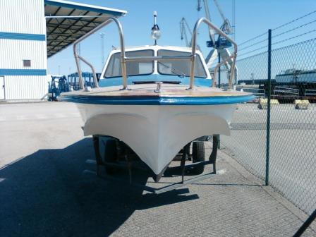

Bild 002.jpg (27.42 KiB) Viewed 903266 times

Hello Klas,
Thank you for that picture! Could you tell us Volga-enthusiasts more about the history of the boat (coastguard - but what was it's original area of navigation?), where you got it, what is the "serialnumber", which shipyard was it made, what kind engine you have in it now, etc? I don't think I have seen a Volga in this particular configuration before. It looks good - and rather comfortable for cold weather!
