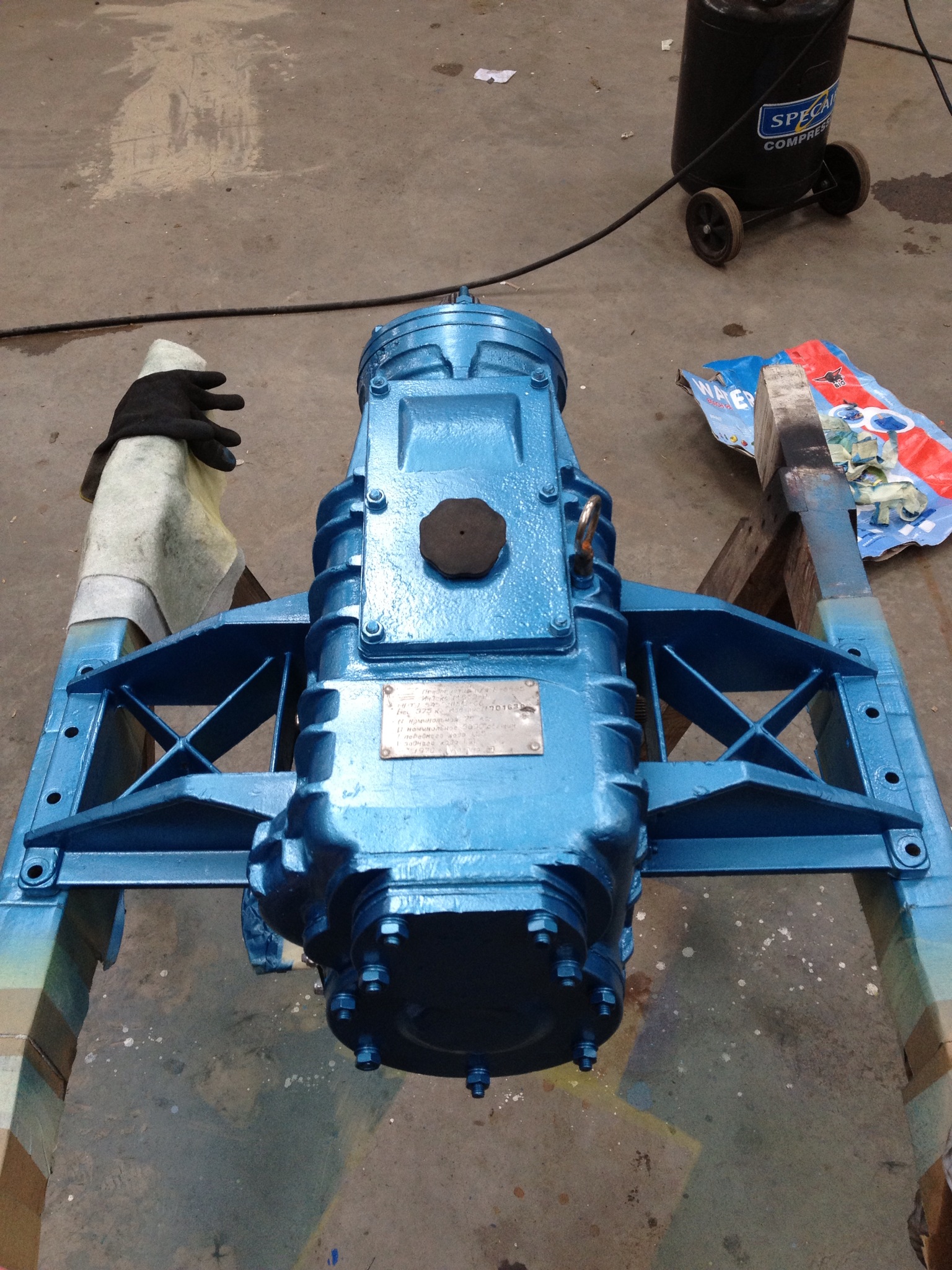

Hay u all,
Above link is to a picasa web album of the rebuild of my URRP-25(УРРП-25) v-drive/gearbox.
The info on the top lid says it is from1970.
Papers of my strela say that the boat is from 1965...
My Strela was found at city Lielvarde(Lielvārde), Latvia.
The first owner was director of some big company.
The company was located at city Lielvarde, this is near biggest reiver(Daugava) of Latvia ,
and his Volga also. The last owner bought it(I think it was 1990).
2 Yers ago Volga was transported from city Lielvarde to city Ragana, Latvija.
From city Ragana we transported it to Holland.
And in the state she was found she has not seen water since then.
So I begun taking it apart.(well taking a brake since the boat is outside and is freezing here.)
I Brought the URRP to my dad's place, and started..
All bearing are new.
6208 = 40-80-18  4x             grooveballbearing(SKF)
6305 = 25-62-17  2x             grooveballbearing(SKF)
6308 = 40-90-23  2x             grooveballbearing(SKF)
6409 = 45-120-29 1x            grooveballbearing(SKF)
6208-M=40-80-18 1x            grooveballbearing(FAG)
N213 = 65-120-23 2x           cylindrical roller bearings(SKF)
1x O ring for the ingoing shaft,
and a oilsealing for the 40mm outgoing shaft.
Now i only need a oil tepm sensor an the oil.
Any tips??

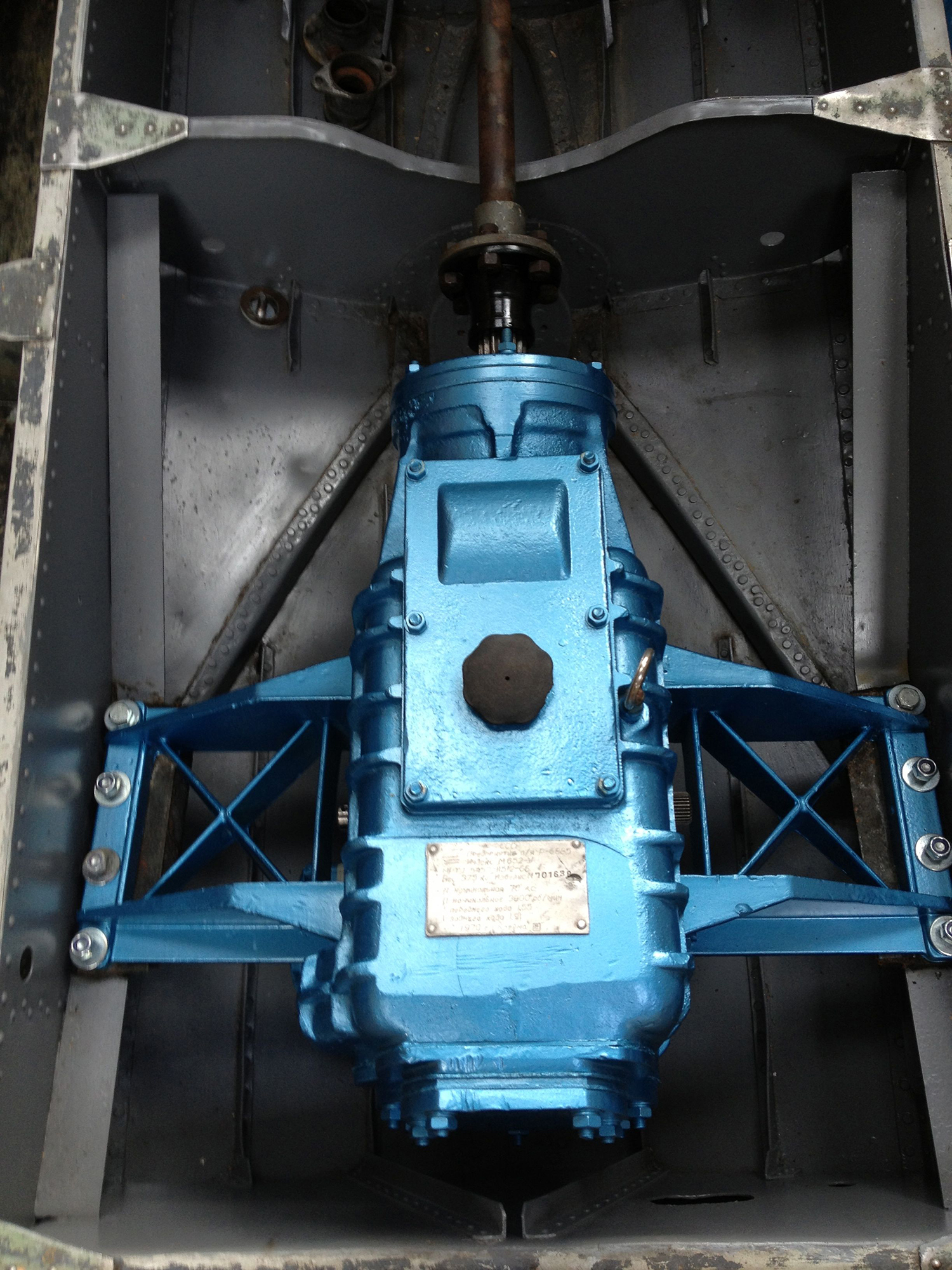

all done !!
and installed.
still waiting on my shafft bearings.
than i can line it up..
							and installed.
