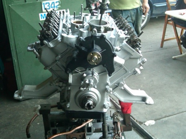

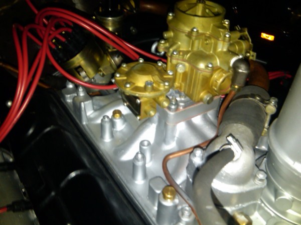

From what you can see, we are more or less finished with the engine but still need to make the correct connections. The spares we have installed, however the company to provide the spares or the manufacturer has not given on his packing any idea about the connection of the carburator and the rev limiter. The revlimiter is having a single output
- Revlimiter below the Fresh Water Pump / Above Crankshaft output
and produces a vacuum which should be connected to the carburator. Our new (and old) carburator has two connections where this vacuum pipe or hose could be connected.
- Diaphragm of the carburator (There are two connections)
Which one is the right one?
What is the other connection good for? Anything to connect over there?

the pic of the carburator is not very good. put pis from all 4 sides of the engine! Normally the GAZ 53 has a K 88 2 barrel carburator it is the same as on the ZIL 6,0Liter or Ural 7,0 Lt. engines!!!
Normally from the carburator there is one copper pipe to the rev limiter, from Rev limiter there goes another copper pipe to the diaphragm mechanism .
here I see 2 bores for pipes on the diaphragm???
what carburator did you get?? any name Number ?
It must be some newer variation of the classic carb. K88.
By the way all gaz trucks run even on the road WITHOUT rev limiters!! All are bypassed or plugged.
At sea you have a hand gas not a foot throttle pedal, so you do not need the rev limiter at all. My two cents: just put plugs at the bores of the carb and the rew limiter , thats all!
