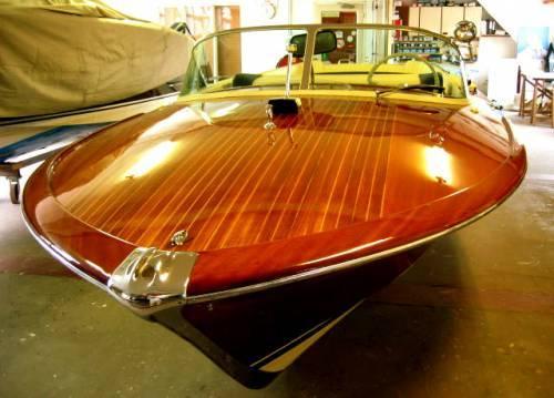

Rounded top wooden deck

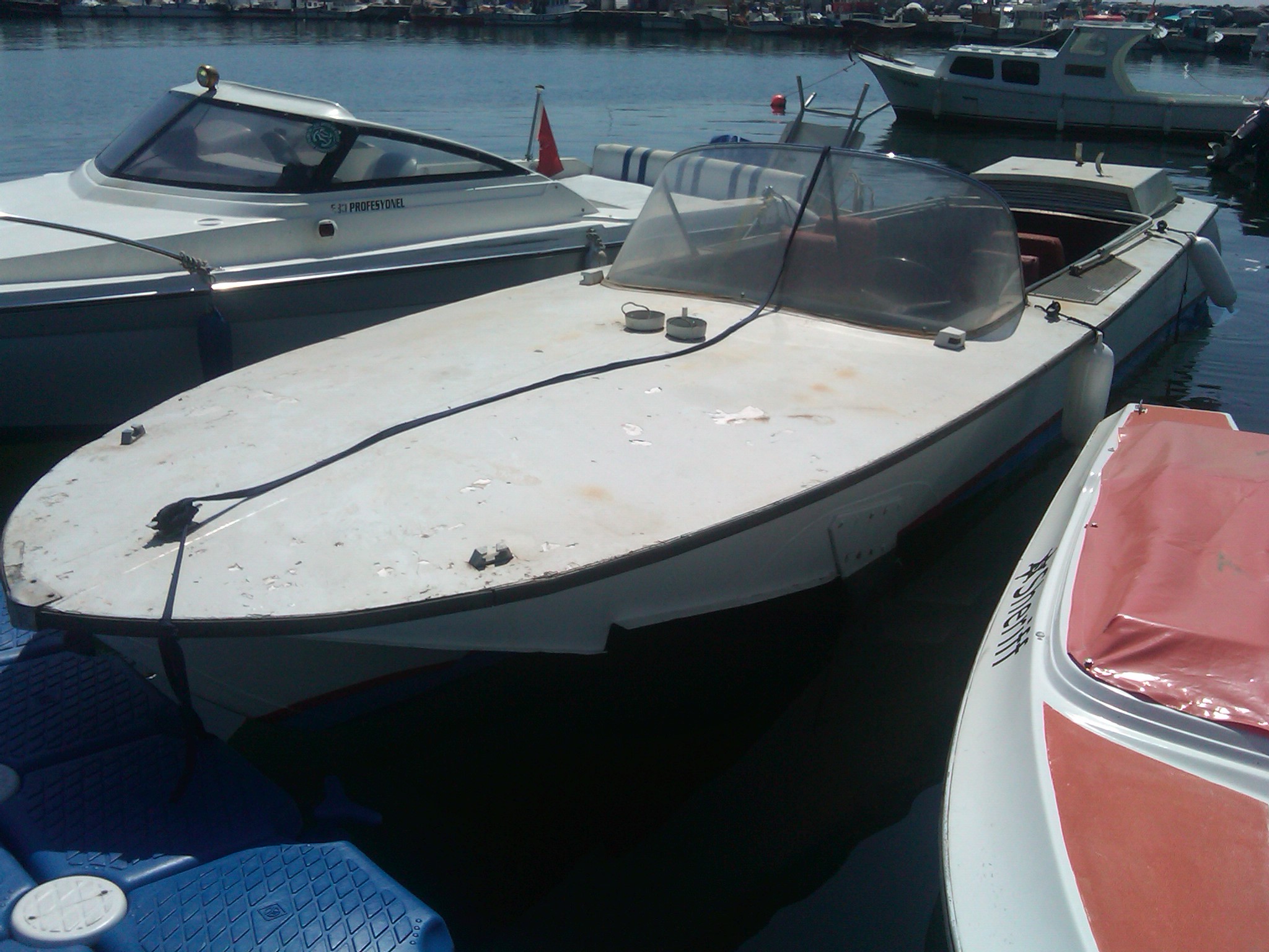

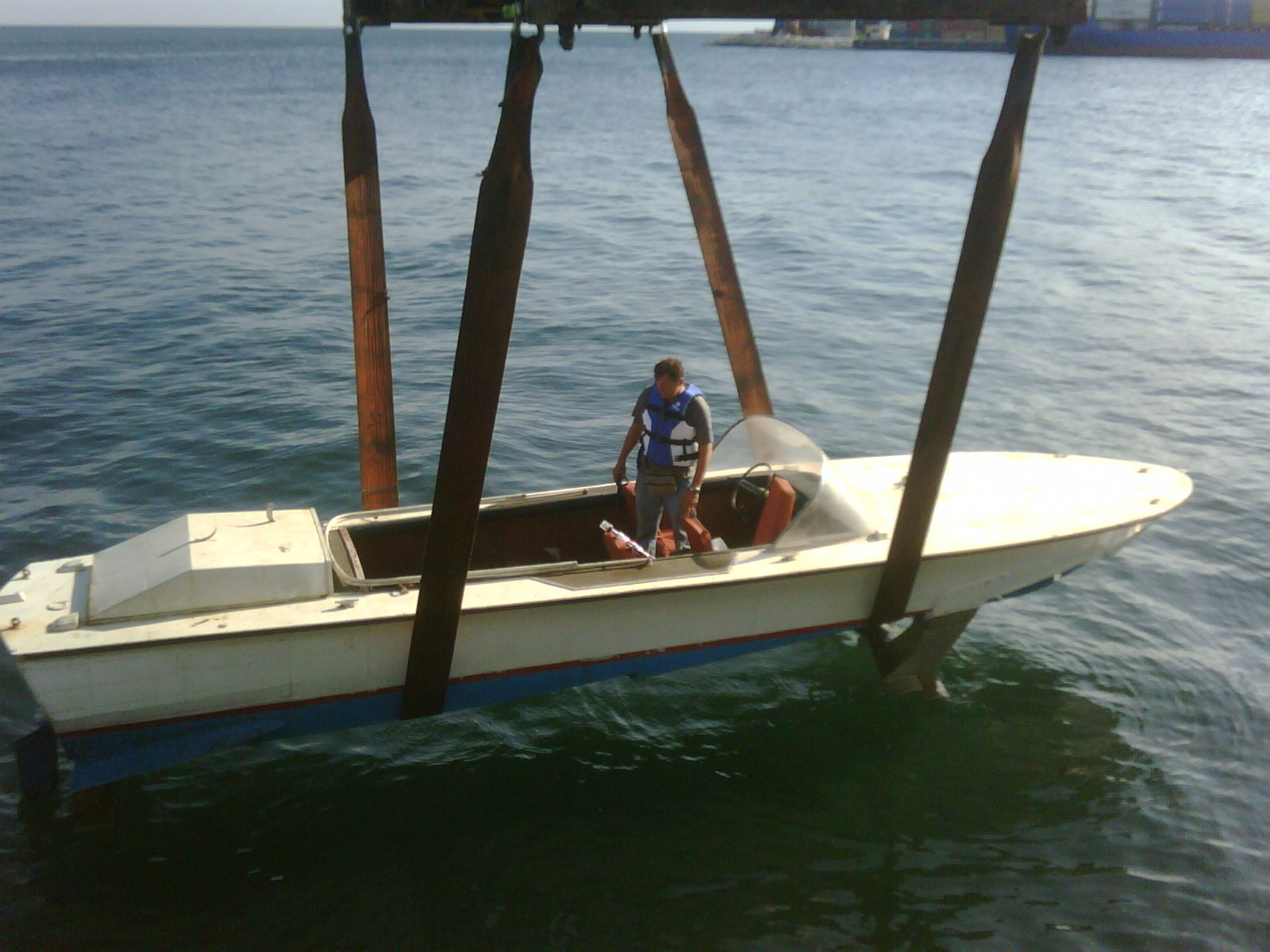

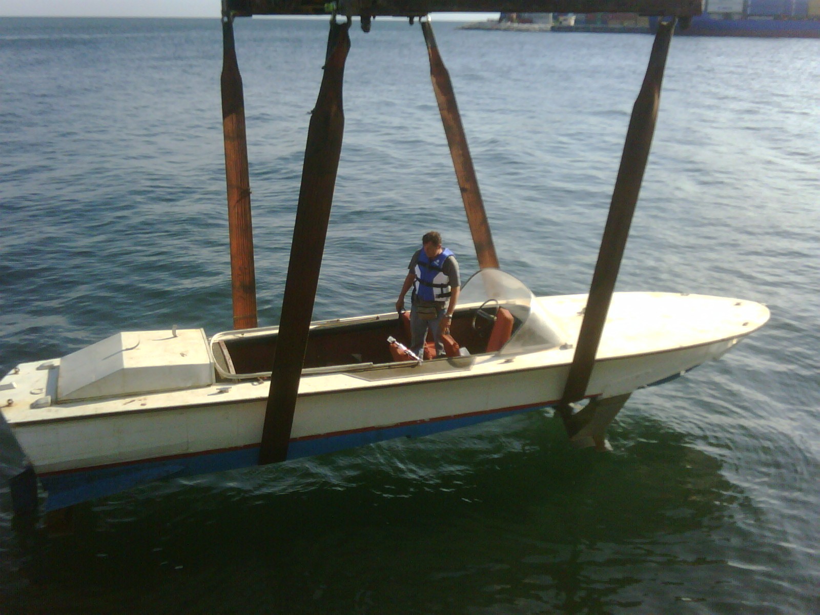

The boat was in a very bad condition after the transport from Batumi. Deck was bumped at several places, paint was so old and top coating was of poor quality cracked and dirty.
Hull bumped and paint cracked at several places

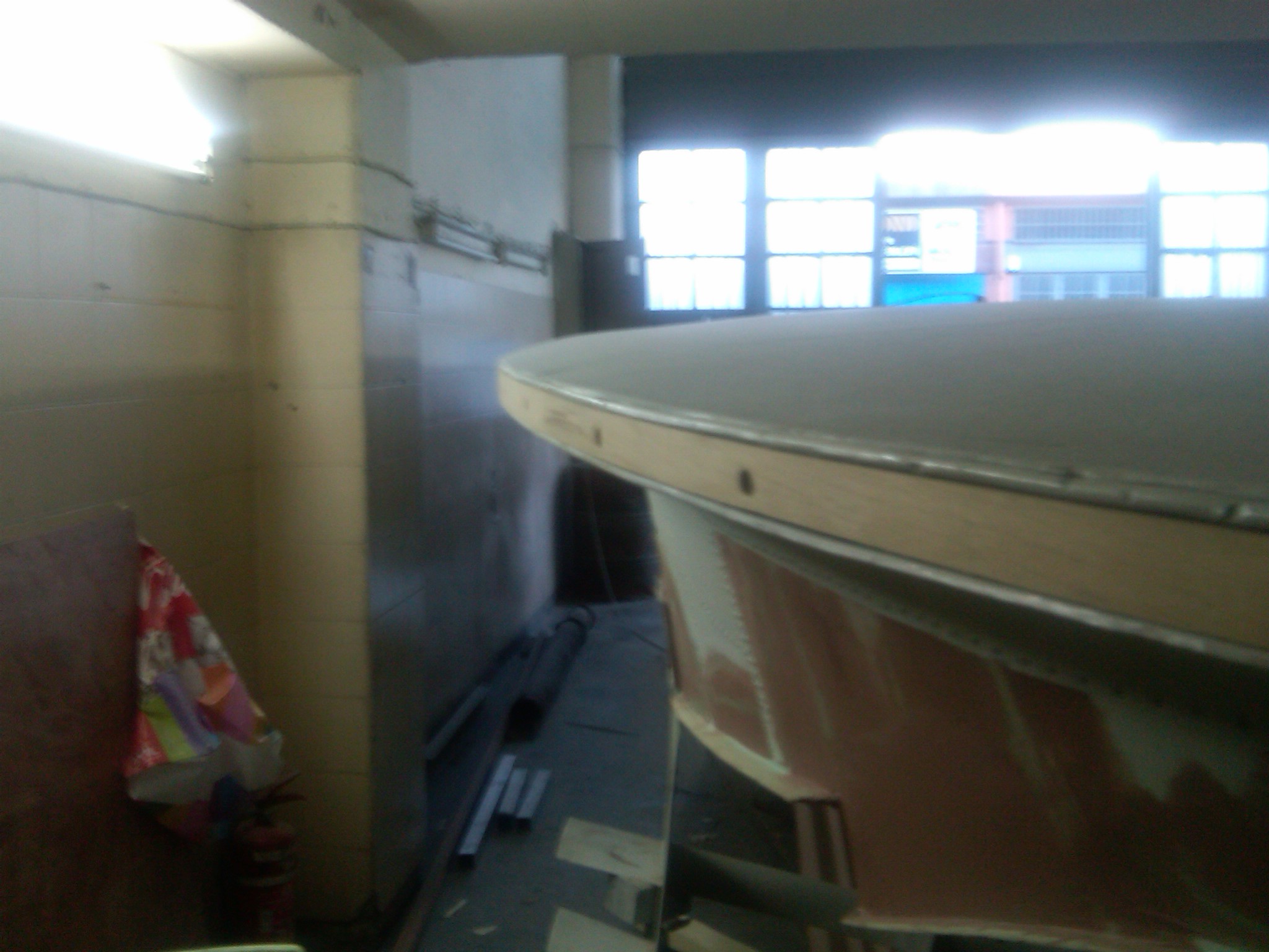

There was no other way than painting and mending the deck.
The guy who repaired the bumps on the hull did not want to stress the hull too much as he feared the rivvets to crack.
Hull cleaning took some time and was all done by hand (soda blasting was not available)
He wanted to fill remaining gaps with mastic. Another option would have been to cover the boats deck like some other Volga owners did. Now Volgas have a rather flat deck compared to other contemporary wooden boats and according to me this can in some cases look like glueing a table on deck.

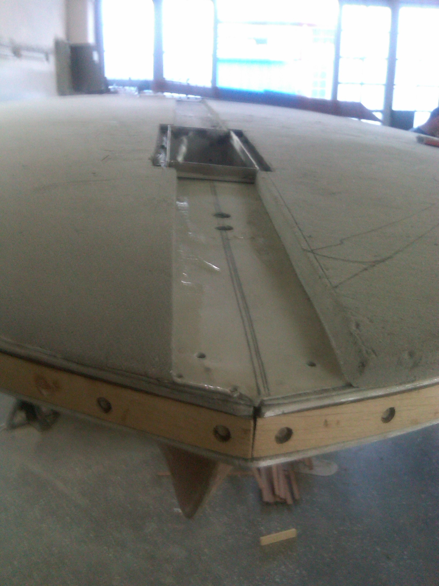

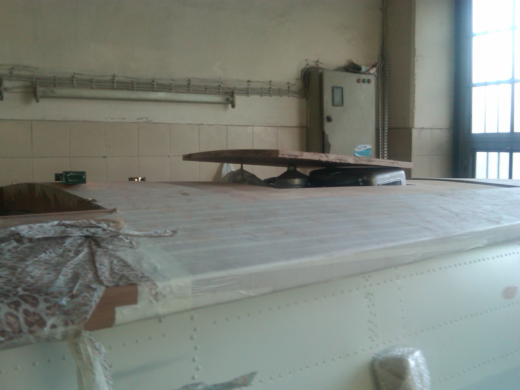

In the istanbul boatshow fair I ran into a boot/fair, which was selling superlight PVC hardfoam sheets, which can be glued on the hull with epoxy resin and later easily shaped by sanding. The material is extremely hard against impacts and superlight. It is extremely easy to shape and when used together with epoxy and glassfibre or fabric it becomes even more resistant. I bought 20 mm thick sheets glued them on deck with 2K epoxy resin,
Sheets glued on an cut.

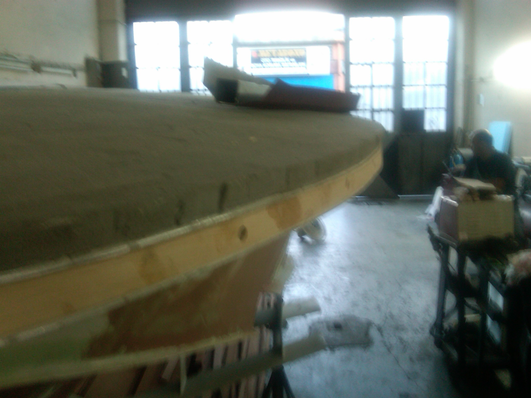

cut away the edges and rounded them with sandpaper
Sanded and rounded
Sanded and rounded

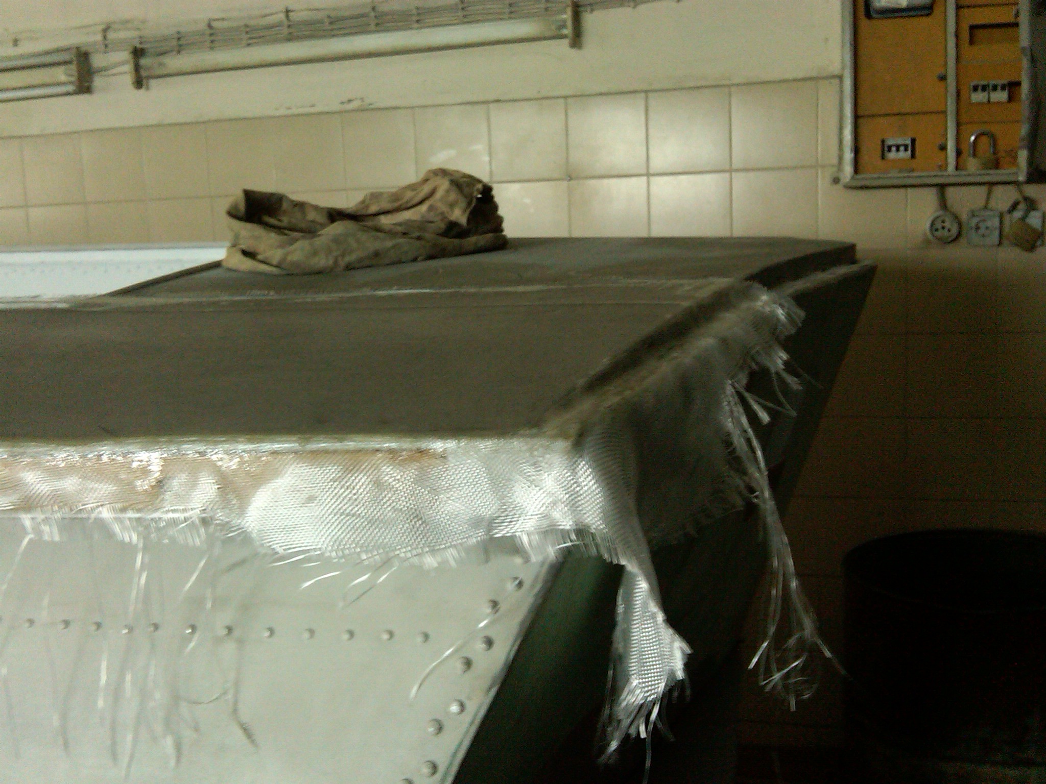

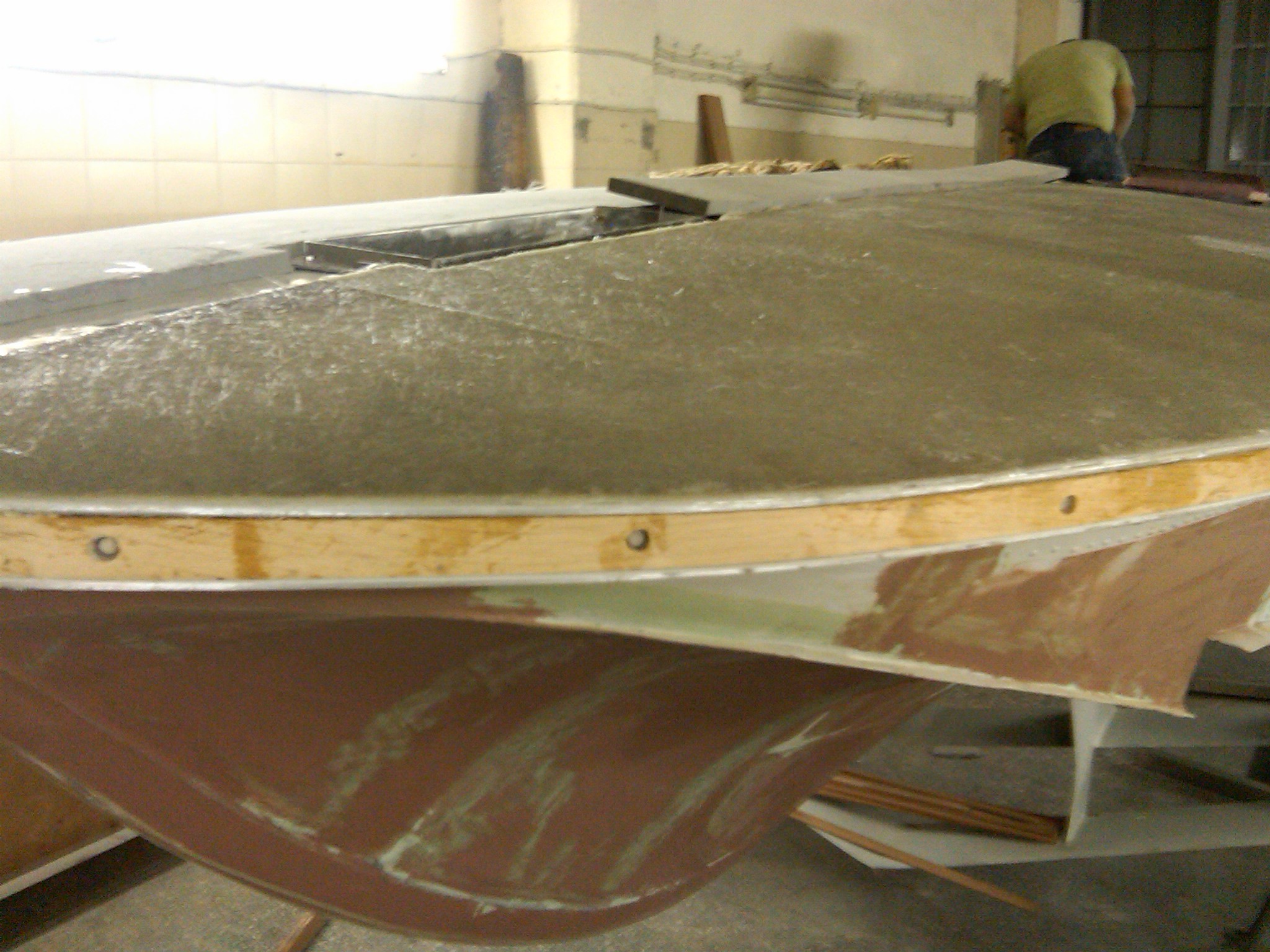

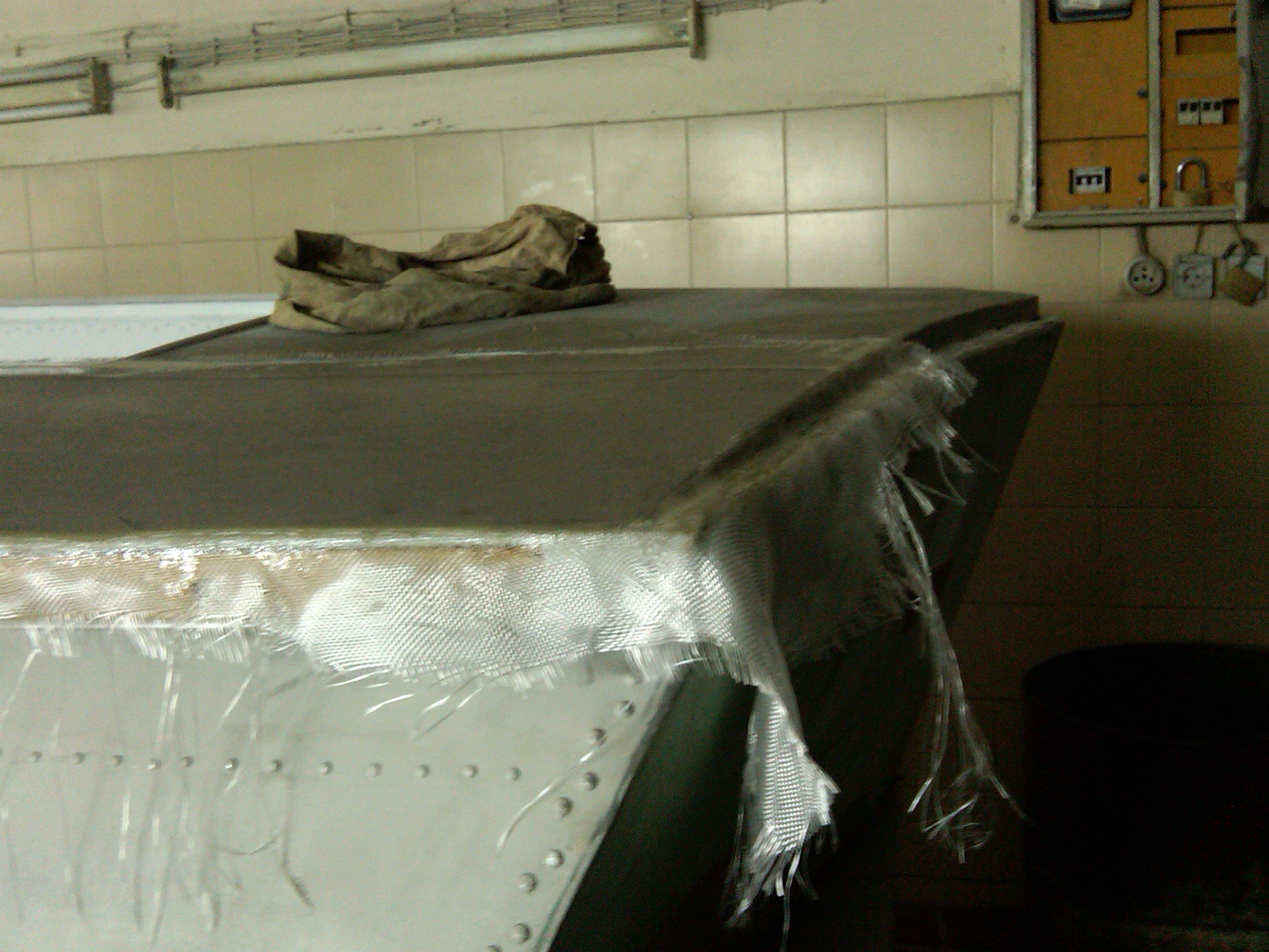

. Later on we applied on the top one more layer with fabric,
White wedding
White wedding
fibreglass
Fiberglass cover
Fiberglass cover
and epoxy resin. This was then also sanded. The deck was now completely even, 22 - 25 mm higher than original and with a rounder shape.
Difference between sanded and unsanded
The sheets where so firm and robust that they did not show any deformation even when you were jumping on them.

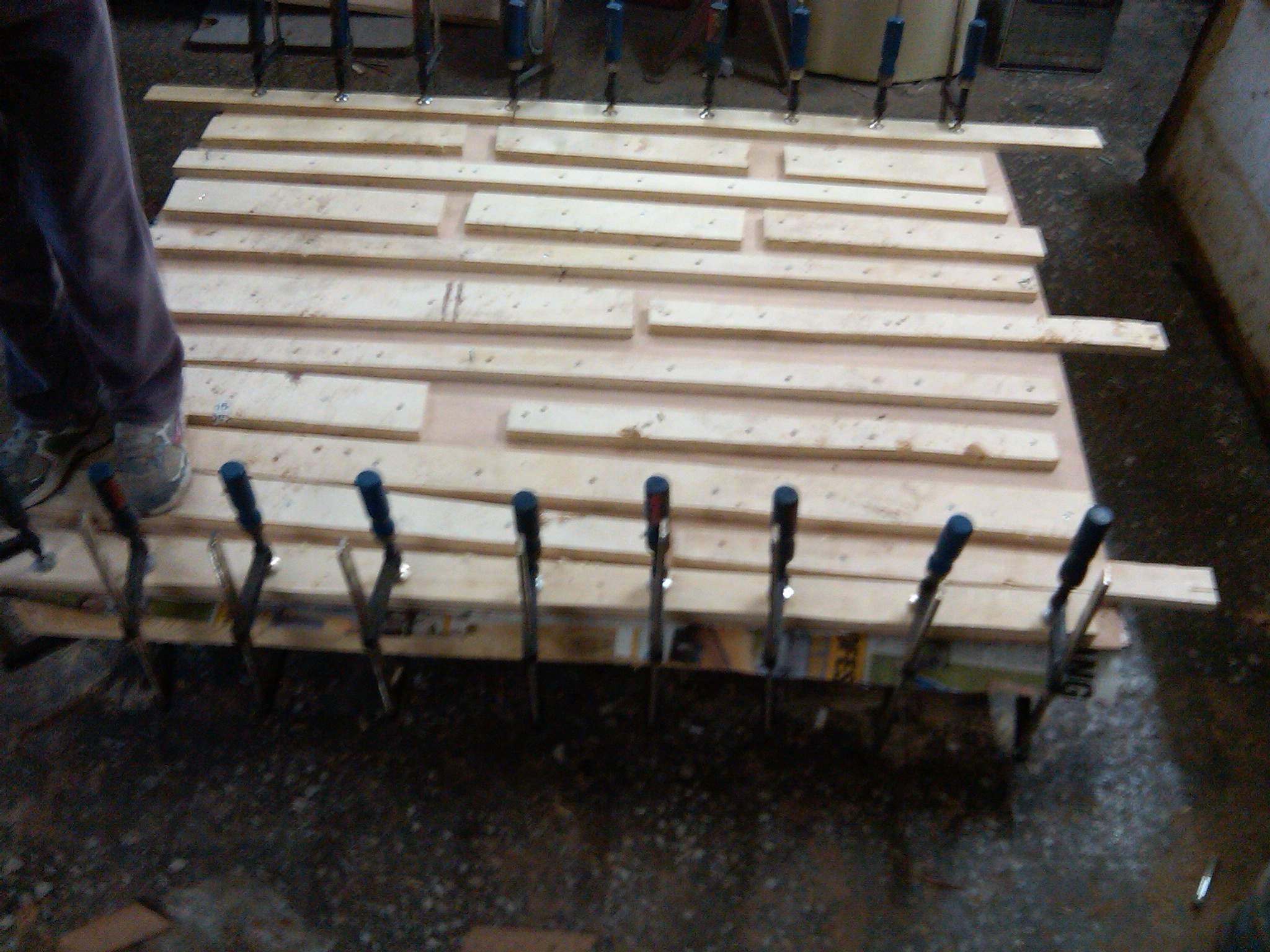

Everything was ready for Sika bonding of the wood. With the wood layers of 5 mm the deck will get taller by about 30 mm, which was also intended.
(Frankly speeking this could also have been done with ultralight marine plywood and the result and sturdiness would have been probably better than of this material. The rounding effect for itself was not significant. I didn't want to exagurate it.)

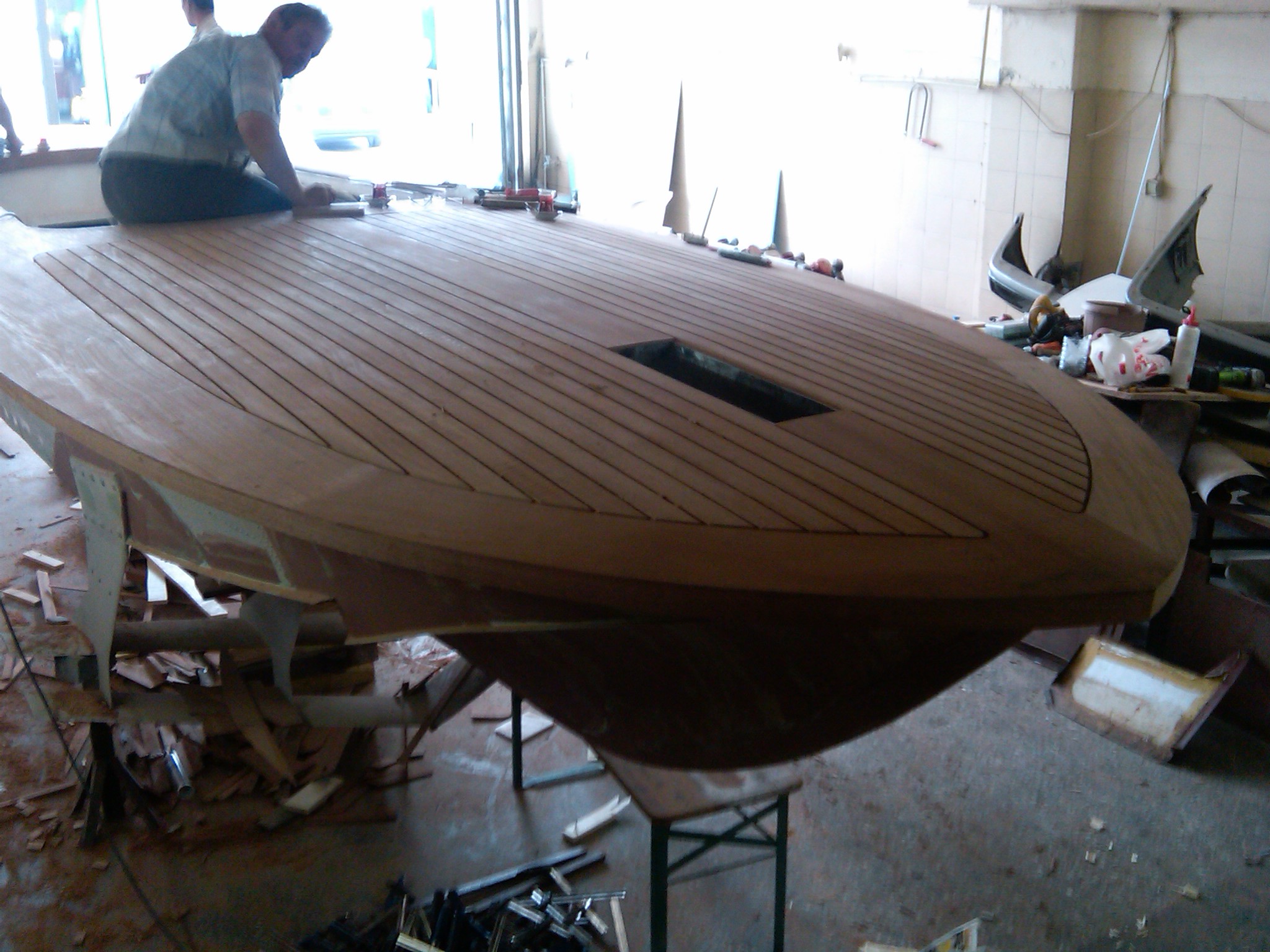

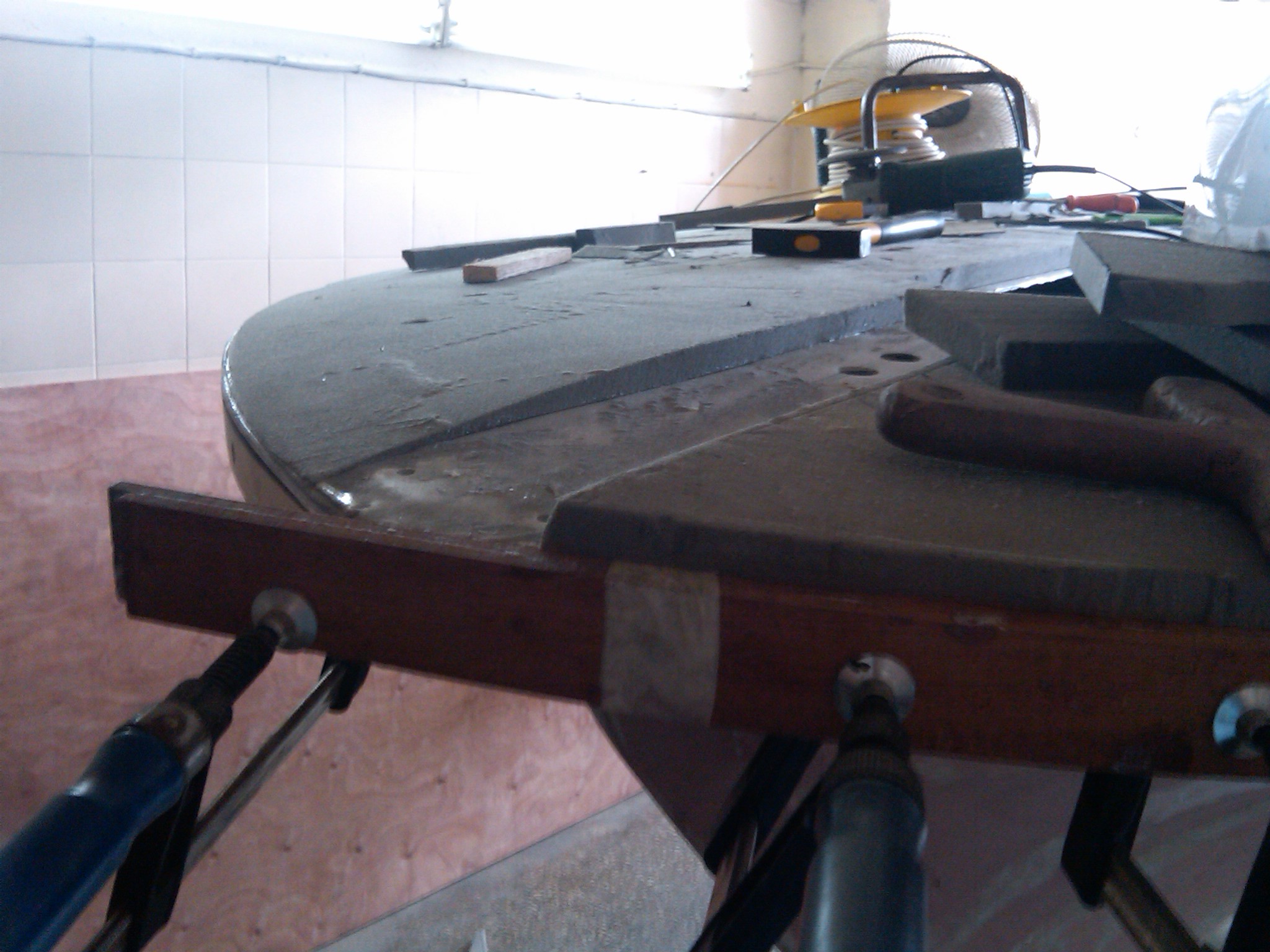

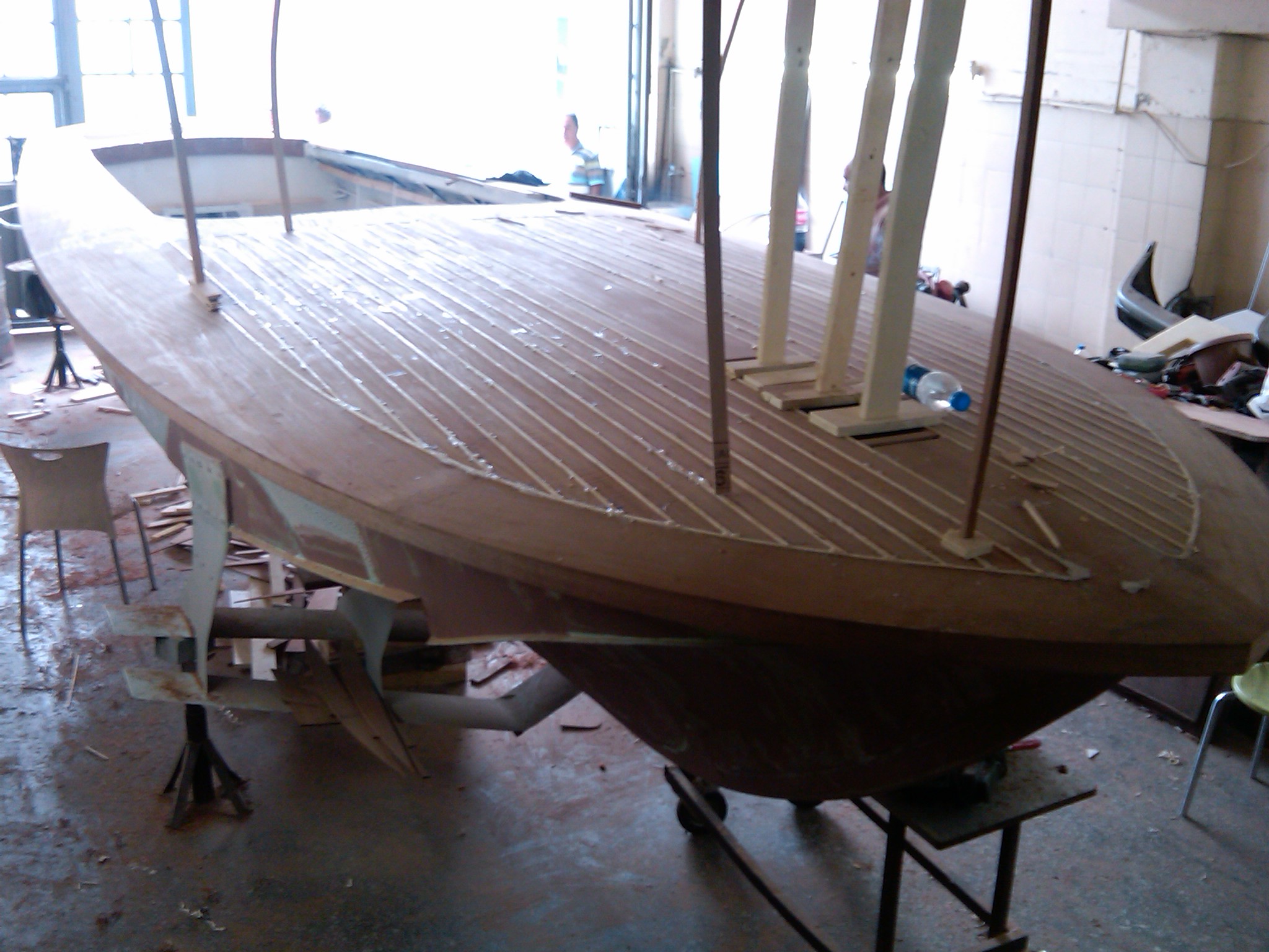

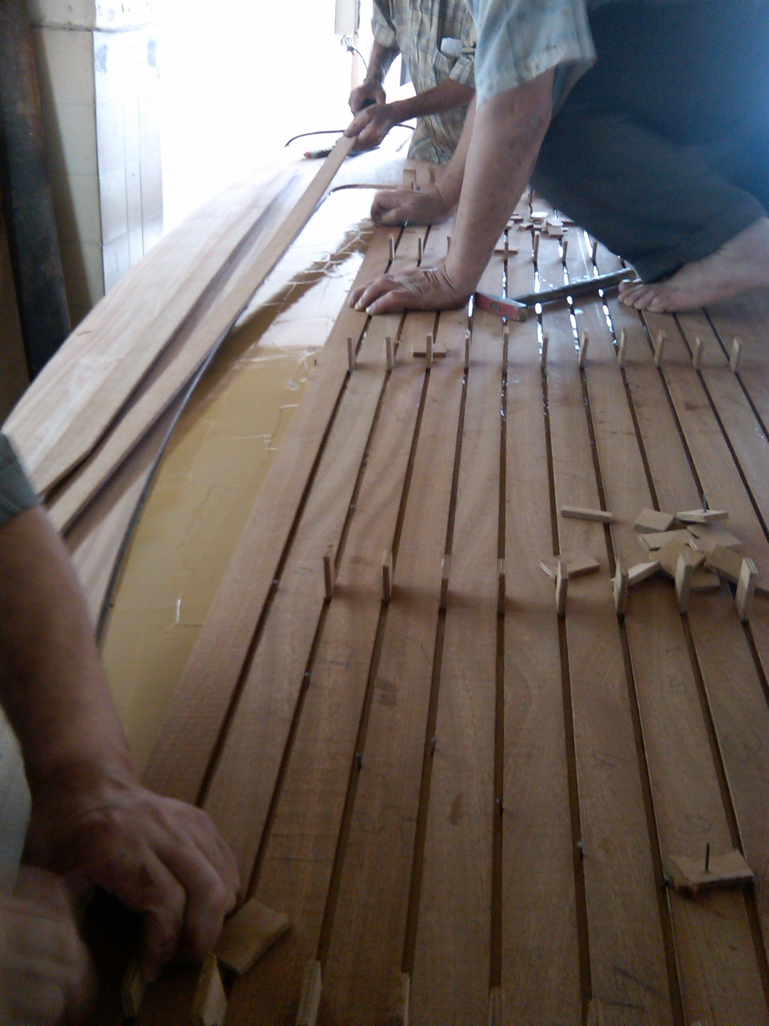

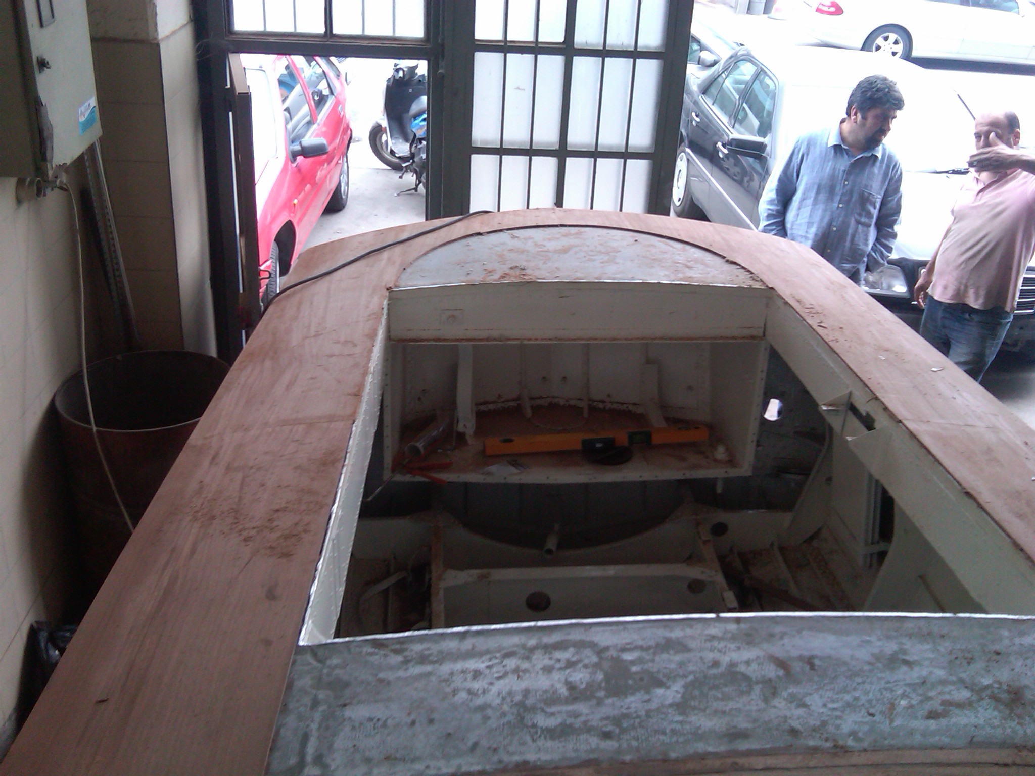

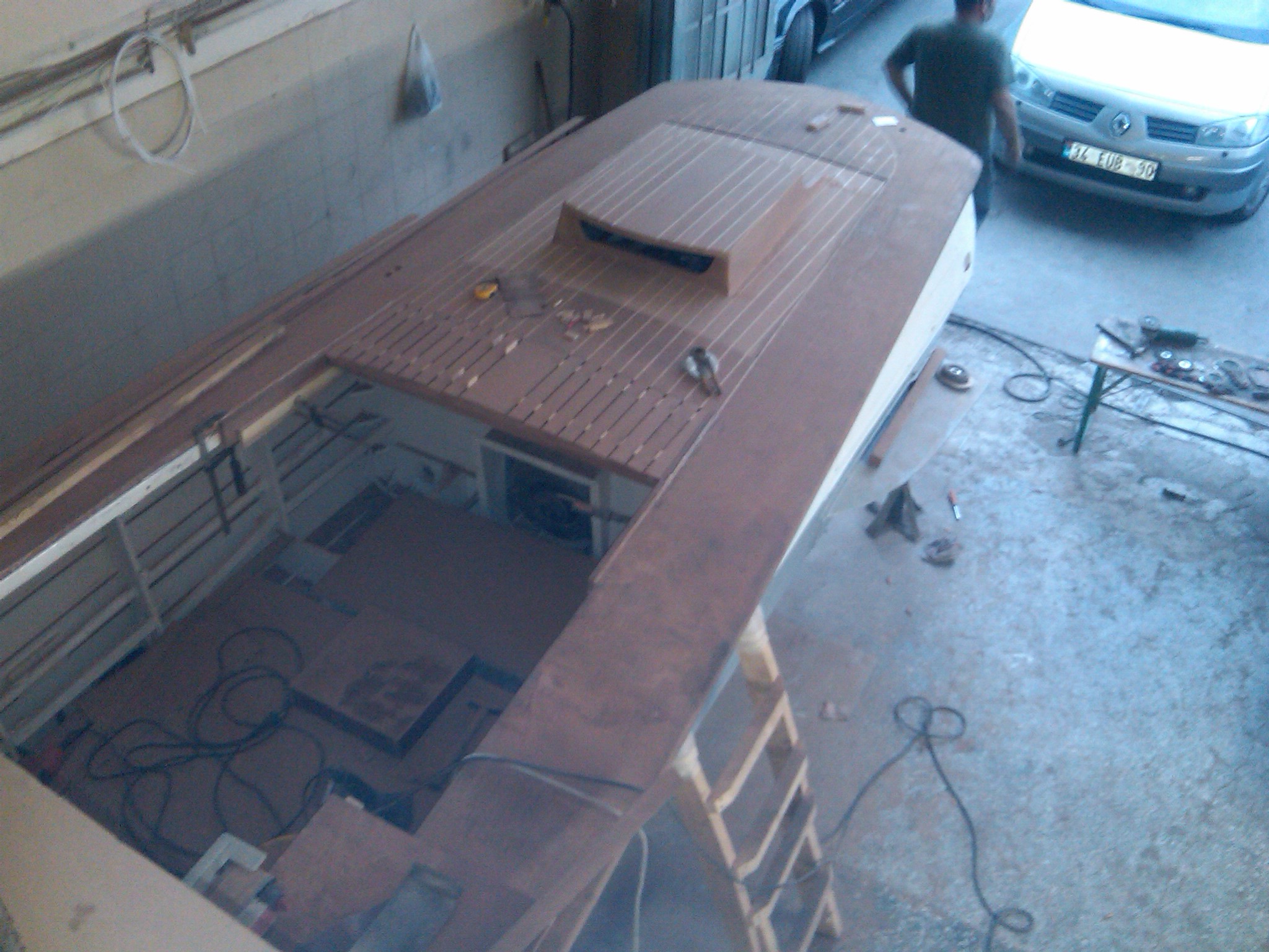

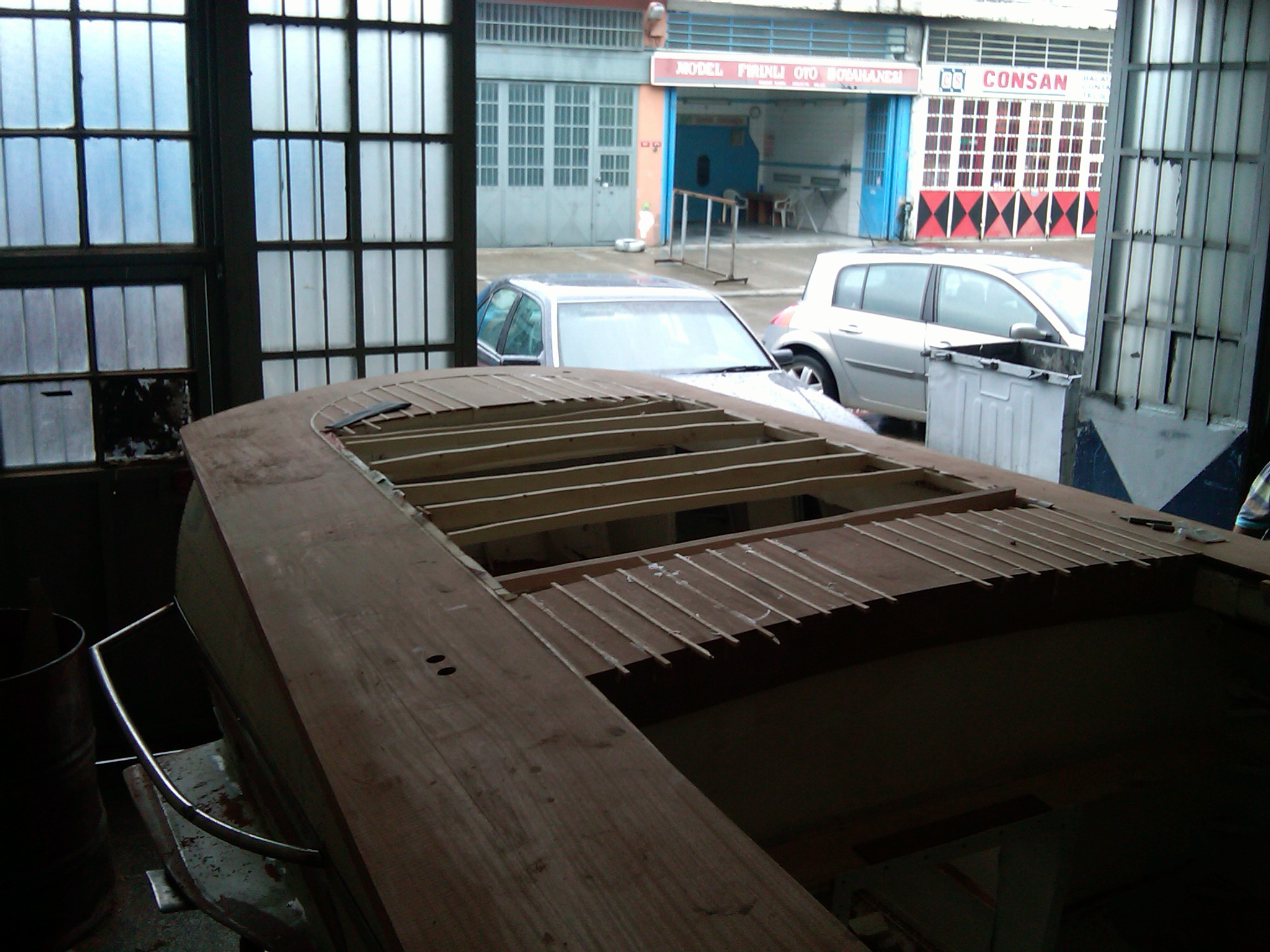

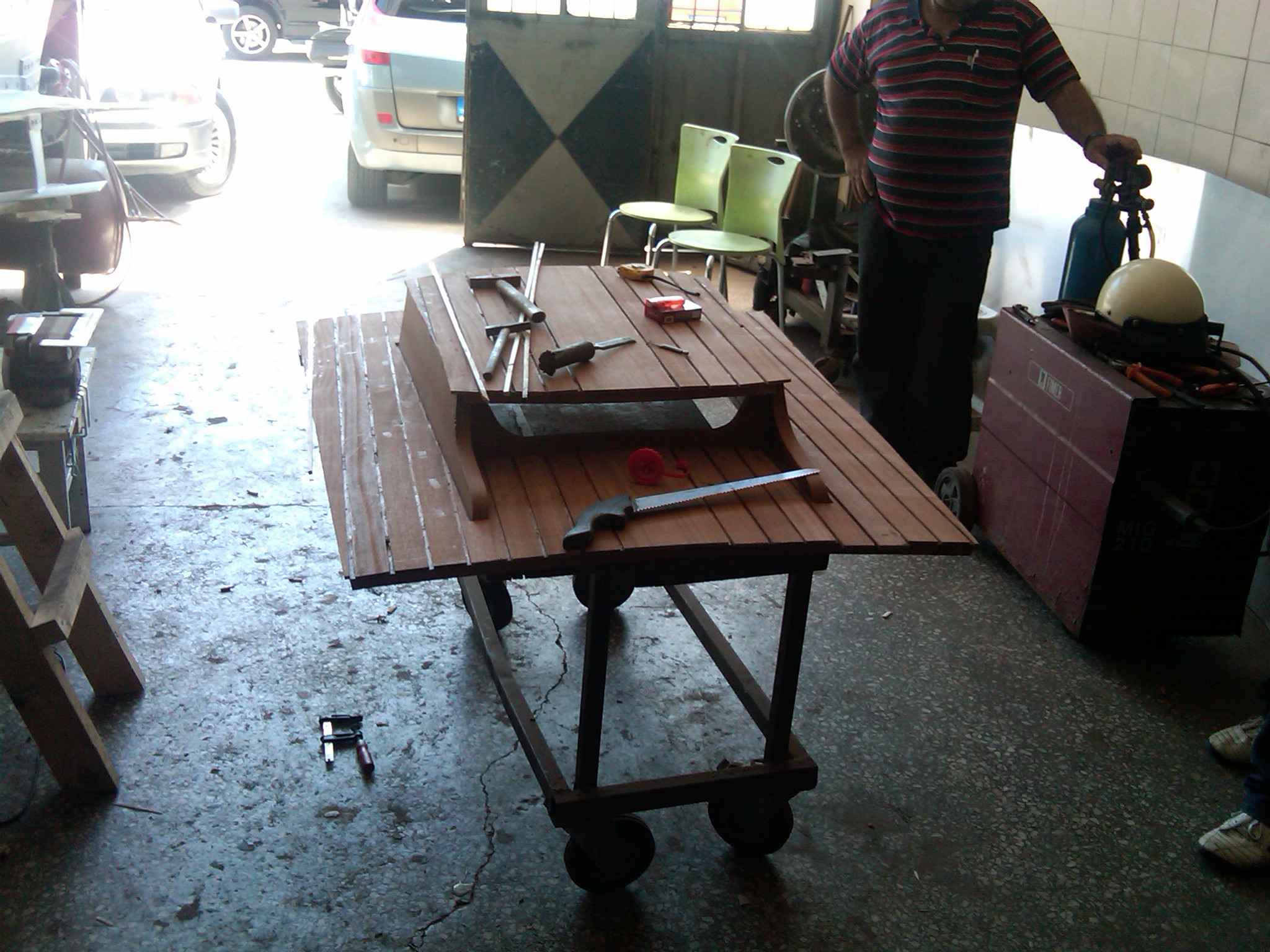

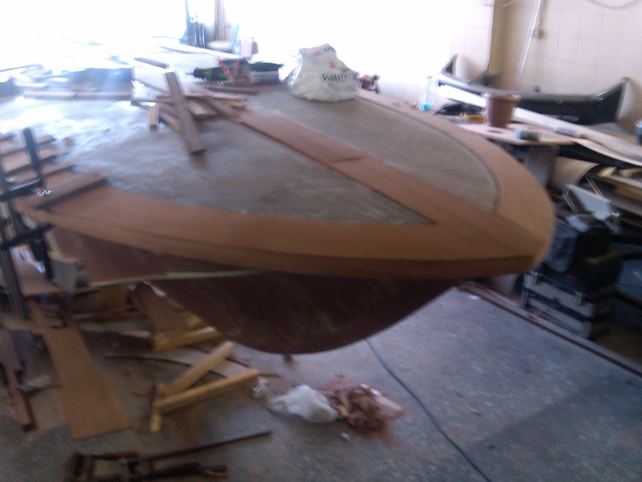

The wooden deck design was copied and/or refined from other Volgas or Rivas. We started with the edges where there used to be the rub rails.
Wooden rail
Wooden rail

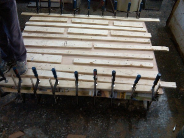

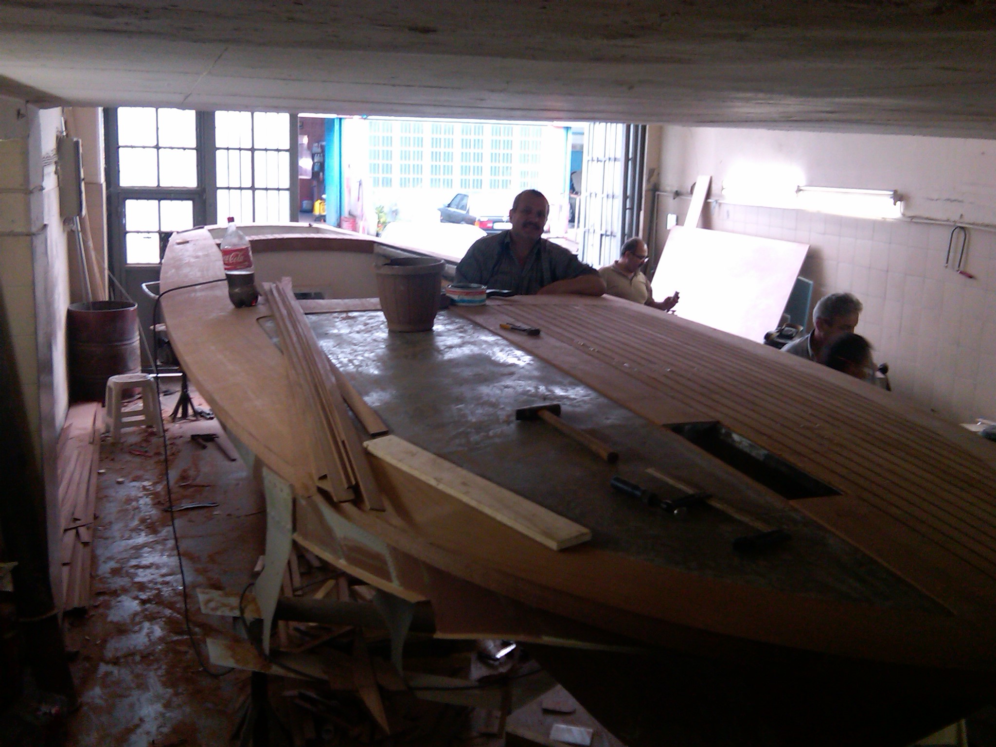

Later on we made the sides and the middle for the frame.
Wood applied on deck
Middle beam with anchor hadge

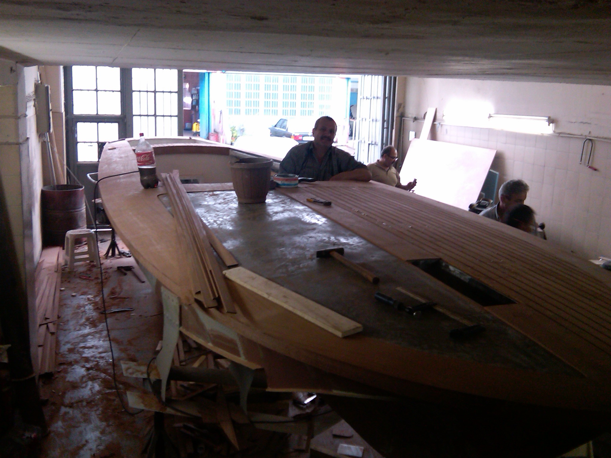

The wood was applied in such way, that all parts had the width.
Width control
Width control

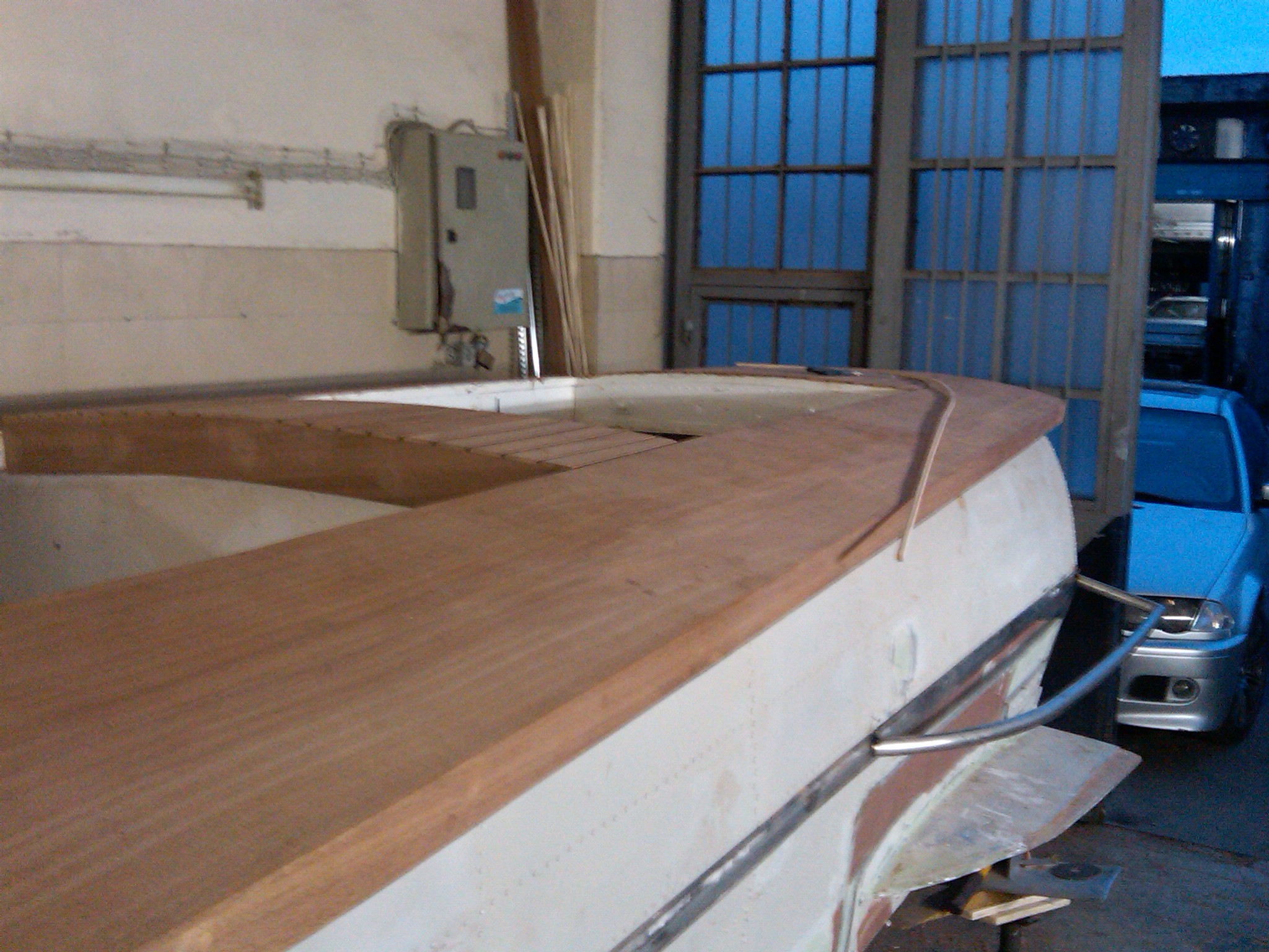

The sides of the cockpit were rounded, too.
Front view ''wooded''

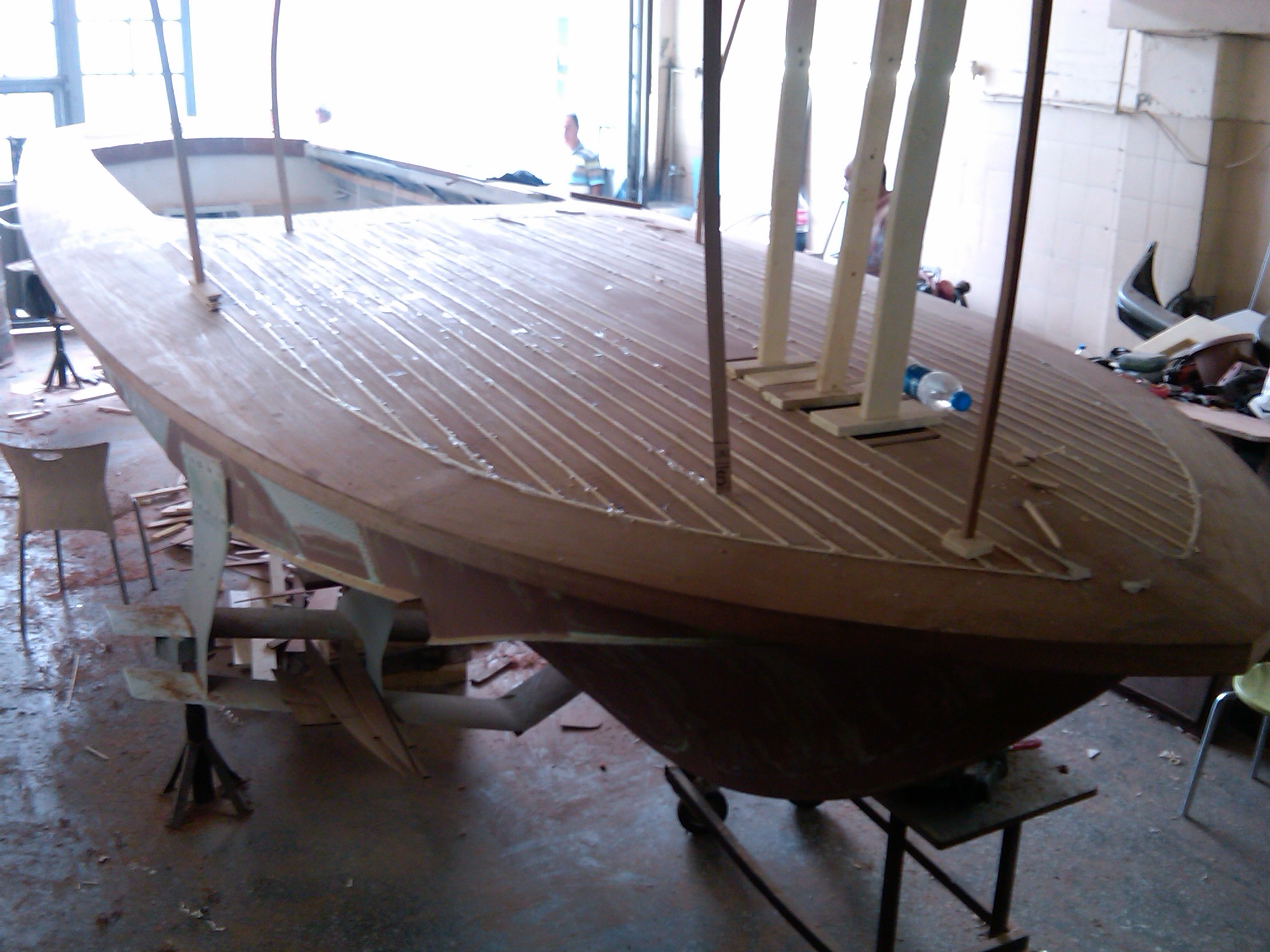

Back wooded
Back wooded

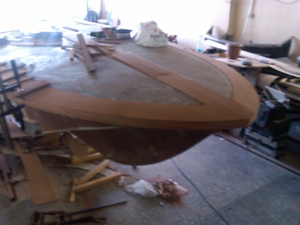

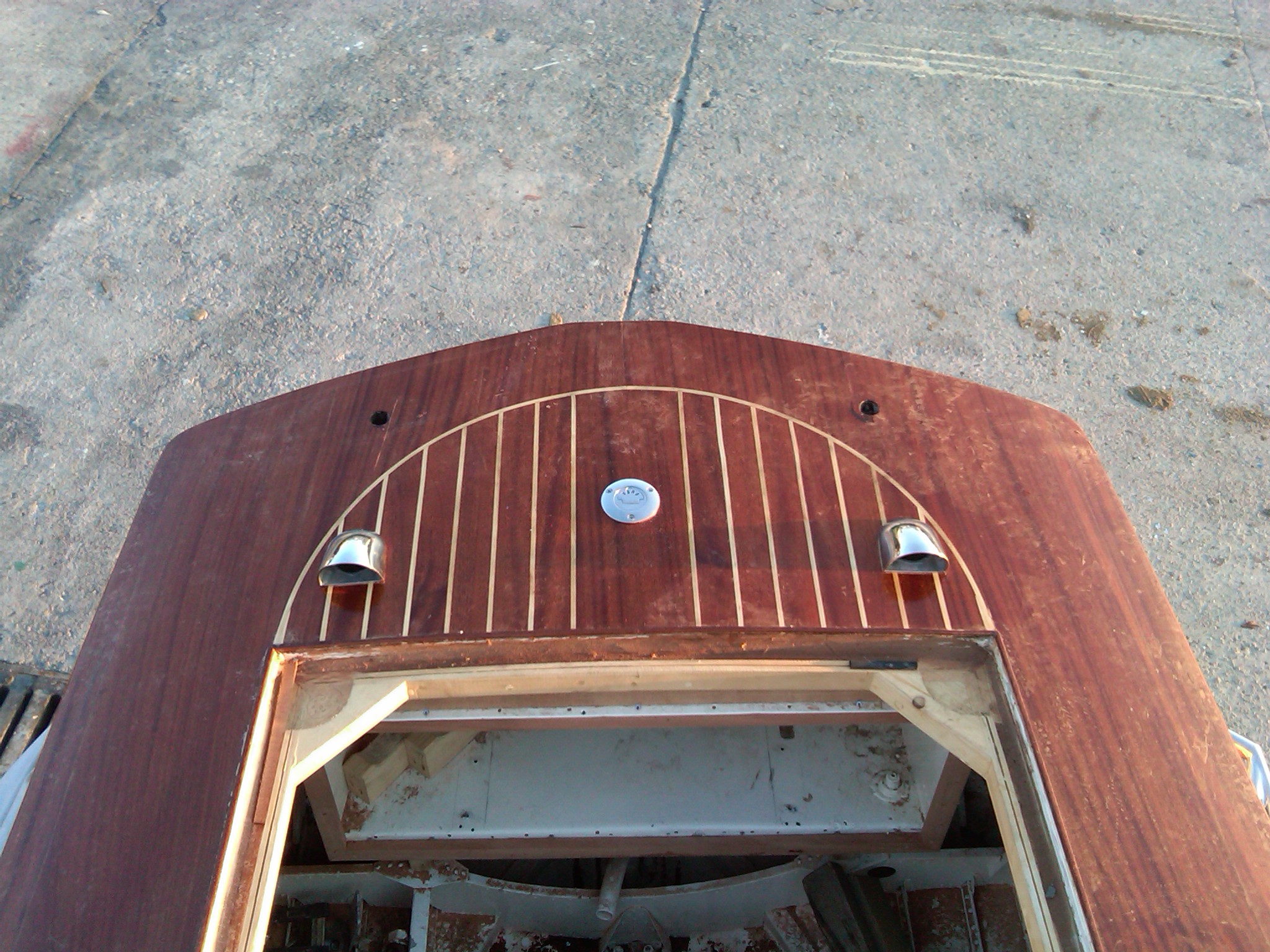

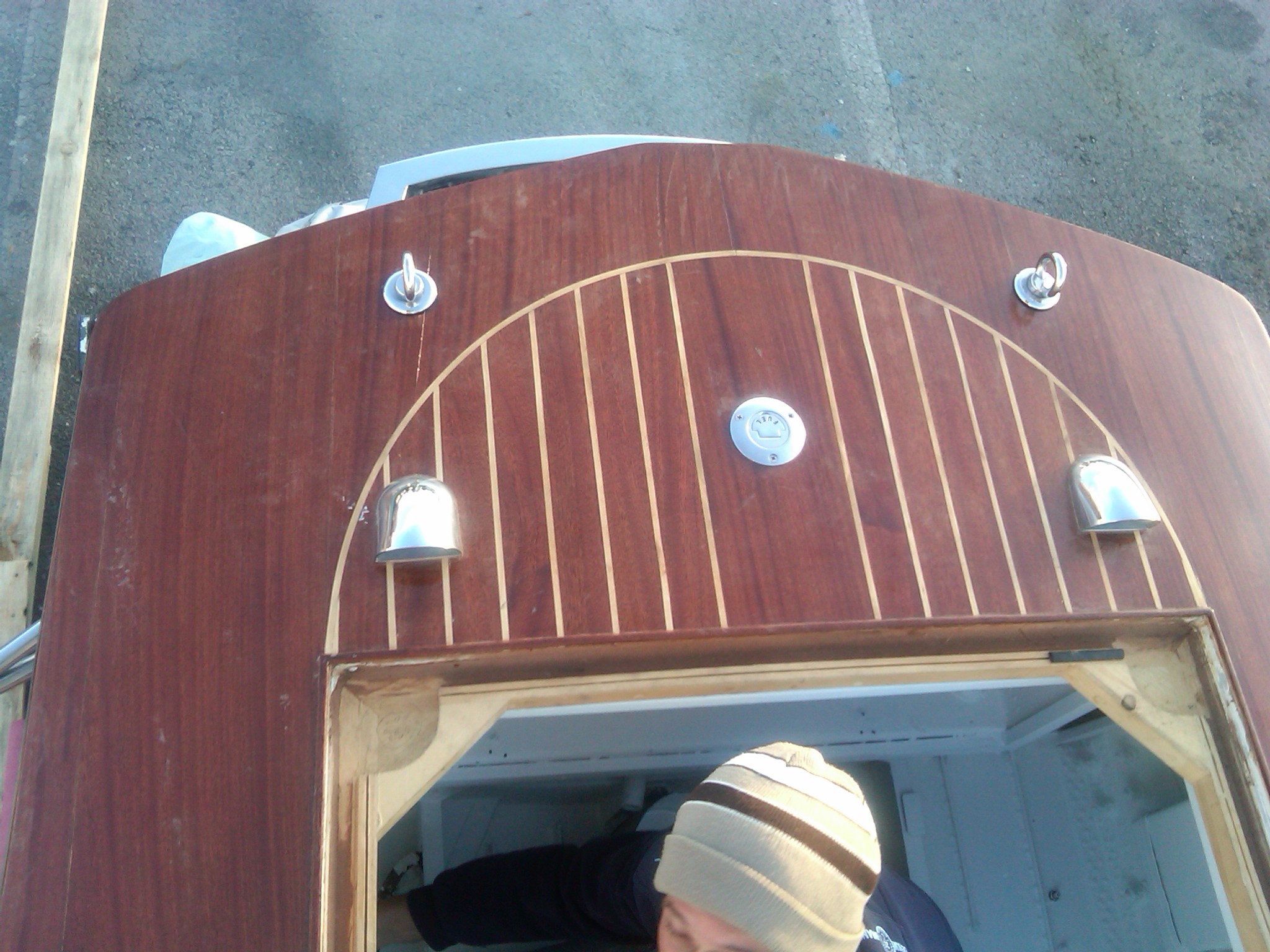

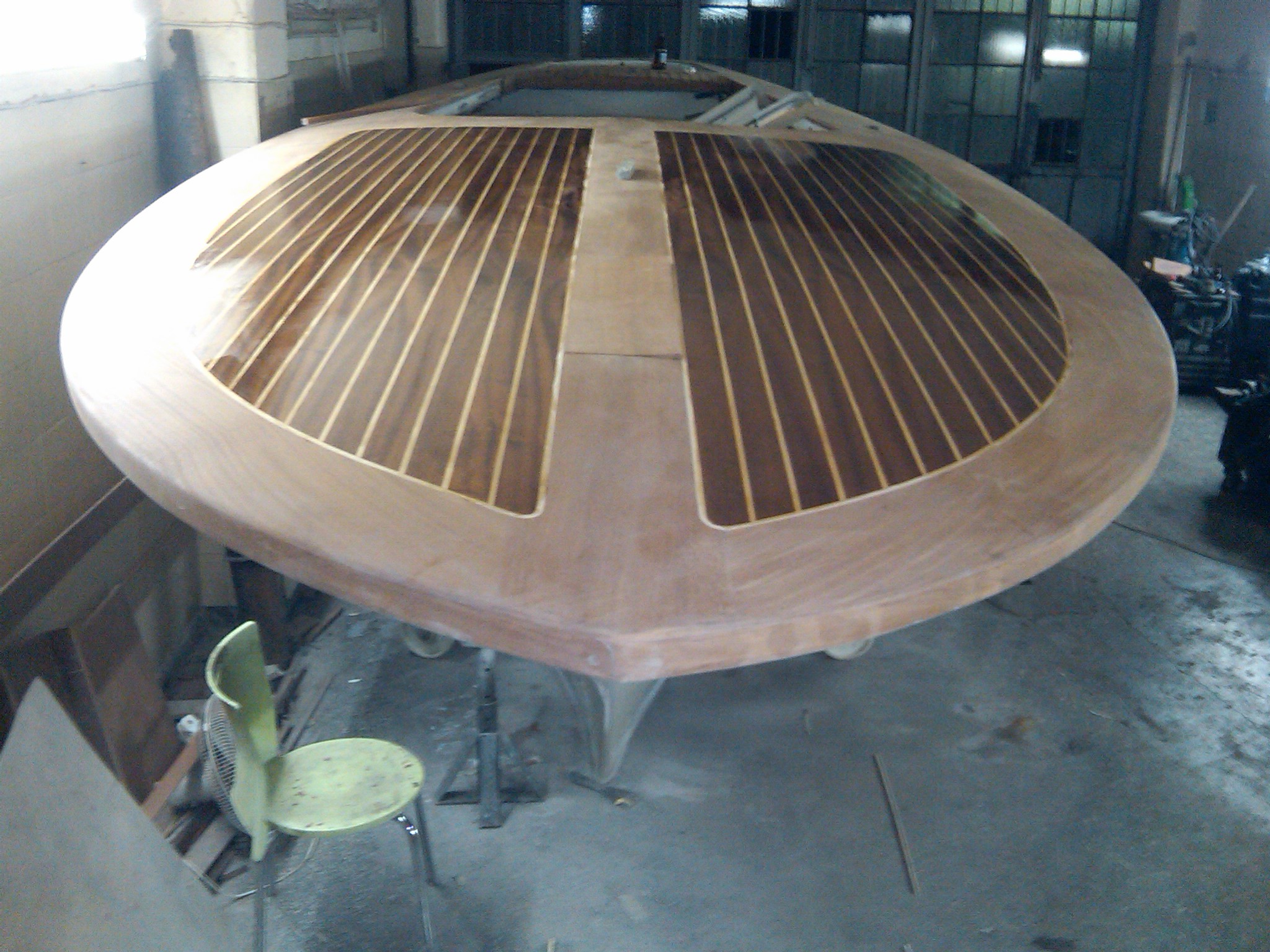

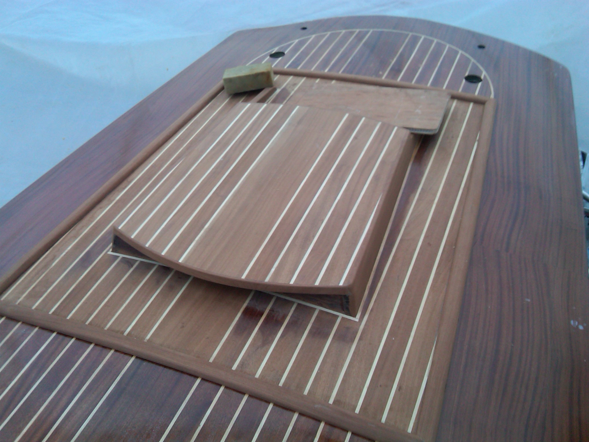

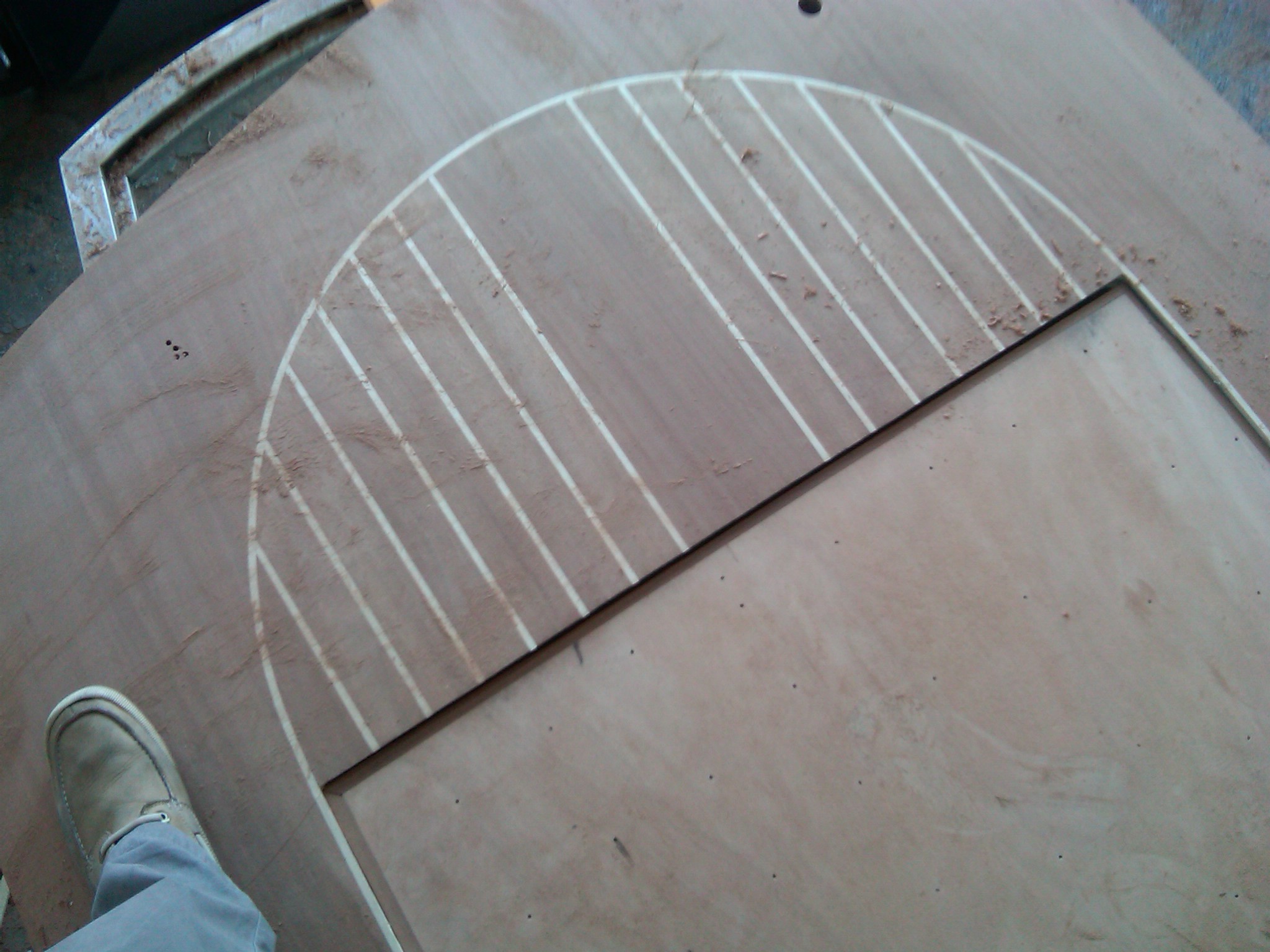

We then inserted white wood between the mahagony.
White wood between at the bow
White wood at stern glued-in

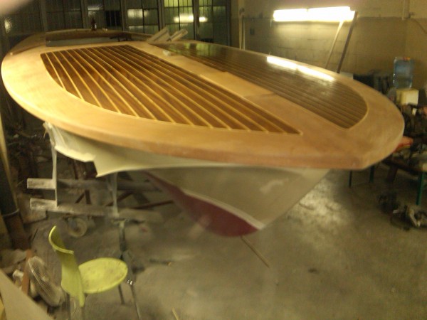

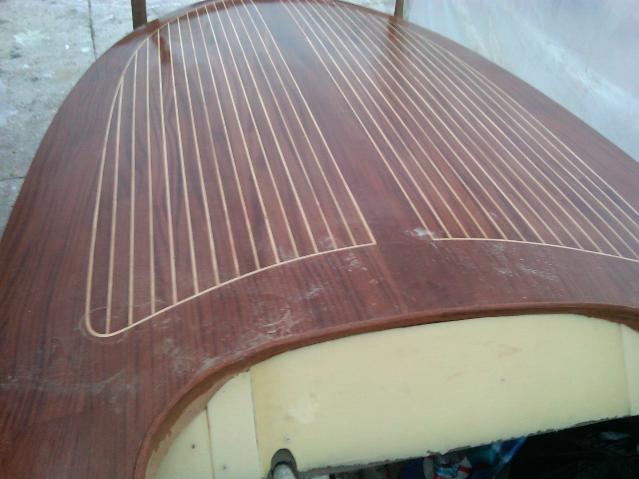

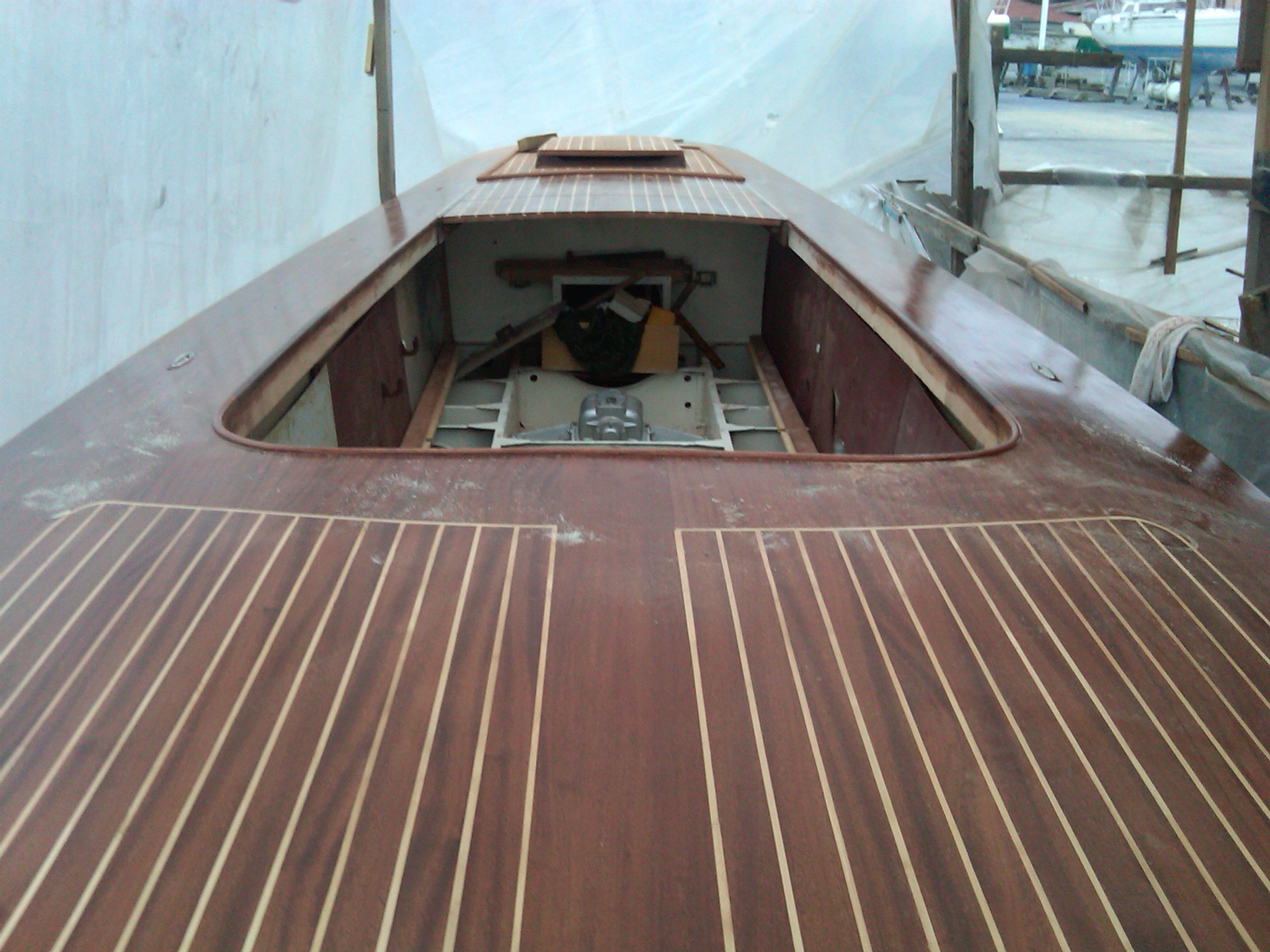

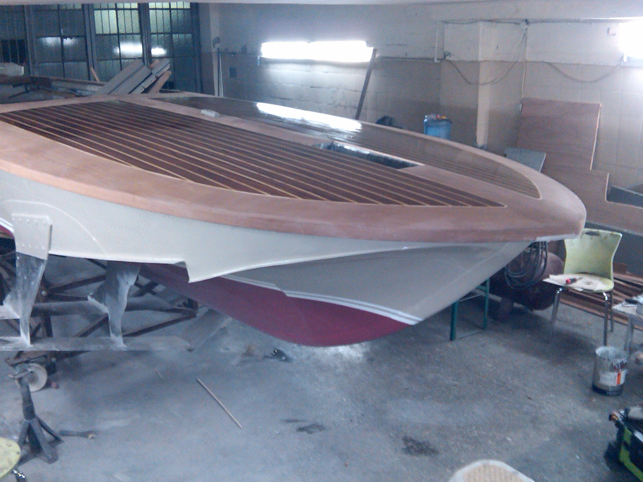

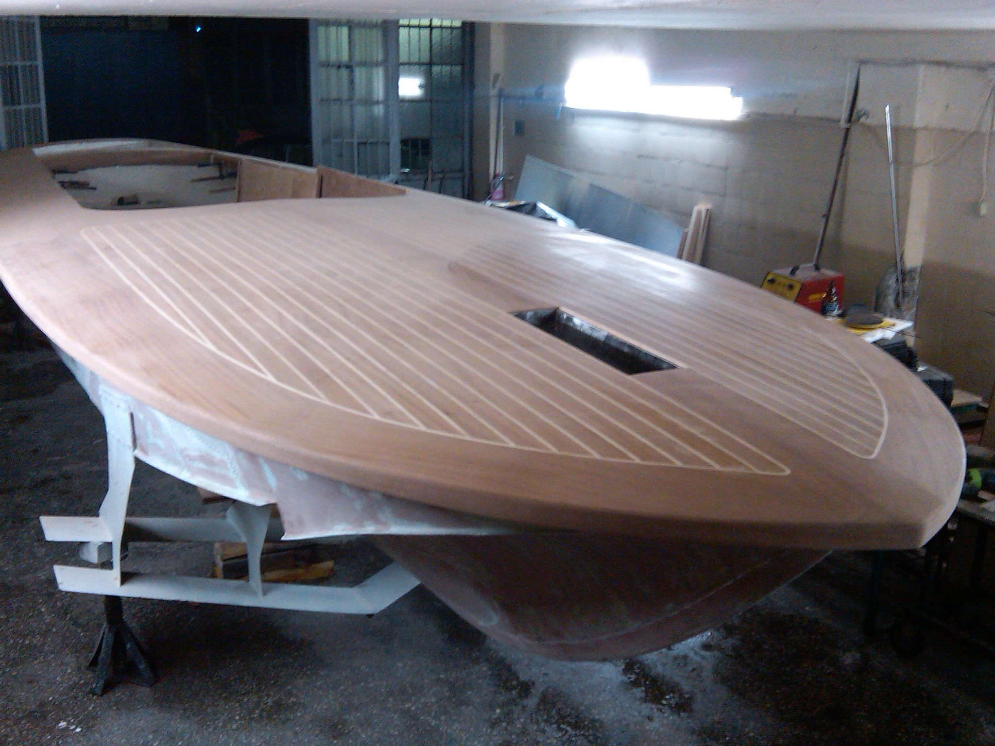

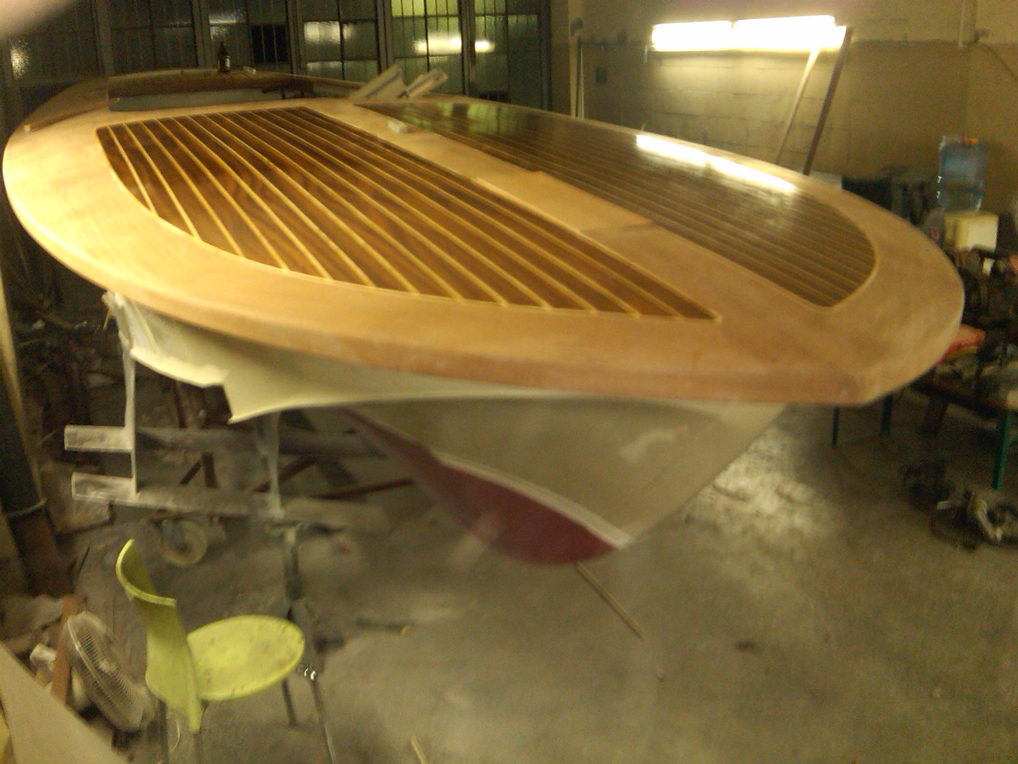

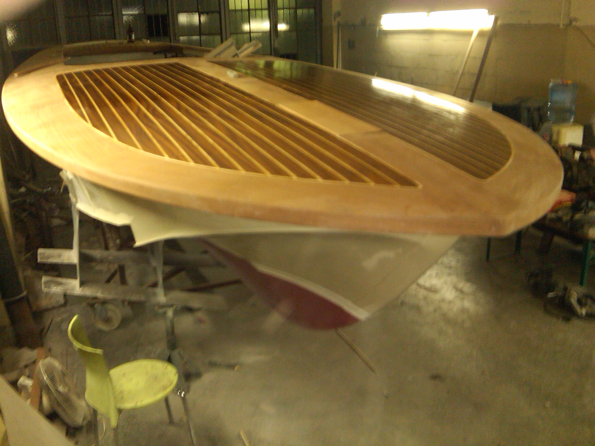

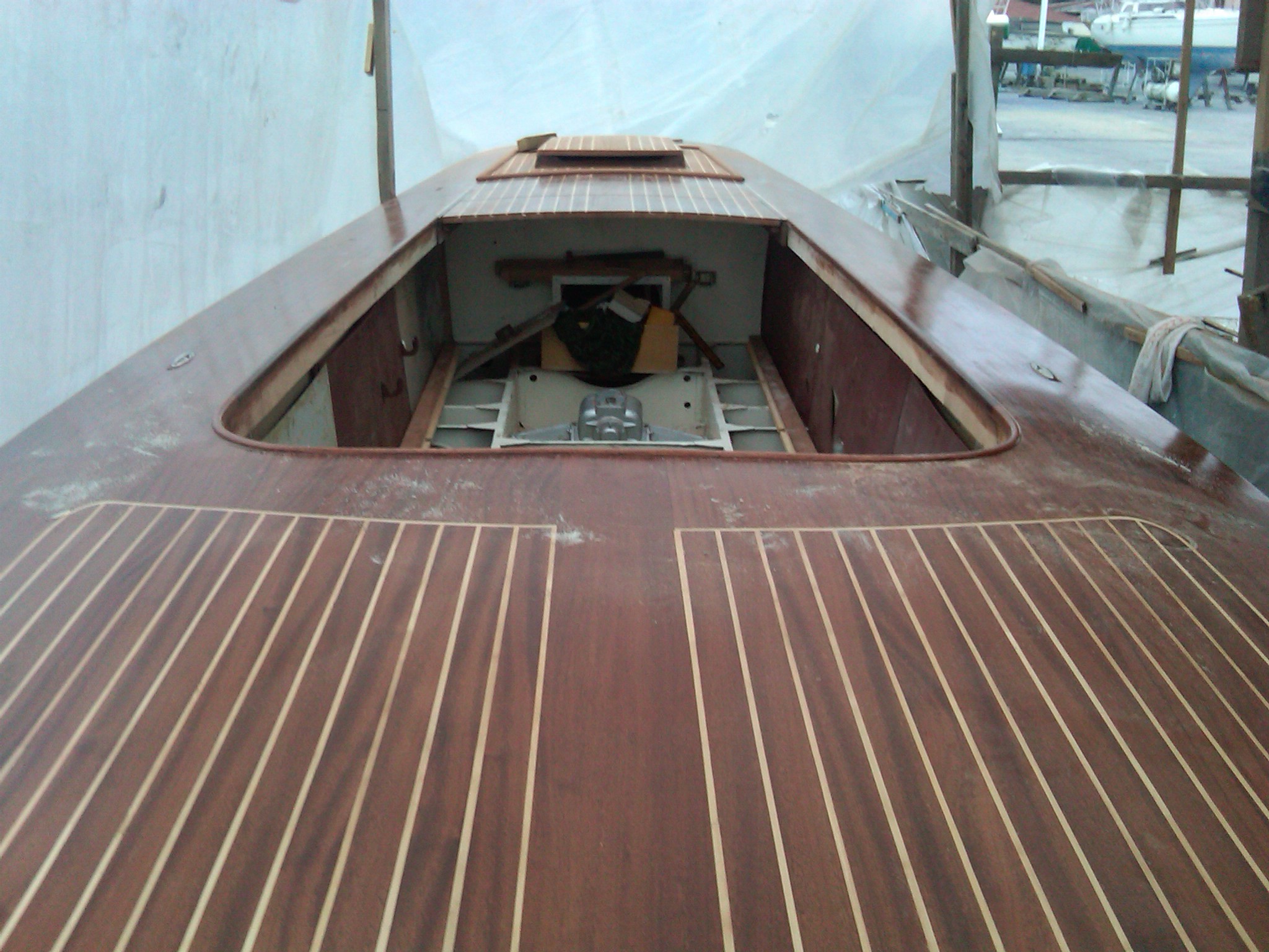

After sanding the front this is what revealed itself:
Bow wood sanded.
Bow wood sanded.
Stern sanded
Stern sanded

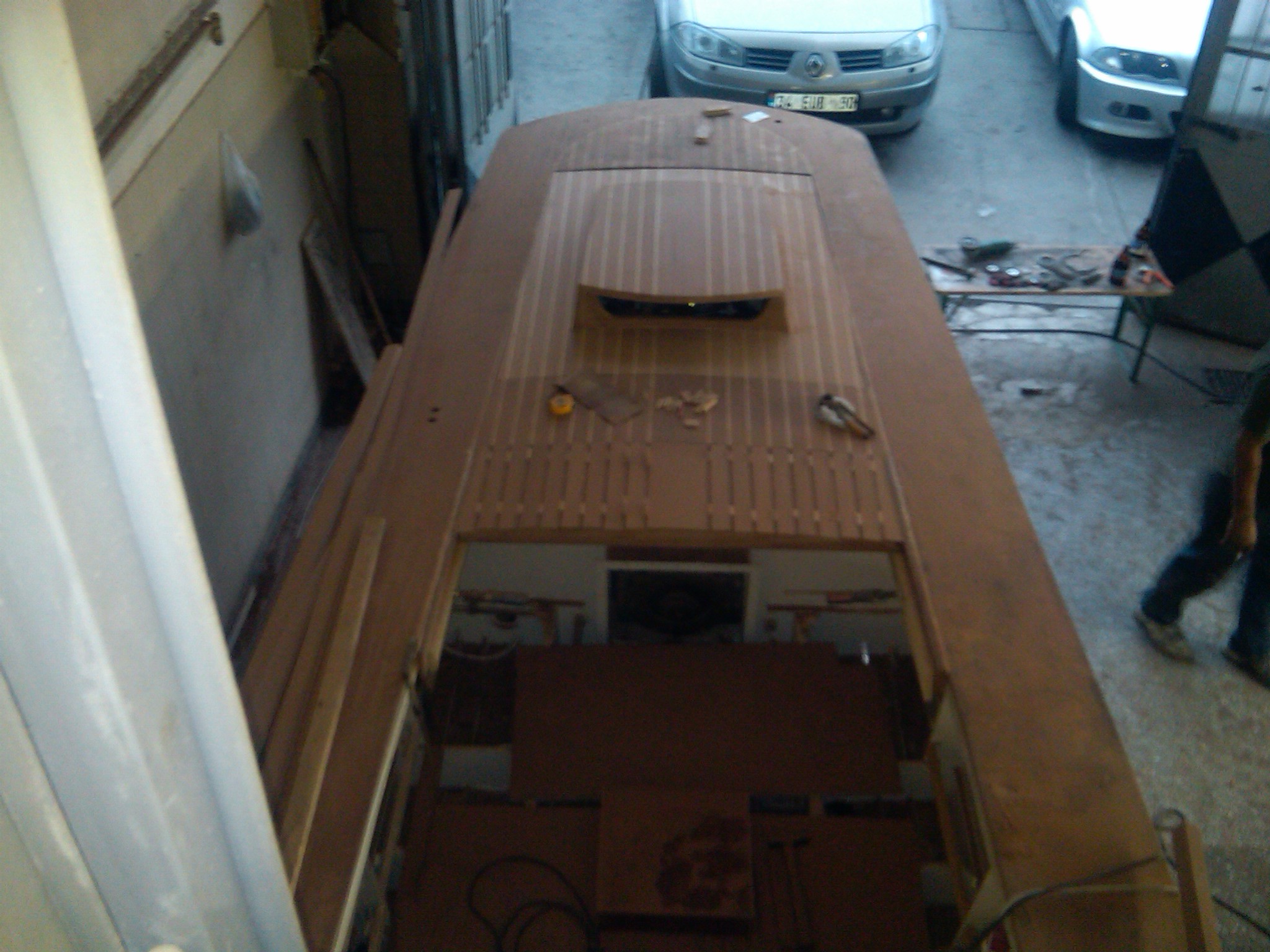

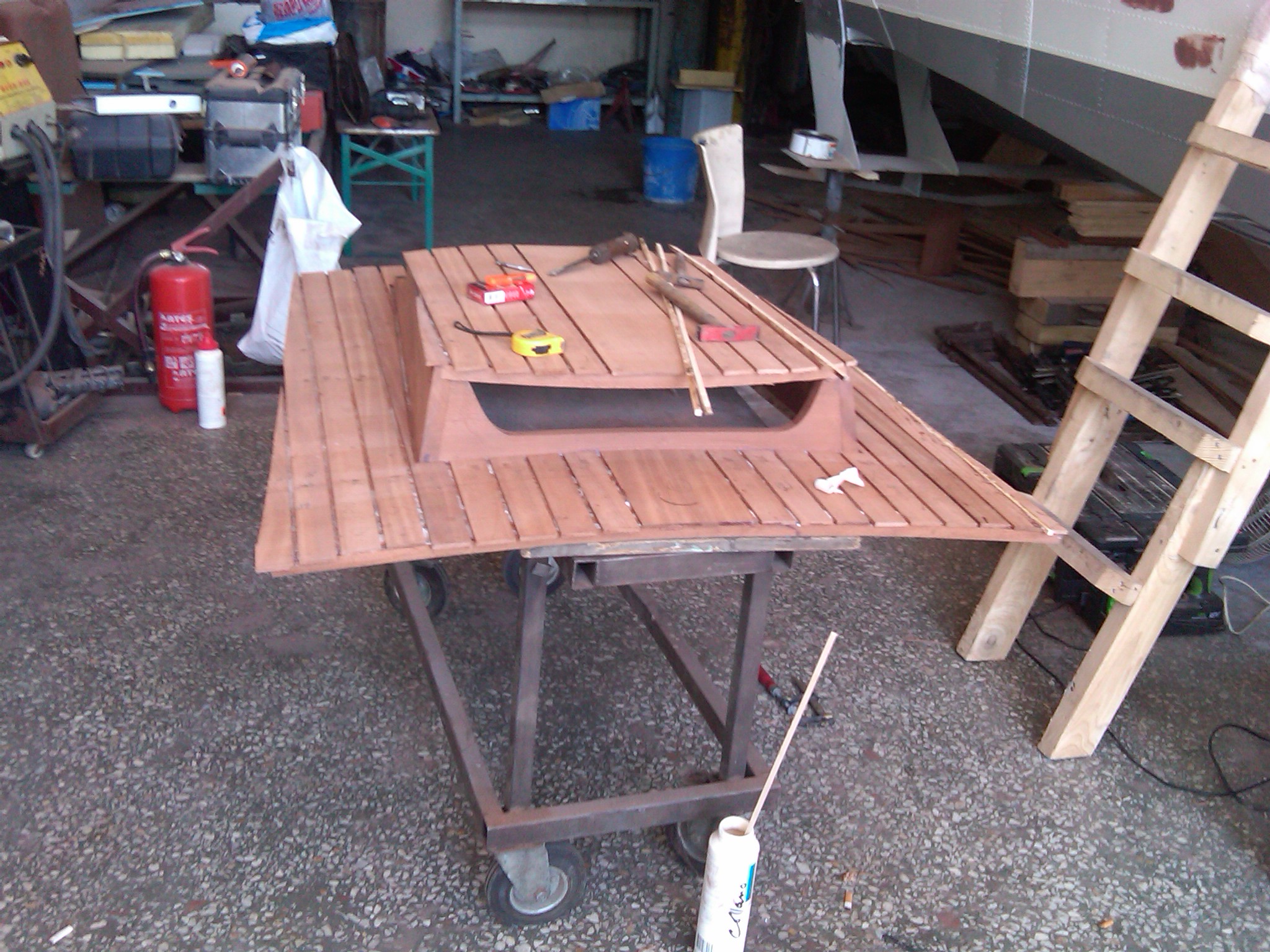

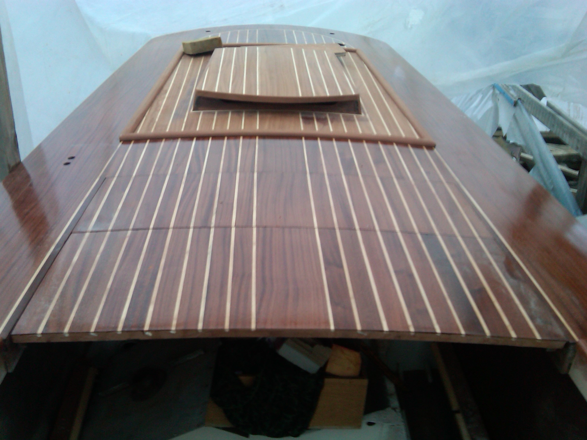

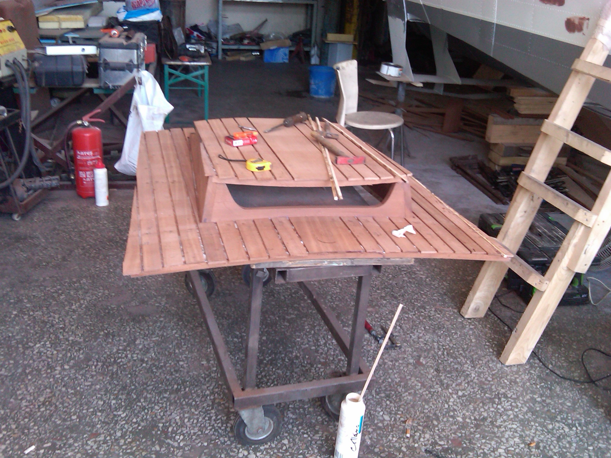

Lamination of the engine room hatch
Lamination of the engine room hood
Fitting of it
fitted without wood yet

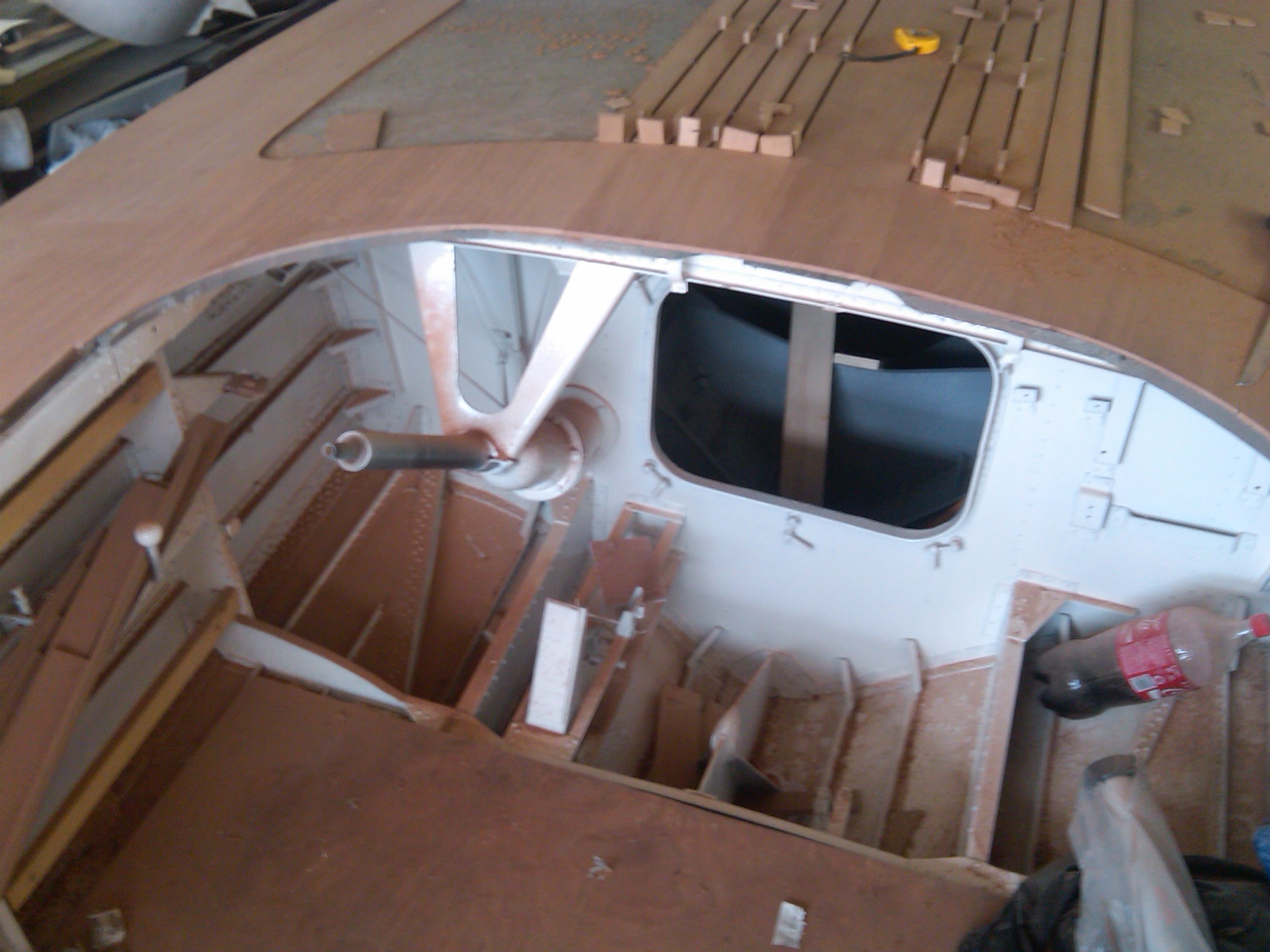

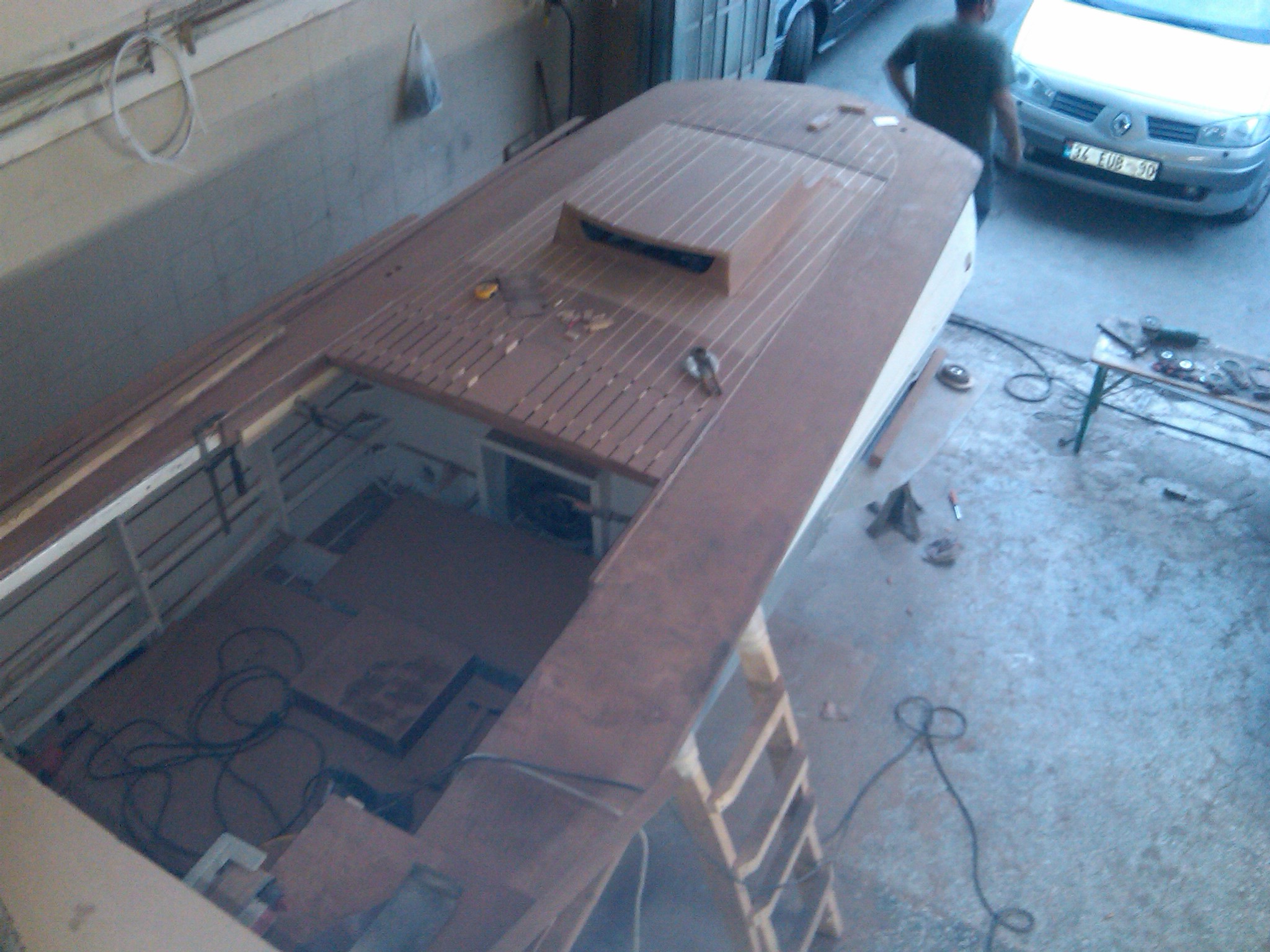

Although we have shortened some components on the engine like filter and decreased height of water tank, we had to make a cut-out for the engine.
Cut out for engine. For proper breathing of the engine room and engine we had to do it anyway.
To make a nicely shaped breathing hood will again be a challenge.
Re: Rounded top wooden deck

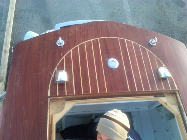

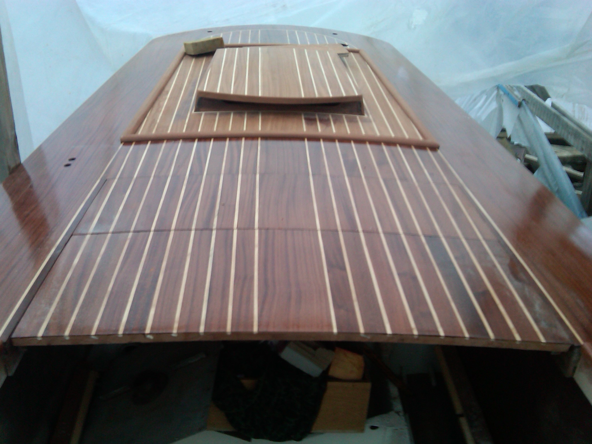

The piece cut out of the hood was then used as roof for the air inlet.

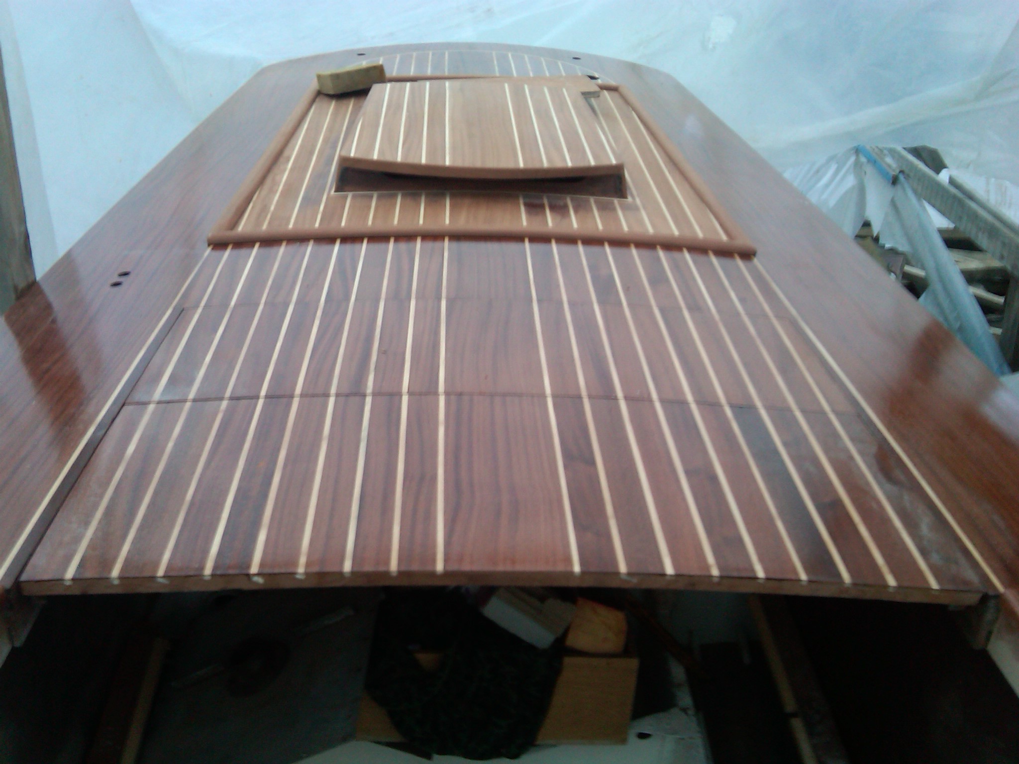

Hood was wooded with the same pattern like the deck.

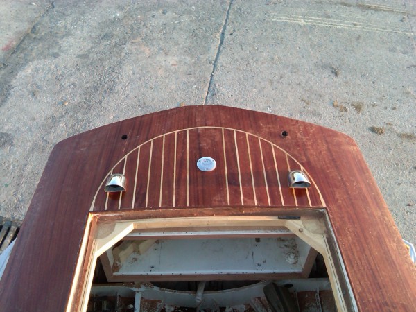

At the rear we made some prolongations.

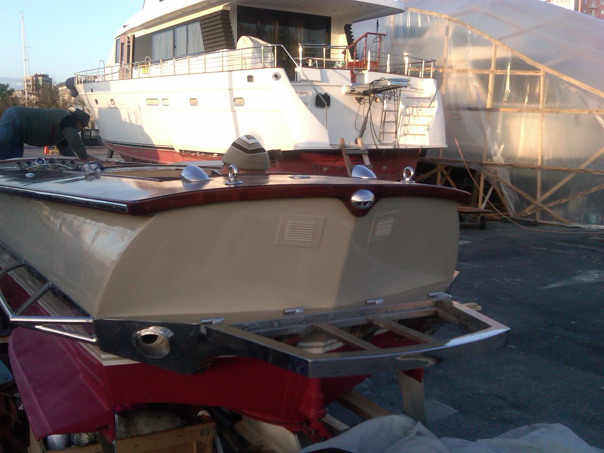

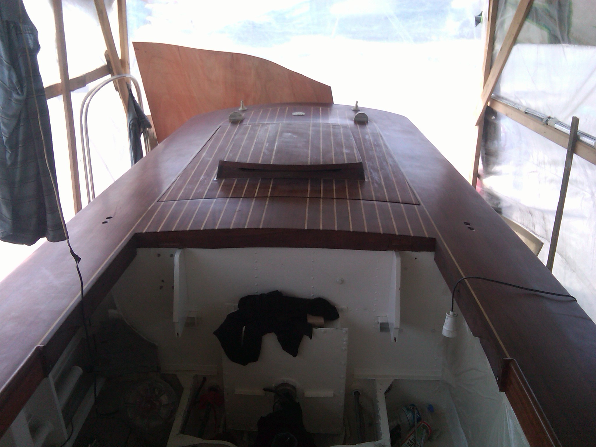

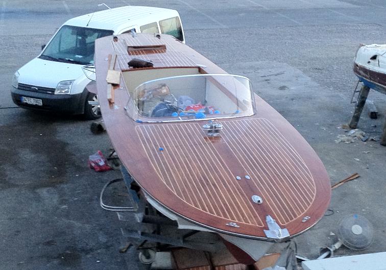

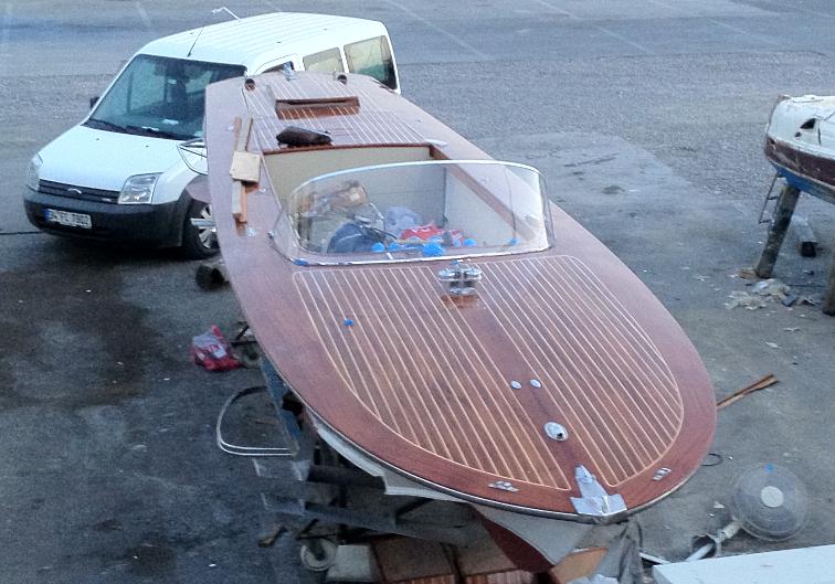

The hooded hood placed on the engine room.
Another view of the hooded hood.

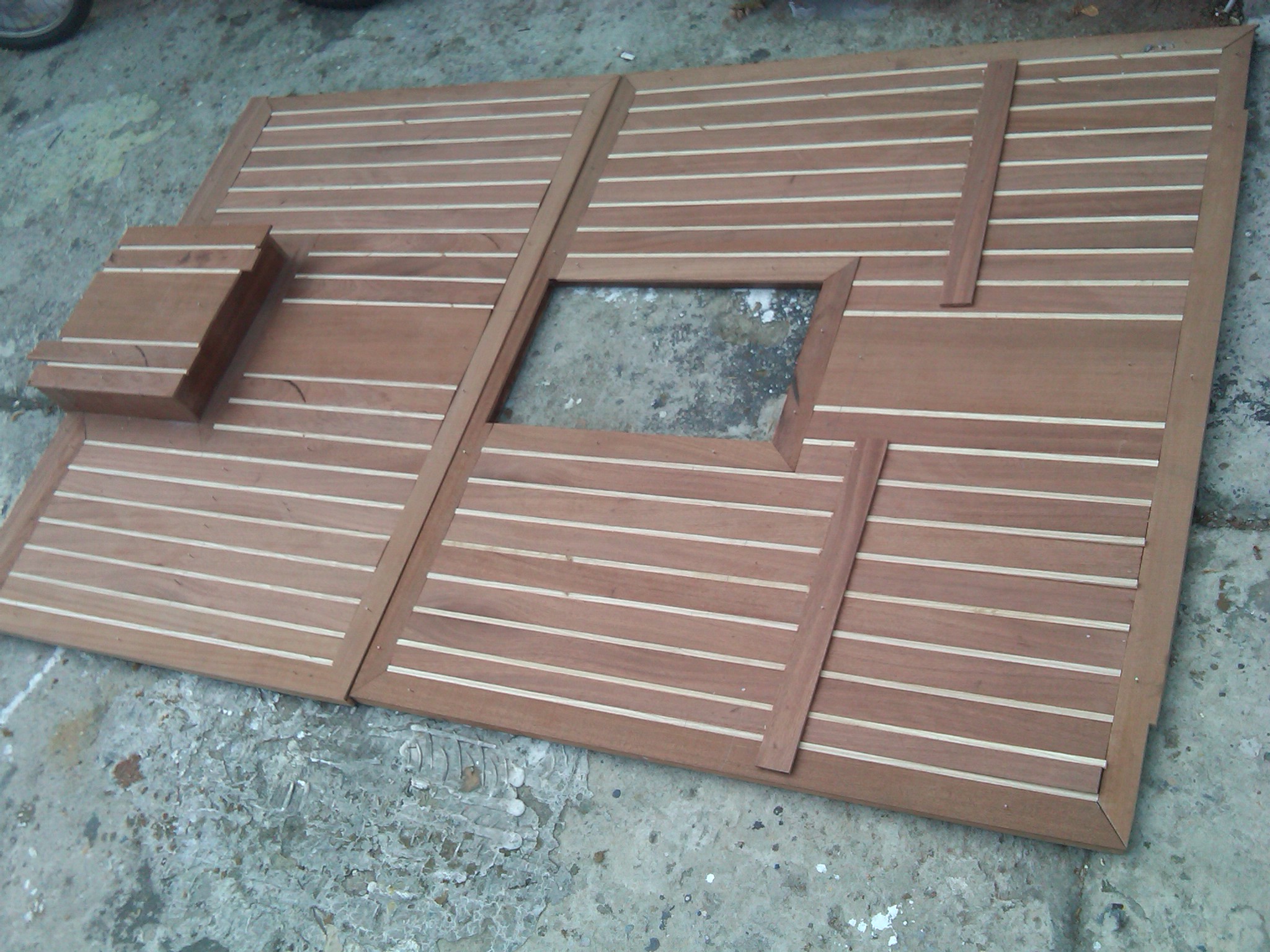

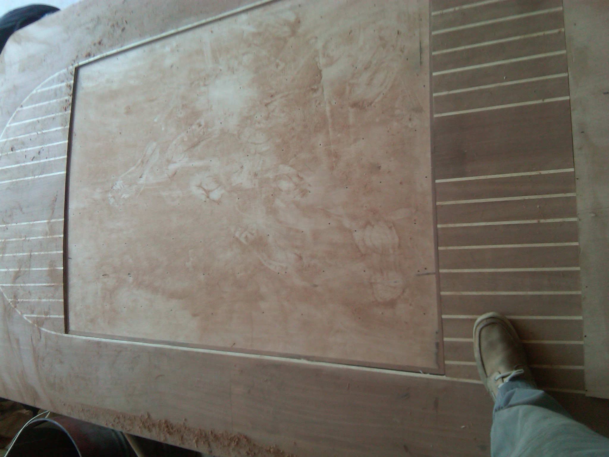

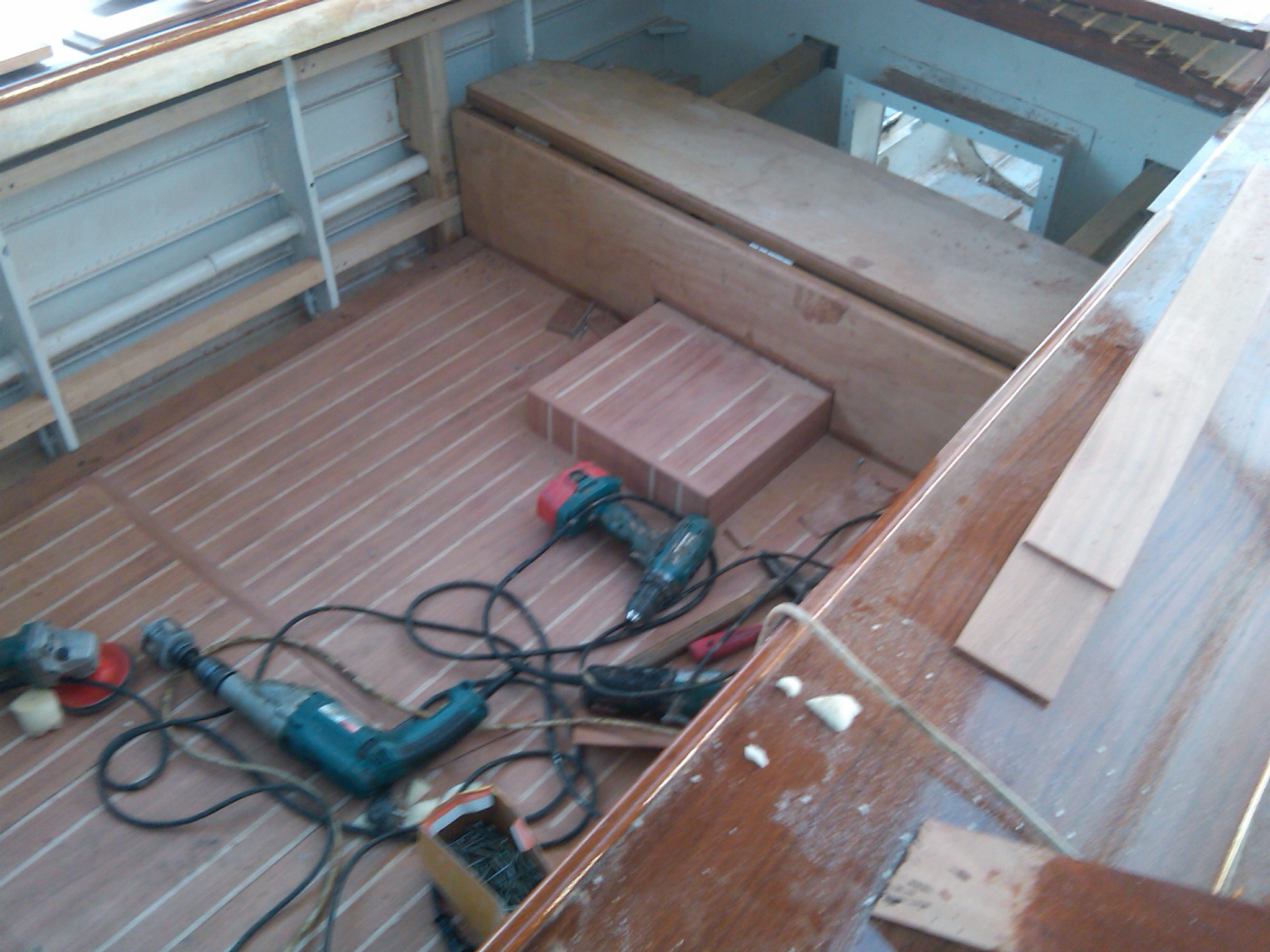

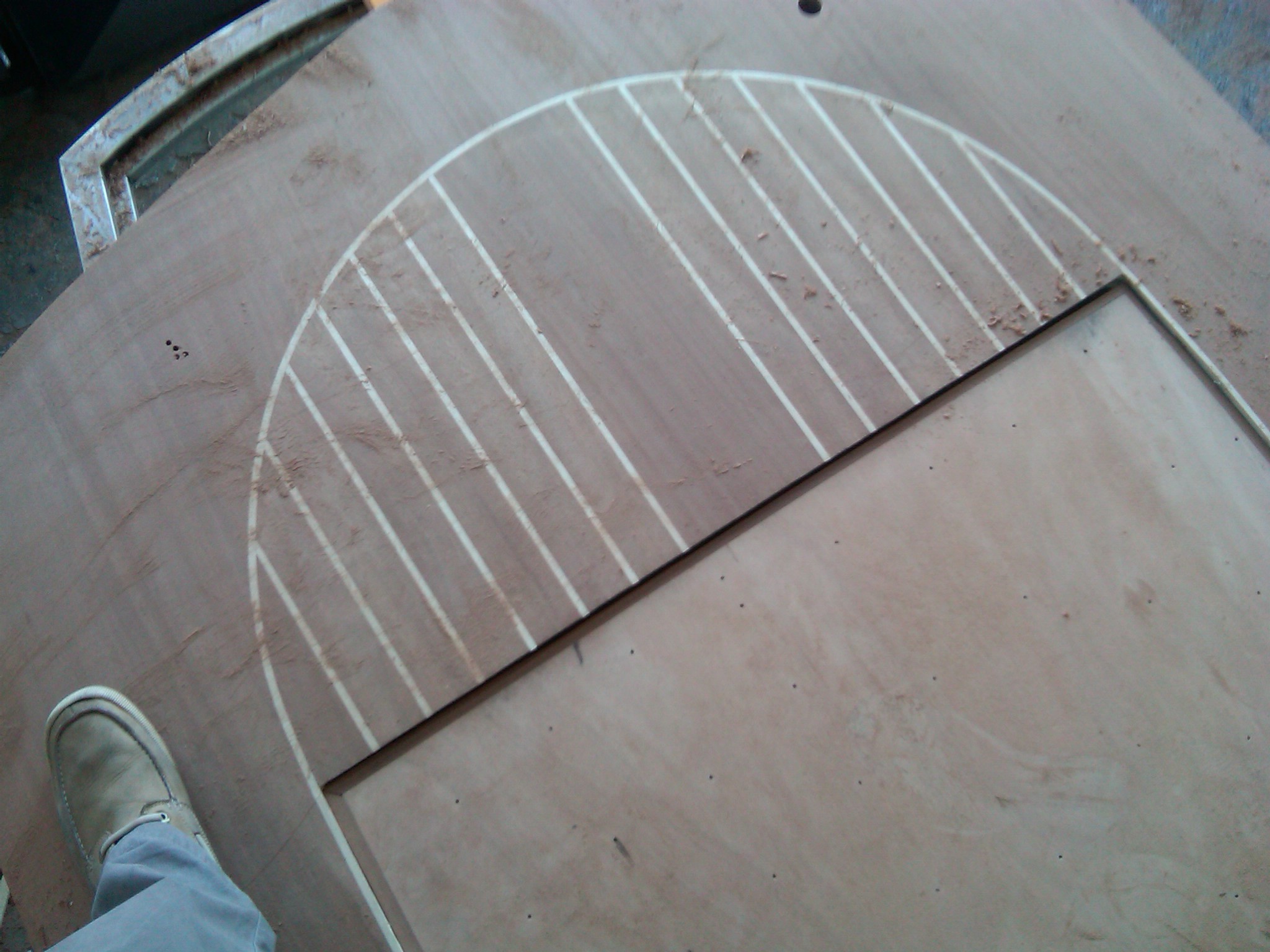

The floor plates of the pool are framed by 5 cm. ... Scrap! It will be redone... with 1,5 cm frames only.
I wonder how good a shish-kebab tastes when you use mahagony wood for it? Don't worry, we will use the wood elsewhere!
The design has a line and the floor plates were designed with a single line. The carpenter said, that the frame gives a longer life to the wood. TheNo compromises with self-inventions of stubbern carpenters. It will be changed!

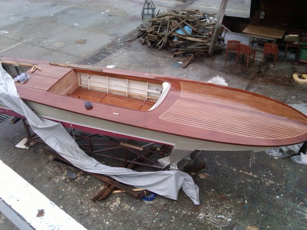

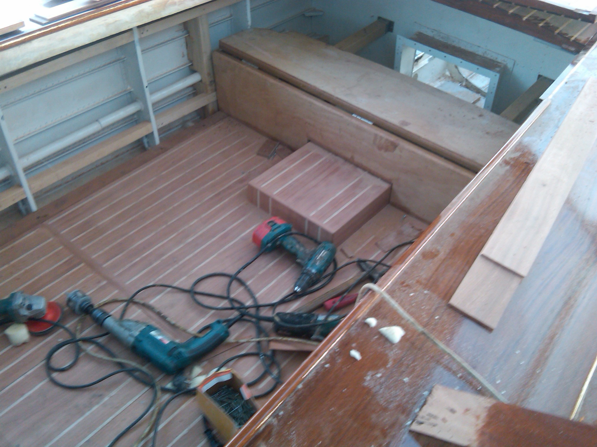

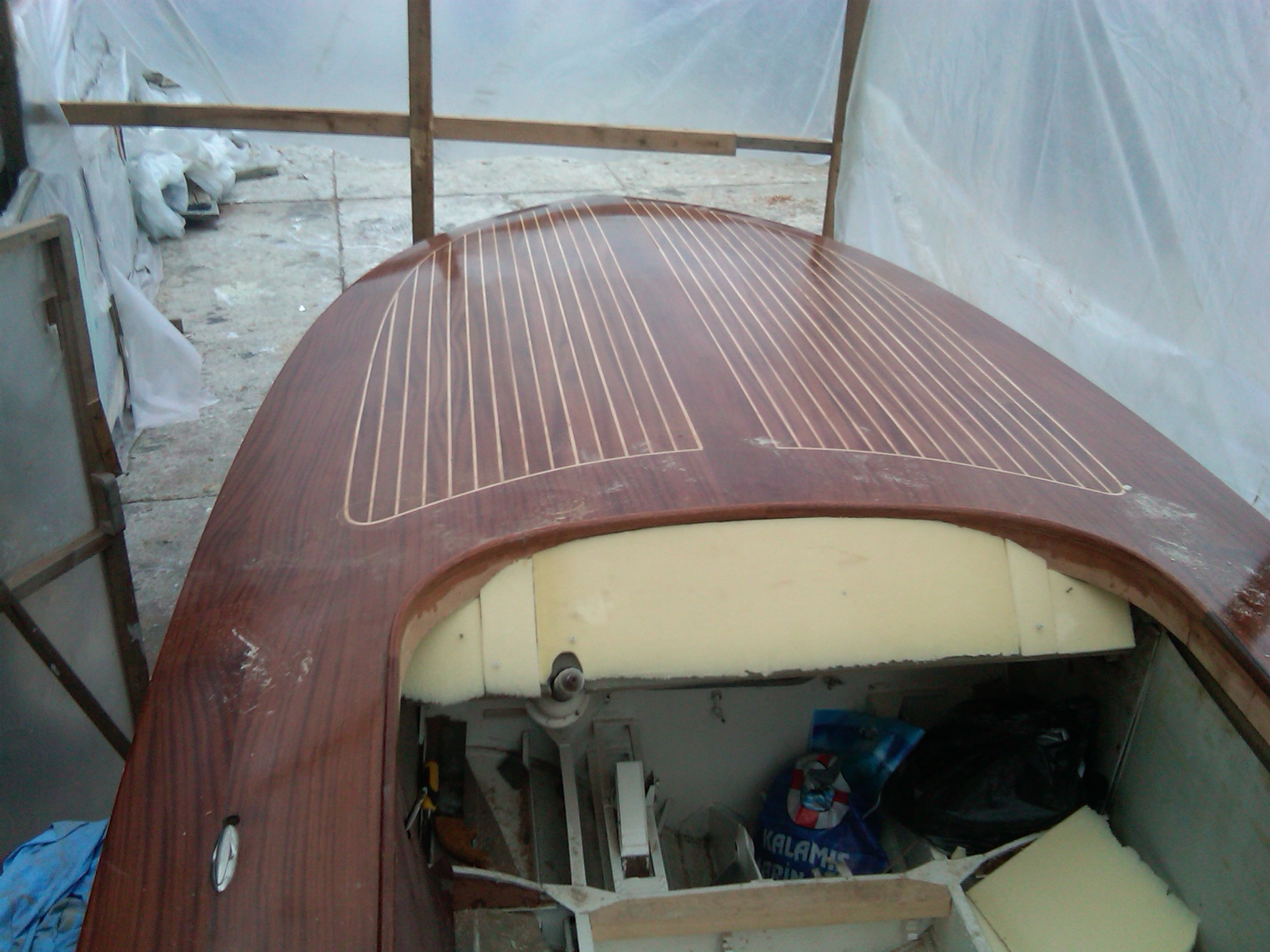

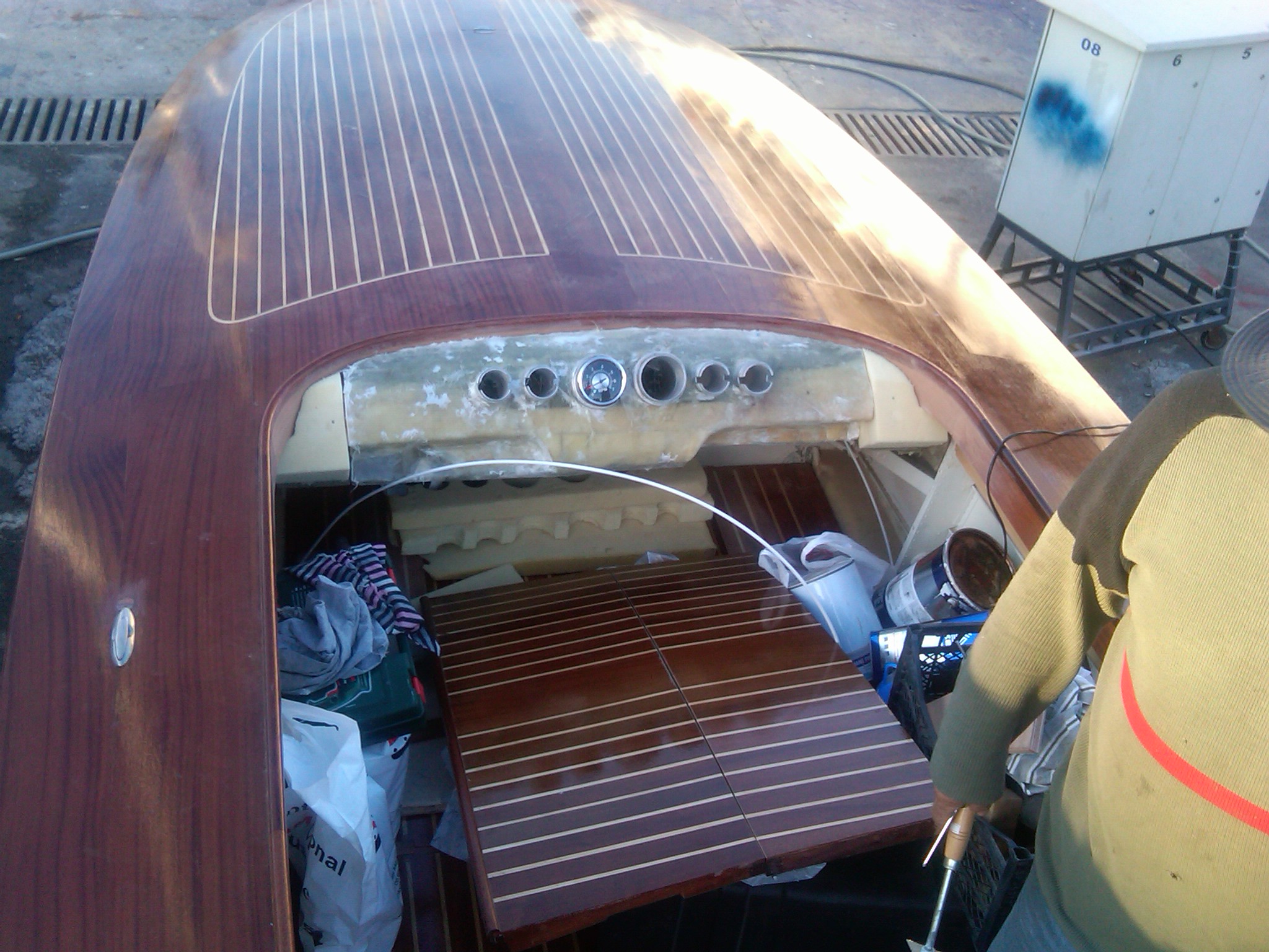

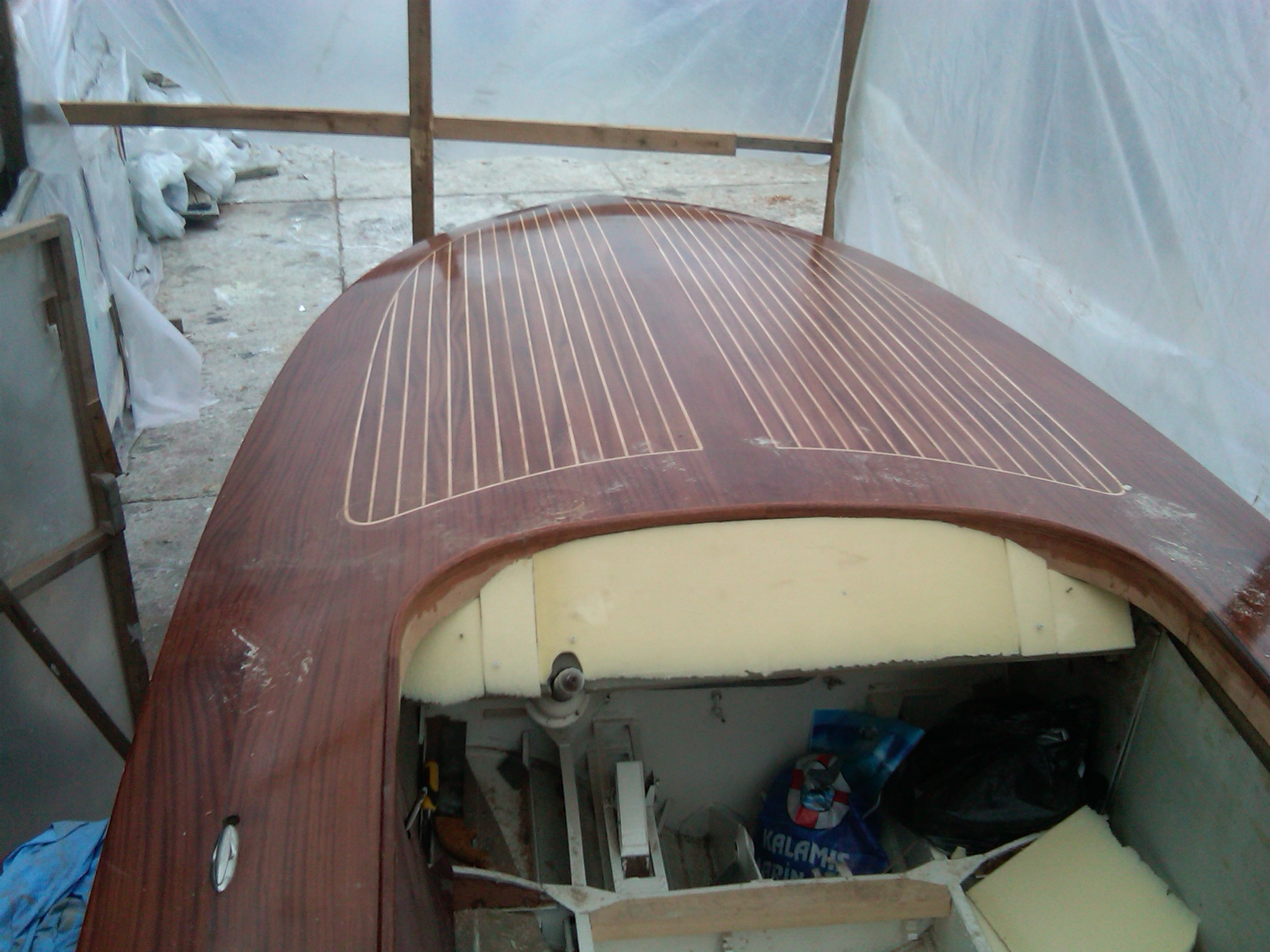

That is the current situation:
View from above with the box/bench and the plywood done.
The woodwork of the floorplates of the pool was redone, with smaller frames.
Small frame version
Small frame version

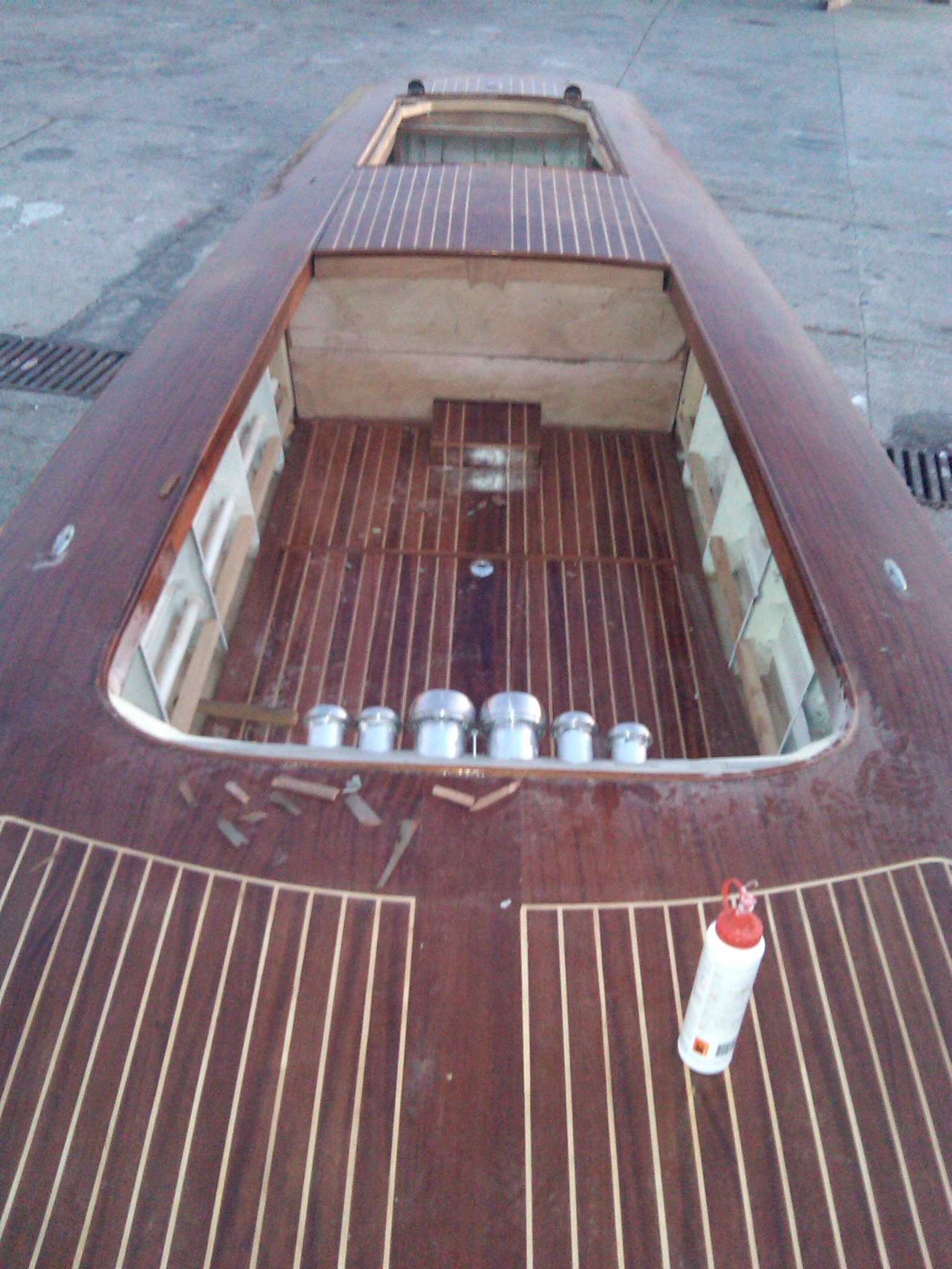

What you can see on the back is the box/bench partially retracted.
The fuel cap and the air inlets were installed as well.
Fuel cap and air-take-ins installed

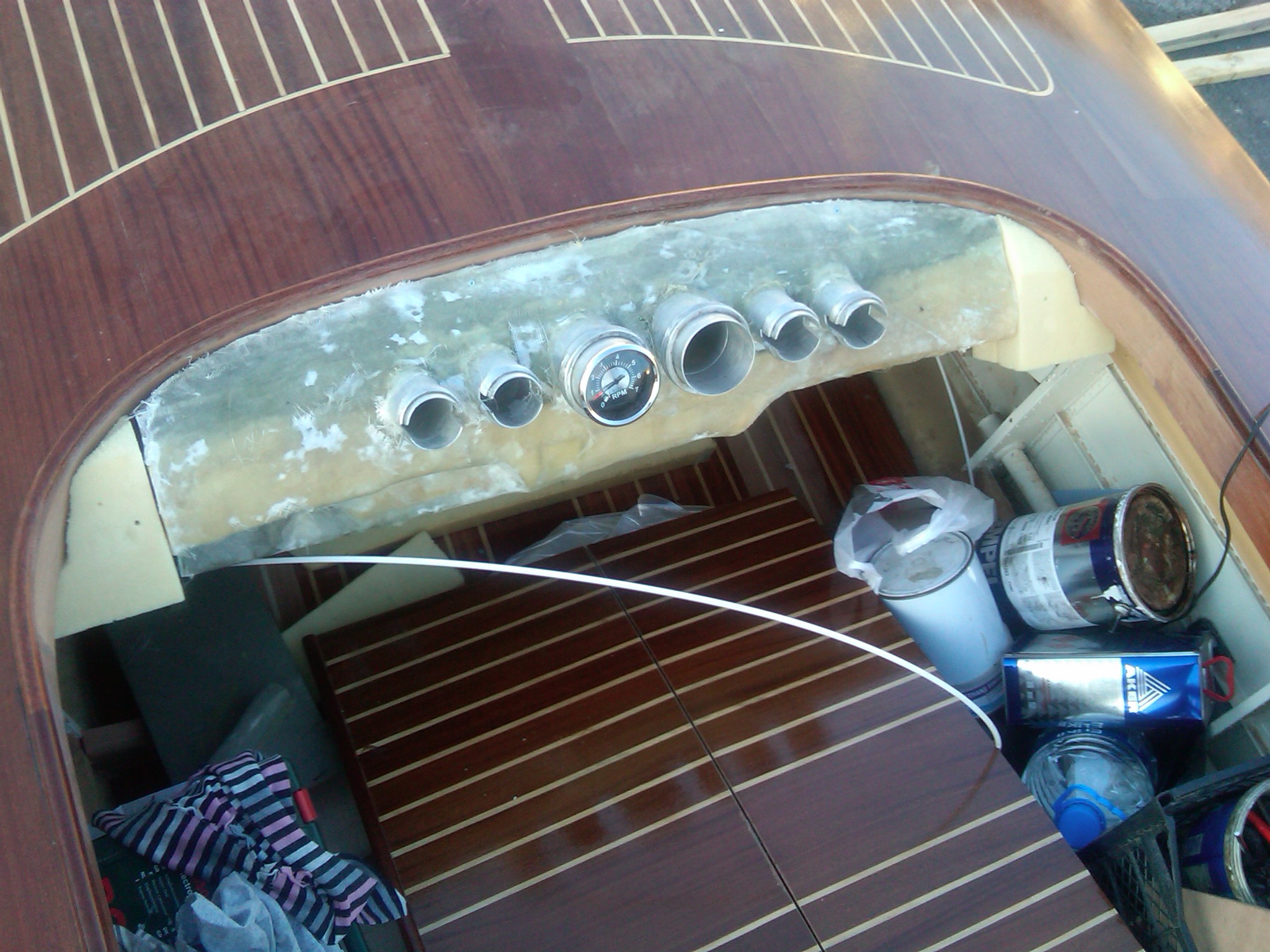

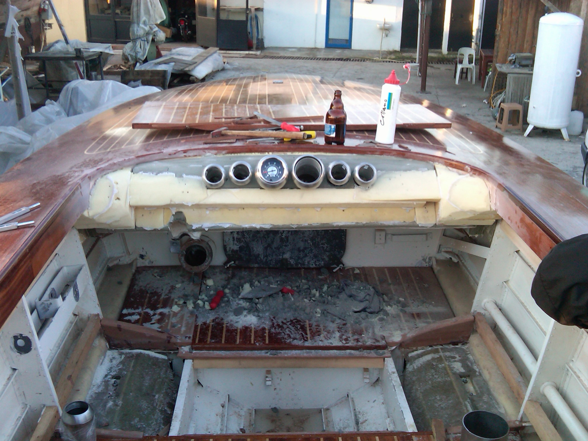

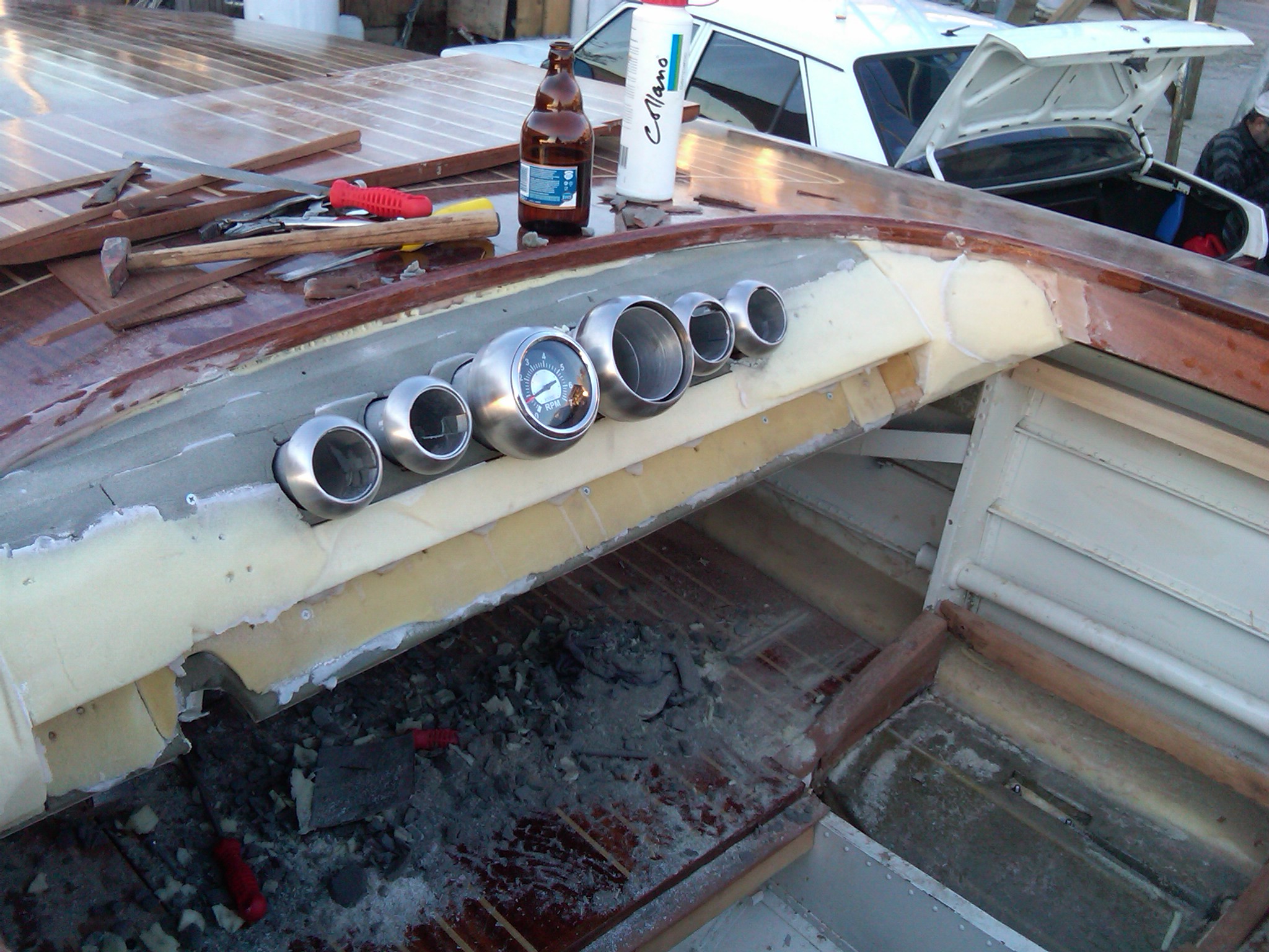

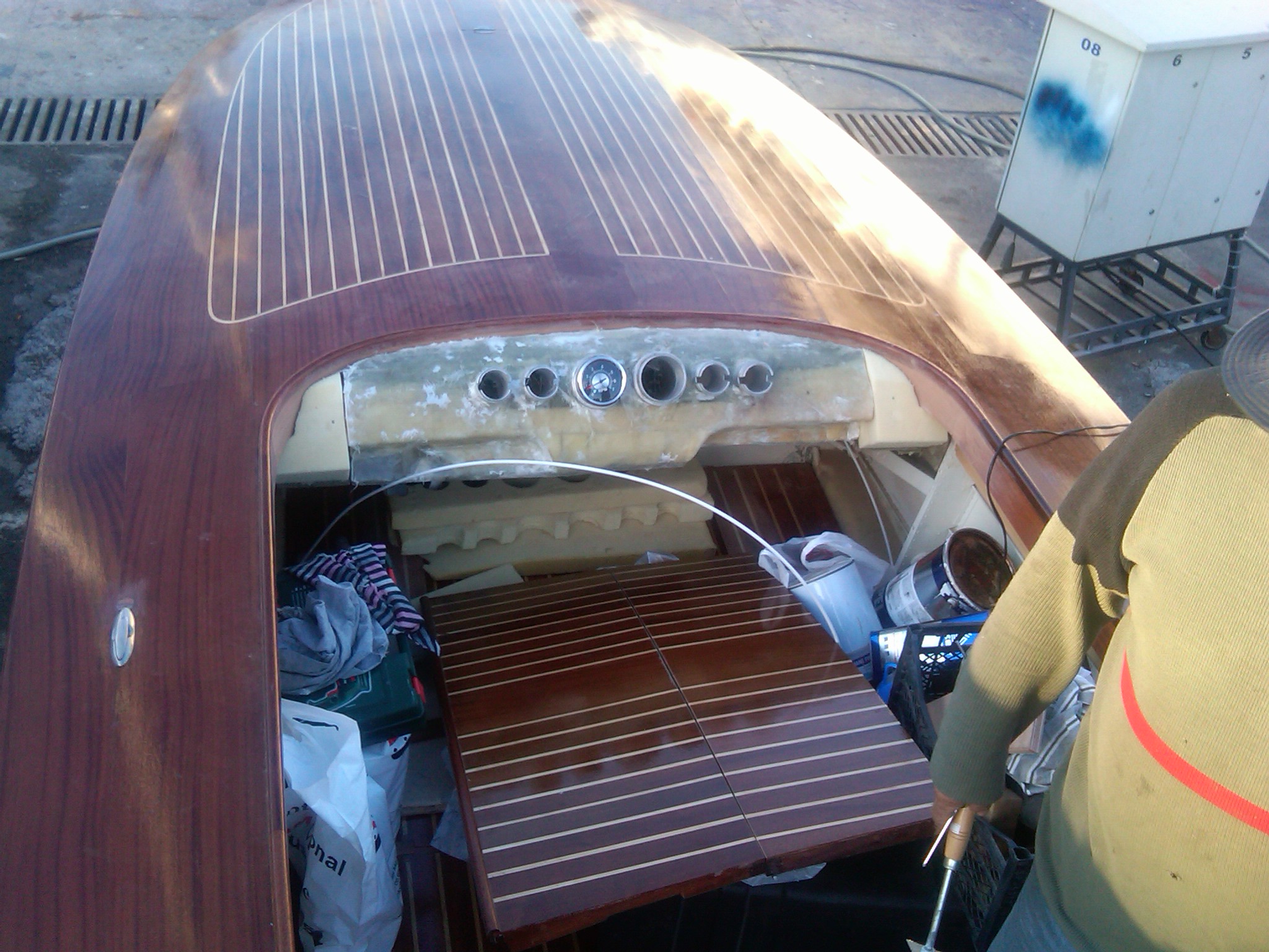

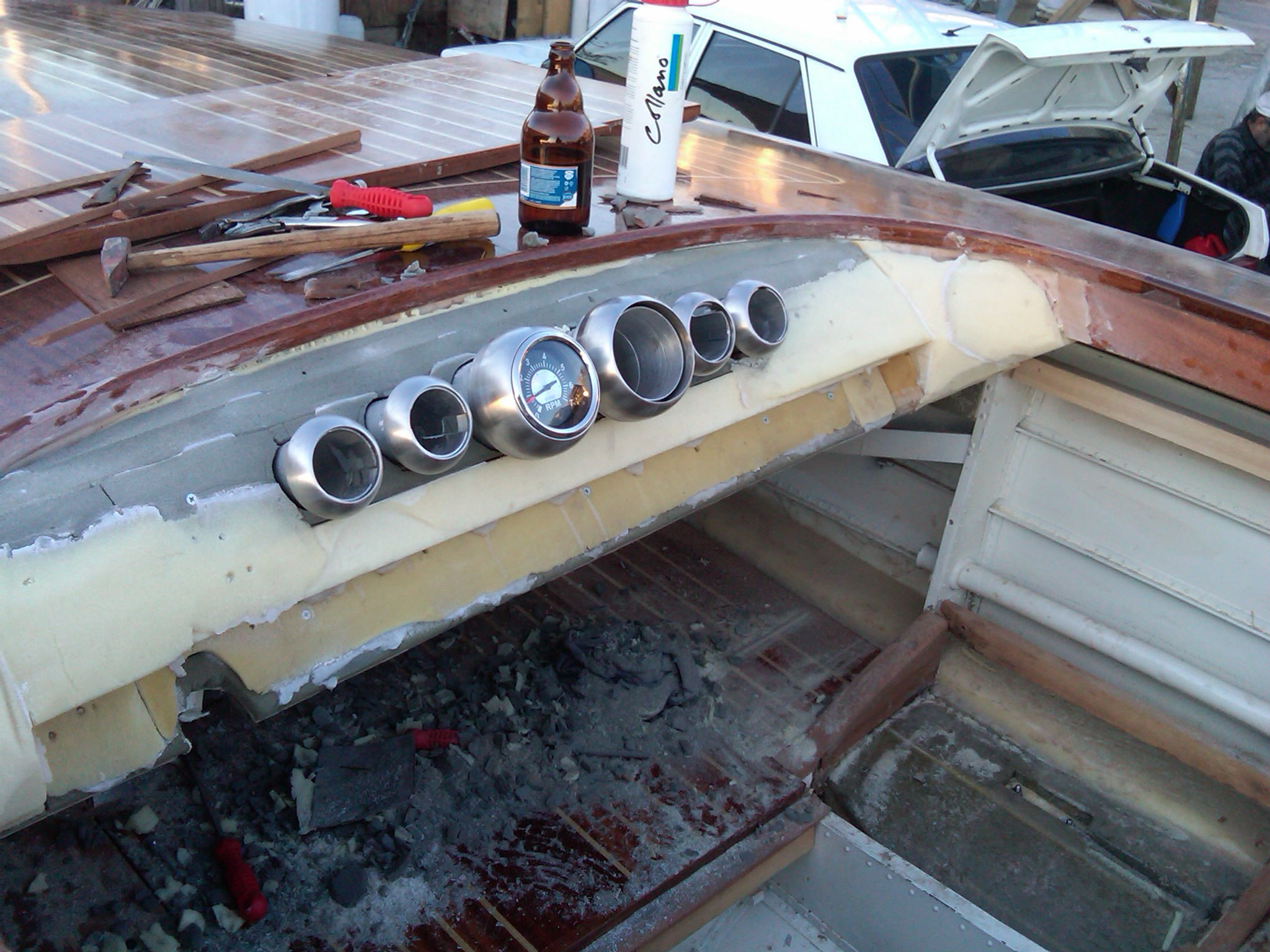

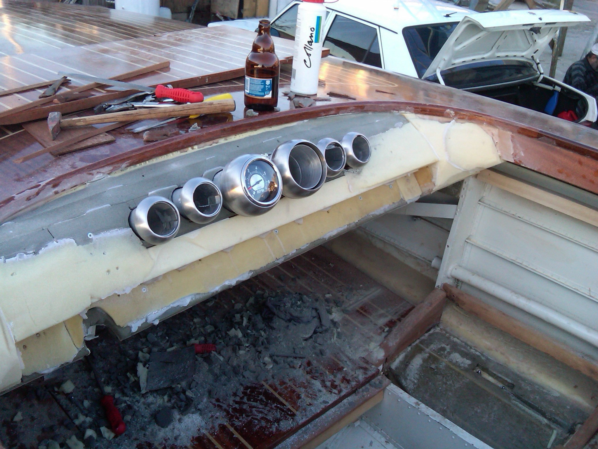

We started to add preinstall the cockpit gauges or their housings.
Nothing makes more dirt than shaping and sanding the foam.
The housings do not fit well, due to last minute decision changes with their distances. They still need to be symetrically fitted properly.
This is a view from front to back. You can see the closed box.

WOW, magnificent! The deck looks stunning in the overview-picture from above!
What kind of material are you using for the deck inside the 'cockpit'?

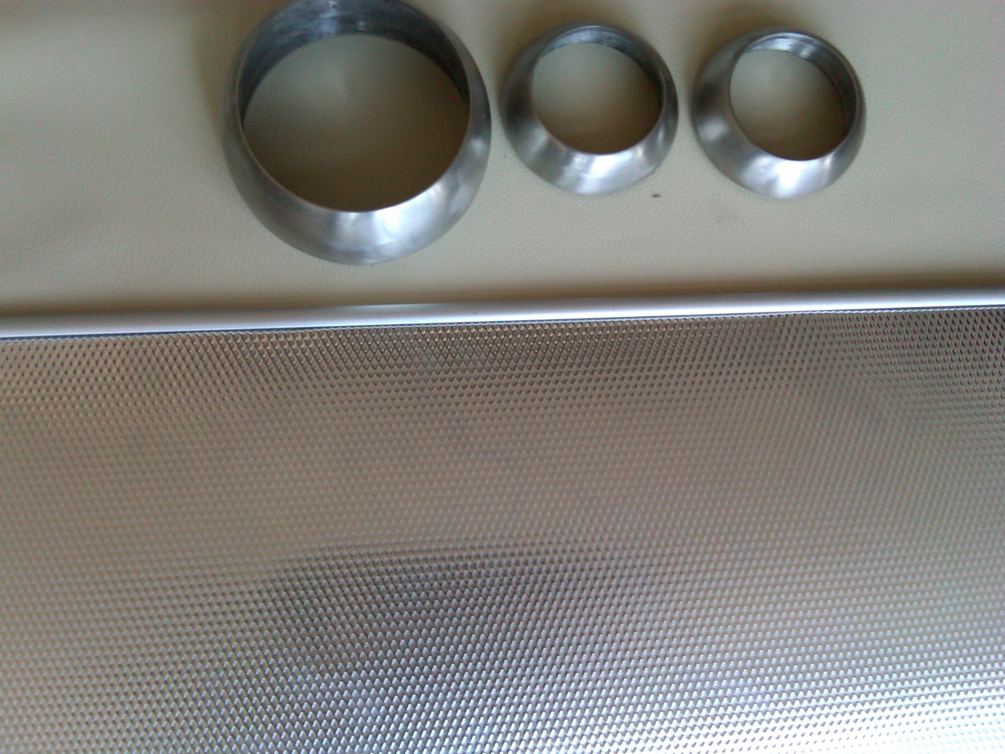

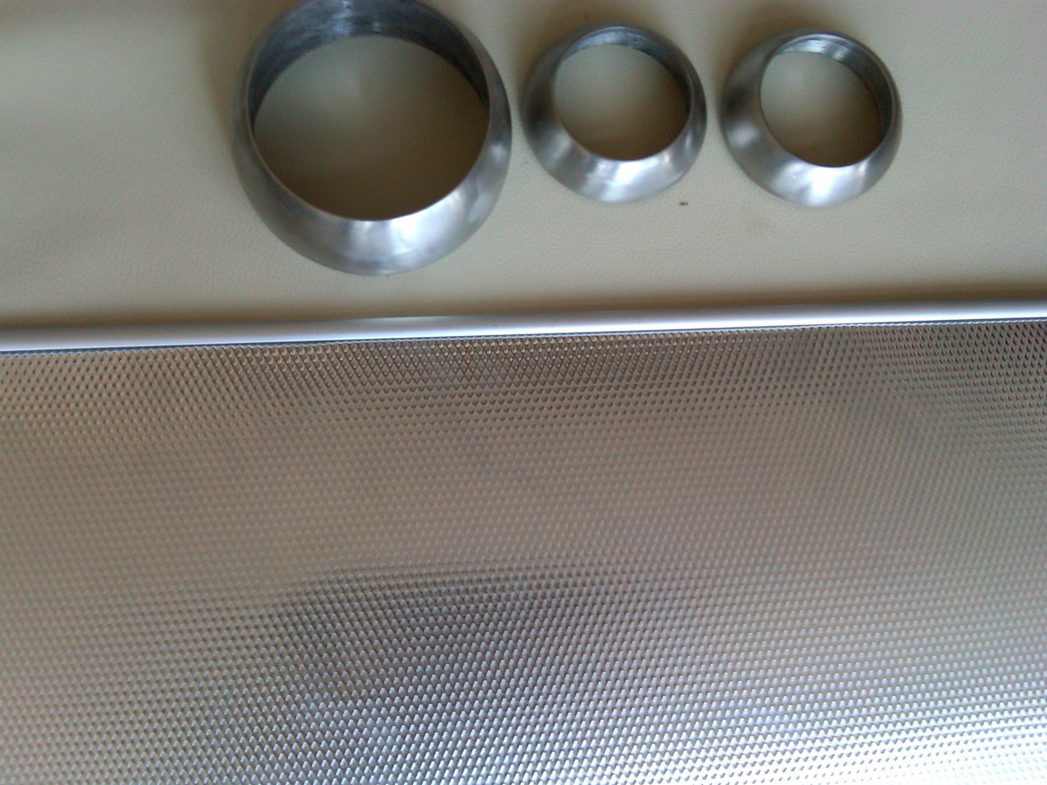

The material is pvc hardfoam sheets, we are sanding. The pipes for the gauges are Aluminium and they will be fixed via epoxy. The bezels are of stainless steel and what you can not see on the photo there are stainless steel guide/cover pipes, that will be shaped to the dashboard. The dashboard will after proper sanding be covered with epoxy and glass fiber, later a UV resistant beige artificial leather will be glued on. Below there will be an aluminium cover with all other switches, radio etc ...
The leather and the aluminium is divided by a thin aluminium strip profile.

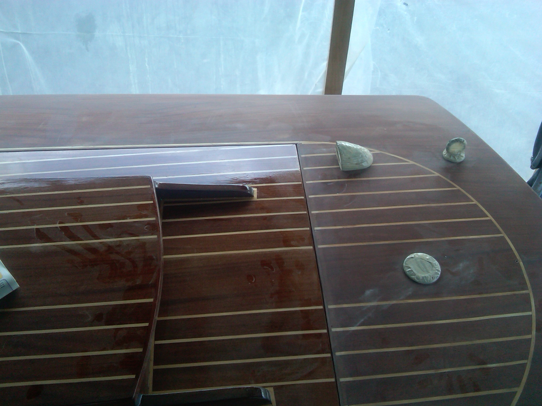

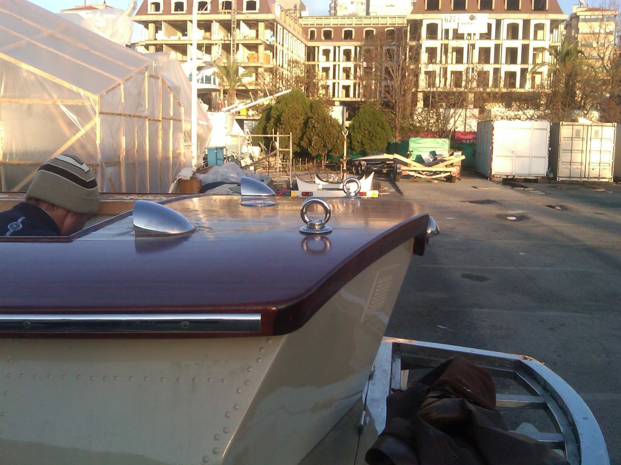

Renewed and installed lifting jugs. Stainless steel. We had welded the on the old construction.
Also the lifting jugs have been renewed.
Looks more civilised than the old rusty russian ones... I think they must have been cast iron and meant to tow a T-34.
Rails on the side.
Rails on the side.
Back with rails on the side.

Some messages before you were able to see the hood with a frame. The frame was never requested by me, but the sparkling intelligence outbreed of a so-called "master" who boasted himself having studied and educuted in England (or/so-what?). He favoured somekind of Southhampton design of a Waterproof Hatch, probably invented by some British Boffins, who must have fighted all their lives against their boats soaking water in English rainy weather, which we for what-ever-reason obviously do not have here in Turkey(!?). It soon and most unfortunately turned-out this highly and insistively defended idea of an outragious 'masterpiece' from unquestionable technical brilliance was indeed unuseful, as it was not only hardly possible to open the hood properly, but there was also no (invisible) hinge for carrying and opening this hood on the market.
Design with the ''water-proof''-frame
The opening of the hood would therefore only have been possible if you provide hinges first lifting about 2 cm and after open the hatch/hood. There are no hinges available on the market, so you need to produce them on your own. So after having had this onboard, we had to search for weeks for a suitable solution to make it work properly, while the glamourous inventor of this design appeared from time-to-time, telling us the Russians did everything wrong in the past anyway and so they did it with this boat as well (!?). We asked him bluntly, whether we should consider his brain being appointed by her Majesty the Queen?
We decided to chop off the f*cking ''waterproof'' frame, suddenly were back to the plain design roots, and now we were able to use the old original Volga hinge-style, of which we replaced the aluminium part with a steel one. We therefore again have in hand something operationable by not being ugly at same time and this is a truely unbritish way of doing it. (Now, for those opposing: anyone having an oil leaking Triumph, Norton or Enfield in his garage will immediately confirm, what is said!).
No frame!
No frame!
Back to the roots!
Back to the roots!

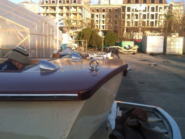

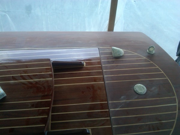

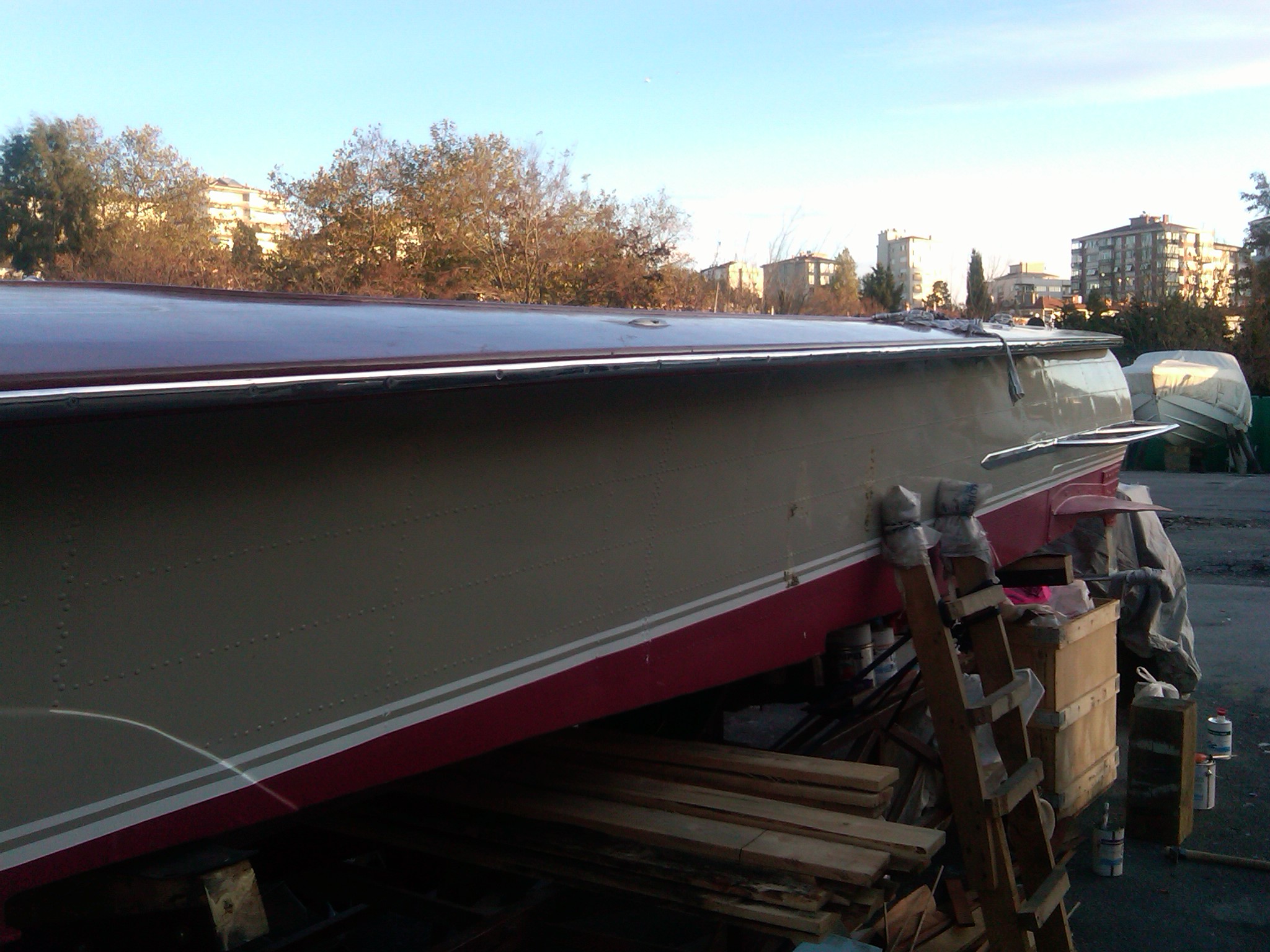

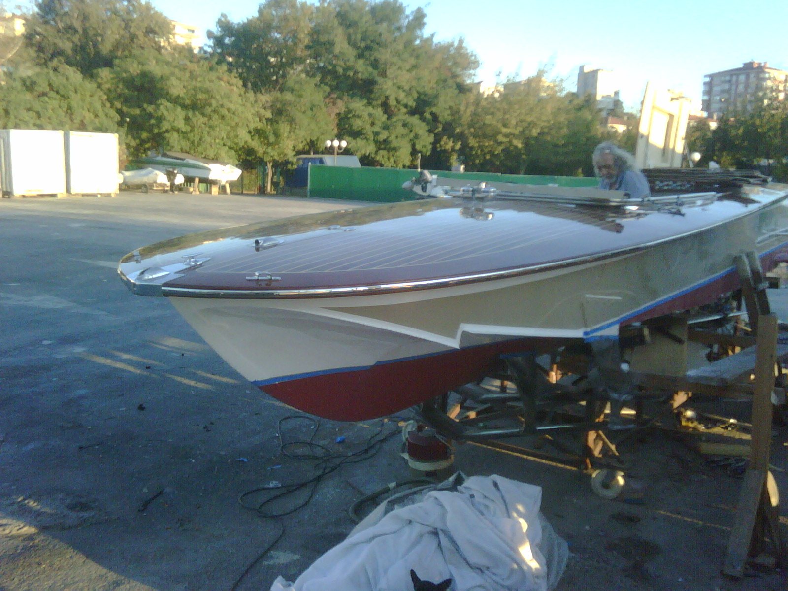

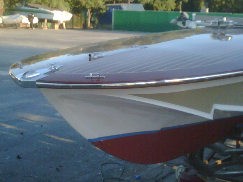

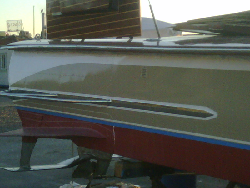

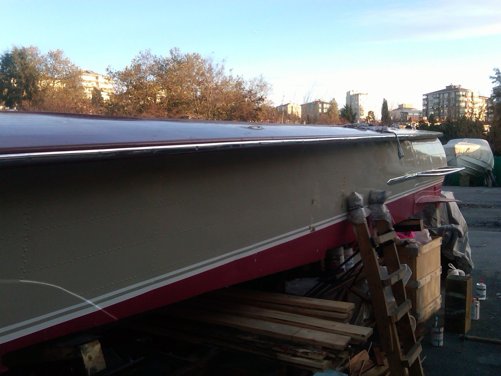

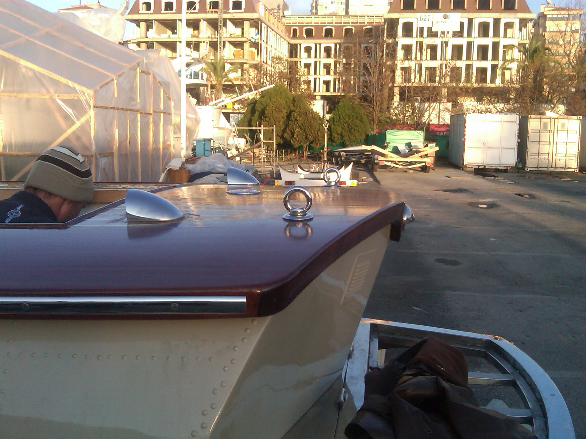

The new paint pattern with the chrome stuff
Even when standing still the arrow on the bow makes the volga faster
bow close-up
bow close-up
white lining around the chrome side bumper

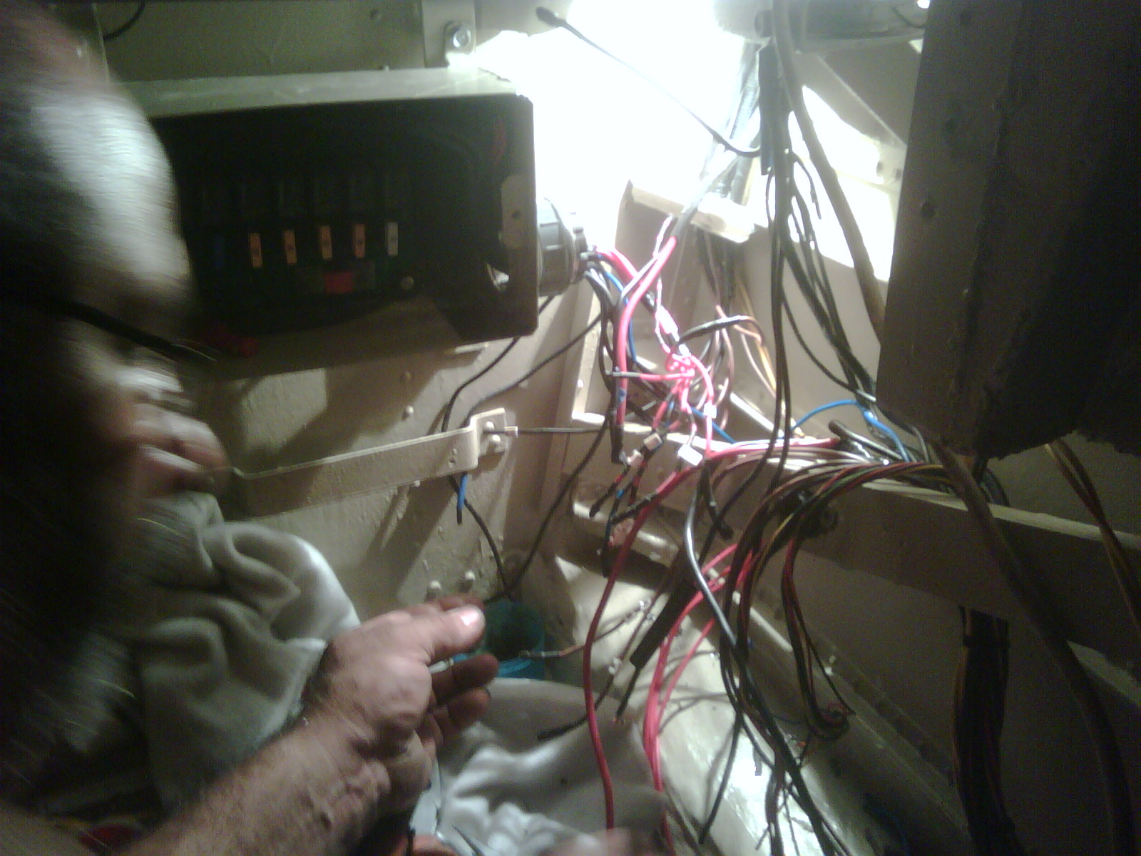

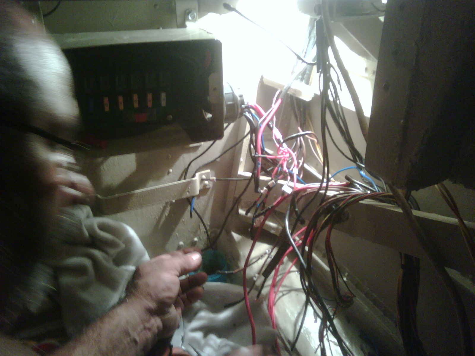

Never-ending trouble with the electric wiring hempers us to finish the inside of the boat.

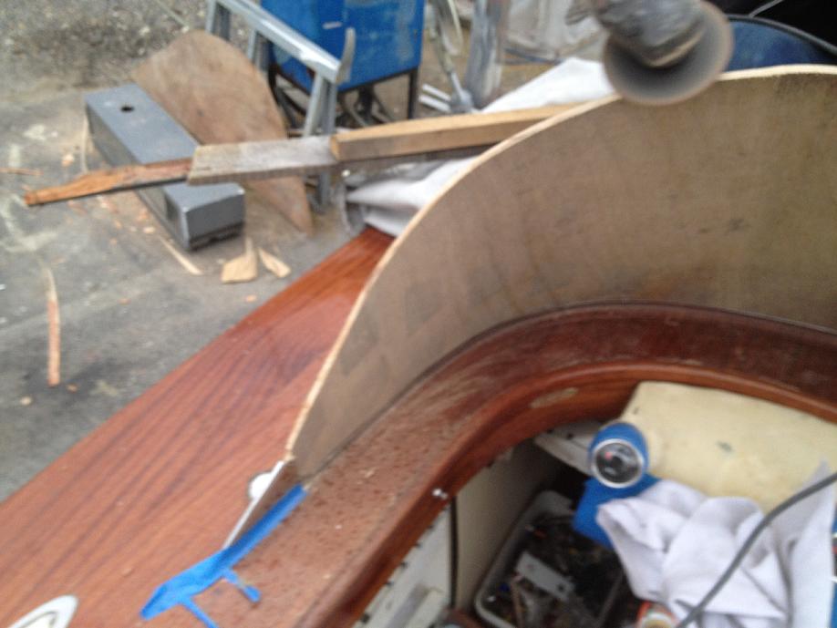

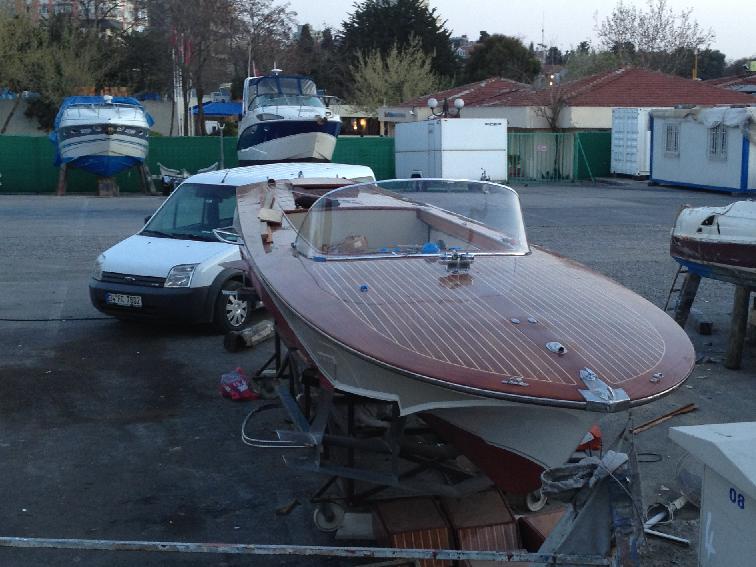

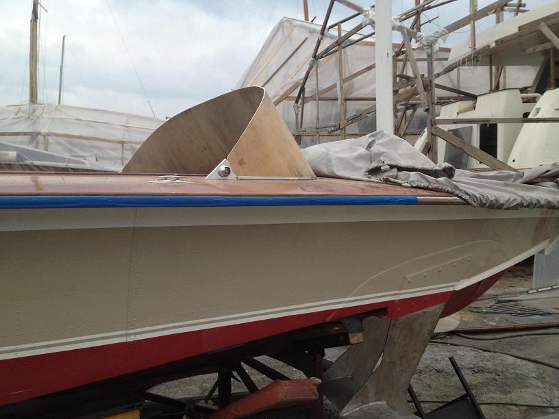

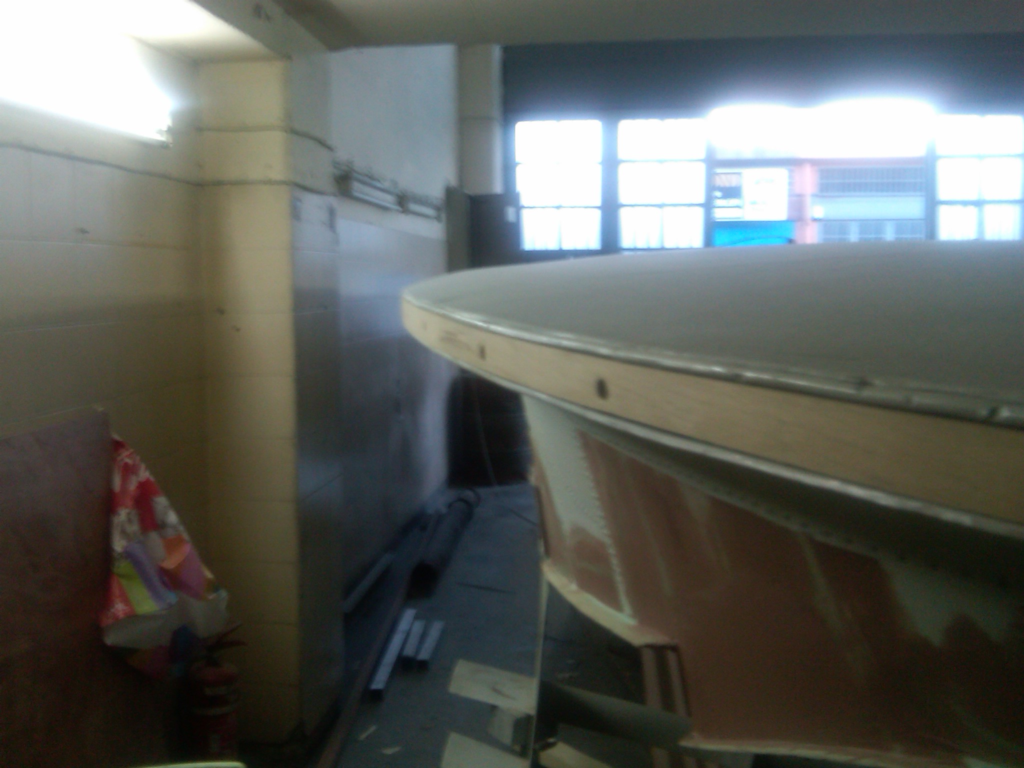

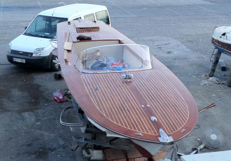

Before starting with the screen, we had to make a welded stainless steel rim (holder) and had to bolt it on the hull. The rim had to fit the shape of the wooden inlays and had to go in paralell to them. Our mistake was that we used a rim with only 1 cm. We experienced that 15 - 20 mm would have been much more sturdy. Last not least for fitting the screen better.
A welded steel model was made first, which could not be used by the screen maker. The effort for it was in vain.
So we were advised to make a plywood form instead and for this we were asked to buy a special plywood on the market called ''prostitute-plywood''. This name was given, due to it's fame of being able to turn in any direction.
Shaping wooden model with prostitute-plywood
Prostitute-plywood form ready!
Even if donated with promising name, the prostitute plywood revealed itself as tricky and difficult to handle. Some rainy weather made it wavy and worn-out. To apply a sample in plexiglass revealed itself more usefull than fighting around with the hooker-plywood. (Several failed tries led me to this way. The applying of the plexiglass took only 2 hours.

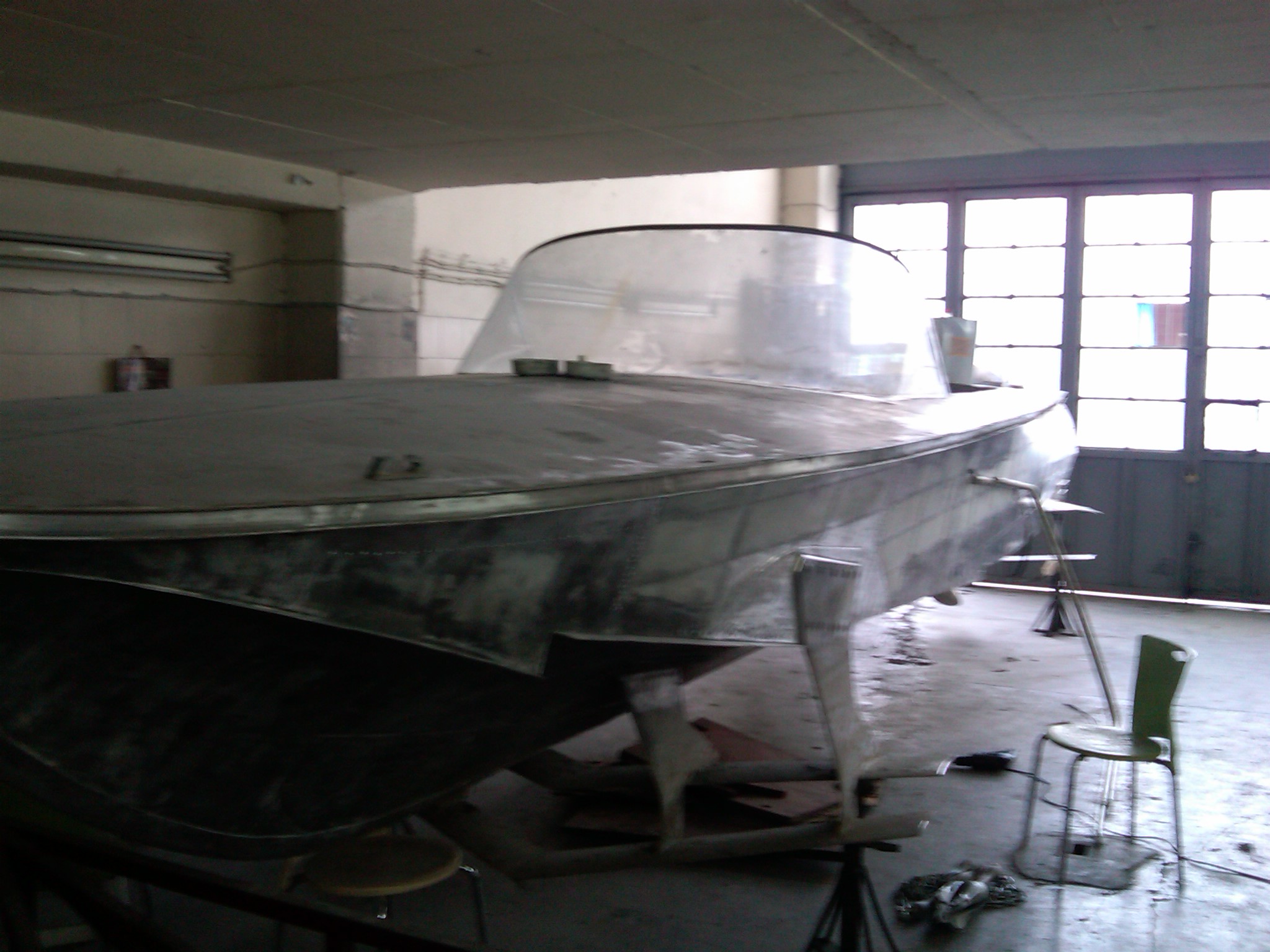

Plexiglass prototype model
View from a higher place
What you might not be able to see, is that the new screen is already 10 cm lower than the original one. The original (later version) was oversized for protecting the passengers of wind and spray, but the estethic of it suffered under it, making it look like ''Barbie Runabout''!
Of corse another 10 cm lower would definitely have been more sexy on this boat, but I did not want to sacrifice the comfort f5urther. The windscreen is having 55 height instead of 65 cm.
With the ready form, I intend to make an Akrylic version instead of plexiglass.
