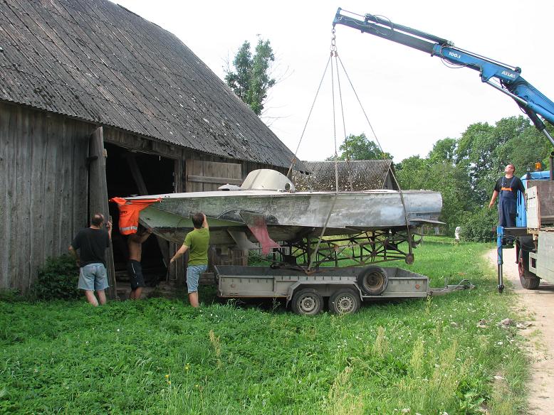

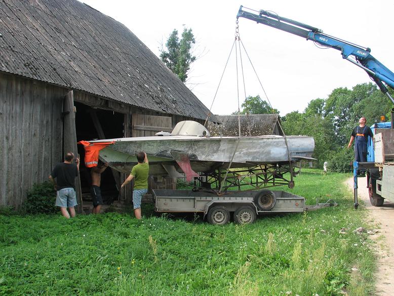

Interesting, because it was quite a challenge to get the boat out of the old wooden shed. We eventually got it on the truck. The journey went smooth.

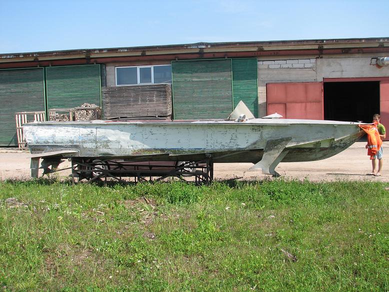

The previous owner had started to take the paint off with far to ruff material, that's why it looks so bad. I will do soda blasting (off course). Besides that, it looks rather good.

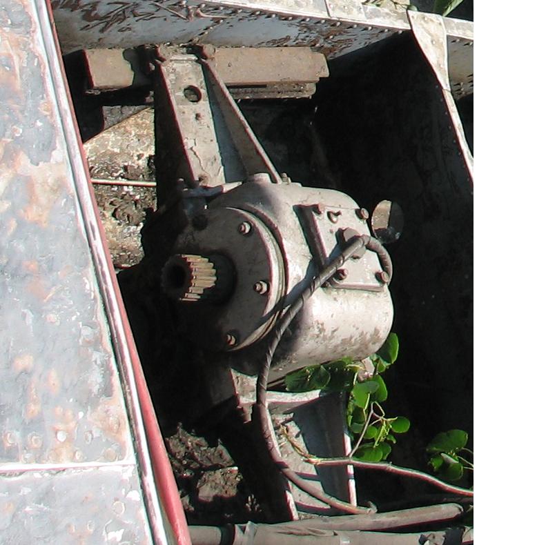

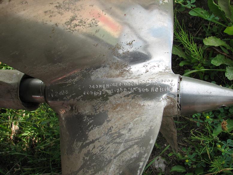

At this moment, i took almost everything out, including the gearbox. Question: does anyone know the original RPM of the propeller and gearbox (number on the gearbox is difficult to read, but i think it is 192-20, or 152-20. I need to put another engine in and want to use the original propeller and gearbox, because they are in good shape.
This is the propeller:

the original Rpm of the GAZ 53 engine is 3200-1min max. 120HP/ 29Kgm torque at 2000Rpm. It can rew up to 3500Rpm without engine surgery.
Normal cruising speed is 30 knots at 2600-2800 -1min.
A good marine diesel : VW marine or Yanmar- which uses BMW engines of HP-150 - 180 costs a lot. Rpm should be max 3500Rpm. Torque should be min 300Nm /30Kgm/ . at 1600-2800Rpm.better 350-400NMt.

What Christian says is correct. Make your own calculation and you will see that with private use you will not come to more than 150 hours a year. A diesel might be sure a better thing, but be aware of the cost. Silly you have to be to through away a brandnew V8 for getting in an xpensive diesel for 150 hours a year. If you do not have the original gearbox which was reducing from 2800 rpm via 1:1,546 ratio, buy a brandnew ZF 63 IV with a corresponding reduction ratio to your engine rpm for it. You may then also replace the old gearbox + V-drive with a V-drive gearbox. This one you can reuse if you get a new diesel with same rpm.
