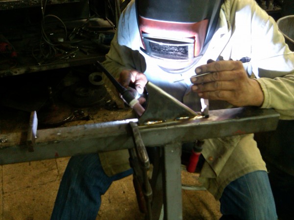

A from the scratch new design and alternative for the old style. It is a very simple design but with a team of people rather unexperienced it was a nightmare to produce it. The parts were designed by me and are cut out of stainless steel plates. Later they had to be crimped and then welded. It started with the crimping that was done by unprofessionals that crimped wrong and also used the wrong press. The 1st welder I found was not able to make a good welding and the parts became scrap. So we had to have them cut again and find a better crimper to bend them and a better welder to weld them.
This welder was perfect!

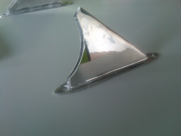

Shark-fin design
Shark-fin design

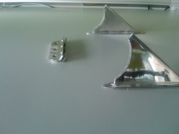

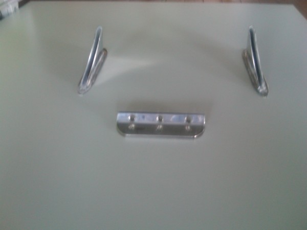

The assembly as a set
Set from the side!
Set from the side!
The set consists of a middle part and two side parts. Besides this there is (will be) a lower and an upper frame. The lower frame has still to be produced and we will use very thin stainless steel sheet, which we will bend in a can production machine. For the upper frame we want to use the original Volga frame profile we still have in hand, but need to bend it according to the new shape.
The middle part will be at front screwed to the deck, fix the plexiglass and hold it down, whereas the sharkfin sides will hold the sides and back, when they slide in it.

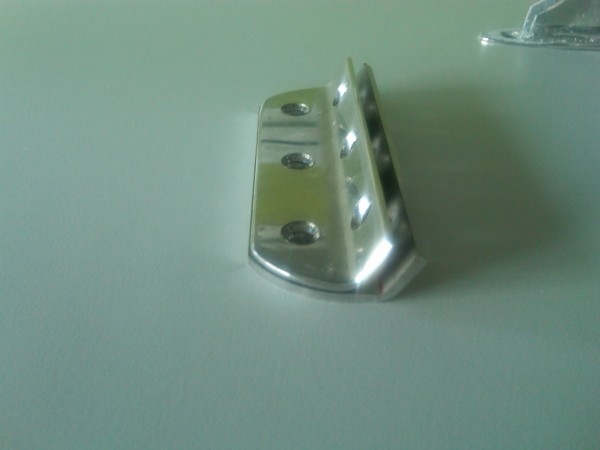

Middle/Front part
Middle/Front part
We used 2 mm and 3 mm stainless steel sheets and I made several tries with it. 3mm parts are better for basis as they do not deform. The design is rather slim and we could have made the basis broader.
What frightens someone from doing it is, that it has several steps to be made (laser cutting, bending, crimping, welding, polishing drilling and mounting). Depending on how far away the professionals are to where you have to go to the longer it takes to have something produced.
