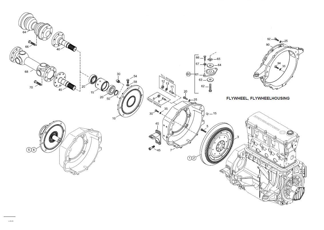

Integral shaft support
Hi All,
Someone recently asked how to connect an engine with the remote v-drive gearbox type ZF 63 IV.
Every engine has to have a coupling between itself and the gearbox. A remote V-drive gearbox needs a prop-shaft (Kardan connection element).
http://www.vulkan.com/fileadmin/product ... 20data.pdf
Above link is from a well known german producer of elastic couplings. Integral shaft support is a bellhousing attached to engine containing the flexible coupling and a bearing for carrying the weight of the prop-shaft. If this item is not used, the weight of the propshaft might damage the bearings of the engines crankshaft. The integral shaft support can be skipped if the propshaft is very short and/or light (Epoxy Carbon Fiber tube).
The propshaft itself has to be provided from somewhere else. It might be also possible to use the old Russian shaft which has a gear coupling.
There are also other bidders for such items like Reich, Centa, Stromag, Rexnord or similar. Vulkan might be the most expensive of all. I estimate a cost of approx 700 EUR for coupling and bell housing. Another option could be a Python or Aqua-drive with machined connection to the engine and a prop shaft.
Re: Overpowered versus Light
This picture shows an engine assembly at the vicinity of the flywheel.
You can see an integrated shaft support, cardan shafts and other elements:
