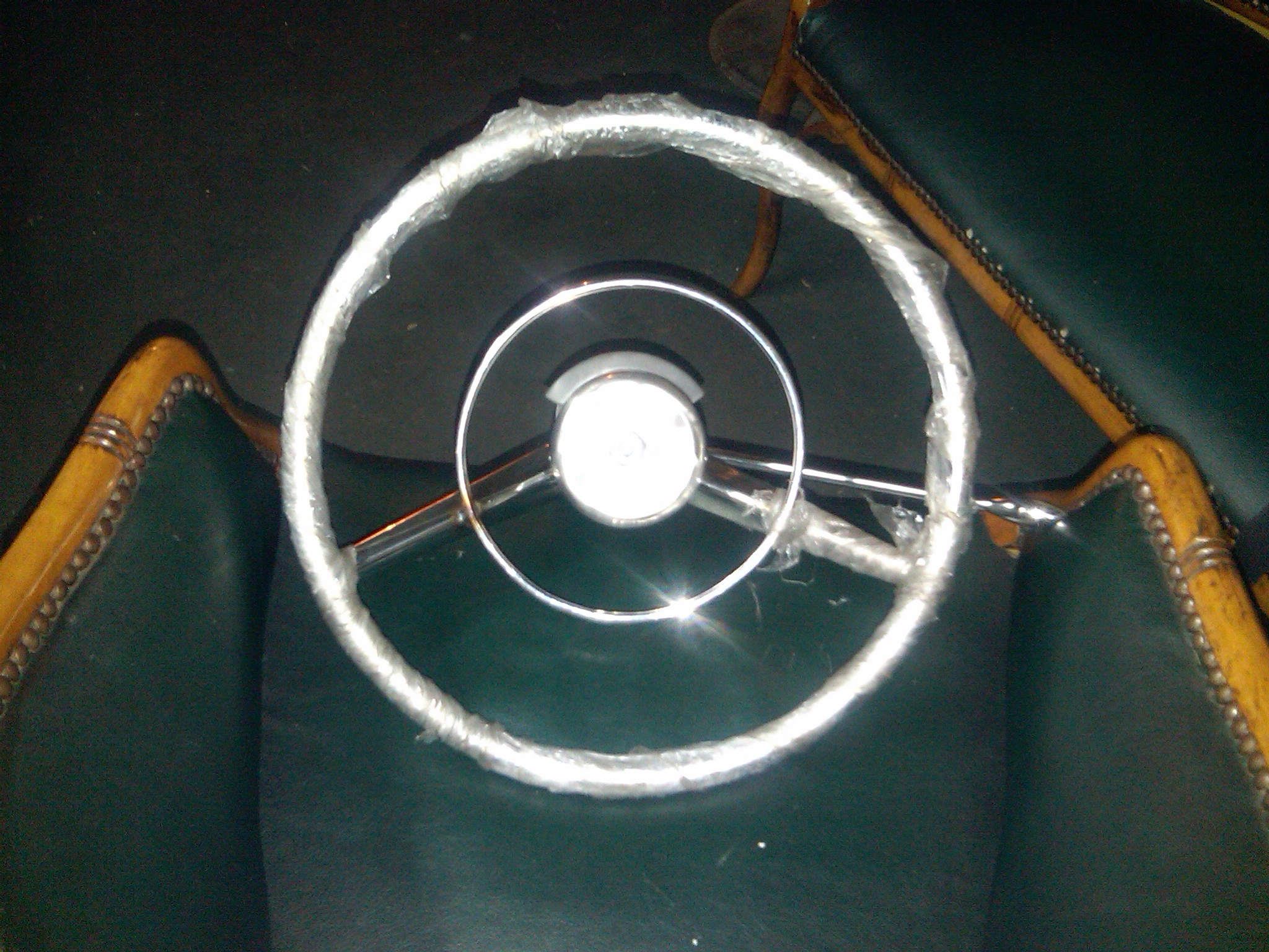

Here are some updates on the last version of the steering wheel. It became somewhat more baroque...
Leather lower part, plexiglass horn doom with Volga logo type flashy CCCP.

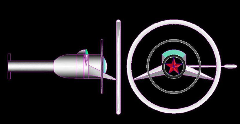

Posted: Sat Nov 27, 2010 12:13 am

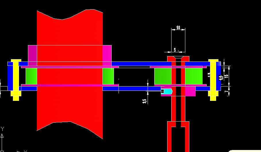

The sectional drawing was something I forgot to add here... Here we go...
We are still struggling on this ...
Sectional drawing of steering wheel.JPG (35.68 KiB) Viewed 526771 times

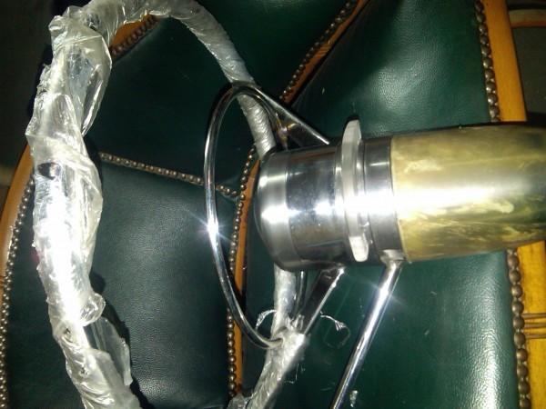

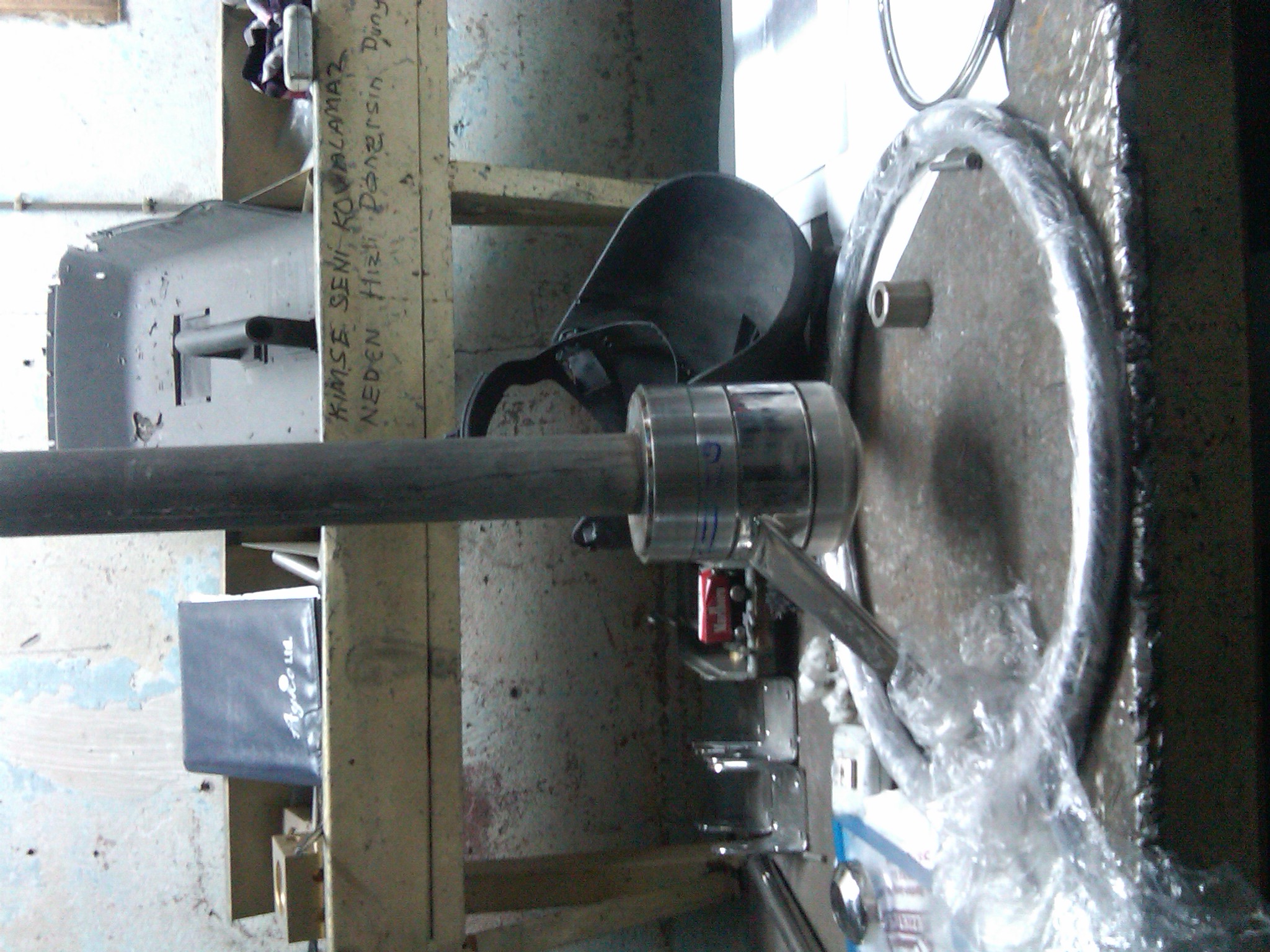

The machined steering wheel, rest is still waiting for finishing.

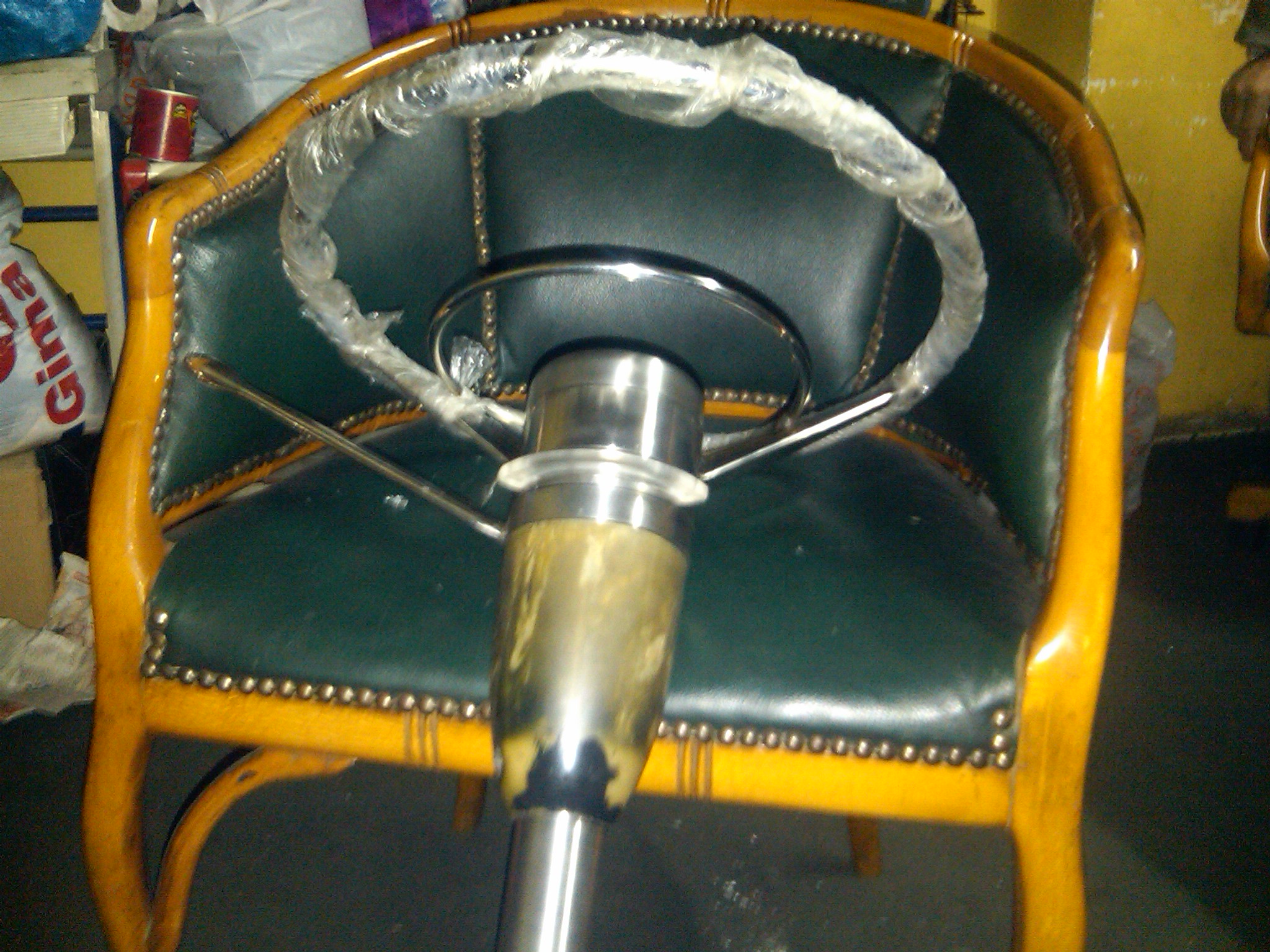

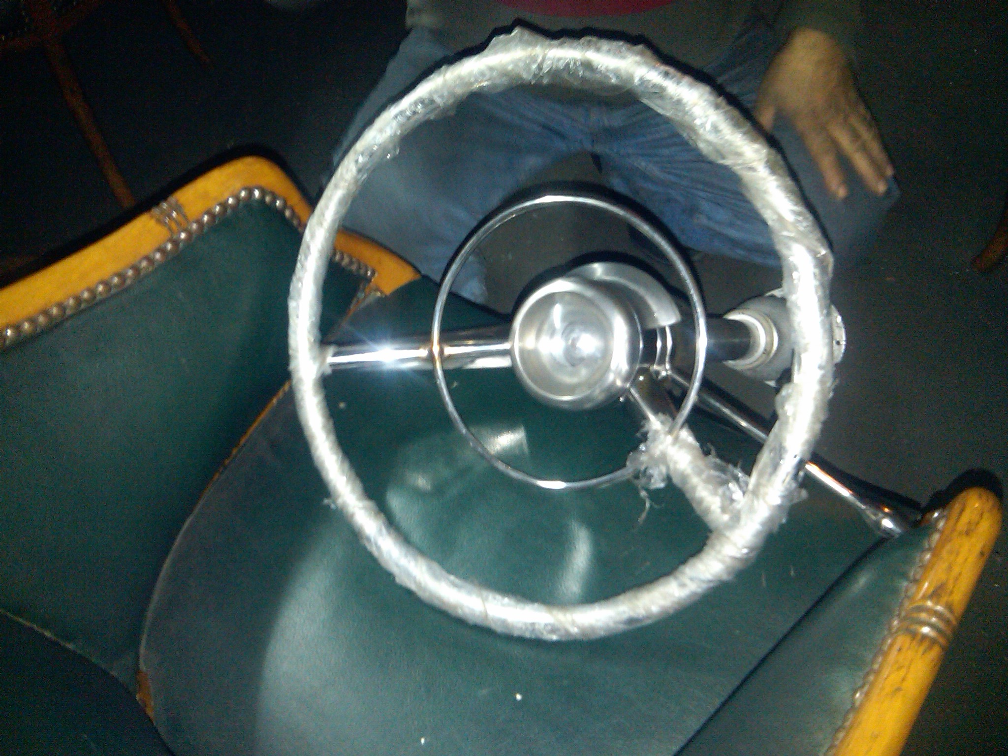

Some more photos for updating the progress ...
There is still some packing material on it for protection.
it will be removed, once we attach the leather.
b
b
a
a

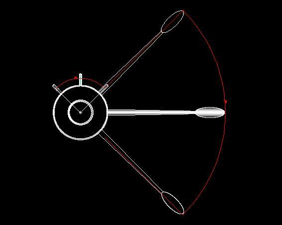

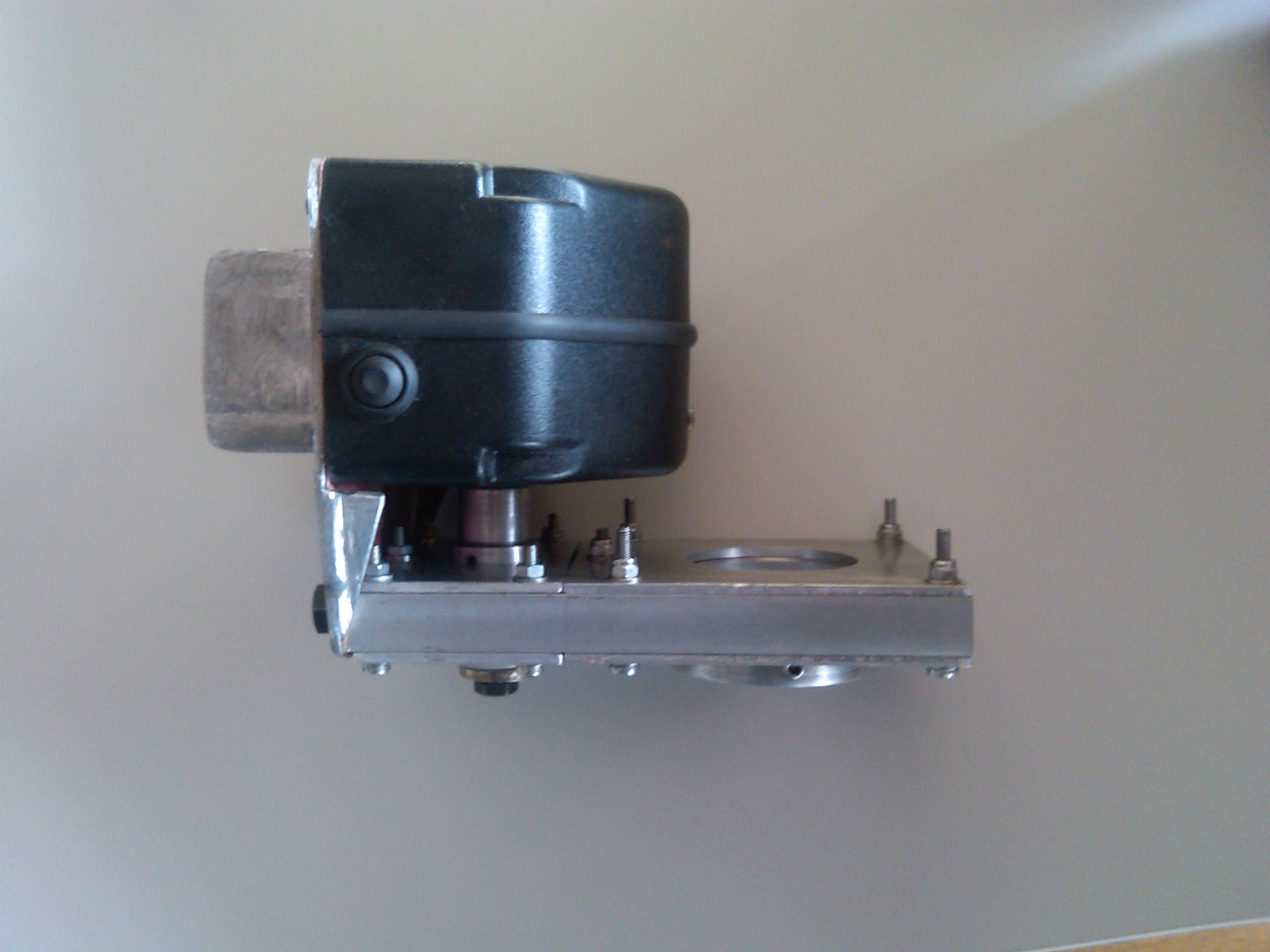

Lever moving 90 degrees
Lever Movement.JPG (16.52 KiB) Viewed 526700 times

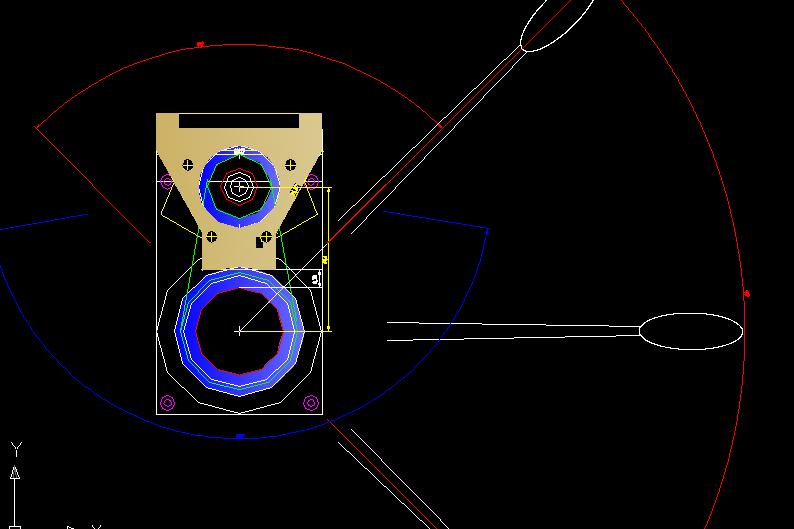

90 degrees is steped-up to 160 degrees to move a potientiometer of a ready control head lever (Mathers)
The movement is being transfered via toothed belt drive box.
Trigger belt enables the transmission

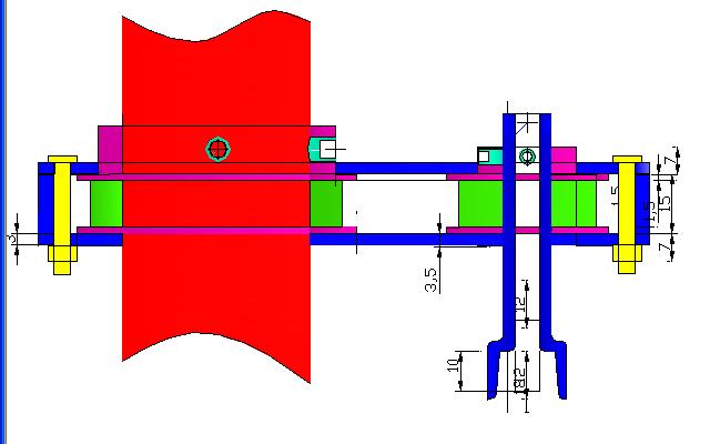

Revised mechanics.JPG (27.88 KiB) Viewed 526646 times

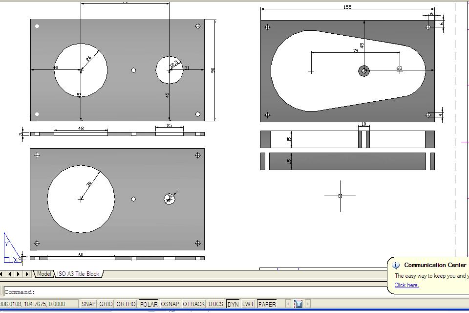

The box is out of aluminum and consist of 3 plates, bolts and nuts.
Here is the production drawing.

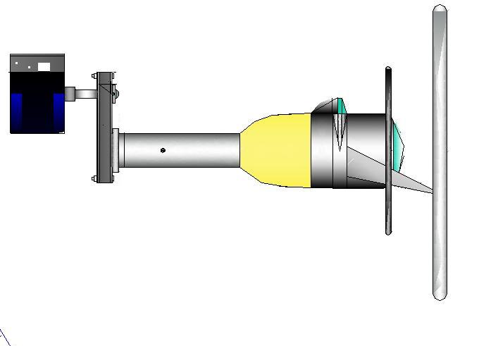

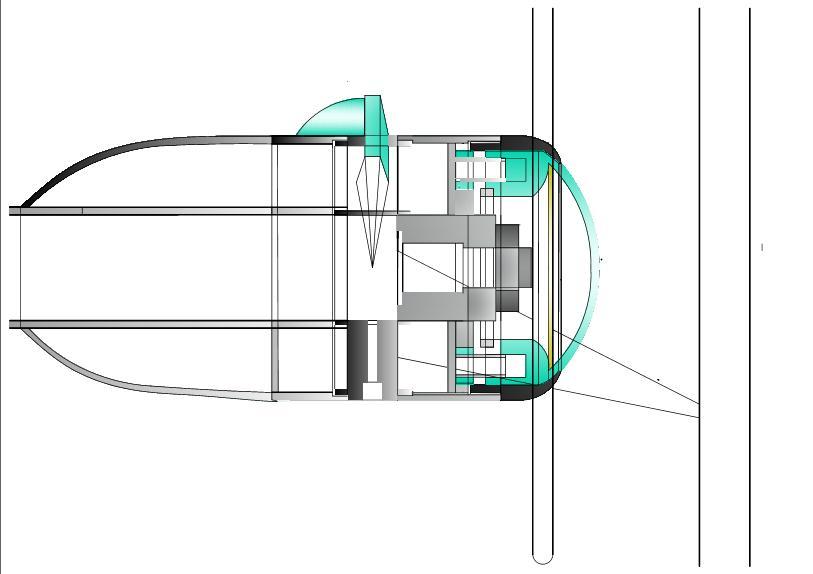

The mechanic transmission of the lever is being shown.
What is beige is the mechanism of the potentiometer.
Sectional drawing of the step-up box.

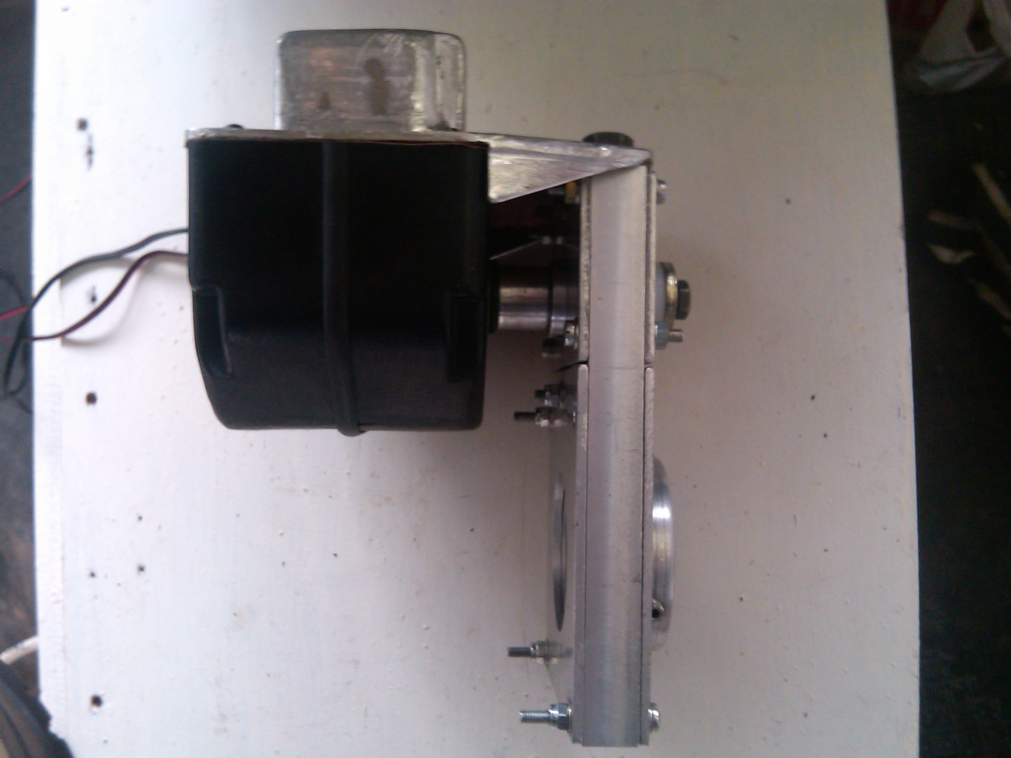

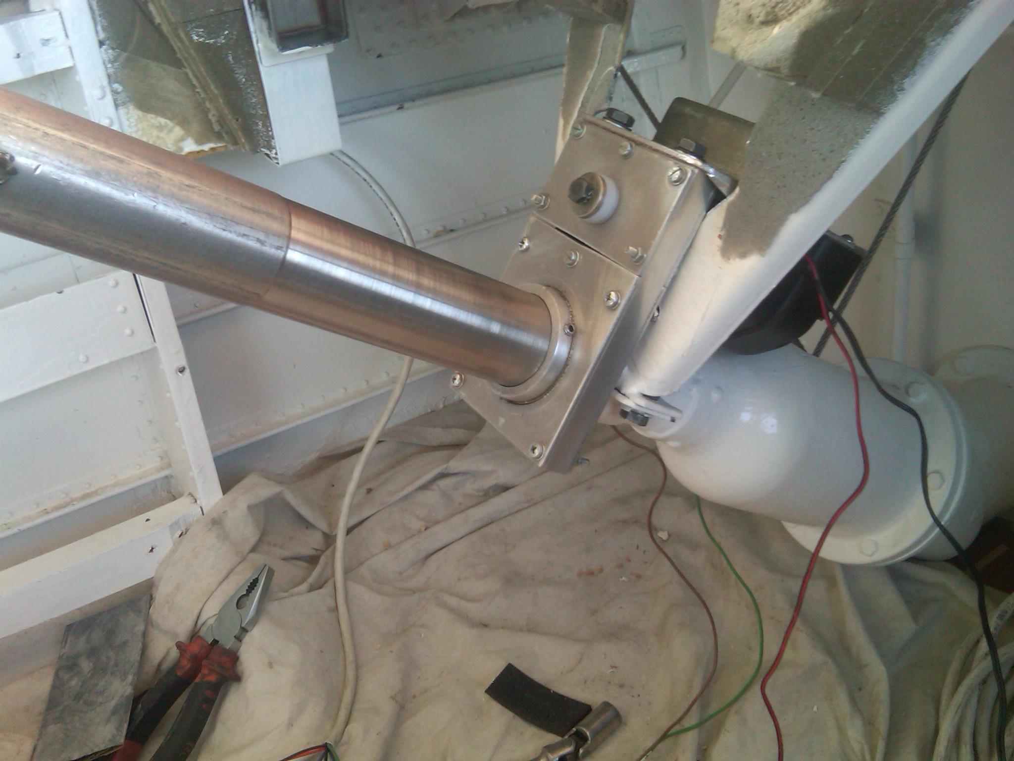

Done ...
Control transmission box
We were fearing that it will touch the shaft, but it was thouching the housing of the aluminium cast steering housing. So there were 5 mm to 8 mm too much we had to the jigsaw to cut it away. A cover was glued on the opening.

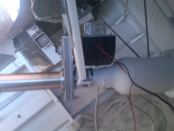

Posted: Tue Mar 08, 2011 7:45 pm
This is how it looks when the mechanism is installed.
Now waiting for the connection of the cables.
You have to imagine the same thing with the steering wheel mounted.
