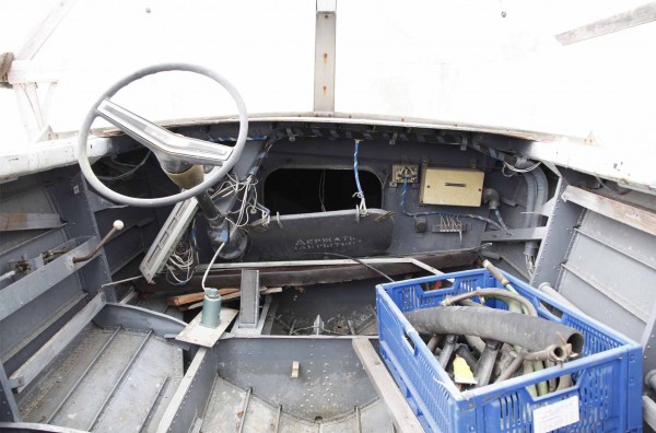

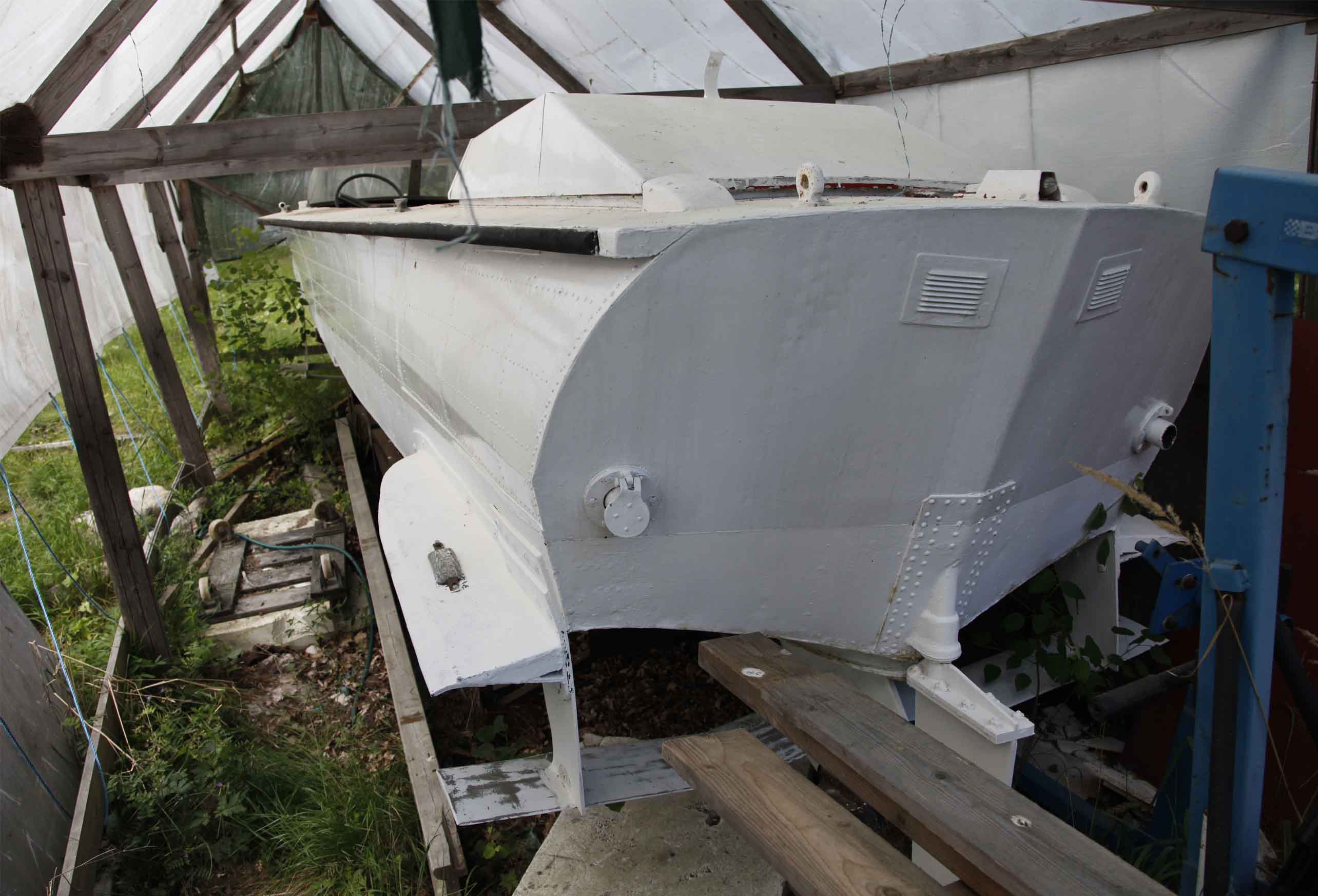

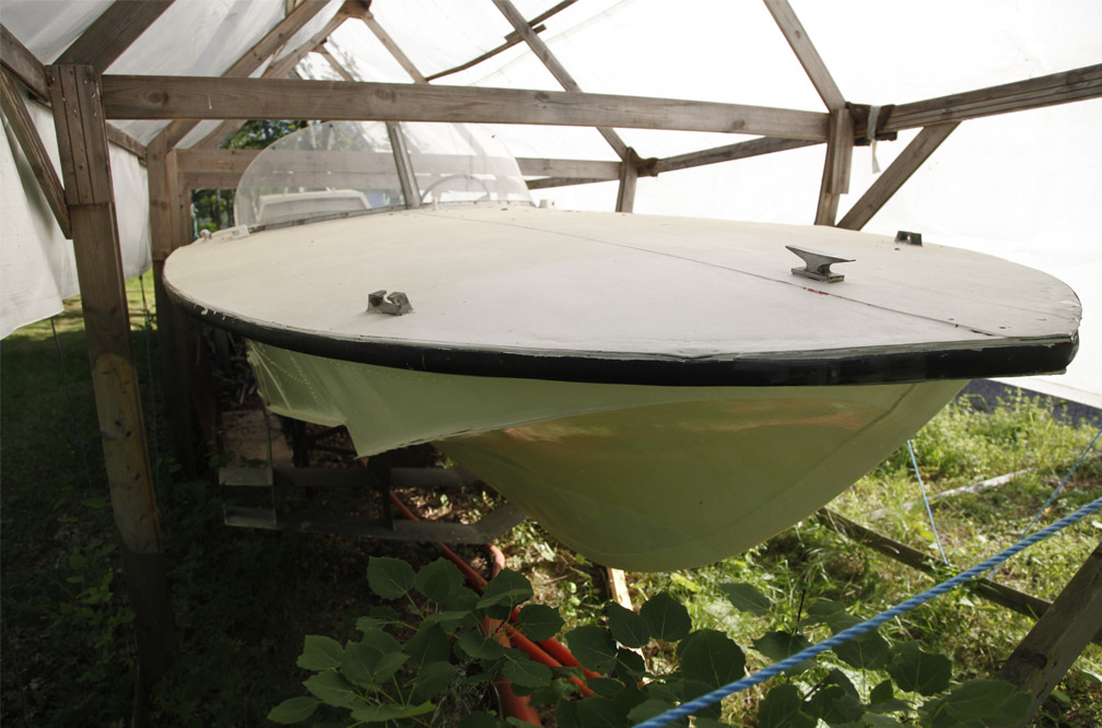

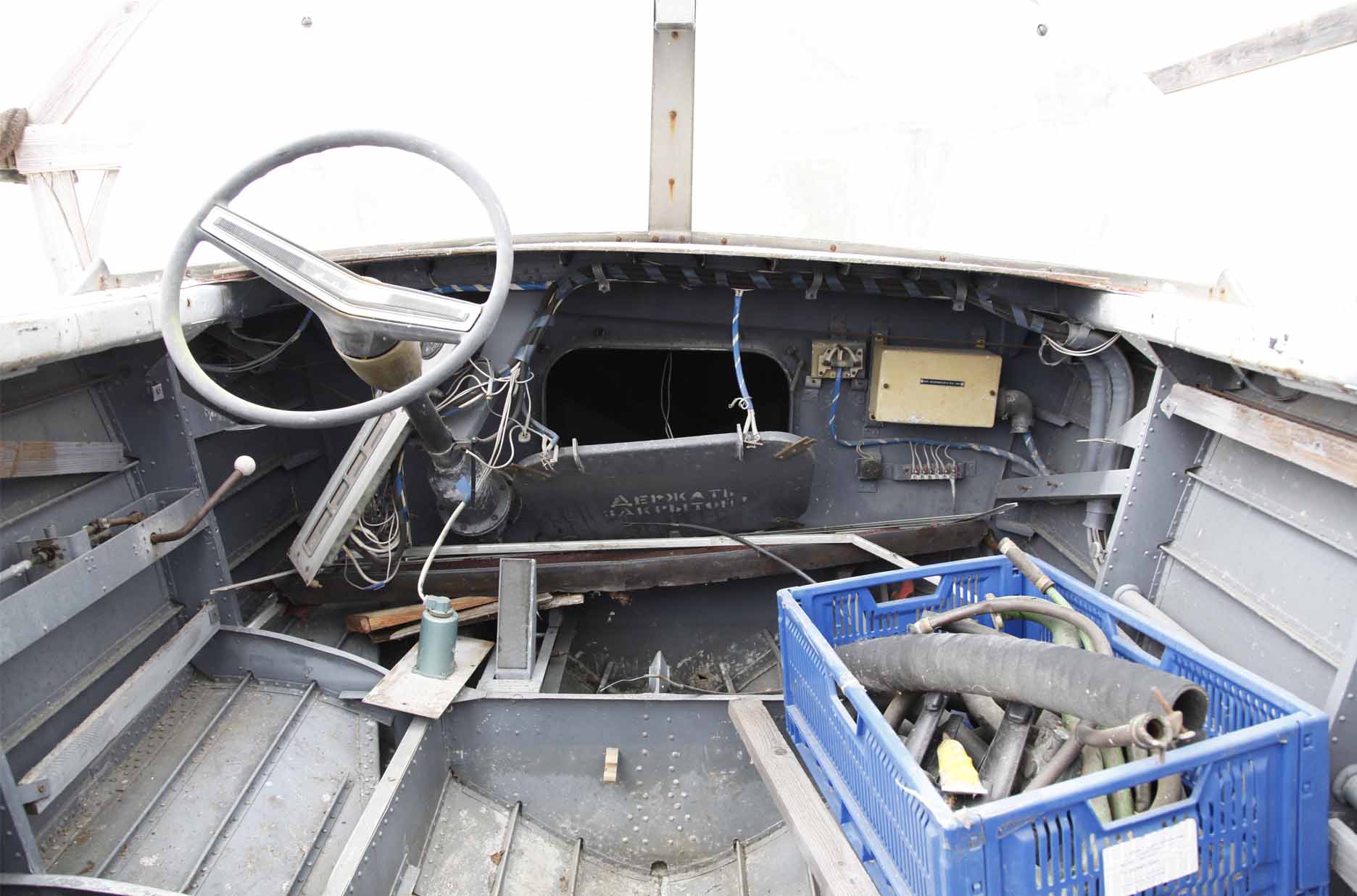

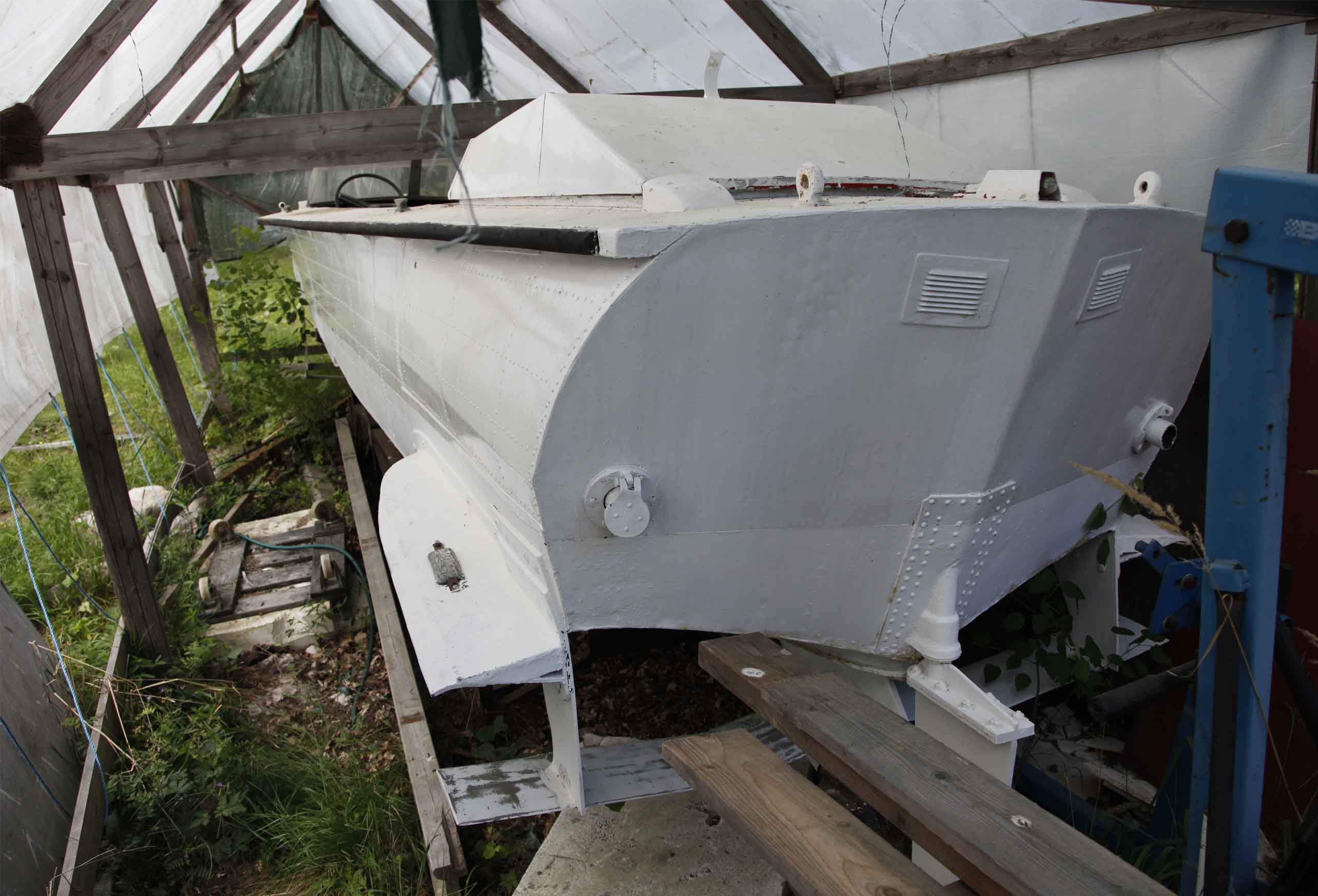

Found this old (1984) Volga close to Stockholm. The two latest owners haven´t even driven it. We now feel the presure and we need a lot of helf from you guys with your knowledge. We focusing now just on te engine, we got it with an mounted 350 v8 chevy. Never been running in this boat plus that we missing a lot of parts to make it run. Know looking for a diesel to install and yes we have been counting on it.
Hard do download pictures more will come.
Seems like we have some engine parts that we don´t have any use for....

Hi Alexander,
great find, congratulations.
The boat hull seems to be in a good condition.
You will have a lot of work ahead this winter in order to be able to sail the next summer.
A350 chevy engine is too heavy and overpowered for this boat.
It has been designed /exatly the foils/ to run at about 32 knots.
So you do not need such a power. The original GAZ 53V8 has an output of 100-120 HP depending on model.
In Bulgaria crate engines GAZ 53 are still to be had at E1900,- from the shop= factory new made 1980-1990.
complete with starter and generator.
Transportation is to be arranged extra.
But they are for trucks - not marinized. you must do this in a shop.
Another way to keep the original V8 sound is to use a BMW 4,4 or 3,0 V8 engine. or a diesel 6 inline BMW or Mercedes 3,0l not aTDI they are too expensive, if you have enough to spend you can save yourself a lot of truble and buy a marine diesel from VW marine or Yanmar - BMW marinized 2,0TDI. A 6 inline engine runs smoother it is internally ballanced - best choice./ well the best would be a v12 BMW, Mercredes or Jag/
Another option: find an old Lancia Thema V8/32 it has a Ferrari V8 3,0lt 32 valve engine very nice and after scrapping the car you will be left with an excelllent engine. Nobody will be having such a Volga.
Good luck.
Christian

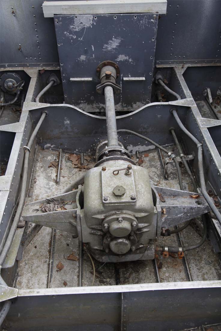

So how mutch did the original engine weight, I guess our boat hade an v8 Gaz 53 as it´s from -84, or am I wrong. 400 kilo??
BMW marinized 2,0TDI, best therefore it´s quality or therefore it fit the best
I would prefer to keep as mutch as possible original as gearbox, don´t want to rebuild everything.

Hi Alexander,
the GM 350 Diesel is the nightmare of every mechanic or driver, on both sides of the Atlantic.
It has head problems - the cylinderheads crack! A lot of vibrations. Too heavy ! A friend of mine had a Cadillac diesel with this Oldsmobile diesel engine - a lot of prblems even after rebuilding it with original parts from the US. He scraped the engine and put a BMW 4,0 V8 turbo diesel with new gearbox and now is happy.
The original GAZ 53 engine is 270 KG. with all generator,starter and flywheel. It is made of Alu.
Even a Vancini or a Perkins 4-212 4 cylinder engine from the 1960 are better!!!
Scrap the 350 diesel and put a normal Mercedes 603/ 605 3,0 TD. It has 140HP and 28KGM torque more than enough for the Volga.
Original Volga has 100-120Hp/3200Rpm and 28-30 KGM/1800-2200Rpm.
But if you want to have a quiet engine you must go for a petrol one.
Any engine inline six BMW or Mercedes 3,0 lt would do.
In Sweden you have very nice Volvo 6 cylinder engines.
A 5cylinder turbo from Volvo V70 would be good too. You just have to limit the revs to max 3500-1Min. in order to use the existing gerbox - V-Drive. or take a ZF gearbox from Georg , he knows them best.
