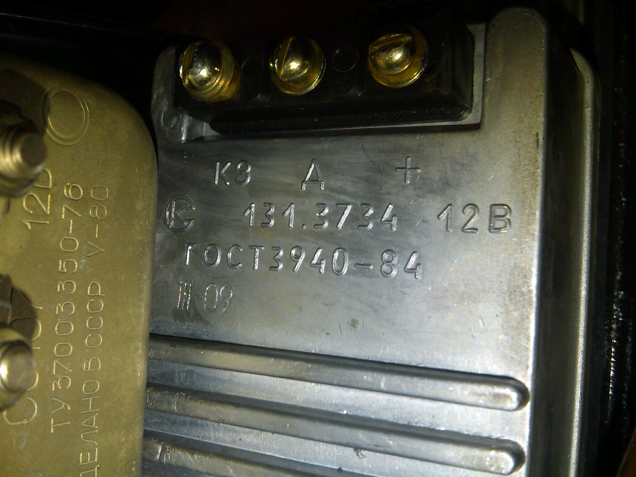

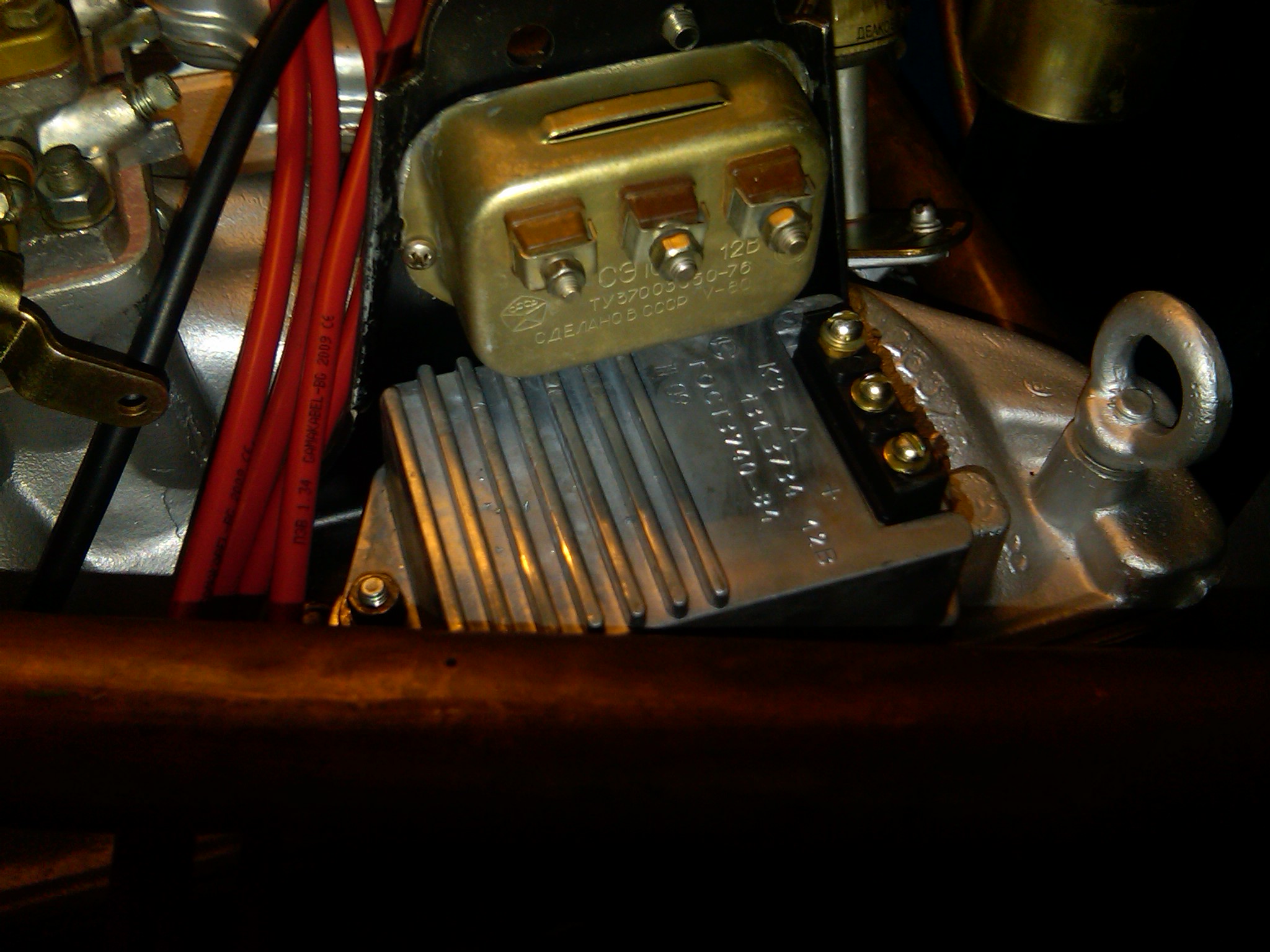

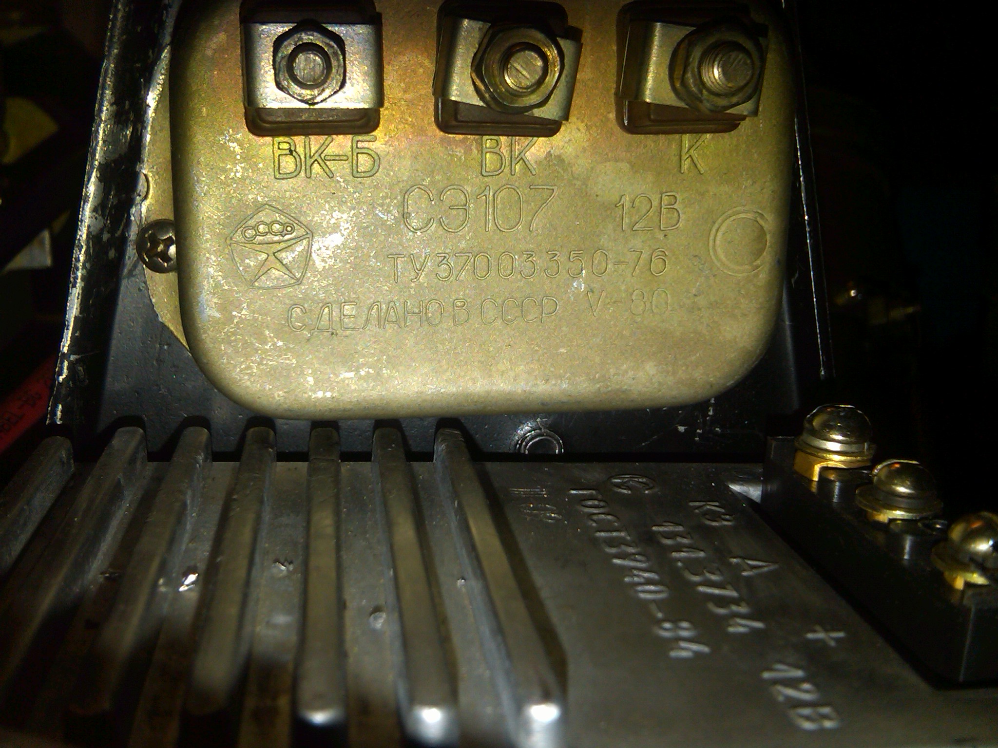

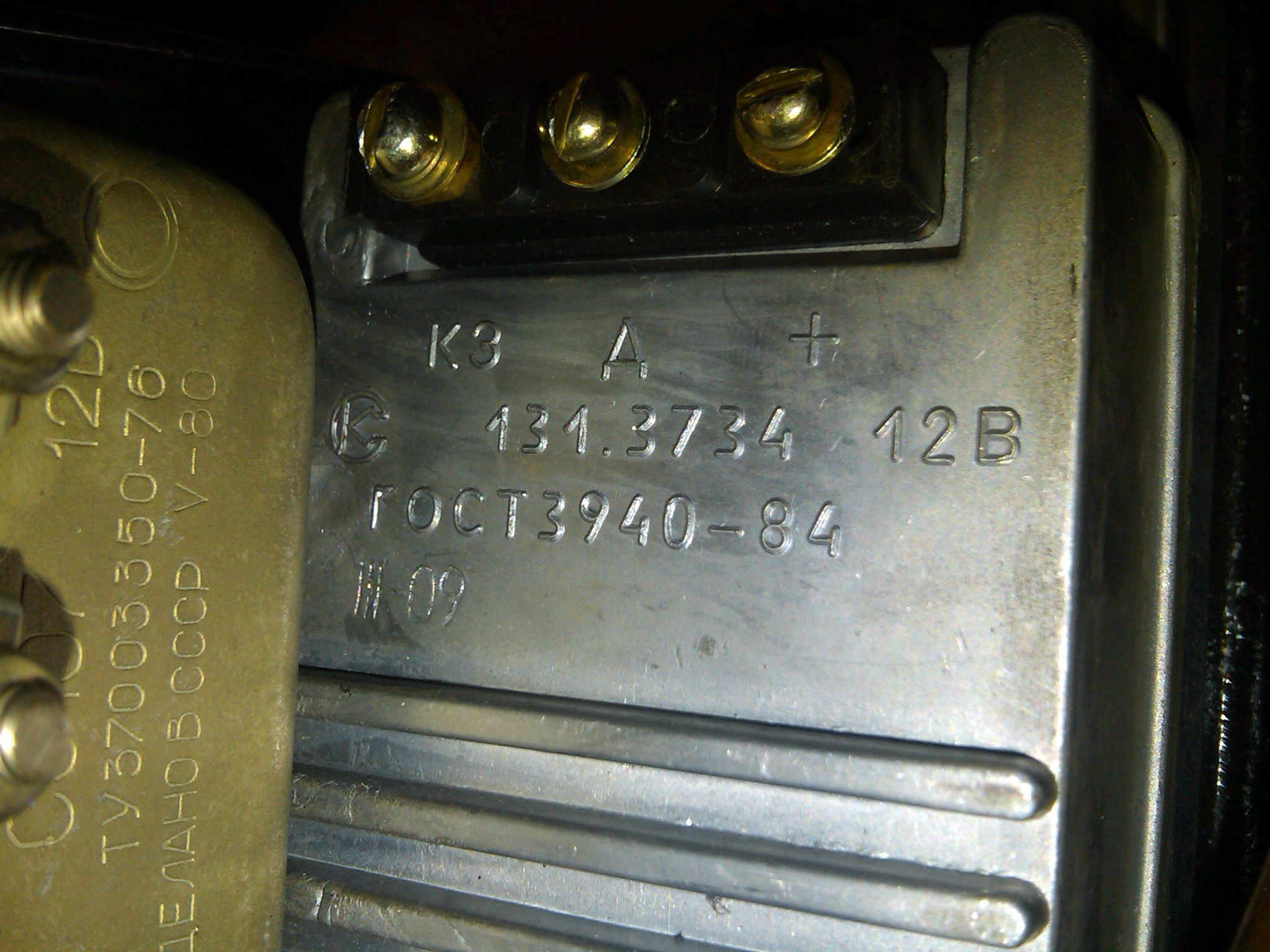

Like described before, the spares came without any explanaiton regarding the connections of the bought equipment. The same problem we have with the Electronic Ignition and its parts. We need to know the correct cable connections for this equipment. Can anybody advise?,
The owner of the workshop where the engine is overhauled is very experienced with US, English and German engines, but has never seen anything like this russian electronic ignition equipment. Where normally Western brands use only 2 connections the russian have here 3. The signs are cyrillic and the letters are nothing what we can give any meaning at all. Can anybody help/pomosht.

There are some more photo of the distributor itself. On it writes in cyrilic Delko Elektrono GAZ-53.

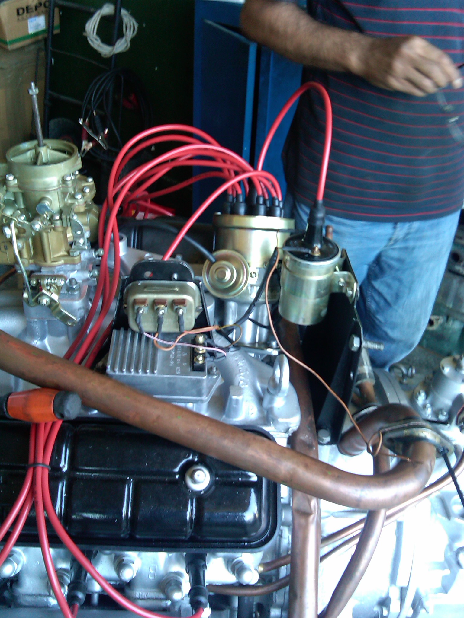

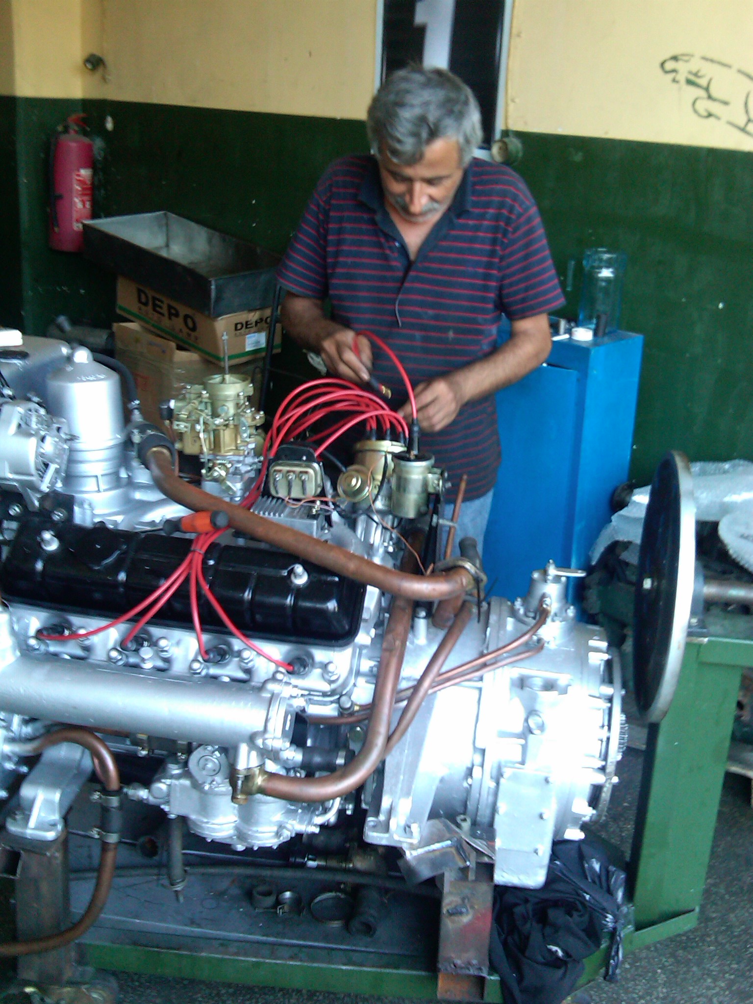

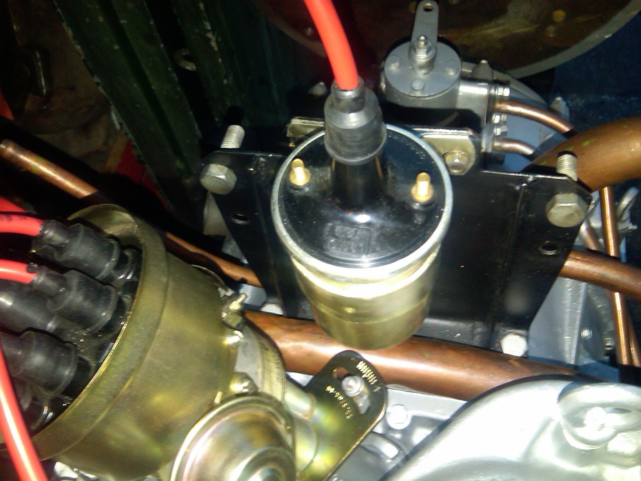

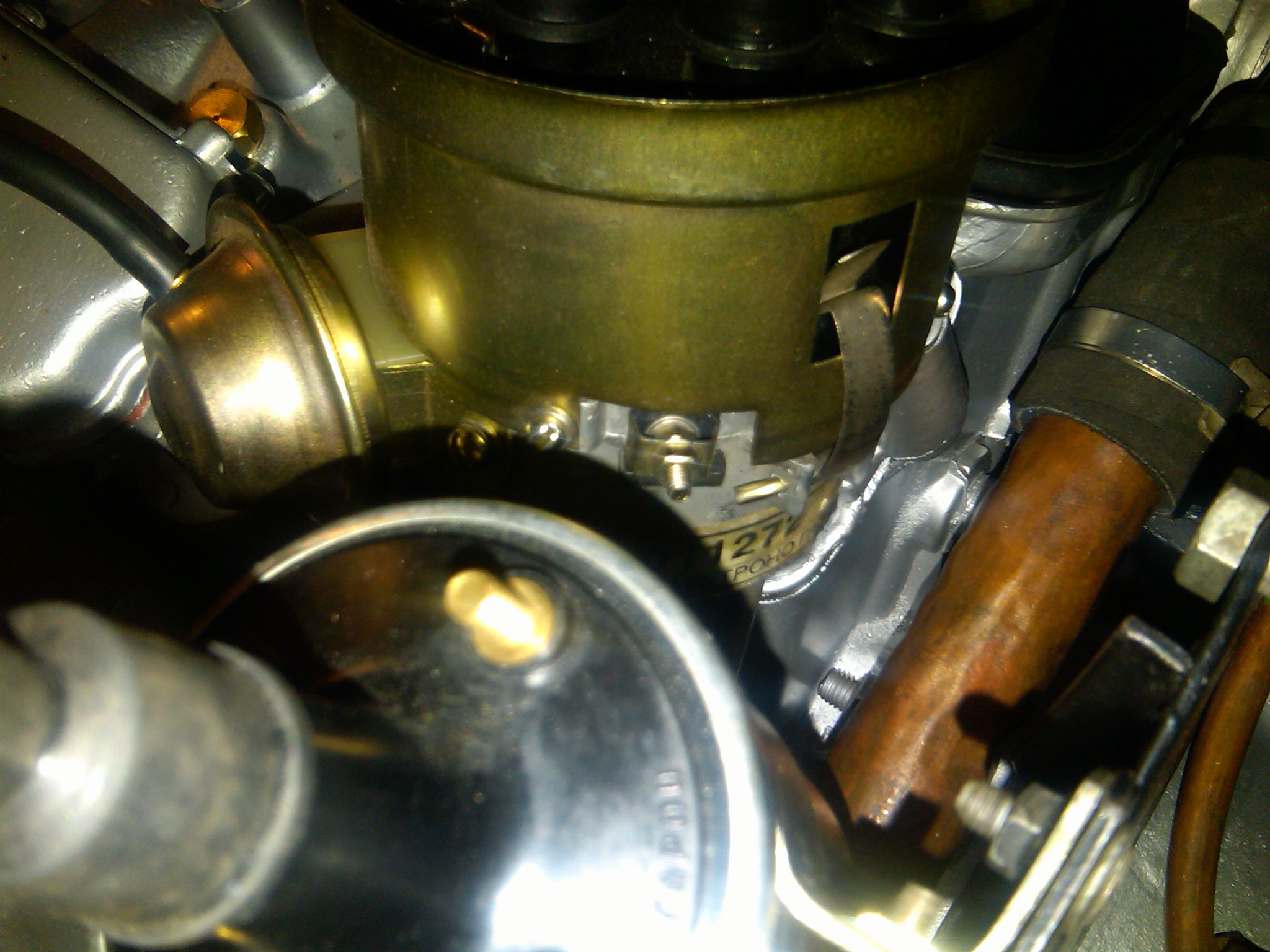

We had one Usta (Maestro) coming today to visit the workshop.
He measured and connected everything.
I think he solved the problem
.... atleast this is what we can see here... !

Post by christian tabakoff » Thu Aug 19, 2010 8:29 pm
Nice pics. Joro.
usta did a good job, very tidy!
I like the copper tubing for the cooling water.
and if it runs like it looks it will be great!
does the engine have a hydraulic clutch? converter? it looks so. Than this expalins the 405 Kg weight of the engine...
