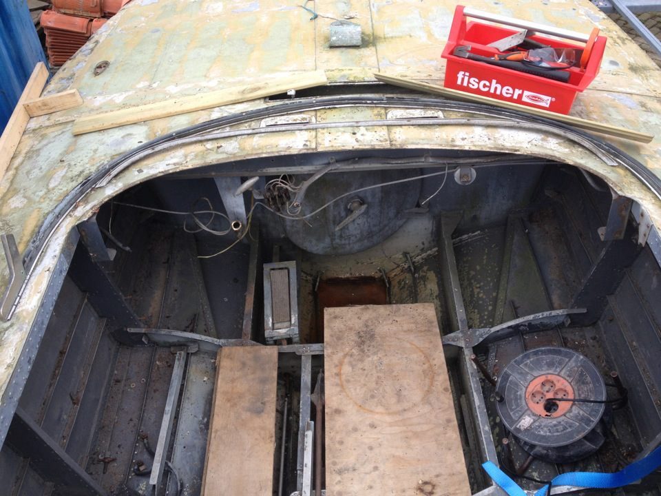

As the weater is getting beter here in Holland,
Today i took out the dashboard..
Mark..
