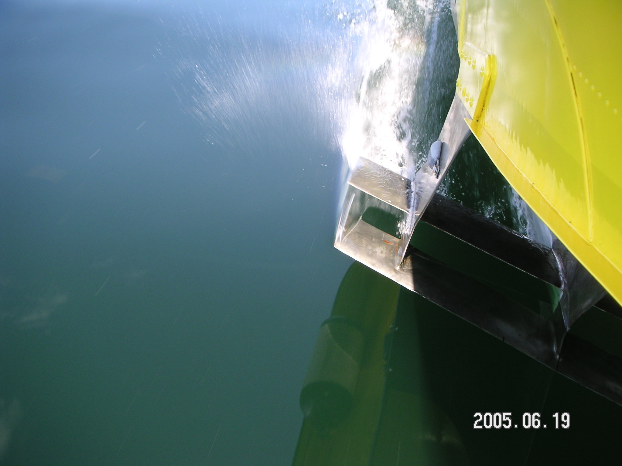

I´m using ordinary 1 Kg zinkanodes for less then 10 euro each on my wings (one on each side). In south Sweden (it´s not very salt water)it use to go about 1/2 Kg for 1 season in water. Because of the low price I change every season. The hullanodes use to live for ever in this water..
