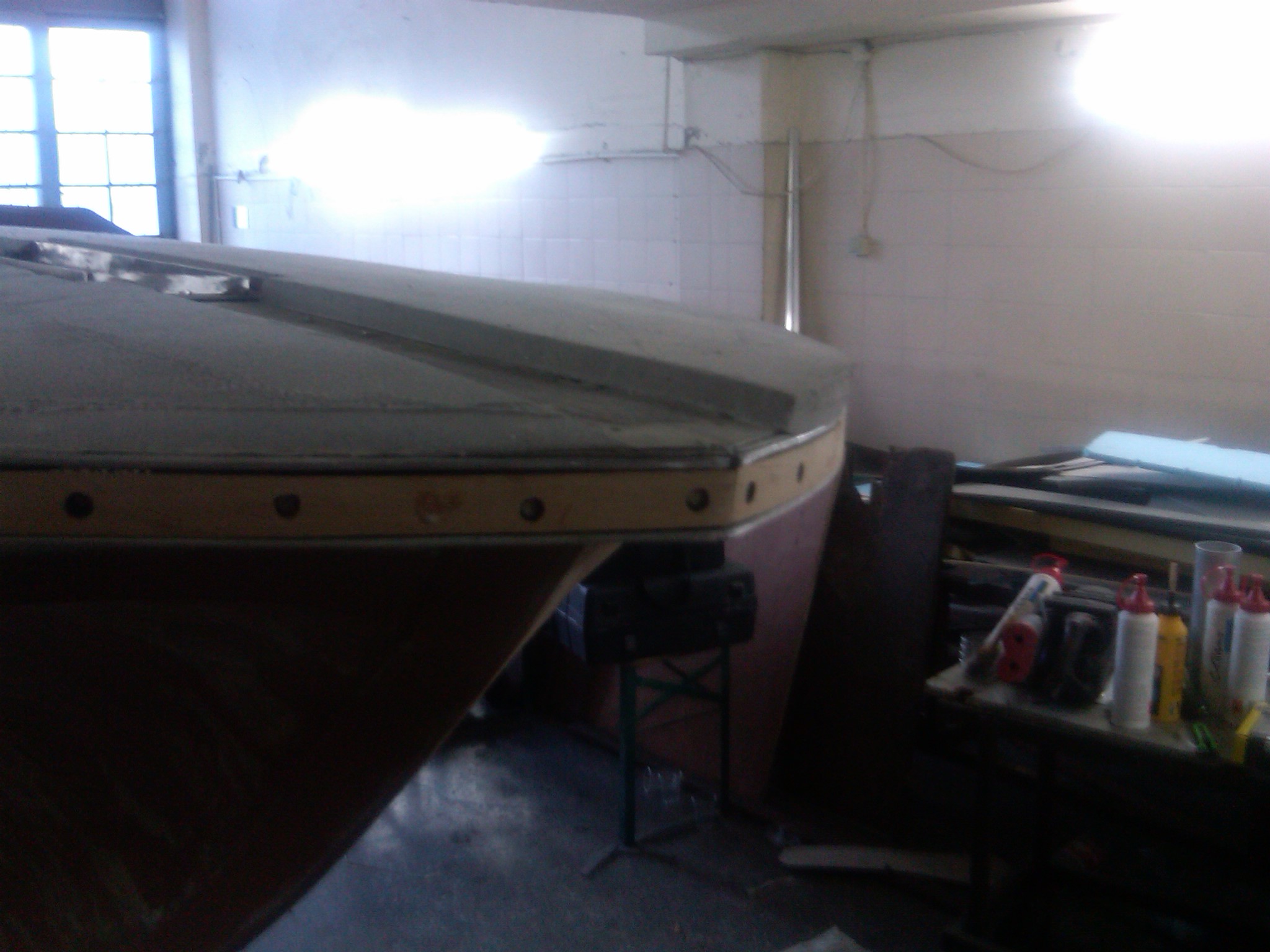

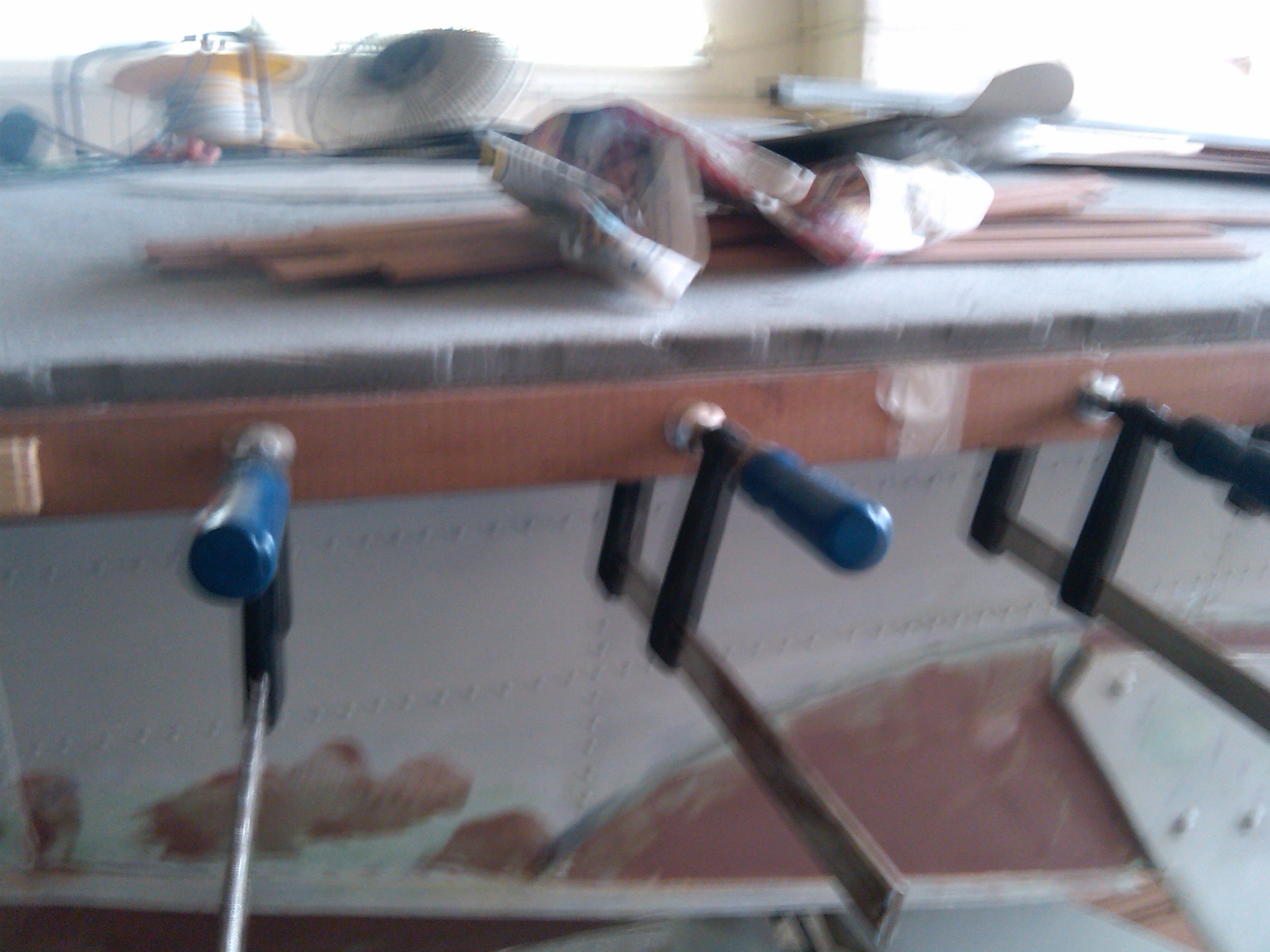

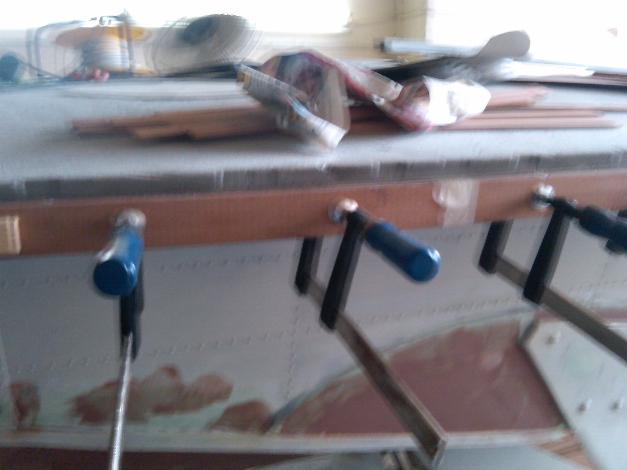

Finding the same or equivalent profile has not been possible here. A rubber hose would have been possible but at that time I already made up my mind for the wooden deck. So we filled the channel with strong oak wood and screwed and glued mahagony wood on it. (Picture should be known to you from ''rounded top w...''

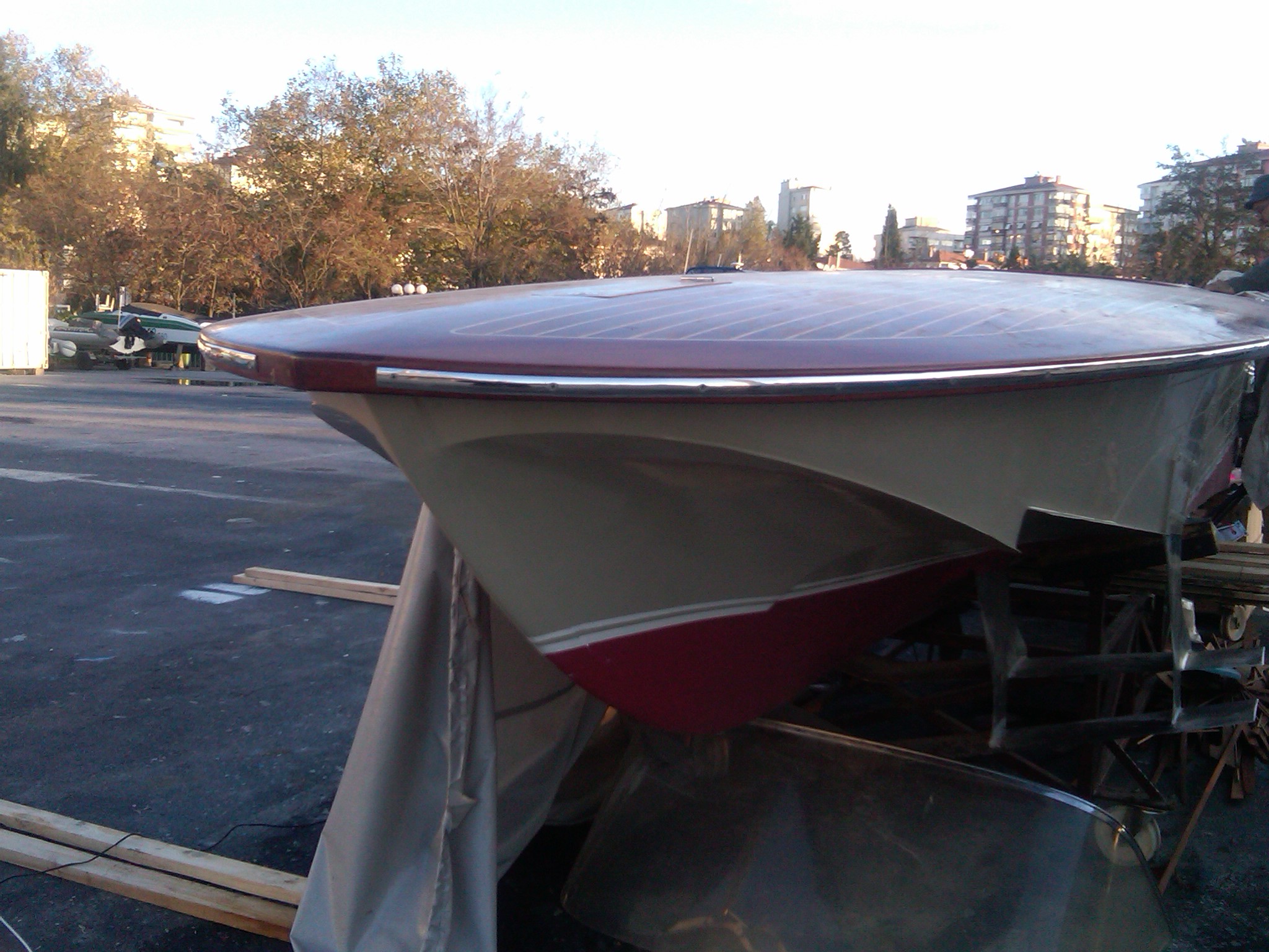

On the next picture we see the stainless steel rub rail attached.
