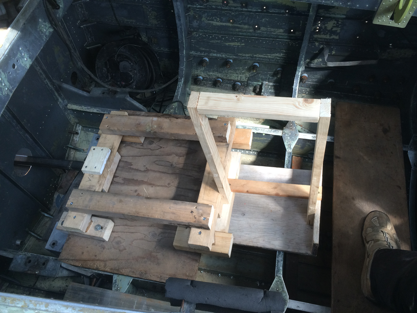

setup
setup
So after some hard thinking with a "wooden" engine the 603 was to high to fit anther the hood.
I had to lower the engine.

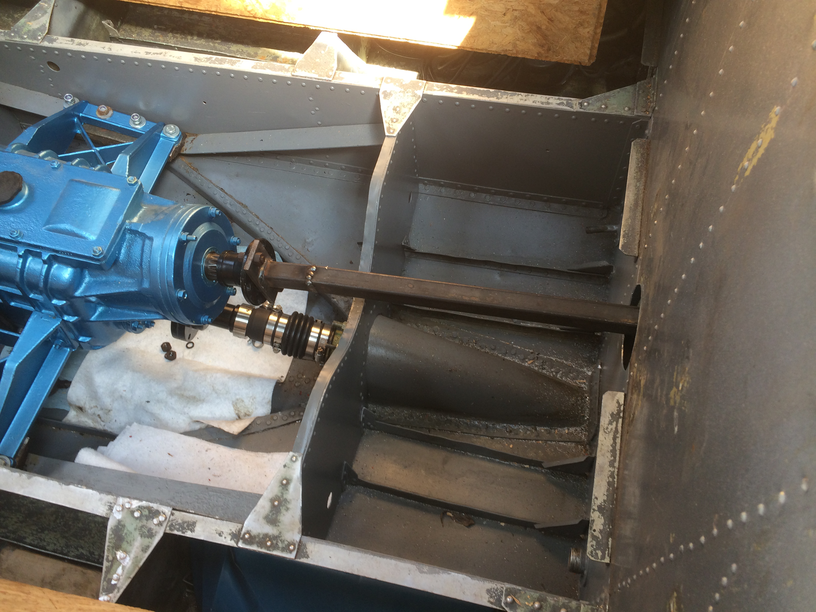

And keep the angles of the shaft( CV-joint like a Aqua drive)between the Vdrive/Gearbox at 2º.
The Cv-joint will be in a W setup.

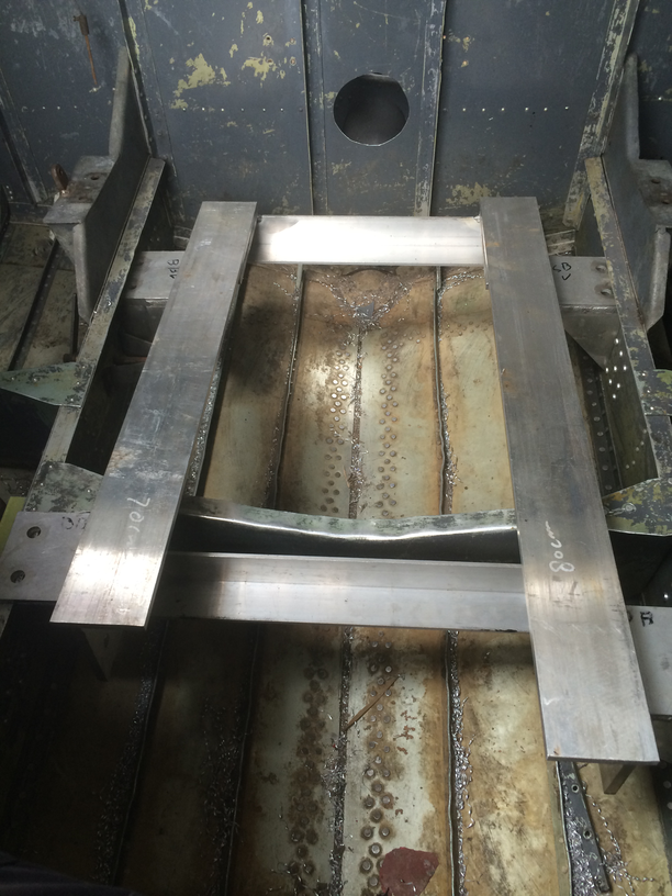

I made a fixed mold.

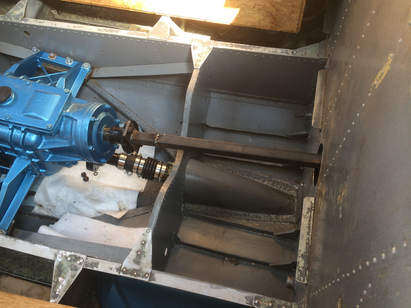

Setup Shaft
Setup Shaft

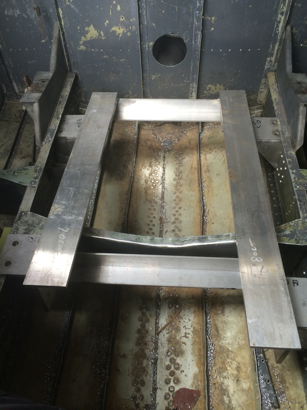

And this is what is is now..
Fundation
Fundation
