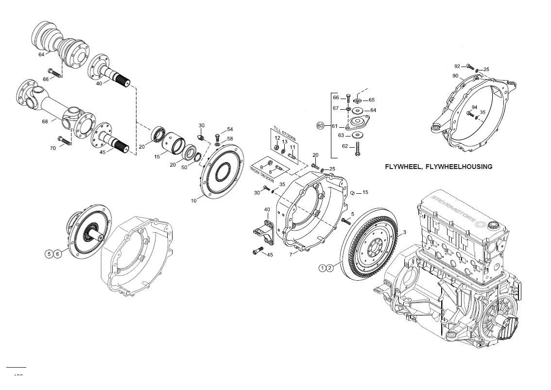

Your statement that ZF 63 series are flanged on engines is correct. The ZF 63 IV is an so-called integral v-drive to flange on engines. The ZF 220 V is a remote v-drive. Being an integral v-drive this does not mean, that you can not use the ZF 63 IV in remote V-drive configuration.
Like any other remote V-drive the ZF 63 IV is to be used in combination with a propshaft coupling and should also have an integral shaft support. This configuration lets someone use the original bracket and shaftline and differs from the original setup as you replace the russian v-drive and the russian gearbox with a single ZF 63 IV gearbox. The propshaft + integral shaft support should be however obligatory to use.
An integral shaft support is an aluminium bell housing including a coupling and a short stub shaft with flanged output. This bell housing has a bearing and a bearing bracket. Reason for use of this integral shaft support is to support the heavyness of the prop-shaft (cardan shaft) as such additional weight will definitely DAMAGE the bearings of the engine if not used.
Most modern marine engines do already have SAE connections and the bell housings have the same SAE connections too, so there is no fitting or fiddling trouble. Integral shaft supports are produced by companies like VULKAN, STROMAG, CENTA or Rexnord or REICH (these ones are known to me). I will add a photo of such support for everbody's reference.
The use of the heavy old fashioned ZF 220 V is absolutely unsuitable. Modifications on the ZF 63 IV may be to dismount the unuseful bellhousing or cut it off.
Once changing the original configuraton I would recommend to change also to a diesel engine. Preferably one with revs that are less than 3000 rpm.
Only the change of the gearbox + v-drive into ZF-63IV should save you approximately 50 kg.

Hi All,
Someone recently asked how to connect an engine with the remote v-drive gearbox type ZF 63 IV.
Every engine has to have a coupling between itself and the gearbox. A remote V-drive gearbox needs a prop-shaft (Kardan connection element).
http://www.vulkan.com/fileadmin/product ... 20data.pdf
Above link is from a well known german producer of elastic couplings. Integral shaft support is a bellhousing attached to engine containing the flexible coupling and a bearing for carrying the weight of the prop-shaft. If this item is not used, the weight of the propshaft might damage the bearings of the engines crankshaft. The integral shaft support can be skipped if the propshaft is very short and/or light (Epoxy Carbon Fiber tube).
The propshaft itself has to be provided from somewhere else. It might be also possible to use the old Russian shaft which has a gear coupling.
There are also other bidders for such items like Reich, Centa, Stromag, Rexnord or similar. Vulkan might be the most expensive of all. I estimate a cost of approx 700 EUR for coupling and bell housing. Another option could be a Python or Aqua-drive with machined connection to the engine and a prop shaft.

Re: Overpowered versus Light
This picture shows an engine assembly at the vicinity of the flywheel.
You can see an integrated shaft support, cardan shafts and other elements:
