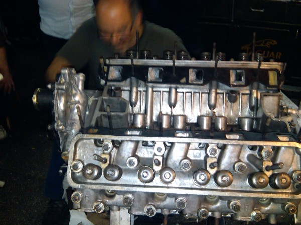

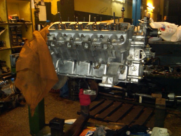

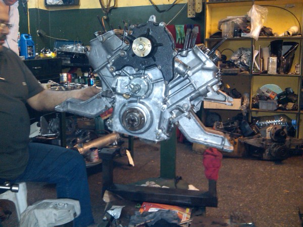

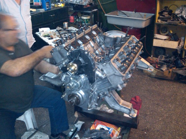

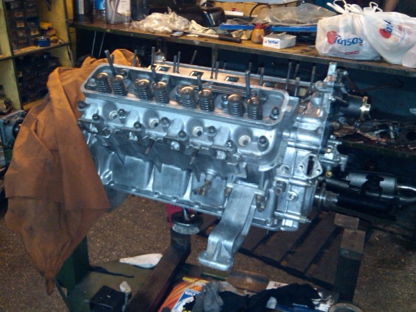

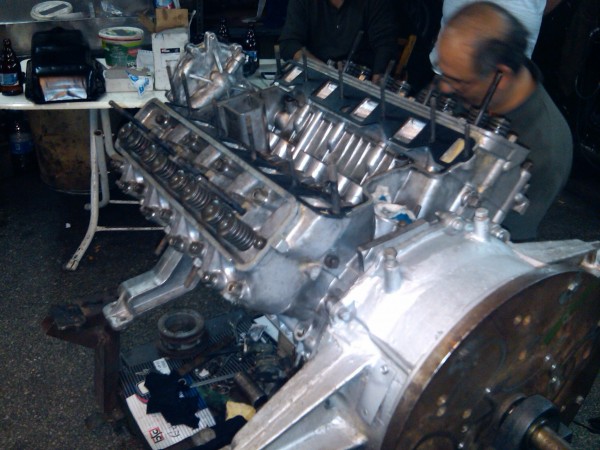

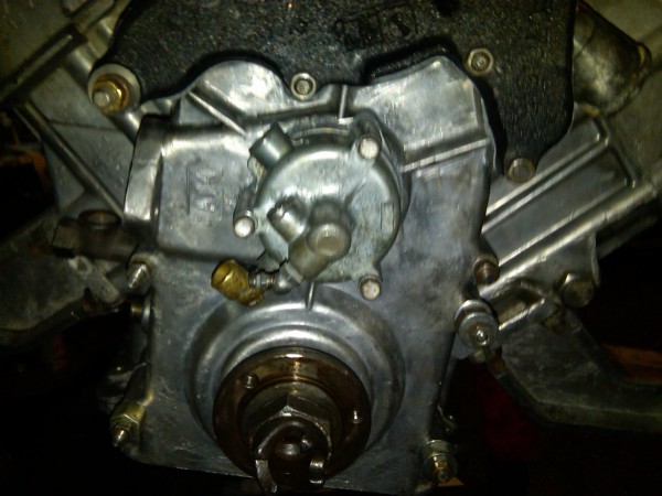

Thanks, 2010 started with raises on fuel. )) We started rebuilding the engine. It gets electronic ignition with 35000 Volts for better spartking and burning. I was promised for this a minimum of 10 and max of 20% more power at same consumption. We are also going to polish all inlet piping of the inlet manifold and maybe even install a 4-barrel carburator, higher capacity/pressure oil pump probably ensures better performance. I ran thru similar things when I had my Enfield Bullet 500 for which EGLI equipment was available. EGLI (CH) was able to tickle the double power out of the indian engine. Are there any data available for original fuel consumption at different knots?
According to my engine work shop the engine should have capacity to be tuned up to 300 HP and more, if all tricks are being chosen. My aim is only good performance at same consumption. Sooner or later I will also end up with a new diesel and a ZF 63 IV gearbox. For the time being I want to give the ZMZ the chance not to disappoint me. I'll be fine with 150 HP, only.
Did you ever operate the ZMZ V8? Was it so disappointing or was it only fuel cost without limits?

Marhaba komsu Weinstab.
I am looking for a Volga boat and drawings too.
The GAZ 53 engine is a very reliable engine. Trucks in Bulgaria have been covering without engine rebuilding 800 000 - 1 200 000 Klm.
It has some drawbacks:
It was built in an era when gas prices did not matter .
It has a low compression 1/6,8 -1/7,2 and so is very thirsty.
Here in Sofia and other cities we have made some improvements to our GAZ 66 trucks and motors:
1- shave the heads in order to increase compression to 8,8 -9,5
2- put some oilsimmerings on the valves - not a factory option - thus reducing the oil consumption, /blue smoke on new engines and older ones/
3 - polishing the heads and intake plenum under the carburetor.
4. new sleeves and pistons - Bulgarian made - they hold 2 as long as original Russian.
By the way some of the factory assembled engines come with Bulgarian pistons and sleeves.
5- new spark plugs - try" champion double platinum" - the engine was changed, very good with a 100 000 Miles guaratee in the US .
You do not need a 4 barrel carburetor, the original 2 barrel is good enough.
The engine is capable to deliver 300 or 500 HP but the life will be very short, the block is not stiff enough.
The heads will flow and hold, but not the block, than you will need new performance pistons - could be ordered in the US as custom build but too expensive.
After the head job the engine will be 150-180 HP at 3200-3500 RPM, if you get rid of the rev-limitter you could run up to 5500-6000 RPM, but after a crankshaft balancing.
How far did you get with your engine rebuilding?
We have here ST. Georg's day and until Monday all is closed.
If you need Pistons, liners, main and big end bearings and a gasket set I could check next week.
The Bulgarian made pistons are standard, and oversize 92,00 and 93,00 MM
The standard sized come with liners, for the over-sized you must bore and hone the old liners at your engine shop.
There was a company selling complete crate engines GAZ 53 but I do not know if they have some left./ they came with starter, alternator, ignition, spark plugs - a complete bolt - on engine./

Restauration of a GAZ 53 L, V8, 4,3 litre engine
First of all, I would like to thank all participants forwarding me information about my GAZ 53L engine. I have so far found all parts and engine is complete now. Engine was completely taken appart, all pistons, liners, bearings, valves and valve seats have been renewed.
Carburator was bought new & and electronic ignition has been purchased.
Yesterday we made the decision also to renew the anchorage bolts for holding the cylinder heads. The Aluminium material of the motorblock proably already got weak with the age and we had 3 - 5 bolts no more tightening, which were tearing out the aluminium threads at 7 bar. We exchange them now with new bolts that are 1/2'' or 12 mm diameter and insert threaded steel bushes, thus enabling us to tighten to 11 bar. The valueable hint came from Crhistian (from Bulgaria). The Bulgarian which still have a high number of old Russian Machinery had to find their way to make them work properly with the European Comunity rules, where they were no more able to buy the
76 oktan fuel. So they increased the compression ratio from 6.7 to 9.5 or even to 10.5. The result is an engine which they say developes
150 - 170 HP at 2800 rpm and this by consuming 15 - 20% less fuel compared to the regular engine.

Re: Spares for GAZ 53 L, V8, 4,3 litre
Hallo Georg, this engine rebuilding looks well done.
I hope that you will get the desired results.
The engine looks clean .
The bolts normally hold.
If they come loose it is an indication that some idiot has been tightening the heads without using a torque wrench !
Well It has been a common problem here, as the saying is : "tighten the screws until they tear and than give back a quarter revolution!" Normally when tightening some block or engine-mounts made of ALU the result is destroyed threads = somebody has been "screwing around" the engine!!!
Use also "Loktite in the red-bottle" for the threads.
This is the newer engine with the paper oil filter. The insert is to be changed every 90-100 working hours.
First oil change after rebuilding in 5 H, second after 20H. with insert.
Oil 10W40 or 15W40. DO NOT USE SYNTHETIC AS THE SEALS WILL LEAK! Just plain old dyno-oil or semi-synthetic after the 1 and 2 oil change.
As to the replacement of the old pushrod ZMZ 53V8 with a modern marine- diesel , well I would not do it unless I am running a commercial operation with this boat.
Just check the prices for a marine-diesel at VW-Marine or Yanmar -BMW engines!!!
How many hours at sea would you need to break even? Just do the math and post the results.
I am curious about the results.
Hi Christian,
The drawings I have sent to you already. They are all AutoCad 2007 format. Boats are not available in Turkey and you have to find them
in CIS Countries or from someone in Western Europe. Any encounters of offers I will try to forward you. You should also make a request in the ''Buy'' chapter of the forum.
All anchorage bolts have been changed already and we are able to tighten up to 11 kg, if necessary. Do you have a proposal for the
cylinderheads ideal ccm for compression ratio 9+?
There is one part, above crankshaft and below FW pump, which we could not give any sense to yet. It has been disassembled and cleaned but we were unable to say concretely what it could be. We assume that it is another revolution counter? You can see it on the photo below. Can you advise function of this please?
Hallo Georg,
1.-this is the factory installed vacuum- rev -limiter.
It is connected via a copper pipe to the carburettor. It cuts in at ca 3000 -3200- RPM.
If you do not connect this tube, the engine can rev up over 6000RPM and it will break.
I hope that you have good rev-meter on the dash -board, just keep the engine under 3500 -1 at top speed for under 10-15 minutes
Cruising speed should be kept at 2200 - 2800 Rpm.
Have you increased compression? How much?
2.-The heads are to torqued - 6,5-7,5 KGM. / 65-75 KN/ This is an Alu-block and not a nodular cast iron diesel that you can torque over 12 KGM! What bolts do you use ? MM or Withworth ? 12 -14MM?
11 KG is too much even for 12 MM bolts, but as you have done it already, keep it, otherwise dismantle the heads and change the head-gaskets.
3.- first measure the combustion bowl of the head. std 68 -73ccm.
you can shave max 2,00 mm. if you want to shave 3,00 or 4,00 mm you must weld some parts of the head , only if you have done this previously you can do the job. If your mechanic has not such experience with heads, you better leave it. Great possibility that you will end with search for new heads.
Well they are not expensive like BMW heads but anyway I have posted you the prices for new heads and machining.
