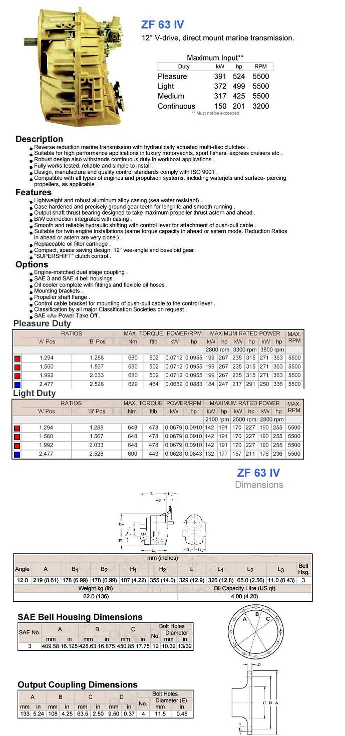

Thanks for your hints regarding the engine and their spares. It was really useful. Due to turkish customs complications, I however will purchase the spares rather than a new engine. It is also cheaper and my heart does not allow me to through away an engine just because it is needing some spares only.
Regarding your Nevka transmission and spare parts if needed. Should you really have problems reassembling it and are in need even to replace it, let me know! I may try to find you a brandnew ZF gearbox for replacement, if you let me know your reduction ratio. You may get it then via your local dealer.
The enclosed picture is for a V-drive suitable for Volga and you may use it with a gasoline or modern diesel in combination with a bell housing + bearing and a cardanshaft in remote location. This gearbox replaces the engine mounted gearbox and the V-drive gearbox (direction changer) and should make you half the weight of those components. The power factor (rating) is pleasure or light and it should be able to cover also the more powerful Nevka engine.
Please mind, that this gearbox has a hollow bored output gear, and the propeller shaft is being therefor led thru the gearbox and then mounted via a companion flange on the forward position. The companion flange is mounted the other way round. A very clever solution as you can place the gearbox deeper inside and access the bolts of the shaft flange from above, rather than fiddling like dentist under the gearbox in tight areas.
There is also a bigger V-drive gearbox available with other angle which might be more suitable. I'll enclose this one next time.

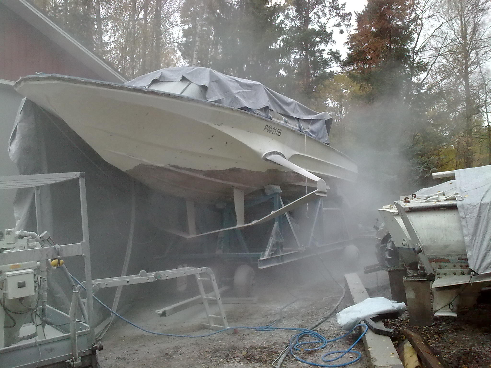

I just bought Soda Blasting equipment, have cleaned some aluminium boats and Nevka.This is the real thing for aluminium and composite.

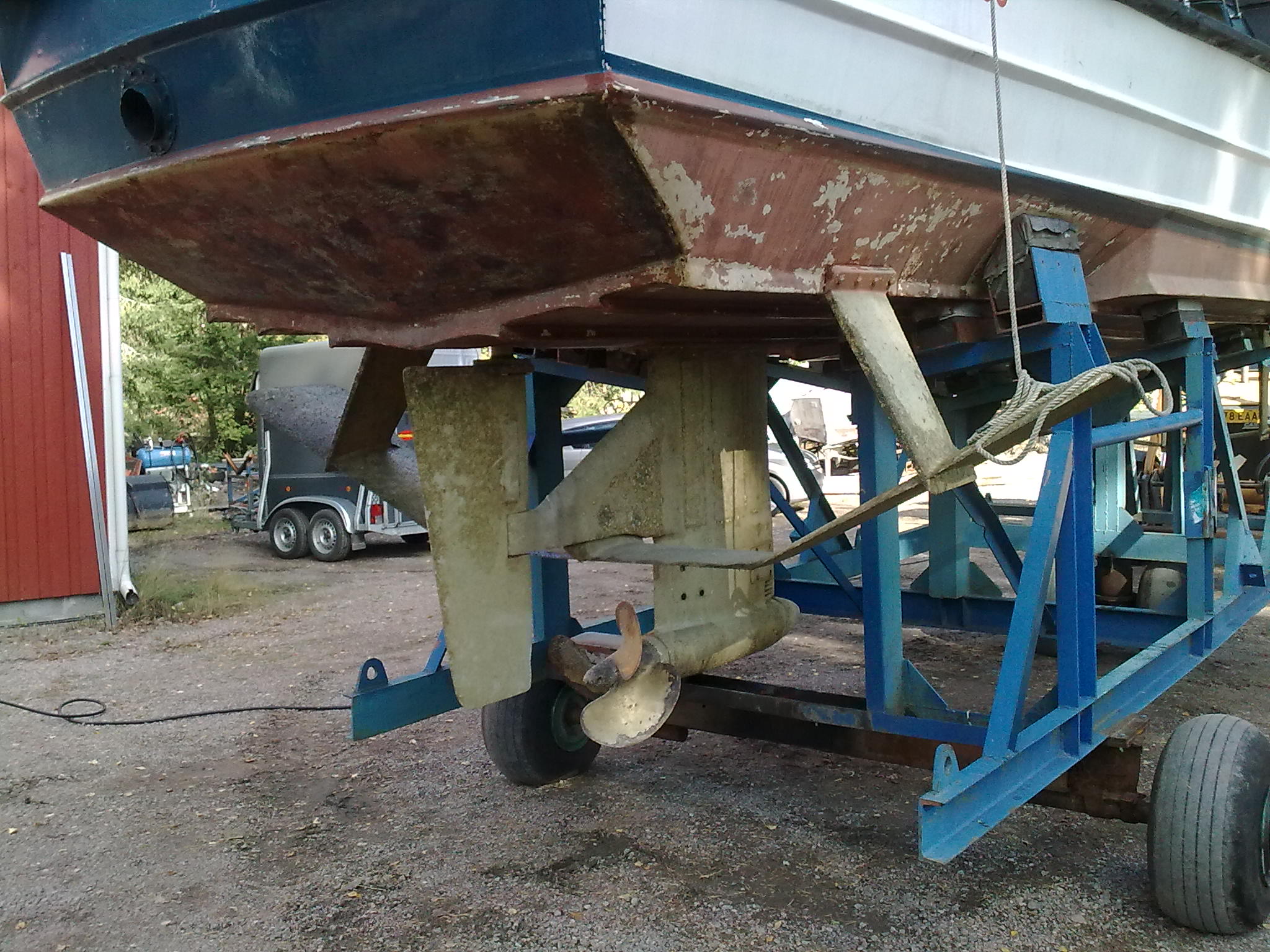

I have no experience with Nevkas. The pod-drive solution is the best I suppose. The pod is probably the biggest value on the propulsion line. Diesels can be replaced without problem as long as they come with a proper marinized package. My favourite Diesel is the Alloy Steyr engine, which is powering Mercedes and Jeeps. Low rev and high torque. The only problem is that it is too expensive in Turkey.
Keep an eye on your pod. Anodes, oil changes and sealing are vital. Don't forget this is probably the most precious part in your Nevka and you will not find easily any replacement.

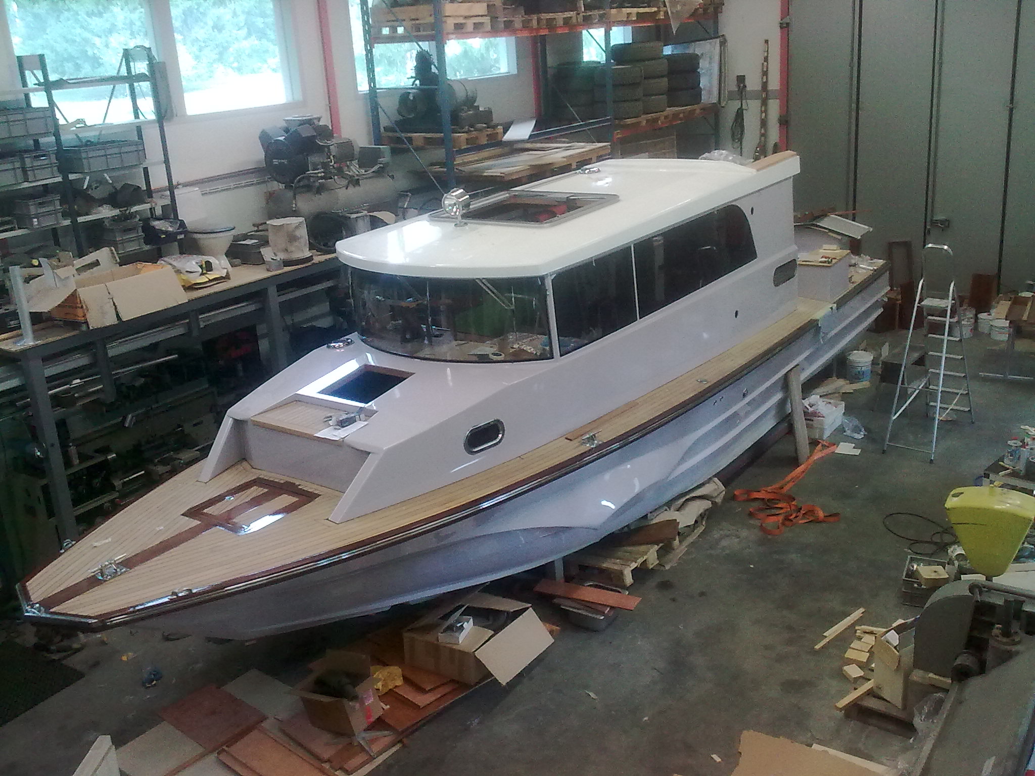

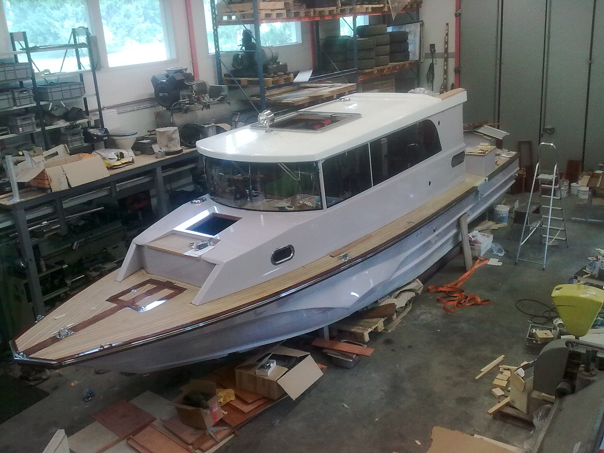

No so bbaddddd news here..... just been a hell of a lot of other work the last time. There were even NO Volgas on water here last year, even if there are several just to launch. This is unforgivable, yes I know it.

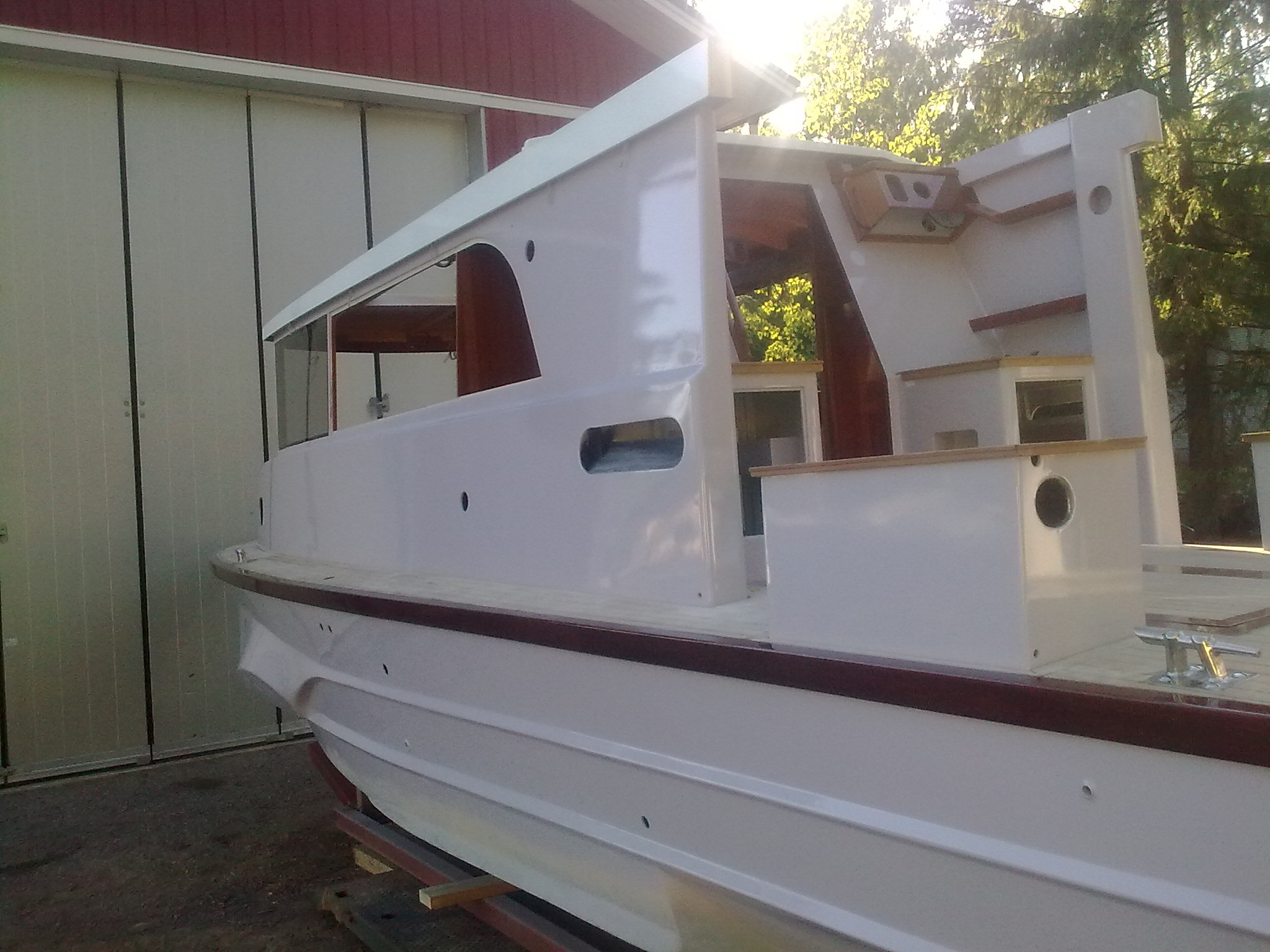

But something new has been done, a completly new Nevka. Only original, is the outside of hull and the drive line.
Enclosed some pictures.
BR
Robert
