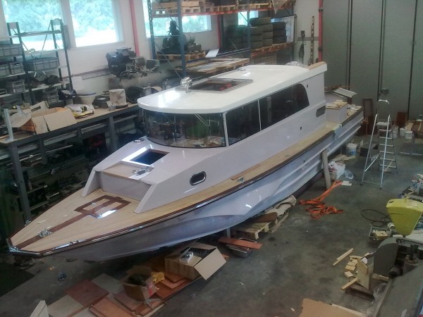

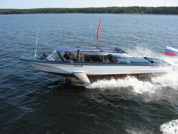

by Robert
Hi Georg,
No so bbaddddd news here..... just been a hell of a lot of other work the last time. There were even NO Volgas on water here last year, even if there are several just to launch. This is unforgivable, yes I know it.
But something new has been done, a completly new Nevka. Only original, is the outside of hull and the drive line.
Enclosed some pictures.
BR
Robert
Original boat
Original boat
New Nevka
New Nevka
