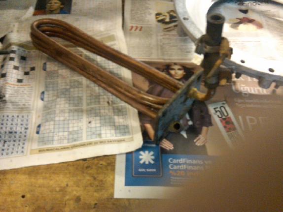

- Nothing has ever been designed more simple. For those addicted to SUDOKU, I can sent hi-rez pictures to make sure the boys stay busy!
- IMG00093-20091107-1440PlantaryGearbox-oil cooler.jpg (35.06 KiB) Viewed 390275 times

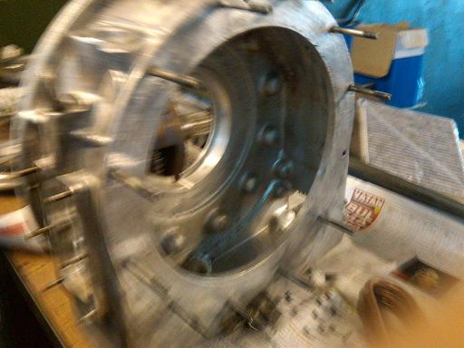

- The aluminium cylindrical housing! None of us were expecting a planetary gearbox inside this.
- IMG00090-20091107-1439PlantaryGearboxS.JPG (30.77 KiB) Viewed 390275 times

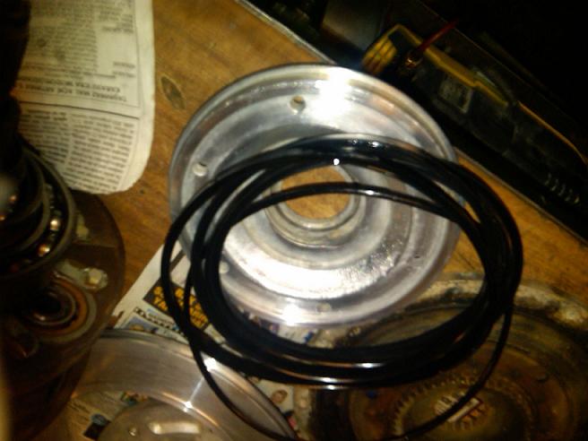

- Cover and some gaskets...
- IMG00088-20091107-1438PlantaryGearboxS.JPG (41.19 KiB) Viewed 390275 times

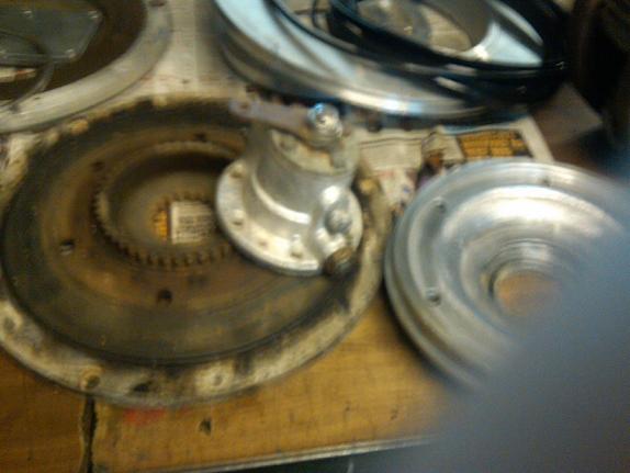

- The female part of the planetary gear cartridge on the right.
- IMG00092-20091107-1440PlantaryGearboxSFemalePart.JPG (37.52 KiB) Viewed 390273 times

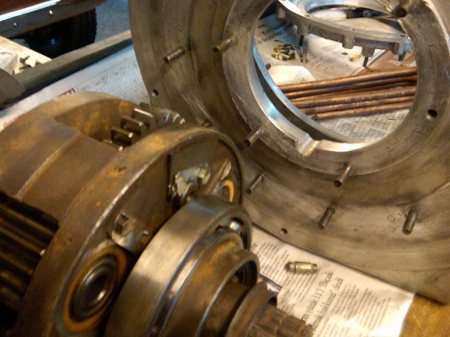

- The mechanical actuating control valve. Simple technology - easy to repair if ever necessary!
- IMG00095-20091107-1441PlantaryGearboxActuator.jpg (29.46 KiB) Viewed 390273 times

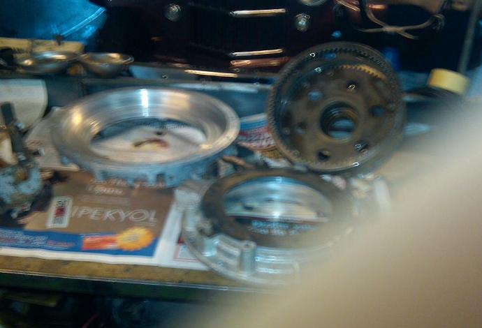

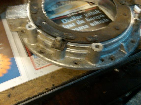

Part showing an aluminium cover with clutch discs fitted. You may see how much they were worn out.
Easy to be replaced by bolting or rivetting new ones on it.
- Some parts of the clutchpats are already missing. No wonder it did not function properly...
- IMG00096-20091107-1443PlantaryGearboxClutchDiscs.jpg (35.08 KiB) Viewed 390272 times
