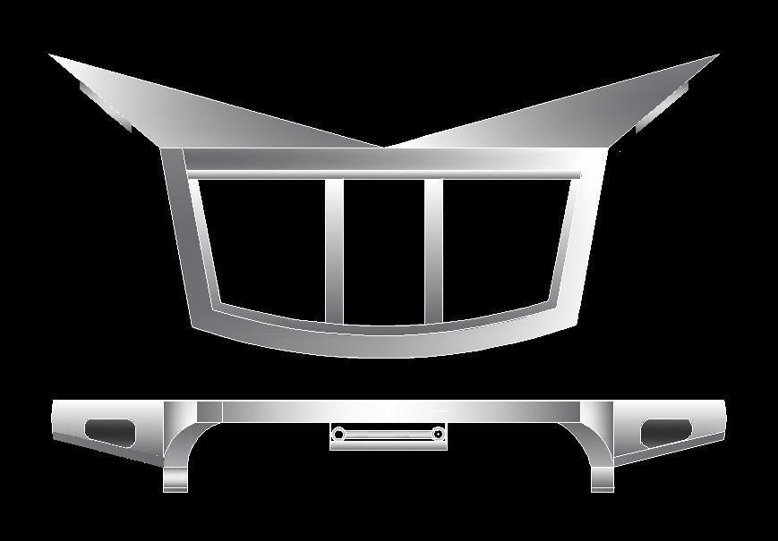

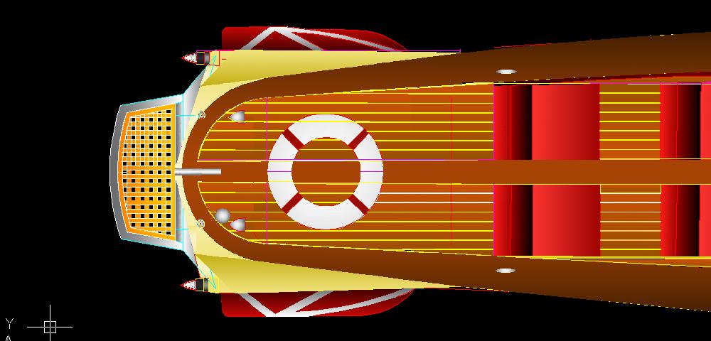

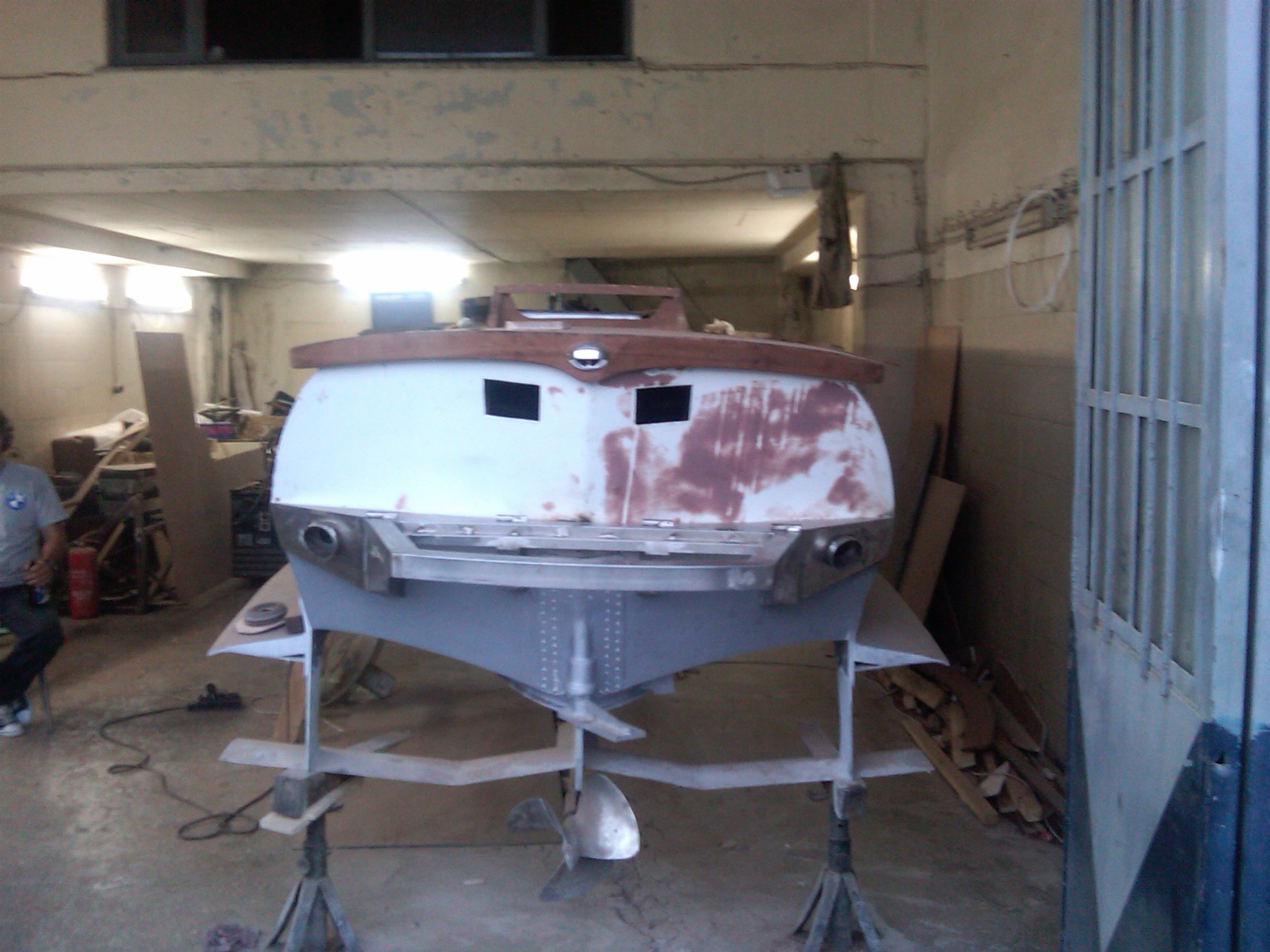

Does anybody know what this could be good for? :wink:
Whatever, you should then keep an eye on that for future ...

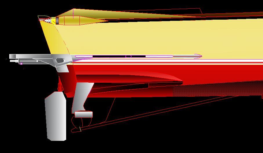

Here is a sideview
Re: Space Invaders
Wait, I know, I know - it's a gril! Right? Oh wait, the filename gives it away.... it's a swimming platform! Cool! 8)
As a side-remark: you might think about adding something there to attach a spare outboard engine. Just as a safety measure for those longer trips a bit farther out on sea...

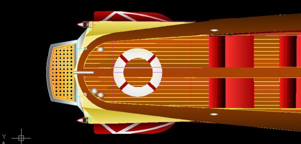

Someone said that some wood is missing ...
AutoCad drawings are available ... (Free of charge)

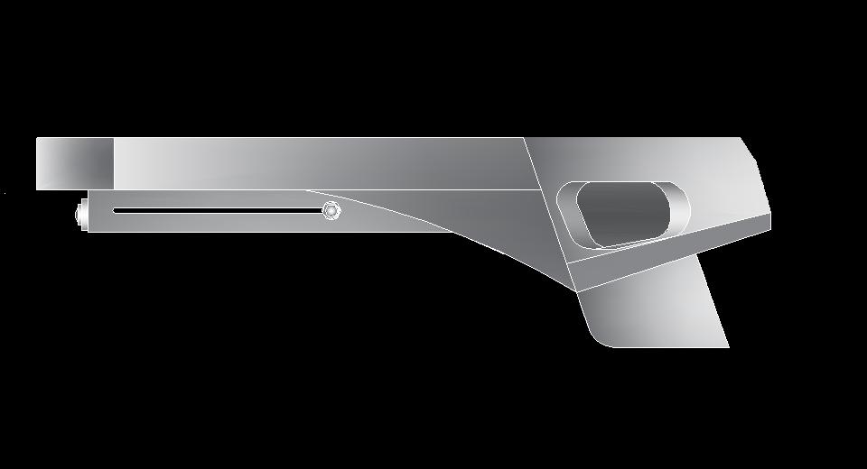

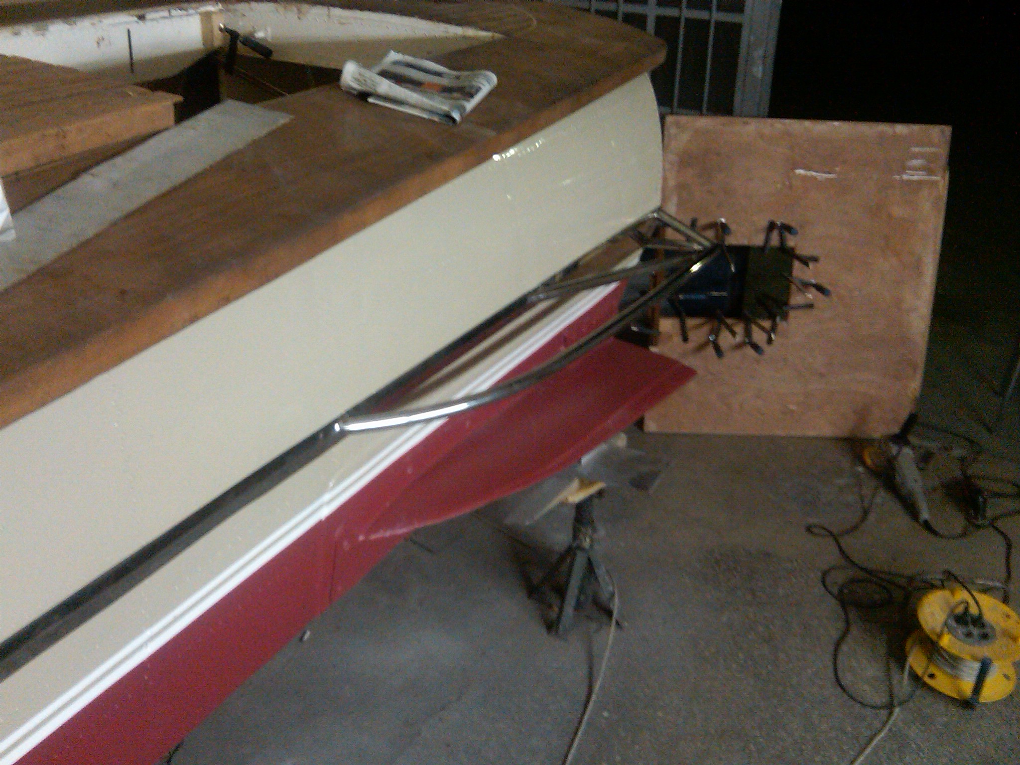

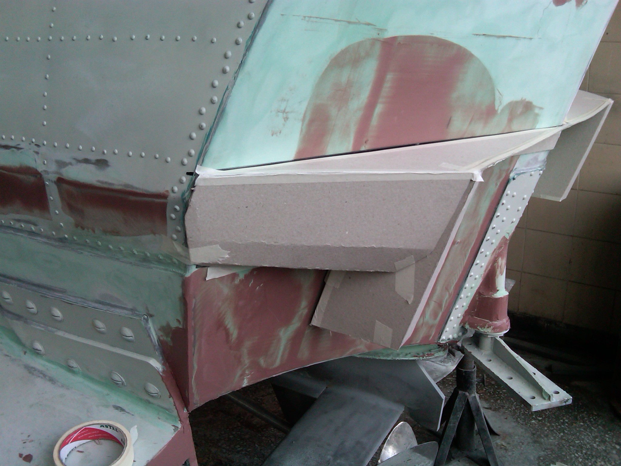

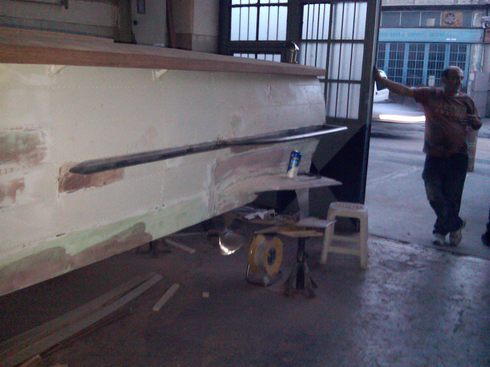

Side view and first tries with a card pattern (Shablon)
Stainless Steelplates used will be 3 mm and 2 mm thick.
Side view
Side view

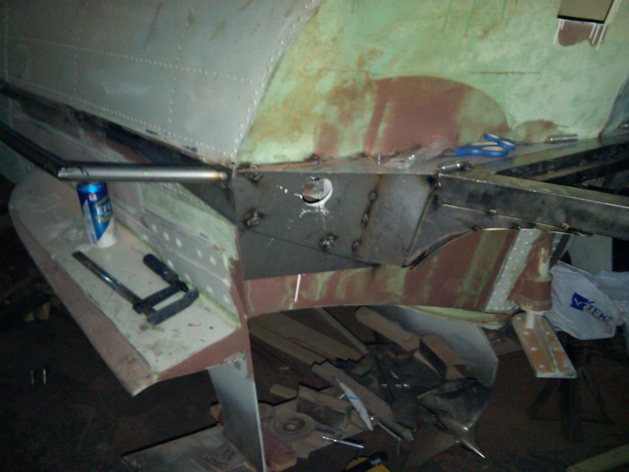

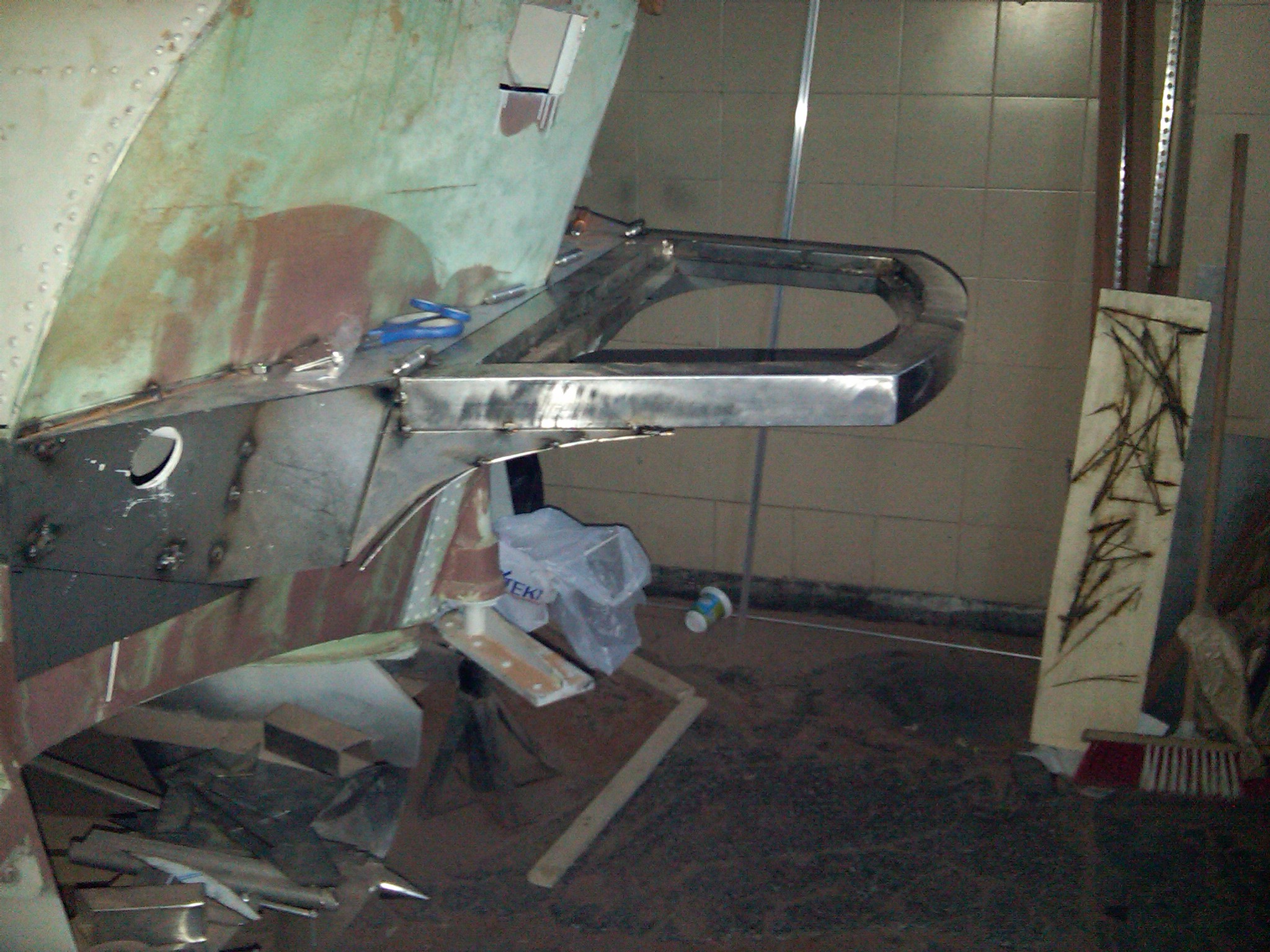

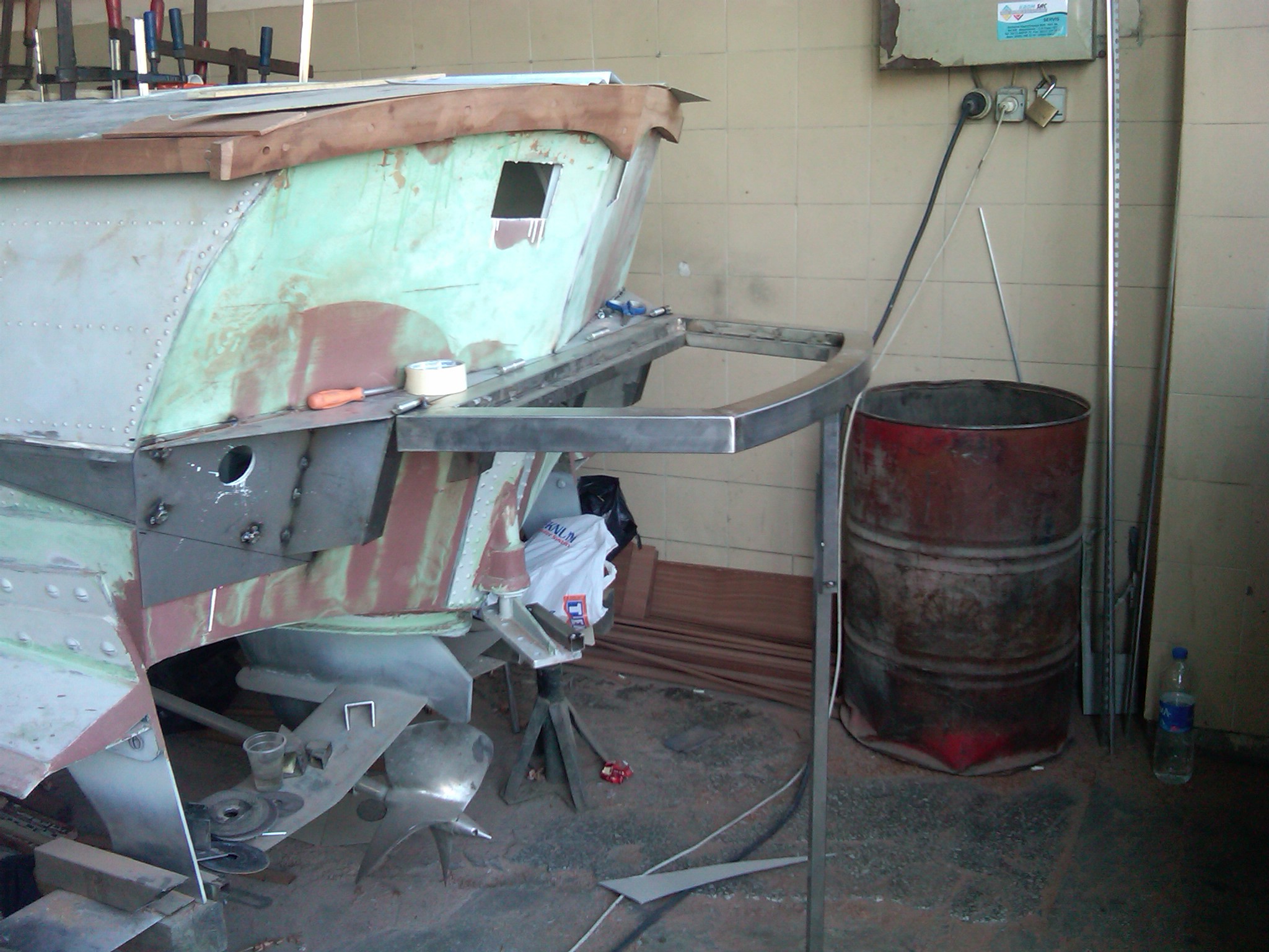

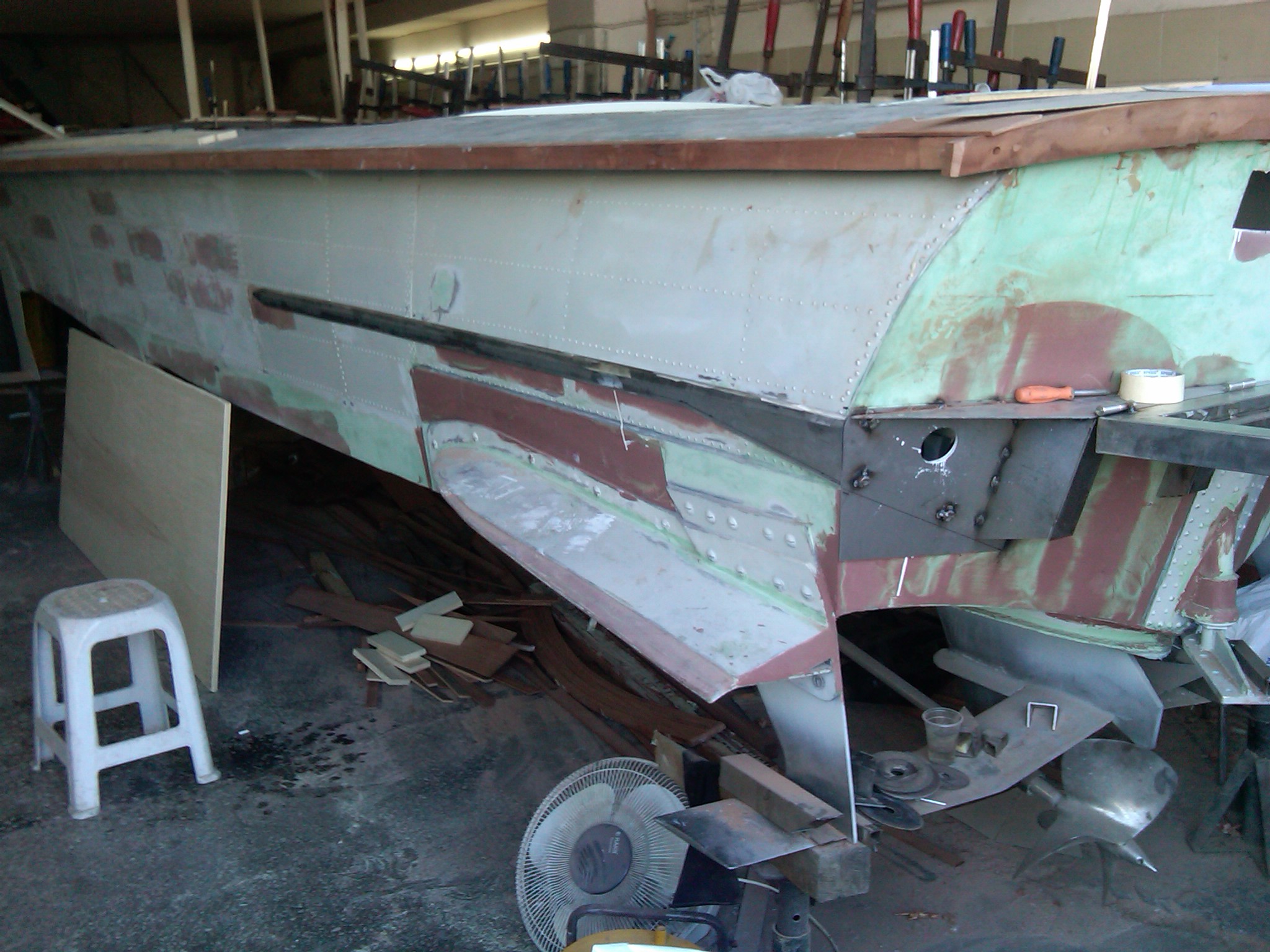

Step-by-step
On the arrow we will still add a guard, otherwise we might turn out to be a yacht killer.
The exhaust is still missing and some plates will be added.

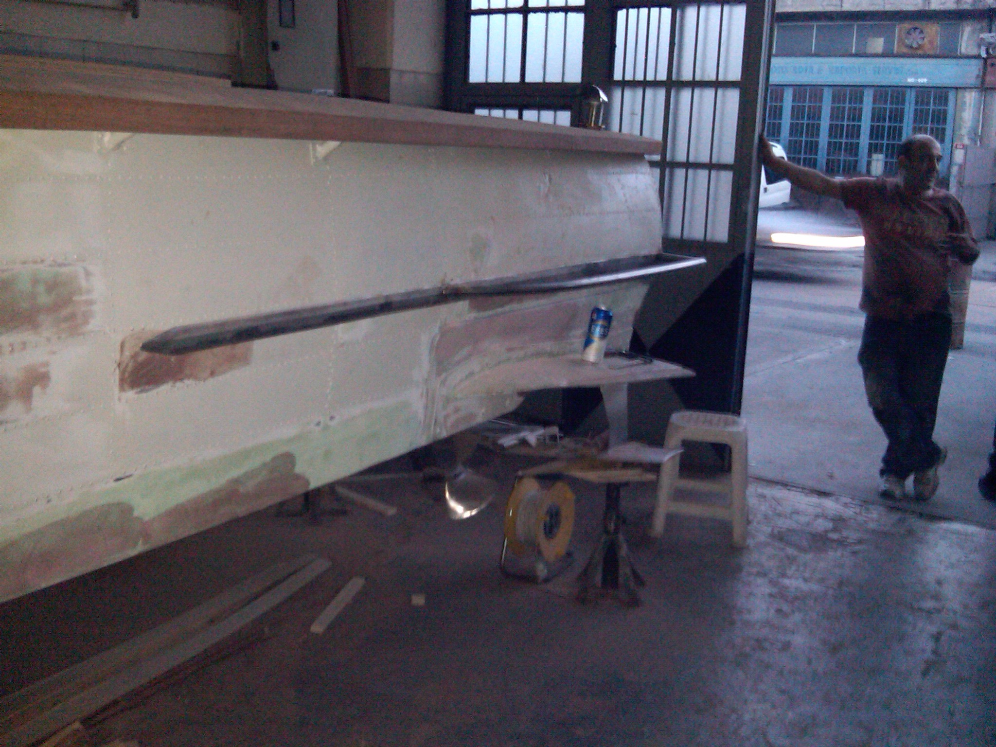

Still small progress

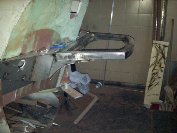

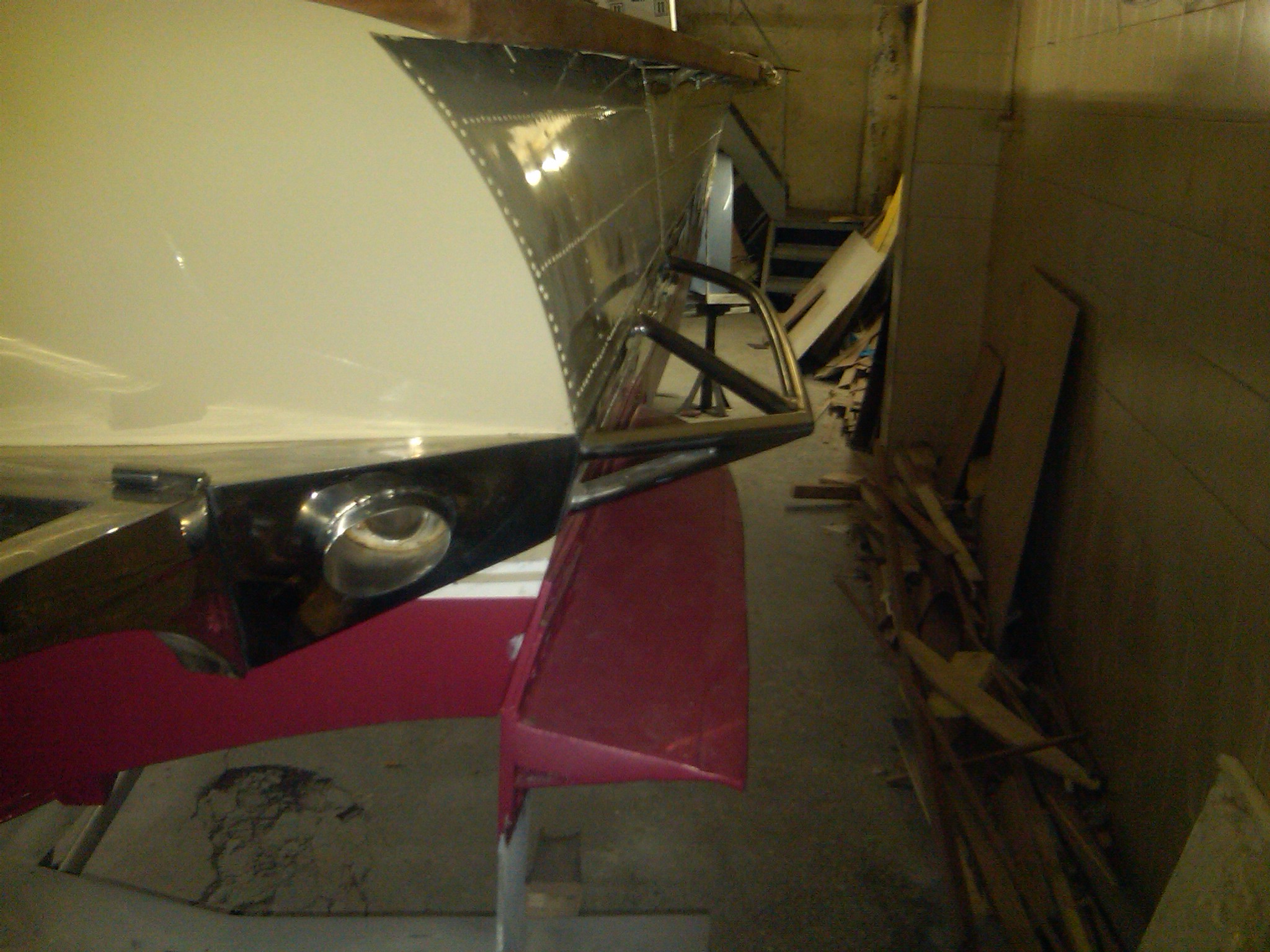

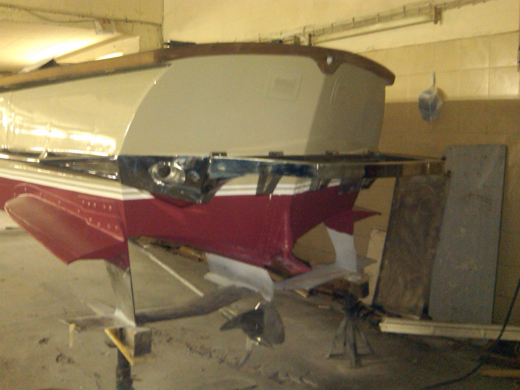

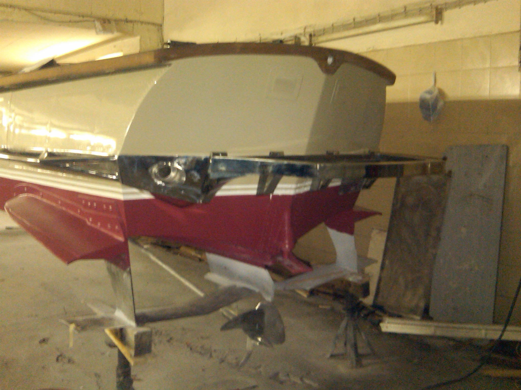

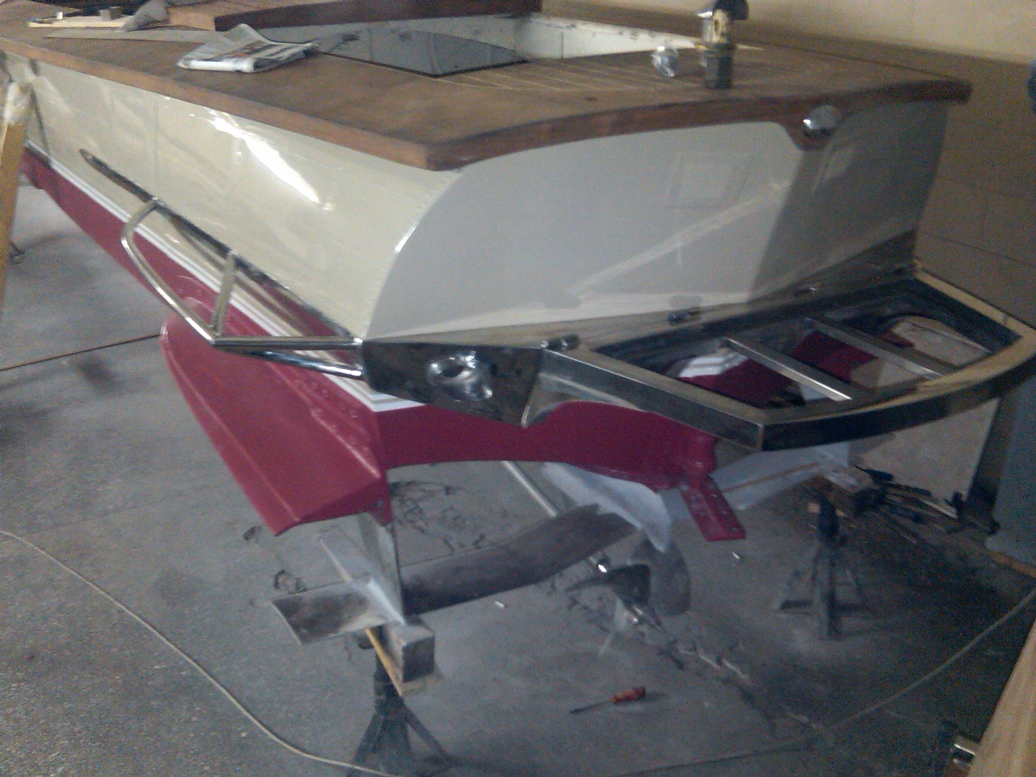

The last fittings and weldings are presently done.
Stern with mounted platform
More or less the construction will be ready now for polishing soon.

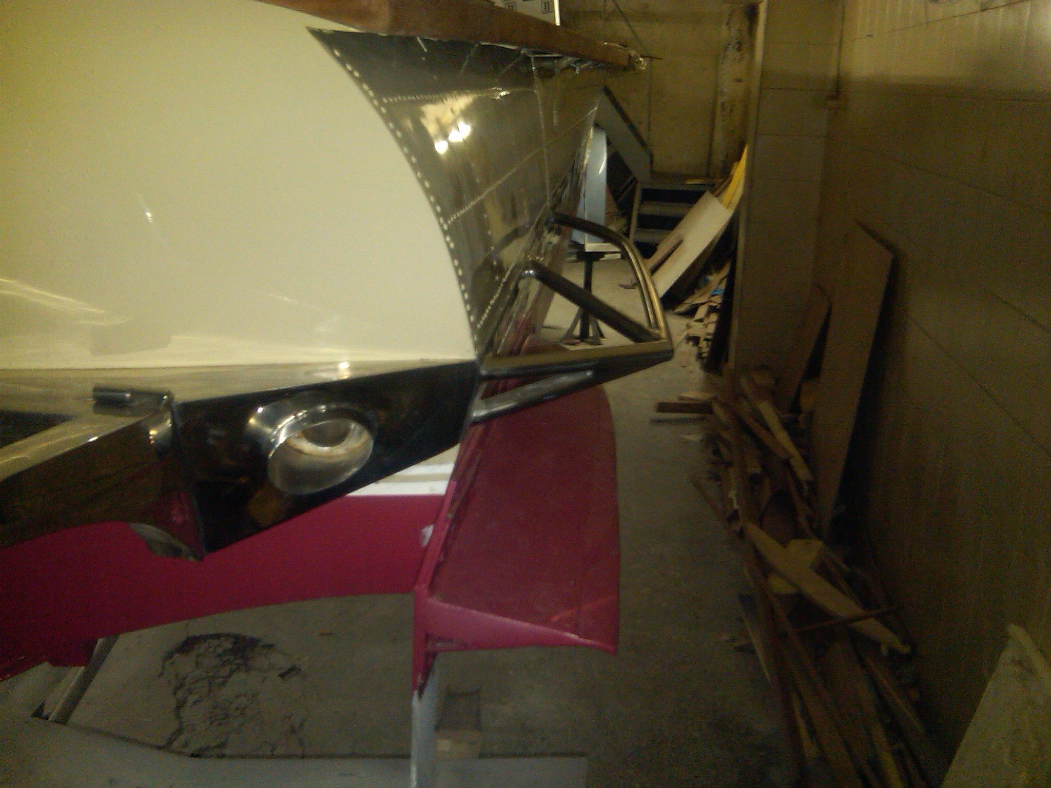

The side guards from elder versions were addopted here. We also mounted a stream or sword-style plate under it that is prolonged towards the middle
Re: Space Invaders

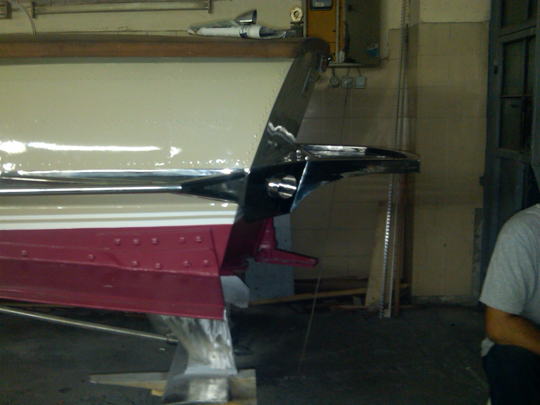

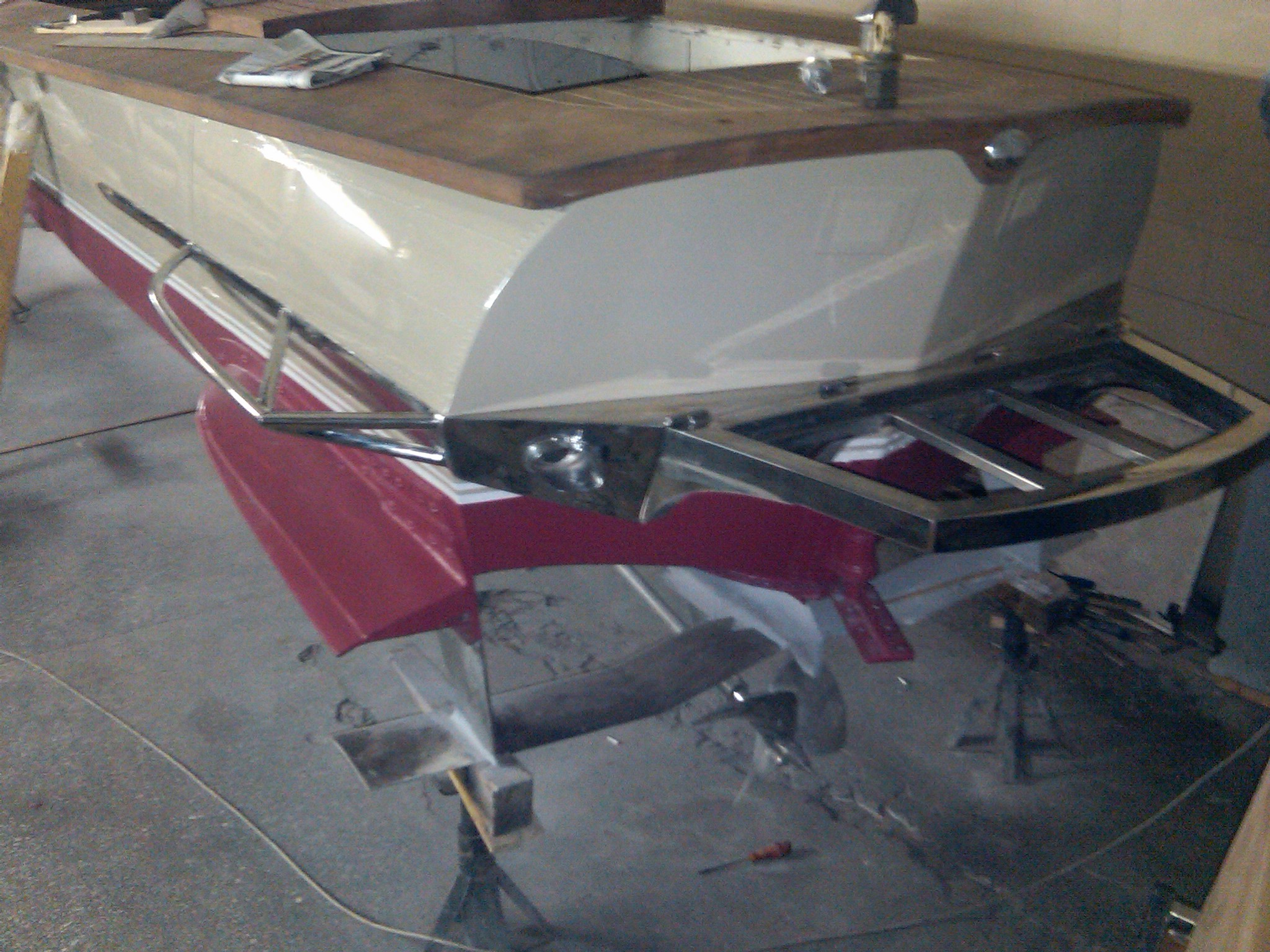

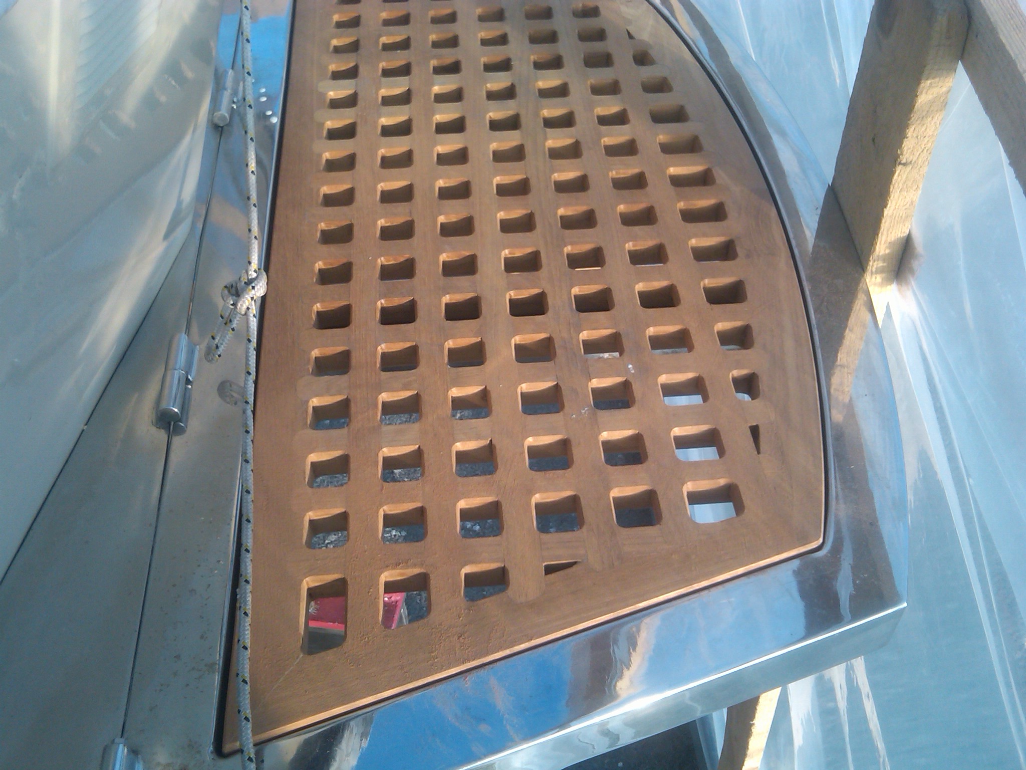

Polished and mounted. I think that the outcome more-or-less keeps the promises of the drawings.

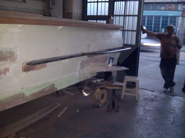

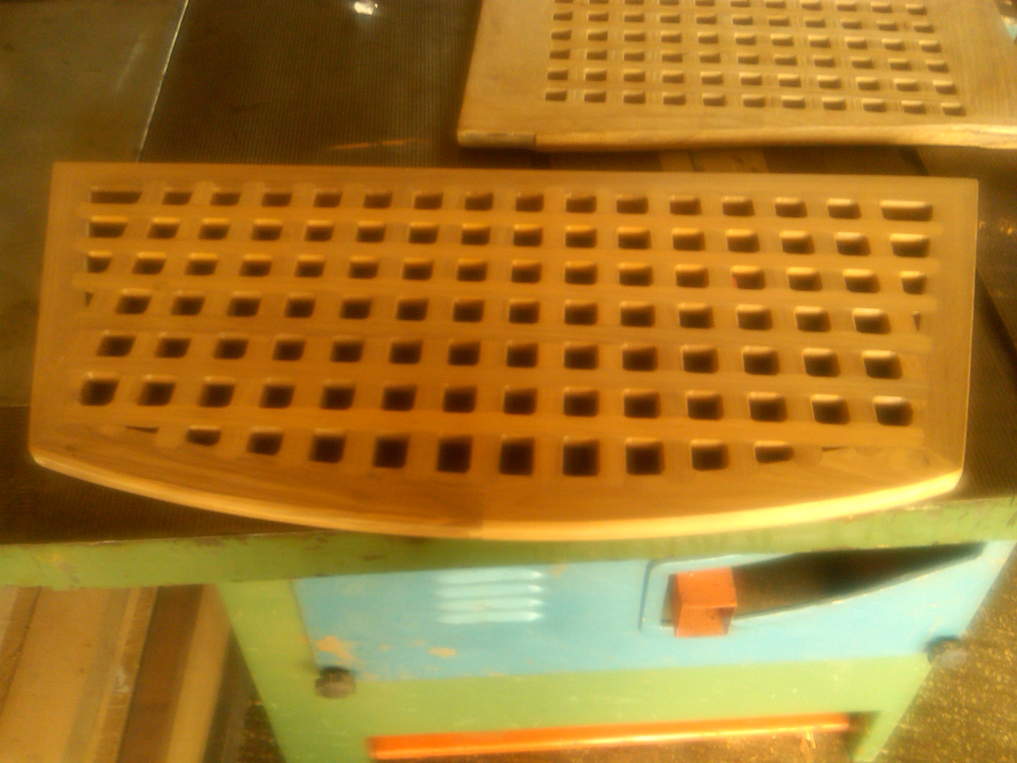

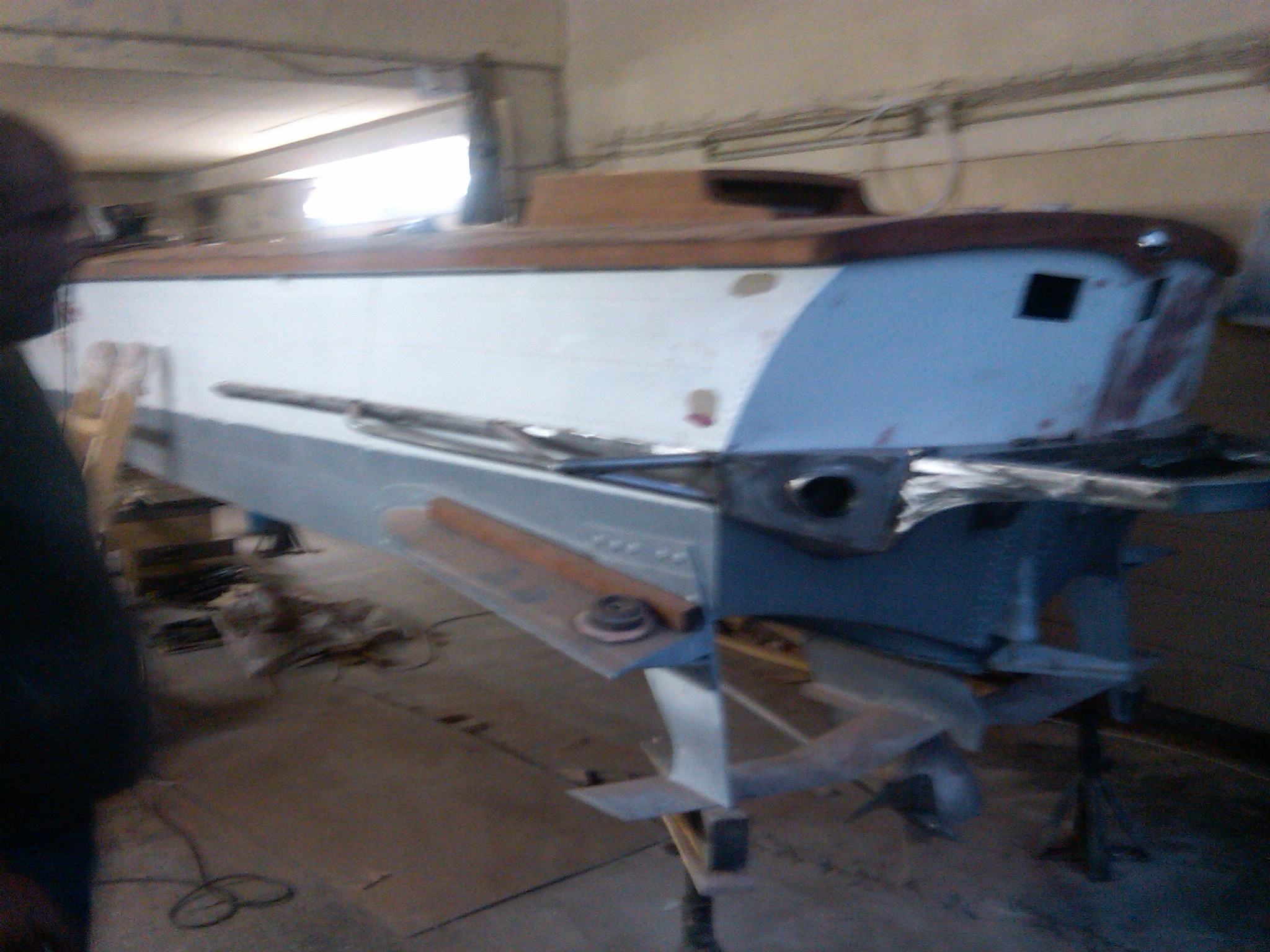

Some wood here ready to be added.
The one at the back does not belong to my boat...

Here we go ...
Now, that's how it looks when the woodwork has been inserted.
