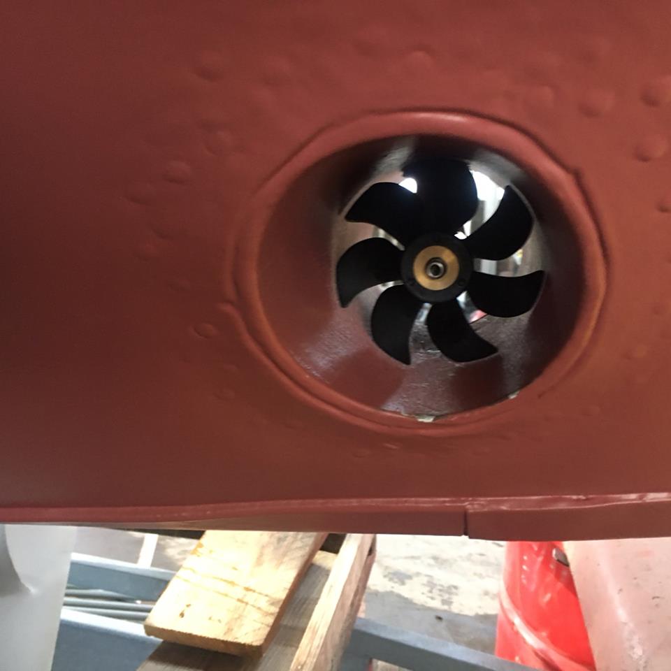

The thruster tunnel is now installed and riveted to the hull. I have painted it three times with 2-component epoxy, before the bottom paint.

Its like a dream come true, my Volga can steer in tight places now:-)
The thruster is absolutely fantastic, i Can do a 360 turn in less than 30 seconds with the stern staying in the exact same place! Continous operation limit is 3", so the 40kg thruster is more than you will need.
I have mounted the joystick behind the dash, so only 2 cm is visible behind the steering wheel.

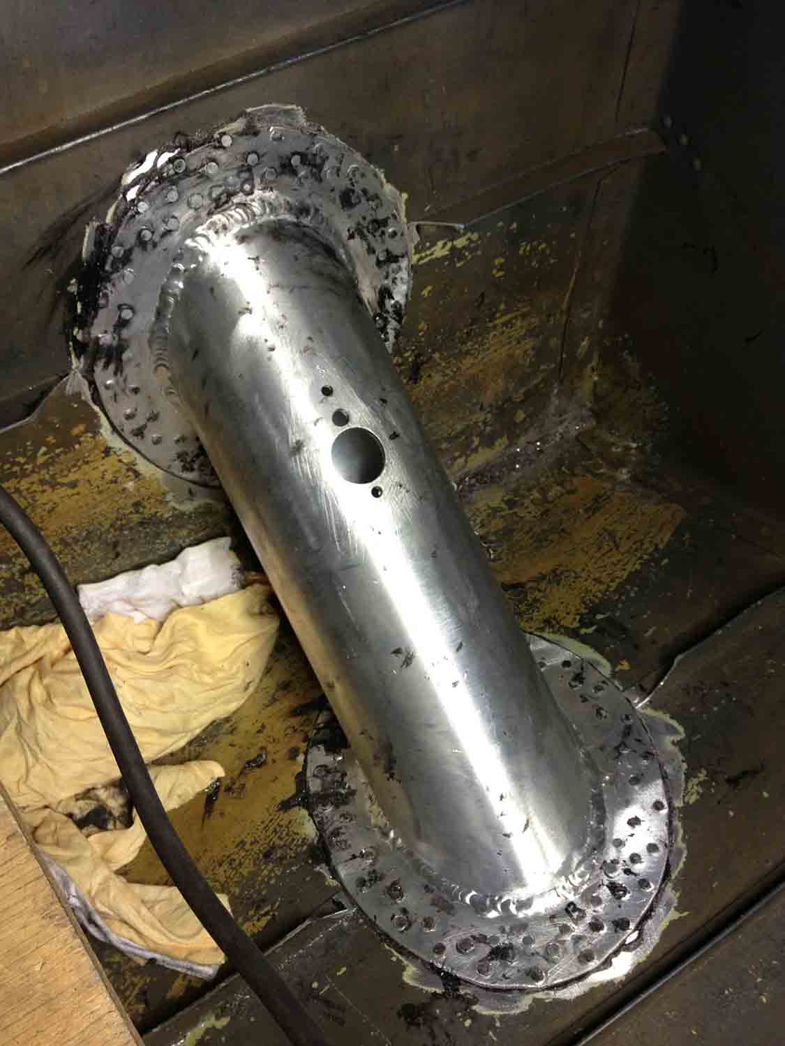

Well i now know how to rivet in tight places.
Together with one of the welders,we installed a 110 diameter tube for:
http://www.craftsmanmarine.com/English/ ... f_12V.aspx
Now i can cruise in the Amsterdam channels and make the turn in one try.

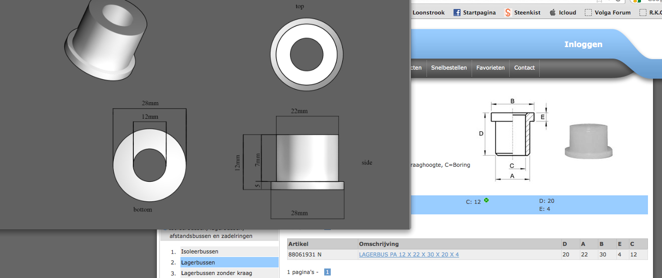

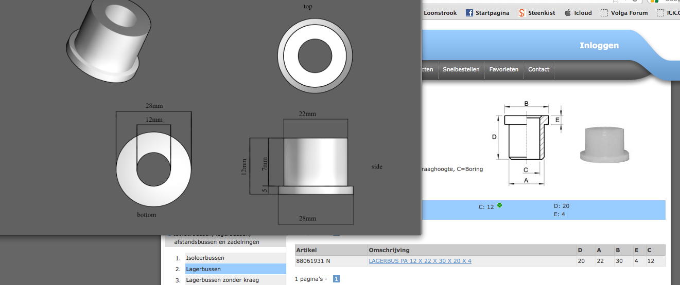

Today i also placed a order for some nylon spacers.
More than 50% of my rubber insulators of the foil bolts is gone

insulator
insulator
inside
inside
