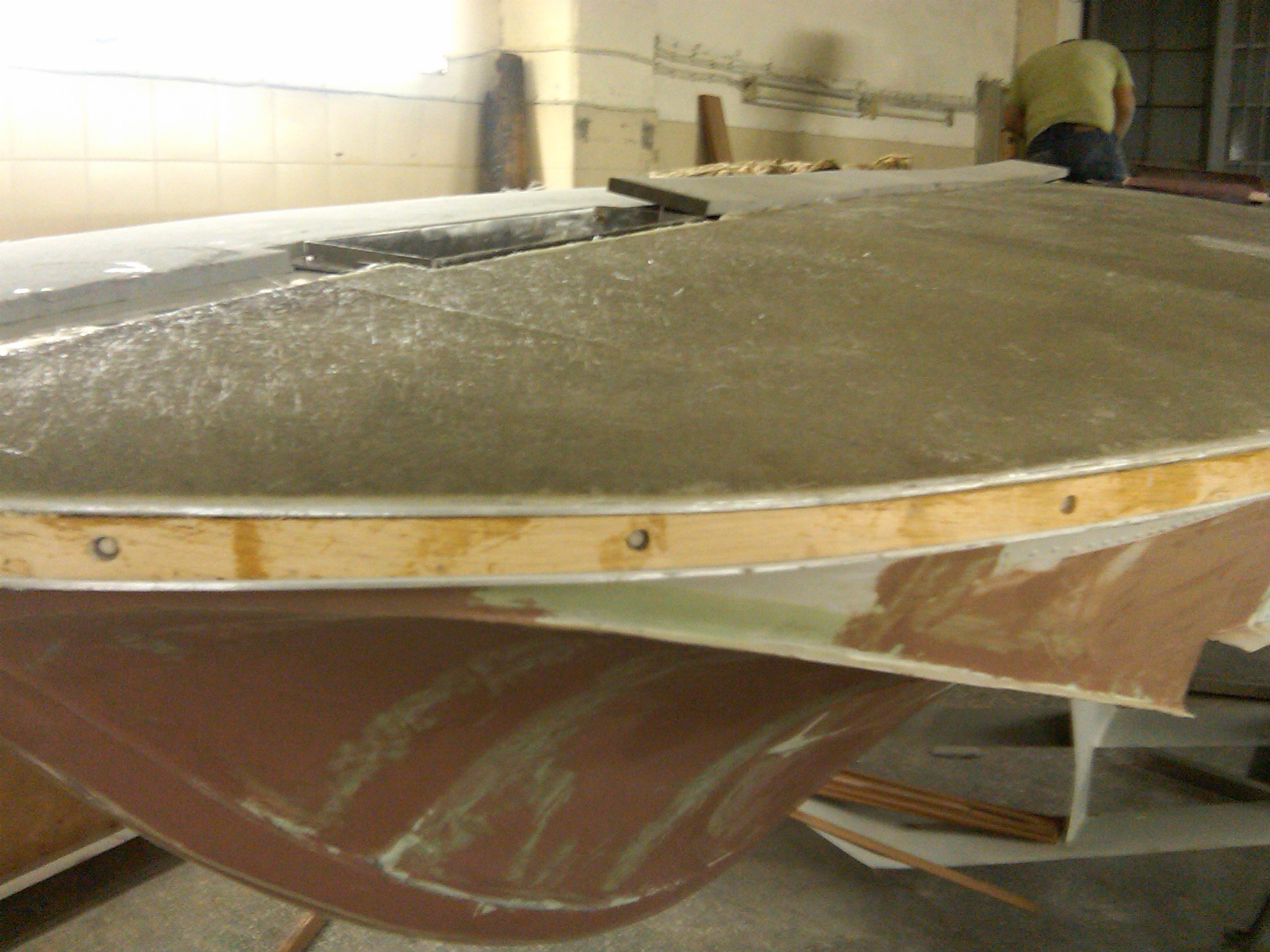

. Later on we applied on the top one more layer with fabric,
White wedding
White wedding
fibreglass
Fiberglass cover
Fiberglass cover
and epoxy resin. This was then also sanded. The deck was now completely even, 22 - 25 mm higher than original and with a rounder shape.
Difference between sanded and unsanded
The sheets where so firm and robust that they did not show any deformation even when you were jumping on them.
Everything was ready for Sika bonding of the wood. With the wood layers of 5 mm the deck will get taller by about 30 mm, which was also intended.
(Frankly speeking this could also have been done with ultralight marine plywood and the result and sturdiness would have been probably better than of this material. The rounding effect for itself was not significant. I didn't want to exagurate it.)

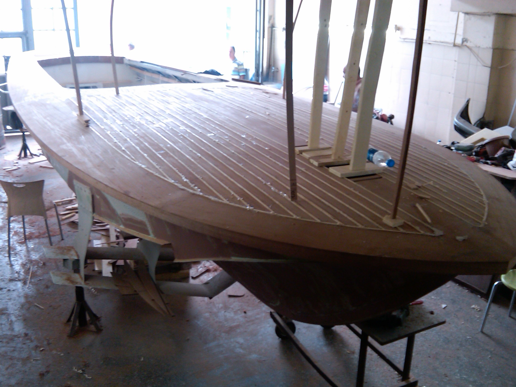

The wooden deck design was copied and/or refined from other Volgas or Rivas. We started with the edges where there used to be the rub rails.
Wooden rail
Wooden rail
Later on we made the sides and the middle for the frame.
Wood applied on deck
Middle beam with anchor hadge
The wood was applied in such way, that all parts had the width.
Width control
Width control
The sides of the cockpit were rounded, too.
Front view ''wooded''
Back wooded
Back wooded
We then inserted white wood between the mahagony.
White wood between at the bow
White wood at stern glued-in
After sanding the front this is what revealed itself:
Bow wood sanded.
Bow wood sanded.
Stern sanded
Stern sanded

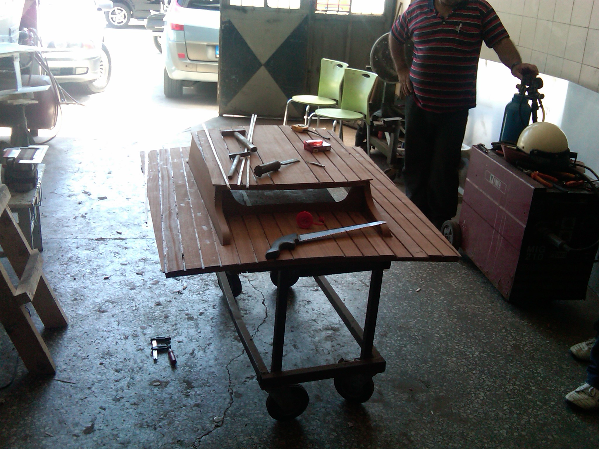

Lamination of the engine room hatch
Lamination of the engine room hood
Fitting of it
fitted without wood yet
Although we have shortened some components on the engine like filter and decreased height of water tank, we had to make a cut-out for the engine.
Cut out for engine. For proper breathing of the engine room and engine we had to do it anyway.
To make a nicely shaped breathing hood will again be a challenge.
Re: Rounded top wooden deck
Posted: Tue Aug 03, 2010 6:56 am
The piece cut out of the hood was then used as roof for the air inlet.
Hood was wooded with the same pattern like the deck.
At the rear we made some prolongations.
The hooded hood placed on the engine room.
Another view of the hooded hood.

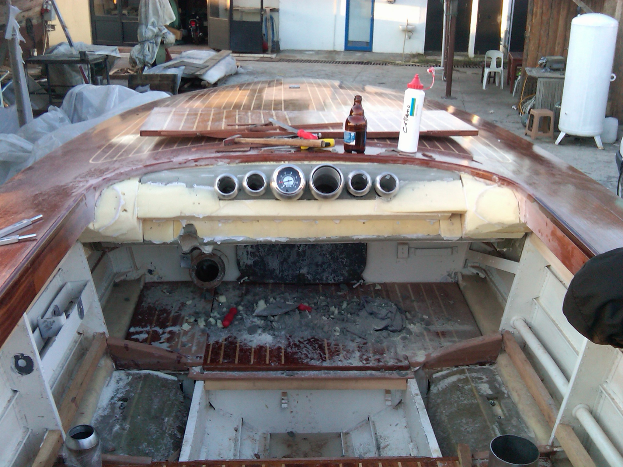

That is the current situation:
View from above with the box/bench and the plywood done.
The woodwork of the floorplates of the pool was redone, with smaller frames.
Small frame version
Small frame version
What you can see on the back is the box/bench partially retracted.
The fuel cap and the air inlets were installed as well.
Fuel cap and air-take-ins installed
We started to add preinstall the cockpit gauges or their housings.
Nothing makes more dirt than shaping and sanding the foam.
The housings do not fit well, due to last minute decision changes with their distances. They still need to be symetrically fitted properly.
This is a view from front to back. You can see the closed box.
Posted: Sun Oct 31, 2010 7:35 am
WOW, magnificent! The deck looks stunning in the overview-picture from above!
What kind of material are you using for the deck inside the 'cockpit'?
Posted: Mon Nov 01, 2010 5:40 am
The material is pvc hardfoam sheets, we are sanding. The pipes for the gauges are Aluminium and they will be fixed via epoxy. The bezels are of stainless steel and what you can not see on the photo there are stainless steel guide/cover pipes, that will be shaped to the dashboard. The dashboard will after proper sanding be covered with epoxy and glass fiber, later a UV resistant beige artificial leather will be glued on. Below there will be an aluminium cover with all other switches, radio etc ...
The leather and the aluminium is divided by a thin aluminium strip profile.
best regards from Turkey
