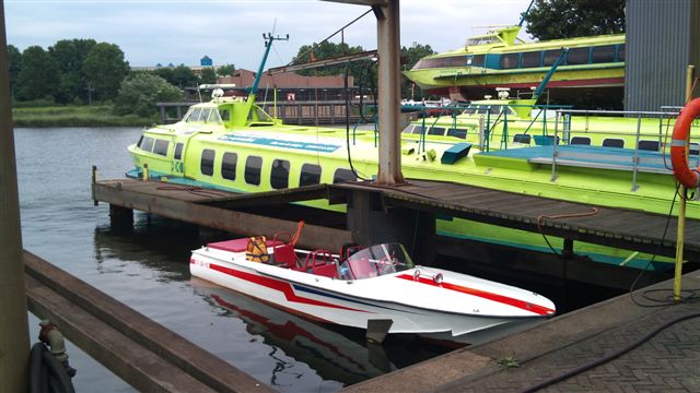

Just let you know i have joined the bulletin board. I have a Volga 70 for over some years now. Bought the hull in 1996 in Kiev together with two bigger Voskhod hydrofoils for the company I work for. That is Fast Flying Ferries or Connexxion Water in Amsterdam Holland.We now have a fleet of 5 Voskhod´s which we operate on a daily bases from Amsterdam to IJmuiden. On a canal which is 25 Km in lenght. This is for daily commuter passengers.
I bought my Volga hull with shaft and V-drive only. We placed the engine, a Yanmar 6 LYA 310 Hp, here in Holland. Runs great, do a lot of water skiening and treyed para sailing but that did not work out to good. Boat has a problem of barnical grouth here in the waters of the IJsselmeer. So one's so often we polhis the foils for smooth operation. This is also a problem on the commercial Voskhods. The full out speed is 71 Km/H. at 3300 rpm on the engine and propellor shaft. Transmission is 1 - 1 and the prop is orginal. I like the set up from your site about the bow thruster. This is on the wish list, and this winter it will get done.

Your Volga looks great at the dock along the Voshods too.
