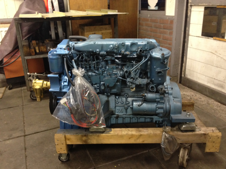

Re: Spare parts
Hello Jouko,
I will install a Mercedes OM 603 engine.
Its a 3L turbo diesel,currently it is at http://www.diemax.nl for a watercooled exhaust manifold.
Plan is that it will also fit at a OM 606 engine.
I overhauled the URRP-25 V-drive/gearbox.
http://www.volga-hydrofoil.net/phpBB3/v ... f=1&t=1204
The Om603 is about the same weight as the original engine,300KG.
Power/torque is also enough.
It is more the small thing we looking for,dek fitting enz..
- OM603
- IMG_2582_750x562.jpg (484.55 KiB) Viewed 307010 times
