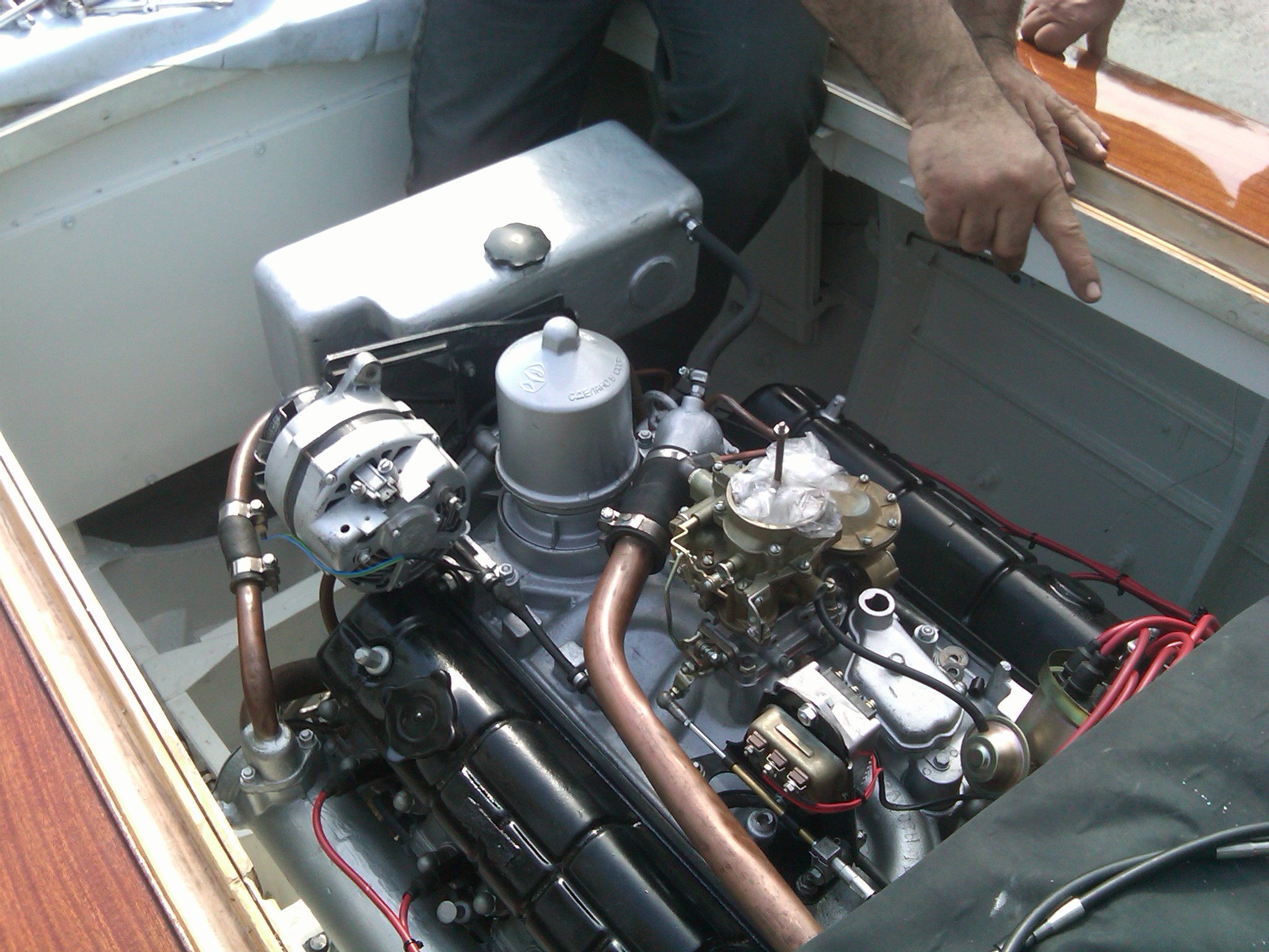

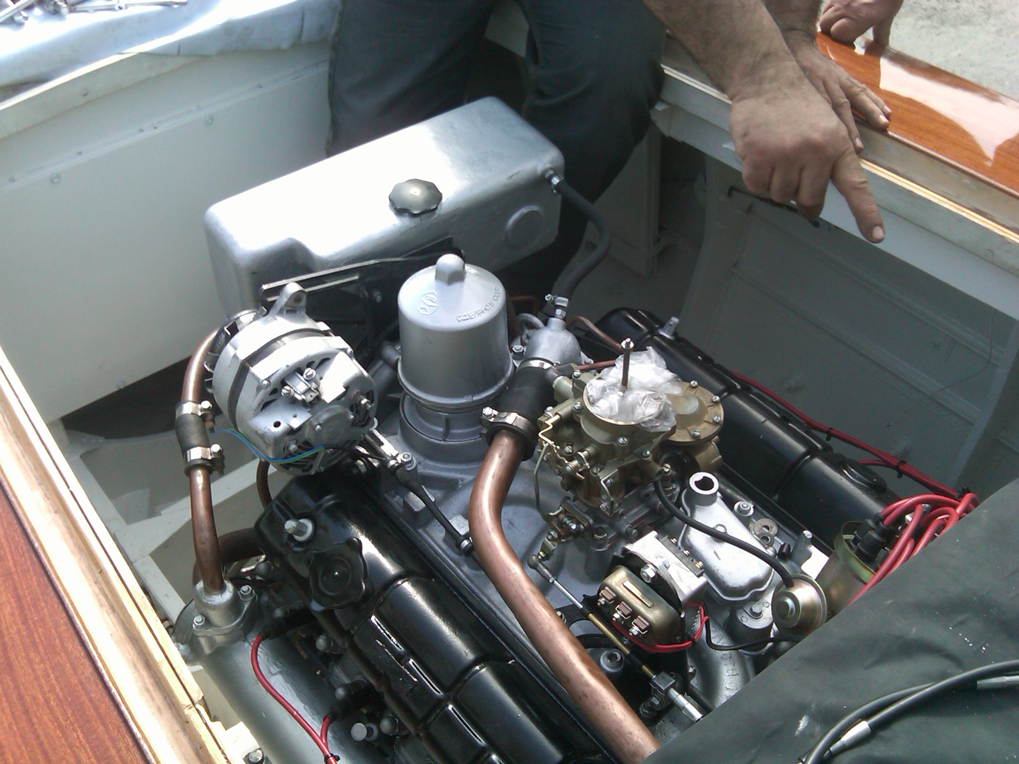

Original engine: GAZ53L, V8 4,3 litre Gasoline engine.
Recommended oil for Russia? Mediteranean? SAE? Mineral based?

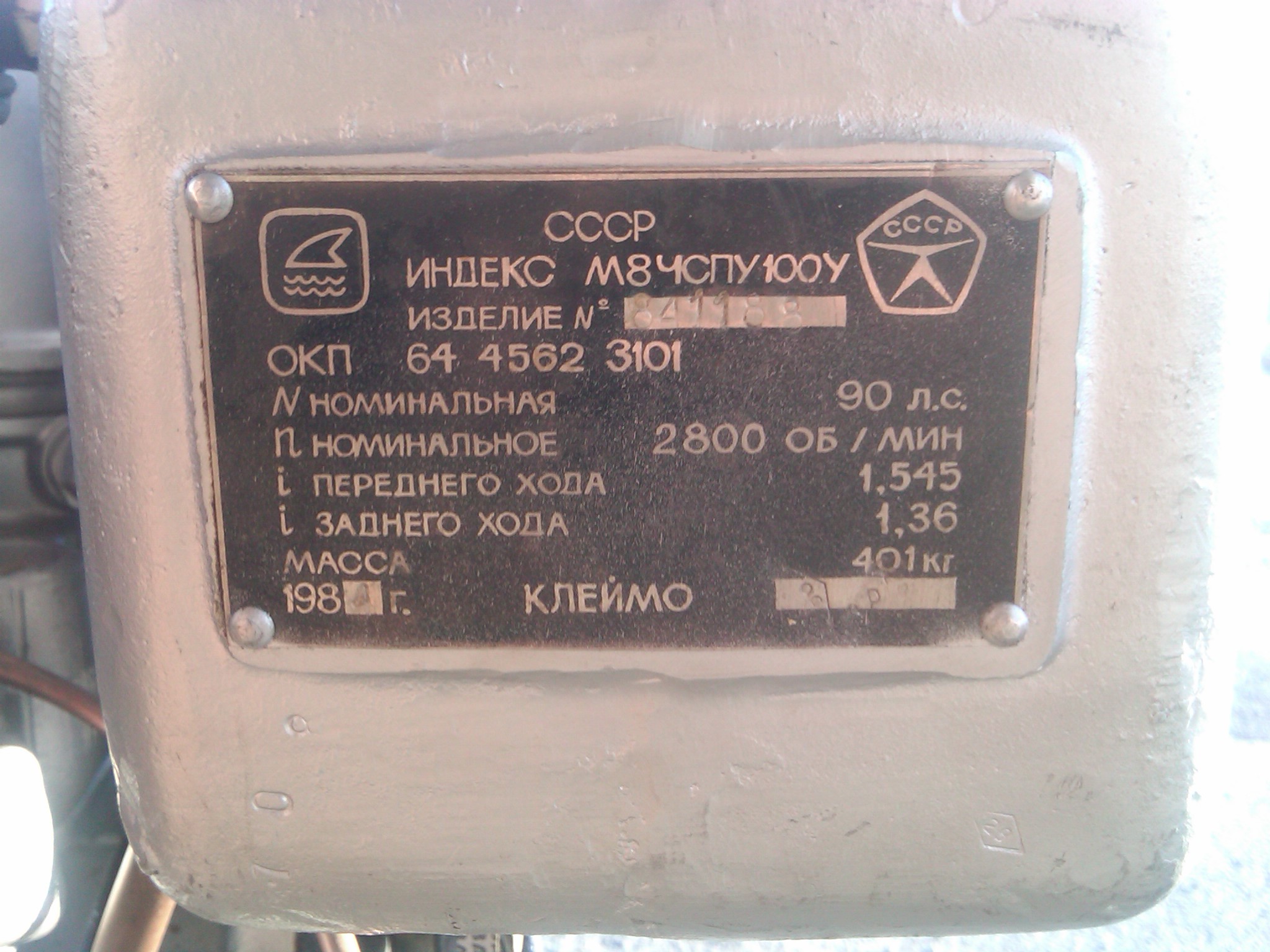

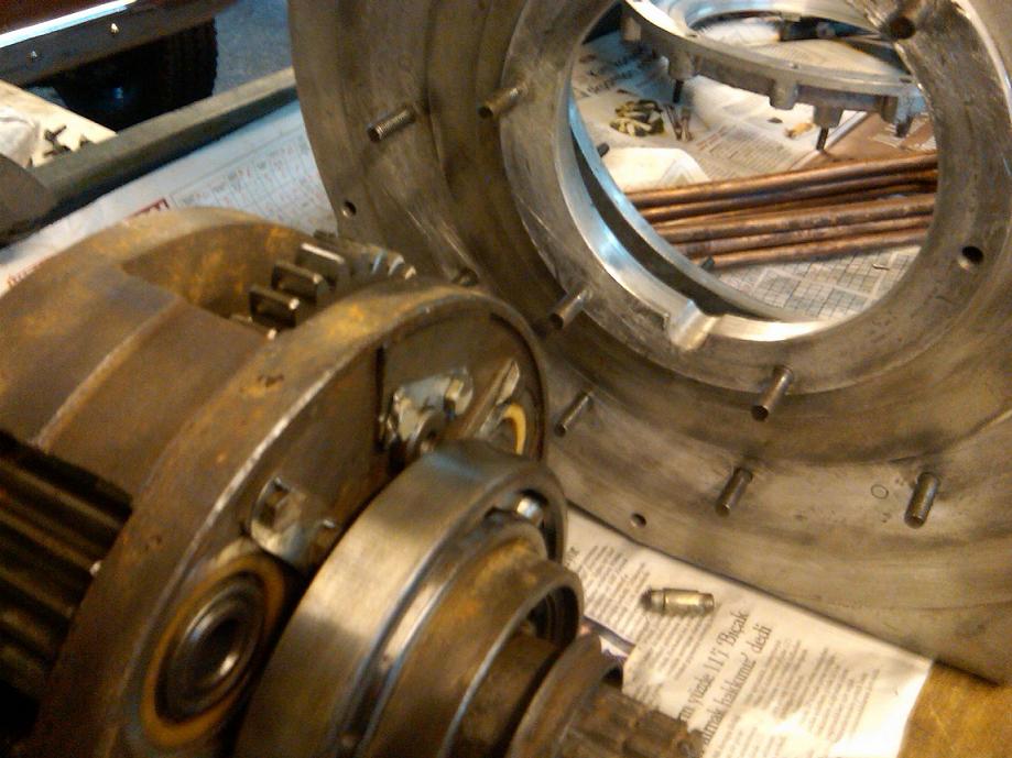

Original Reverse reduction gearbox: Planetary gears, Manufacturer unknown.

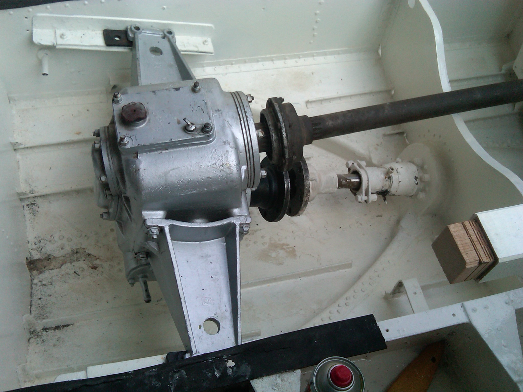

Original V-drive gearbox: Manufacturer unknown.

as all Russian engines of the time 1955-1990 use the same oil grades you can pour 10W-40 or 15W-40 semi-synthetic/ all season/. Full synthetic 5W-30 or 5W-40 would be too much good for this engine, the oil seals would leak . Tested on Gaz 24 and 53 engines.
For the gearbox you can put any mineral gear oil that is suitable for the old dolmus's of Istanbul - Chevy or Dodge make 1960-1980.
If you like put some full synthetic oil it will have a lower friction coefficient and increase your gas-mileage 3-8 %. Dura-lube or other make.
As you deal with ZF gearboxes/drives you can use similar oils, perhaps oils for the Baltic or Ostsee would be fine.
