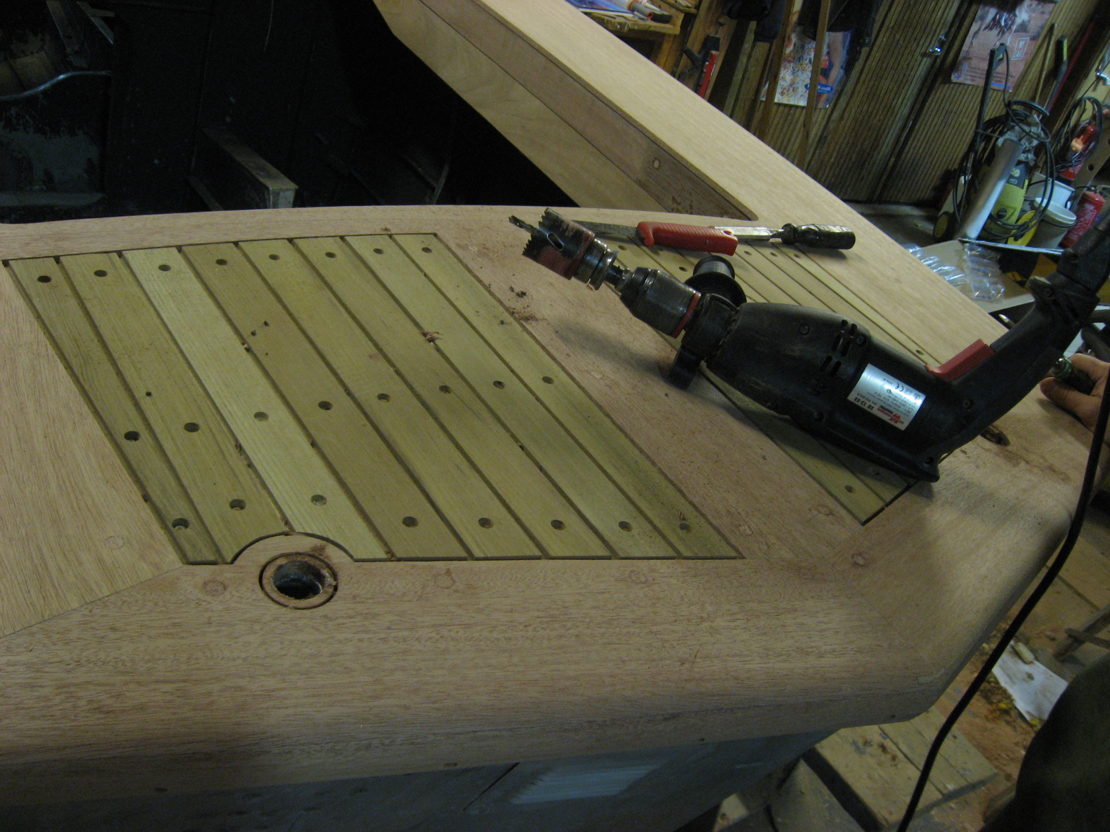

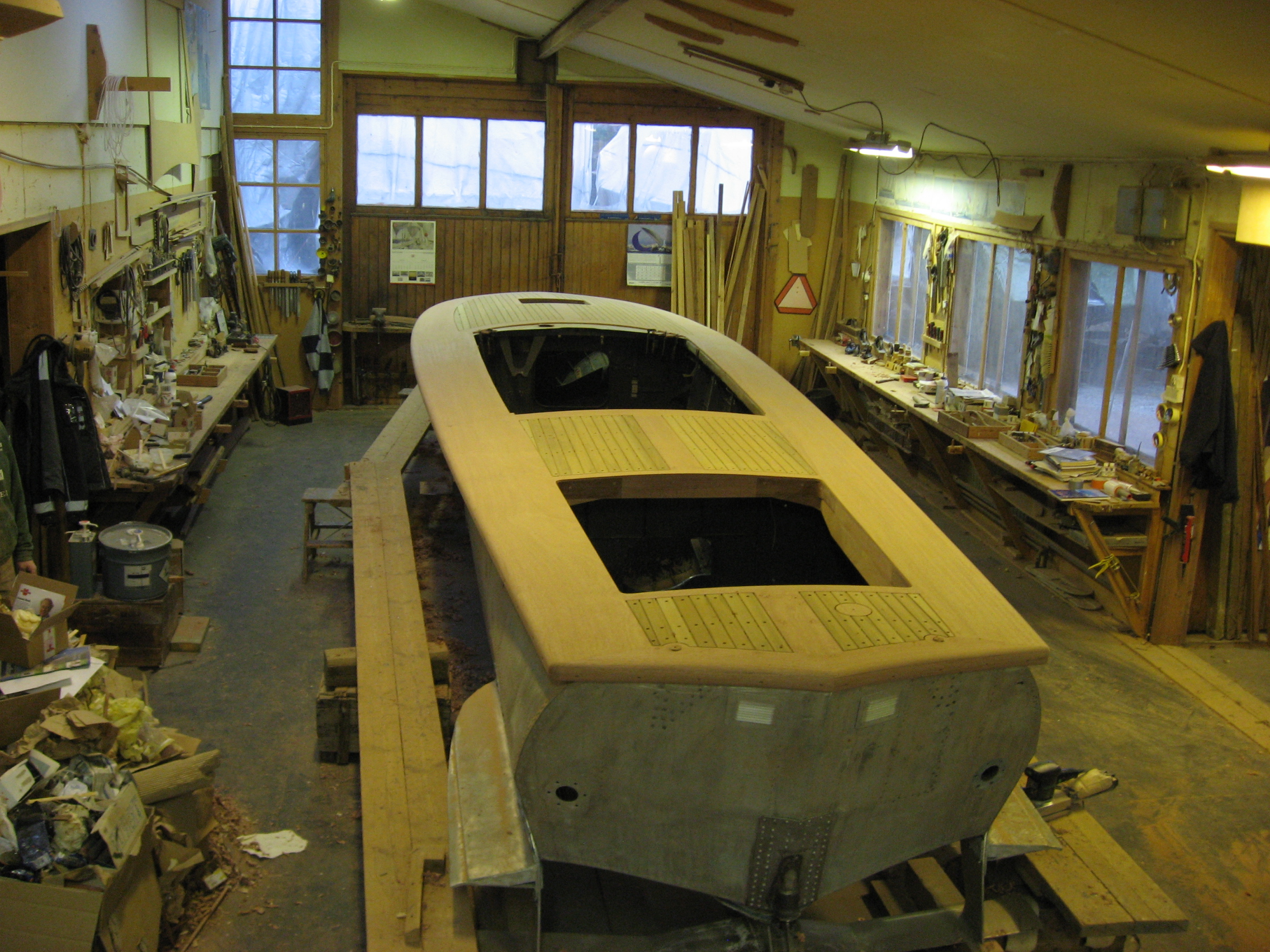

Showing here some pictures of one of the Volgas under restauration at the moment, our project called Volga 2000.
This is a hull from 1984 in very good condition. After soda blasting, the aluminium hull looks like new at outside.
At the moment we do the wood work, deck seats, hatches and so on.
Then hull will be painted with epoxy primer and polyuretan high gloss surface paint.

This is highy impressive! I got offers for doing something similar.
You seem to screw on the wood and then fill the bore holes with same wood to cover the screw.
You will probably also fill the gaps with the white elastic stuff. This is truly old style, old school!
The guys here explained to me that nowadays this is done in a different way. They are gluing
several wooden blocks of 50 mm Teak to 5 mm white wood (dont know the name now) and then
cut the pieces to slices or 5 mm thickness. The result you have a complete layer of prefabricated
teak flooring, you now only need to cut it for the and glue on the hull.
(P.S.: Don't be mistaken when looking at the photo. You are right! The layer has been torn. An indeed blond
girlfriend had to try how robust it was....?)
Off corse, yours is nicer due to the authentic woodwork being done.
Is this kind of woodwork prefered due to elongation differnces between wood and Aluminium or
is this just for eye?

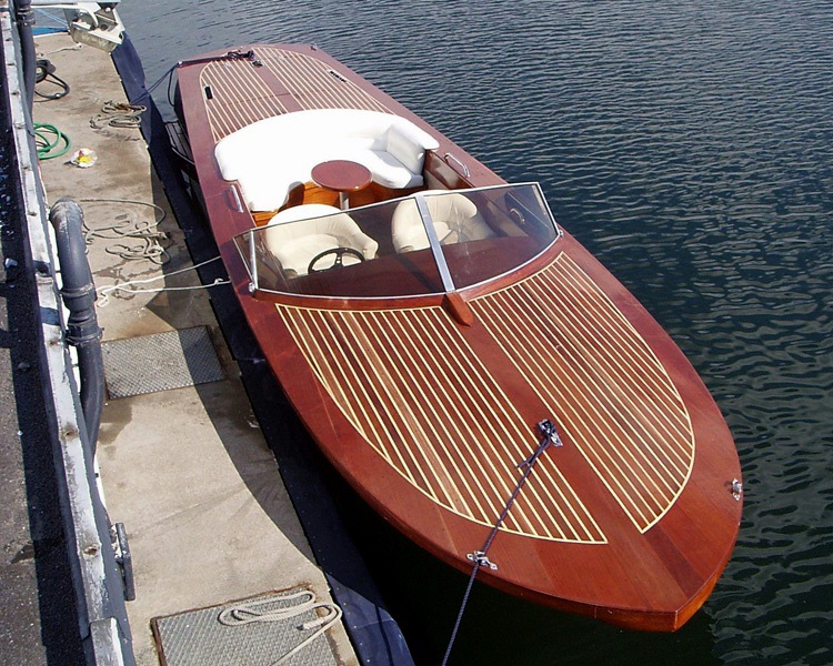

Wow, that looks really awesome! Great craftsmanship..
All that woodwork, it reminds me of pictures of the 'Riva on Wings' that were sold for some time by a (US/Norwegian?) company named Jet Technologies. Does anyone know what happened to this company? I can't find their website anymore.
And then there is the beautifully crafted "Danish Volga", owned by Mike.
I did always wonder how much weight all that woodwork added to the boat. Robert, do you have any idea how much extra weight the wood will bring in? Are you using special light-weight wood types to keep the weight down, or will you put in a big fat engine that will pull the boat on it's wings now matter what the weight is?

About the weight and materials, we use ordinary mahogany and teak.
The deck material is about 9 mm thick, and when sanded and finished about 8 mm.
Epoxy we use on the mahogany about 5 kg.
Teak will be only oiled or left grey.
Mahogany is at first darkened with brown coloured betz.Then epoxy one time by brush.
After that one layer of woven epoxy mat.Then two layer of epoxy again with brush. Light sanded between each layer.
After all epoxy layers it will be sanded to final finnish.
Then two layers of polyuretan 2 component lack, which is UV-resistant and gives it a deep shine and service free surface for 10 years at least.
Totally we have estimated 80- 90 kg of additional weight due to new wood construction.
Engine will be a 5,7 l with about 300 hp, so it will certainly lift that additional weight up on wings.
Gear will be a ZF V drive which only is about 60 kg.
We will try to make the engine as light as possible by alu exhausts...etc.
Anyway there will also be added 2 fueltanks more, 60 l each on both side V-gear. That means we will have on board totally 200 l of fuel when all tanks are full.
I am not afraid of more weight on the back of the boat,Volga will be ok with that with the power of the new engine.
The teak is now been off while prepairing the mahogany with epoxy.
